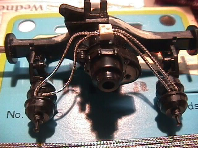

I have taken a few close ups of the christmas candies string that used for plumbing the frame. The unpainted ends show the original color. The structure of the thread is well visible.
Posted Image
I am just wondering if I can get something like this when Christmas is over. The idea came too late, the sweets were already eaten by my kids and papers with strings thrown away. I saved just a few pieces.
Hey Jaroslay I bought this elastic thread years ago from a craft store here in the US. Do you have any craft stores over there that have sewing materials? They may have this. I am currently using it to replicate textured brake hoses.
Posted Image
Posted Image
Posted Image
