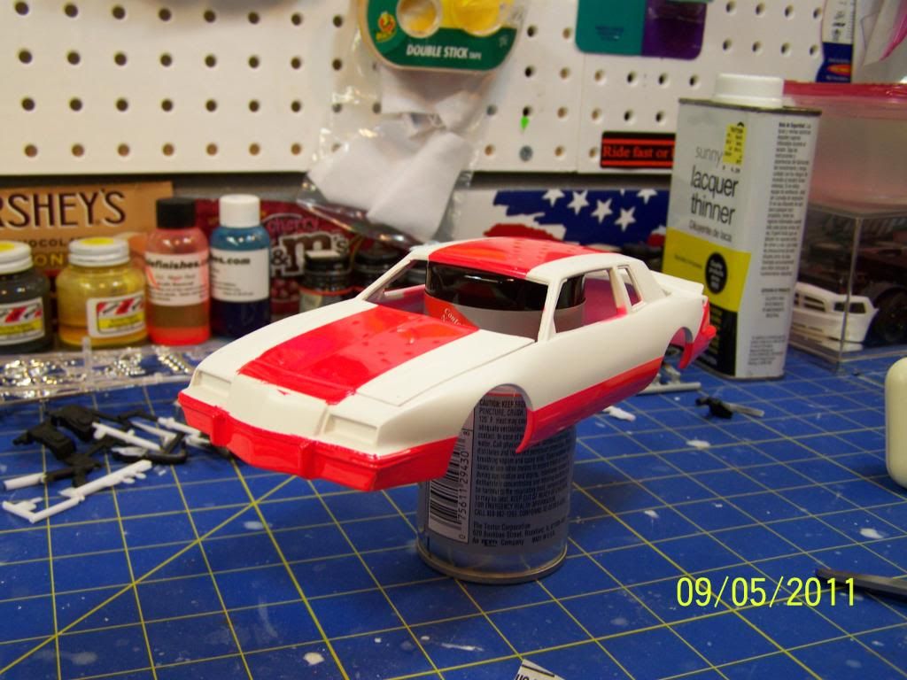

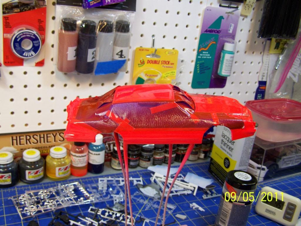

Posted 05 September 2011 - 09:01 AM
Just painted
Posted Image

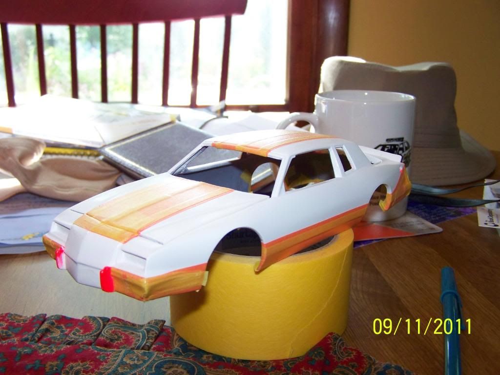

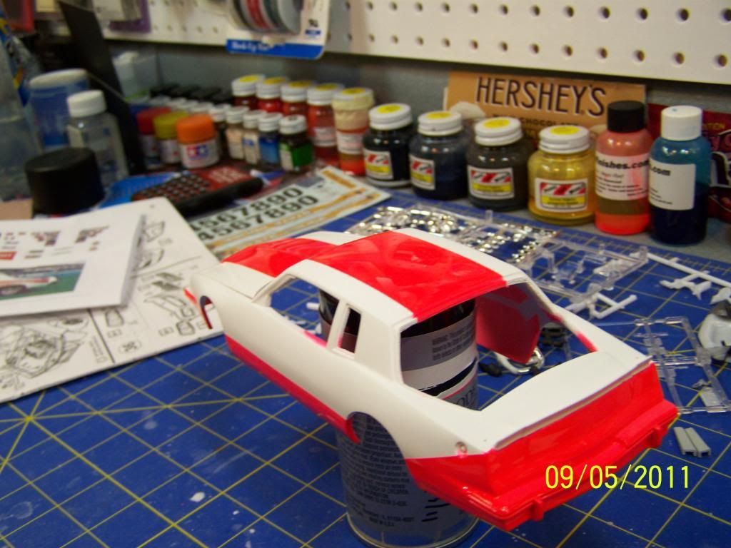

Posted 05 September 2011 - 09:04 AM
Tape removed. gonna need clean up around the nose and much to my horror i faled to pay attention and painted the fuller lower bumper red.ARRRRRGGGGGG
From bumperette to bumperette its supposed to be blue. We'll have to fix it when the blue goes on.
Posted ImagePosted Image
May I suggest you use maskign tape from Tamiya in the future? The tape you are using now is well known for bleeding and leaves a big(ger) transition between colors.
If you use modelling masking tape, the chance of bleeding are much slimmer and the paintjob looks sharper.
#9 Rocketman
Rocketman
    MCM Regular
  • PipPipPip
  • 55 posts
  • Location:Ottawa, IL
  • Full Name:Mike Fuller
Posted 05 September 2011 - 10:34 AM
Except for the curve on the nose all of the remaining edges are 6mm Tamiya tape, then blue, then 6 mm Tamiya to seal the blue tape which is how i got the rest of the lines clean.
Problem around the nose is 6mm Tamiya won't curve tight enough and I'm taping on a body curve also. I used 1mmm tape then 3mm then Tamyia. But i did not effectilvely burnish it again before paint and it lifted. In the past i've cut a pattern for things like that nose area out of 40mm Tamiya and taped on butI just wasn't thinking this morning (not enough coffee) and goofed the bumper color in the center.
We'll clean her up before adding the blue.
Posted Image

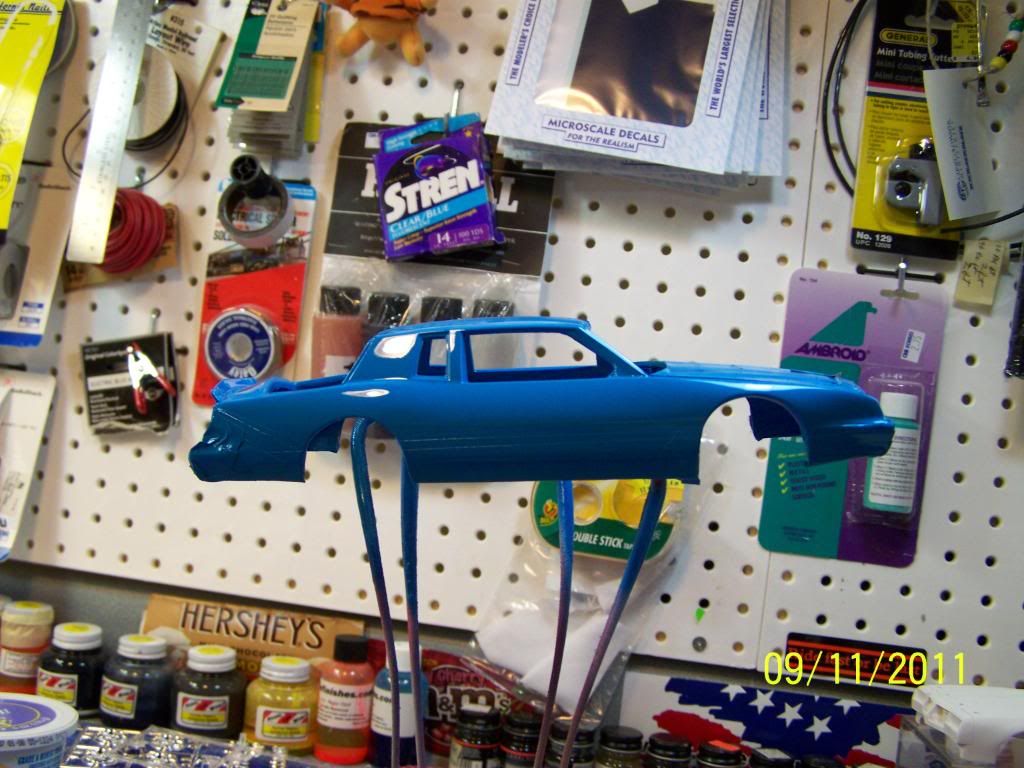

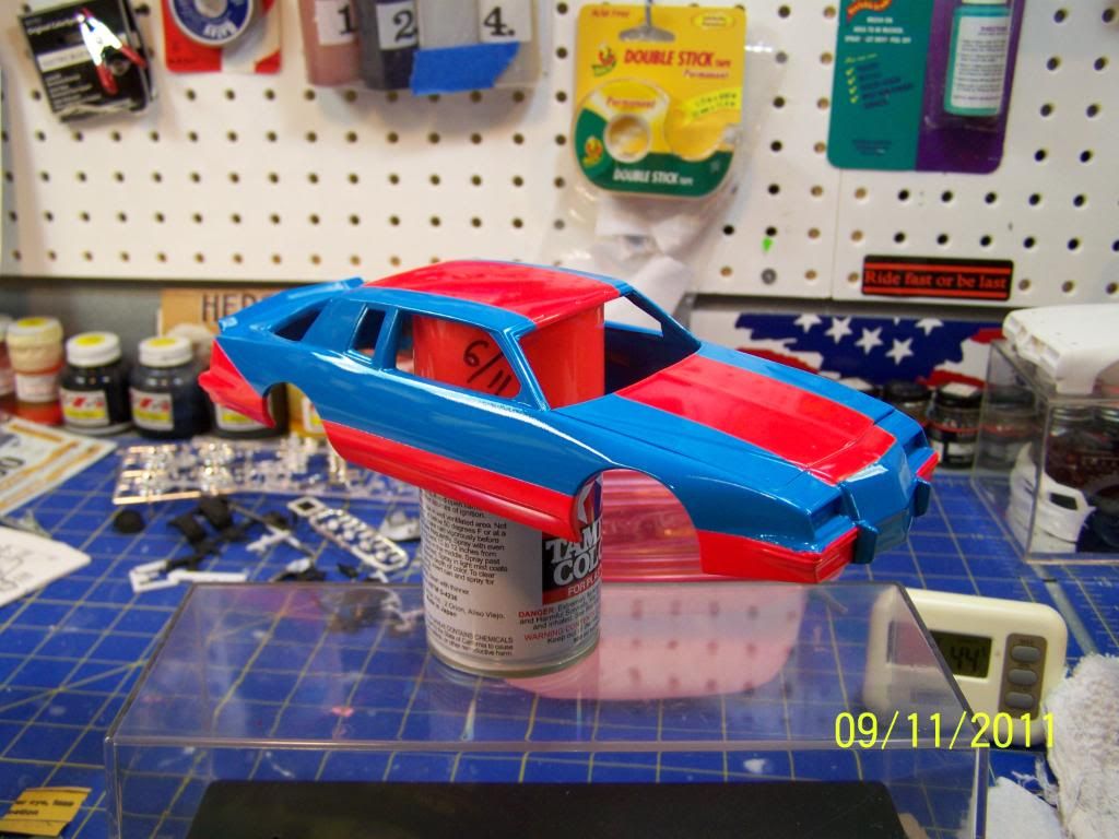

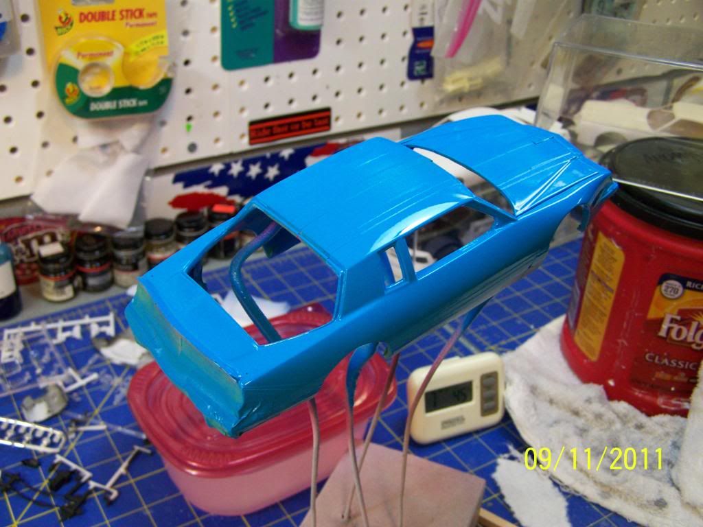

Posted 11 September 2011 - 08:38 AM
Moving right along, except for that bug that landed in the paint!
Posted Image
Posted Image
Posted Image

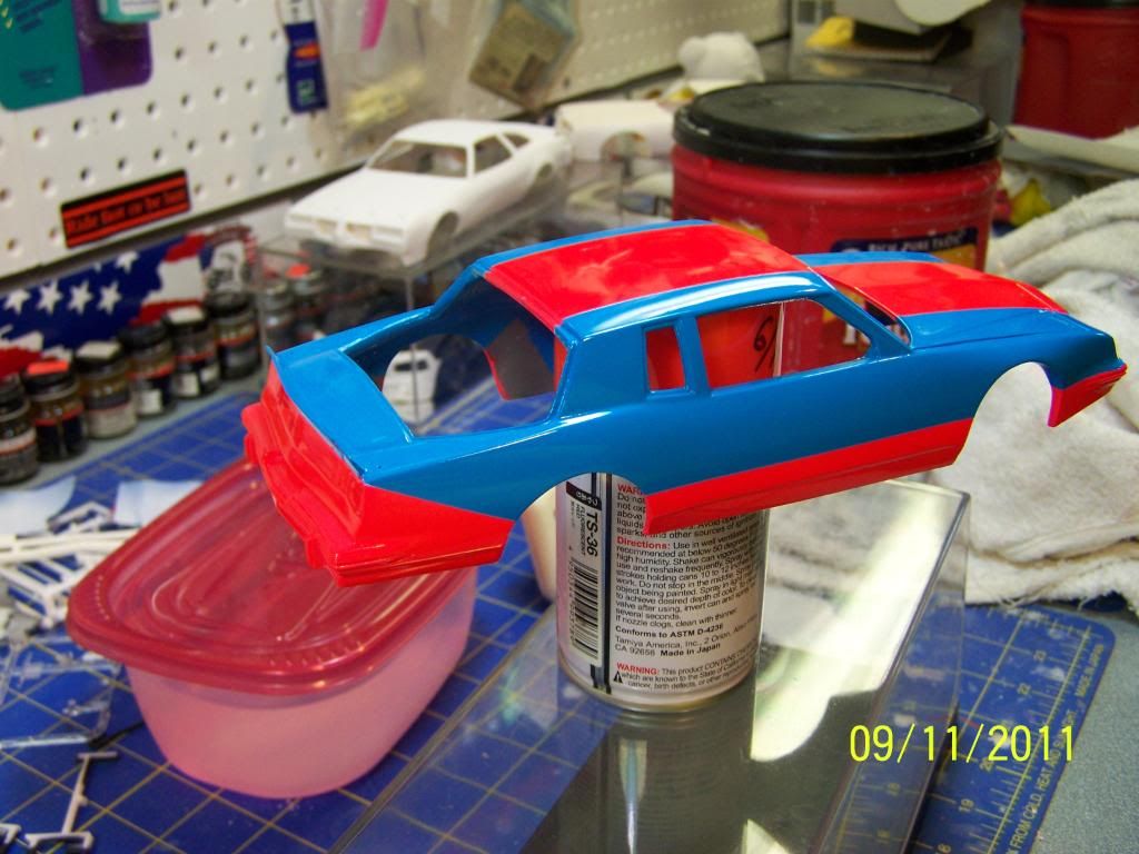

Posted 11 September 2011 - 09:24 AM
untaped

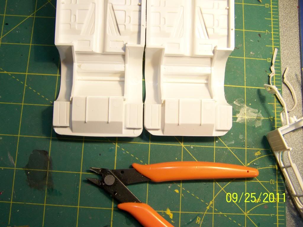

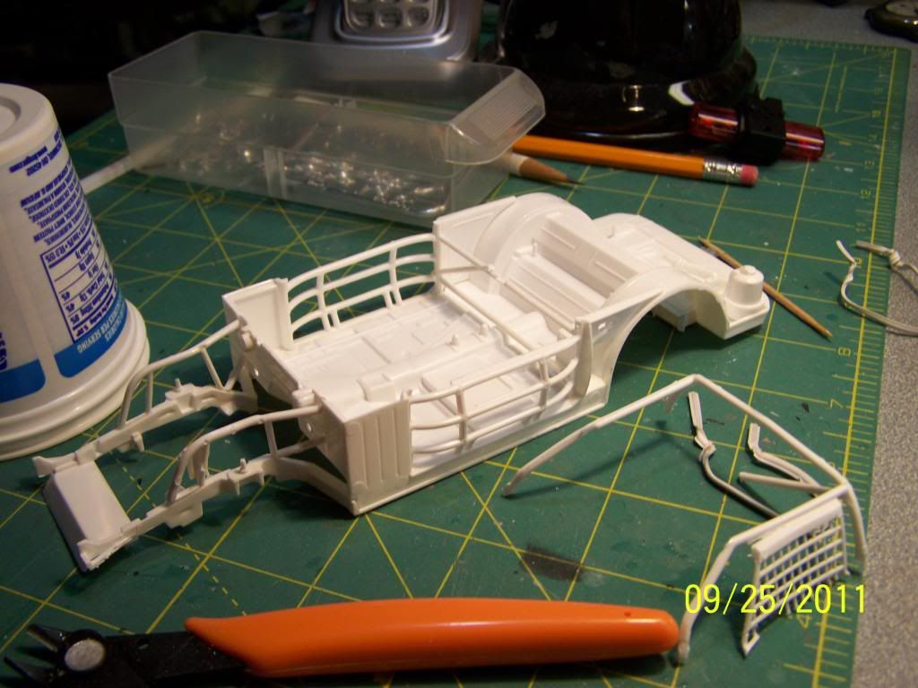

Posted 25 September 2011 - 06:24 AM
Working along. Chassis is the basic Monogram Monte Carlo/Grand Prix chassis. Did a little grinding on the inside of the body for clearance. Ground off the back of the chassis, on the left is un cut, right is after grinding.
Posted Image

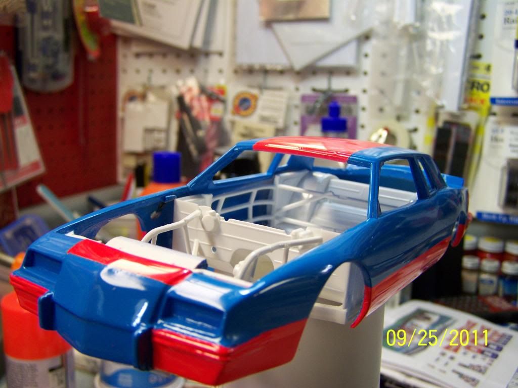

Posted 25 September 2011 - 06:27 AM
Cut to bars off as I'll have to shorten the height so she'll fit properly
Posted Image
