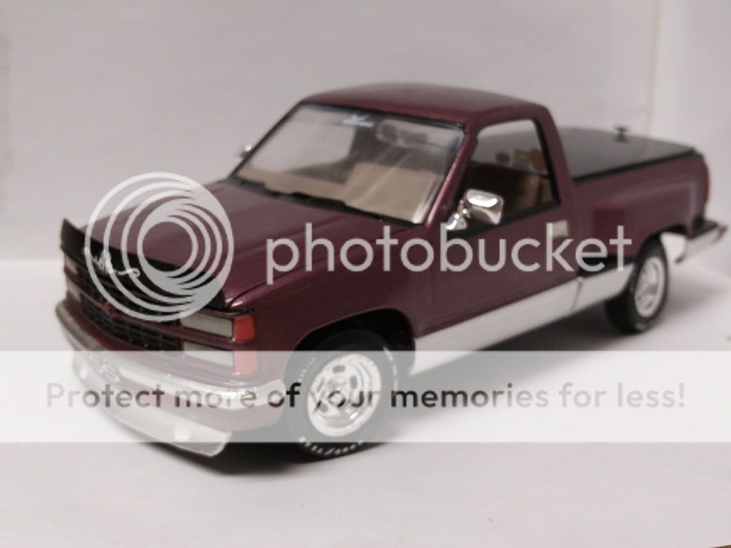

It should, depending on the color you may want to use a barrier coat of some kind (clear coat, future or silver paint works), this car was molded in black.

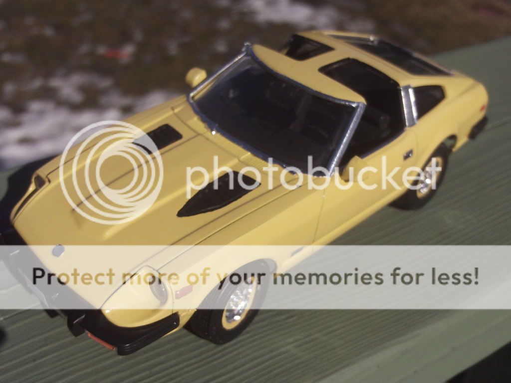

This one was also Black with Orange parts (2 diffrent versions)

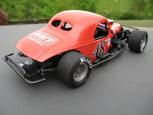

and this one had a lot of yellow colored plastic Parts

For Red, Orange or metallics I reccomend the barrier coat
Nick

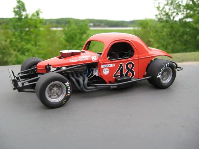

Posted 08 September 2011 - 12:42 PM
this is the Hemi orange lacquer shot over grey primer,
Posted Image
Posted Image
you could use white primer if you want i suppose but you are going to have to do one of two things in that case, either prime the car grey first or paint the inside of the body grey or black.
