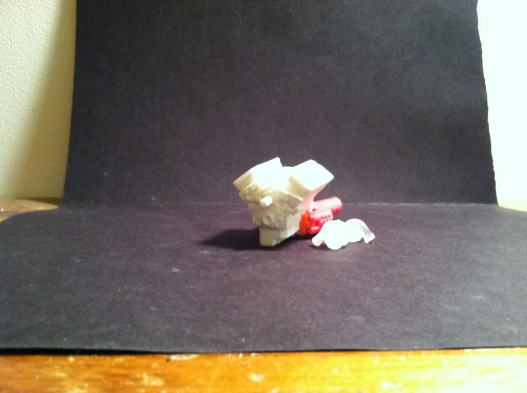

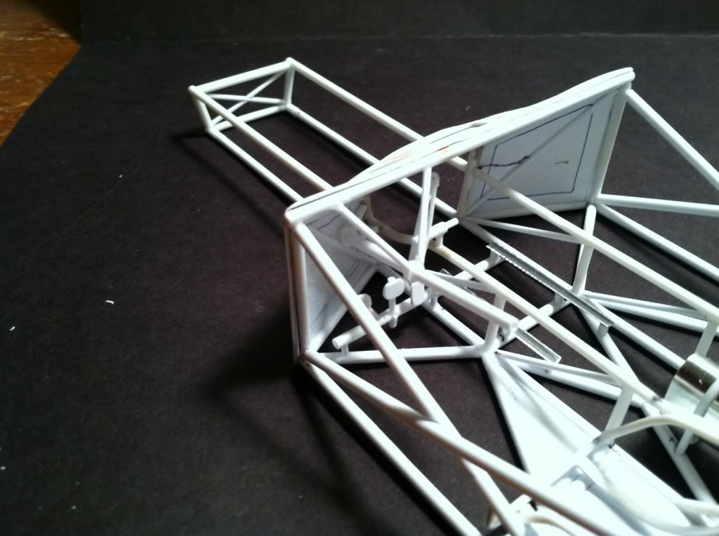

Mike, here's a picture of the turbo next to the flashpoint BAE hemi. They are the 2-1/2" turbos, bummer is the detail isn't as good as it was on the larger ones but they are still nice, hard to get good pictures of it with my Iphone, I really need to invest in a good camera.

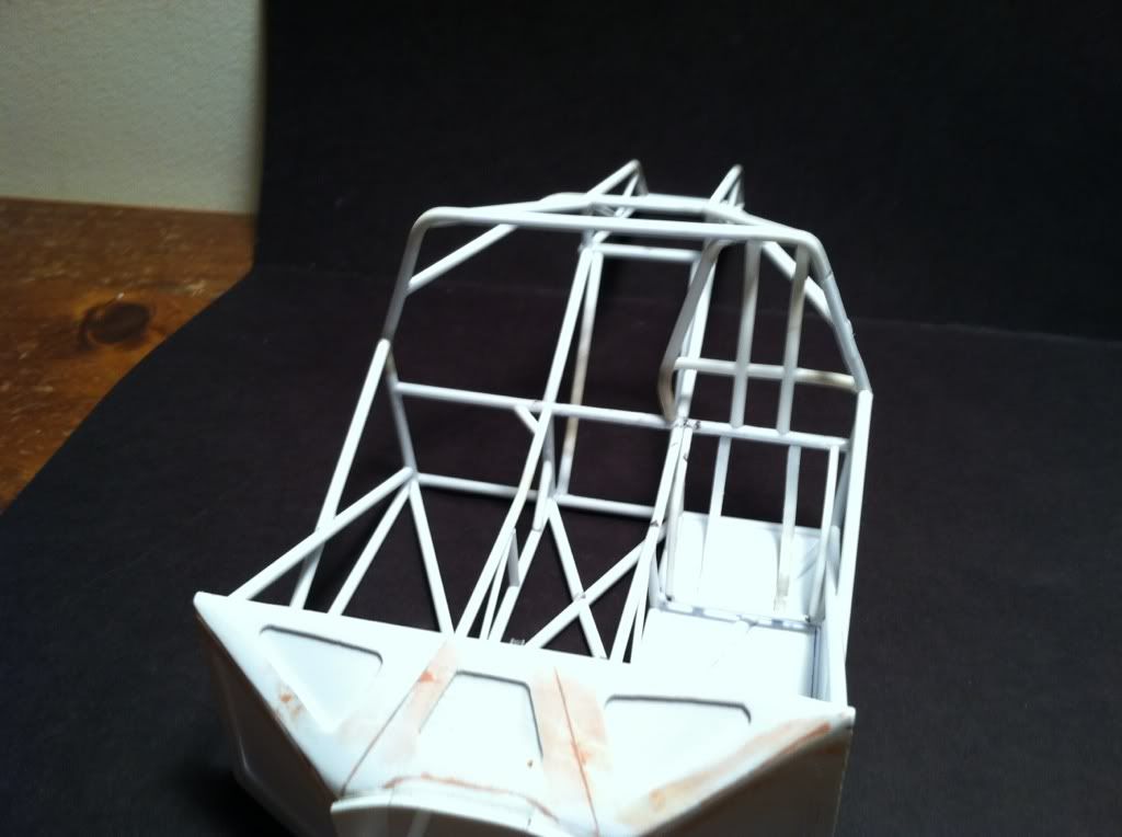

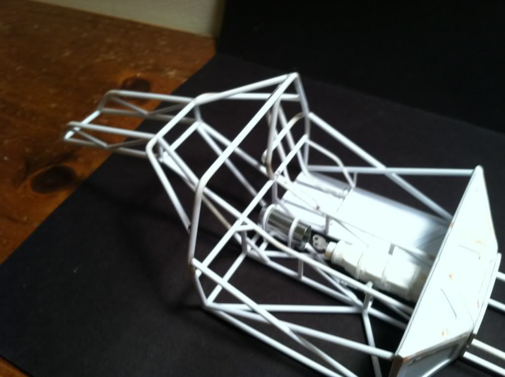

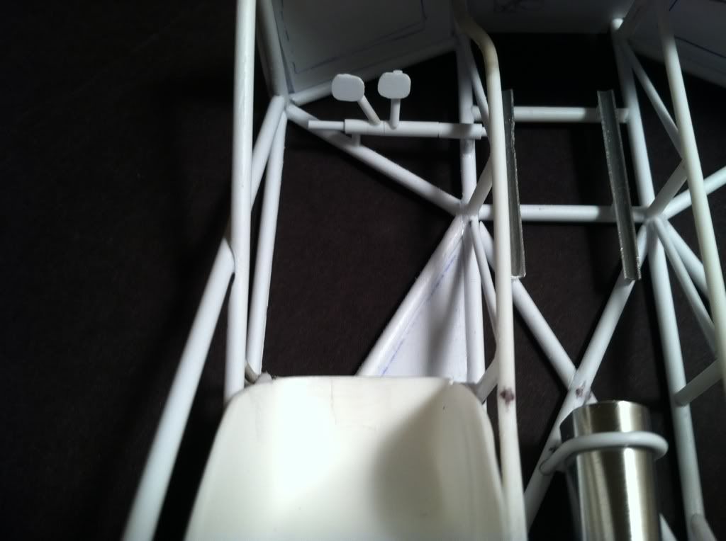

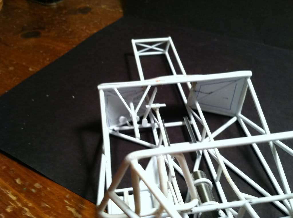

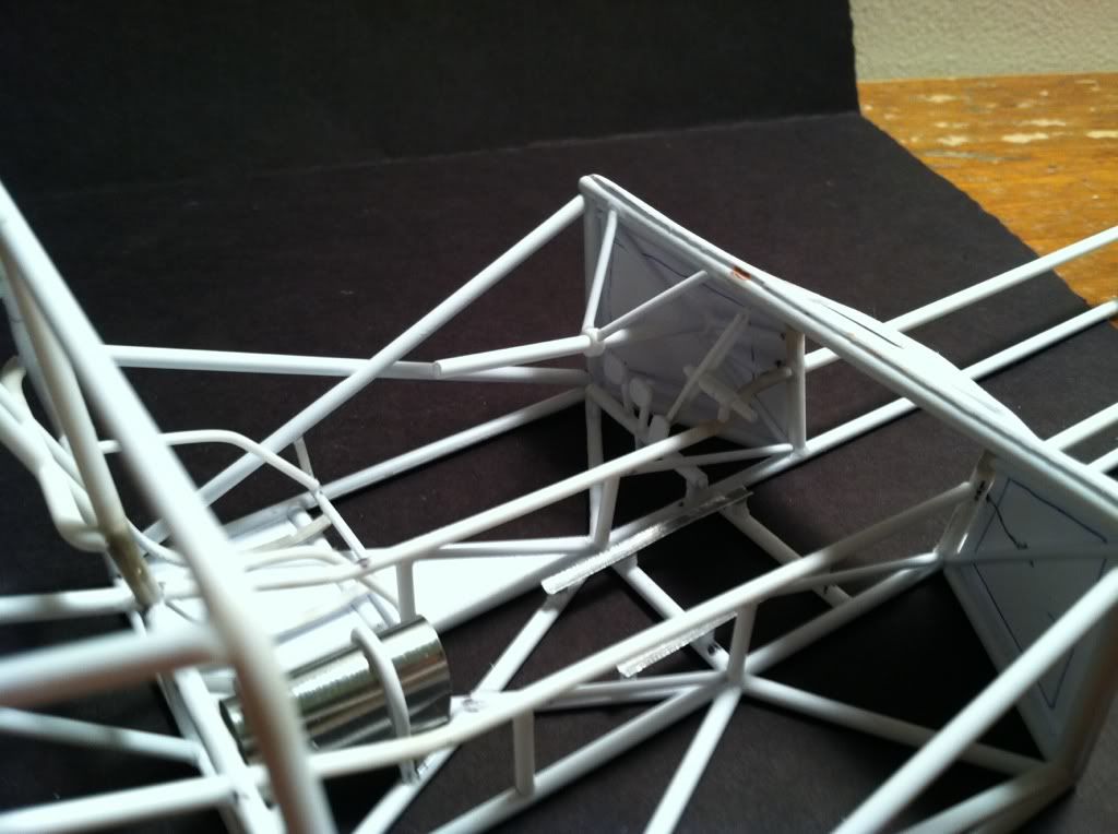

Bart, Here are some more pictures of the cage and the seat mount setup. Kinda hard to see in these pictures.

I am with everyone else... I think Joe has done an outstanding job for his first full blown chassis job!.... Even I am learning as he shows his work. :D
I saw the Video Tim (TDR) put up on Youtube on how to clean and prime the parts. He was using the 4.5" Turbo and they looked like they had A LOT of Detail! That is a shame it doesn't scale down to keep that.
Can't wait to get the Keith Black Hemi block and Heads from TDR. My plan is to use it as a model for my own Brad Anderson aluminum block... we will see how it goes. If I don't like it, at least I can resort to using the block with some modifications after speaking with Dave to make it look like a BAE.

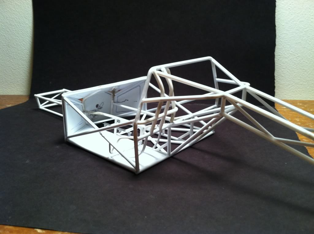

Only got a little work done, Made the Drive shaft tunnel. Used some K&S sheet and Plastruct .060" rod, I drilled some holes in the chassis and glued the hoops in and the tunnel itself is removable. Hope to have some more updates later tonight. it's been slow going but i'm making some progress lol.

Joe very nice job on bending that Tunnel yourself. What did you use to get the curve and how did you finally get it to stay together without struggling with it popping apart? LOL

The tunnel looks great... I also want to know how you bent it, I might try it on my build.

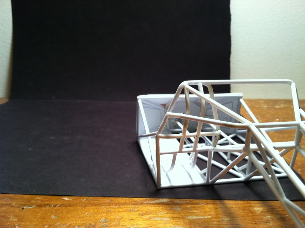

Thx. Guys, Can't tell you all my secrets. J/K lol, I used the end of a X-acto knife and bent it around it by hand. i did the top first to get a nice bend, Then i did the bottom and bent on half then the other. The bottom over laps a 32nd", the tin holds it's shape nice so it doesn't pop apart. I got my brake and clutch pedal mount and pedals done. this tiny stuff is very tedious and time consuming. gonna do the hand brake tommarrow.

So just to clear up my confusion.. the seam on the tunnel is then on the bottom or the passengers side? And will you be putting the wrapped tubing on the bottom of the tunnel as well?
