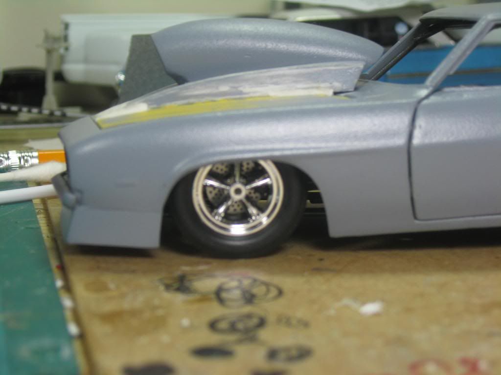

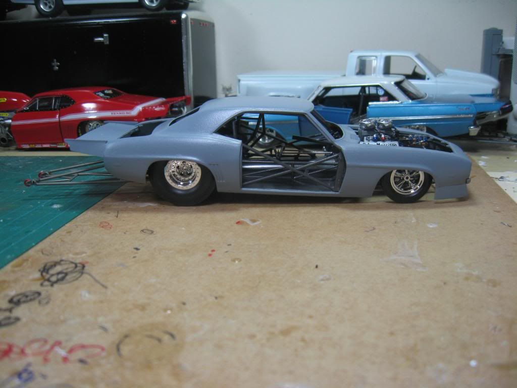

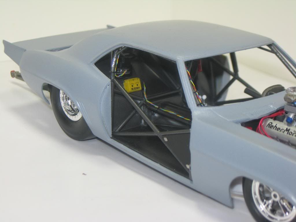

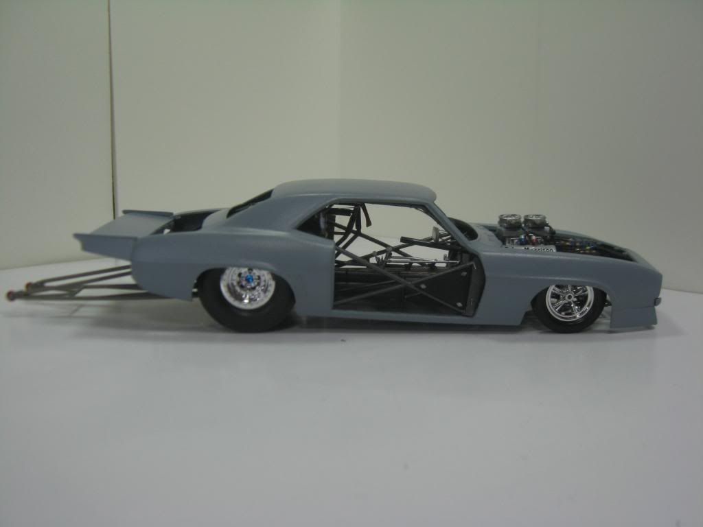

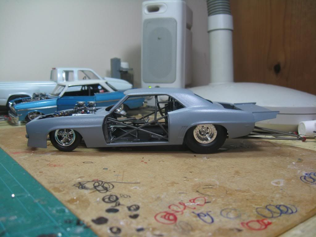

Thanks fellas for all the comments, flattering comments from heavy hitters like you all are, means alot, I didnt get a whole lot done tonight, kinda thinking of what I'll be doing next and also trying to decide on a color. Bart I'm not going to add any styrene pieces to this one I kind of like the stance like it sits..here's a few pics w/primer on the body...

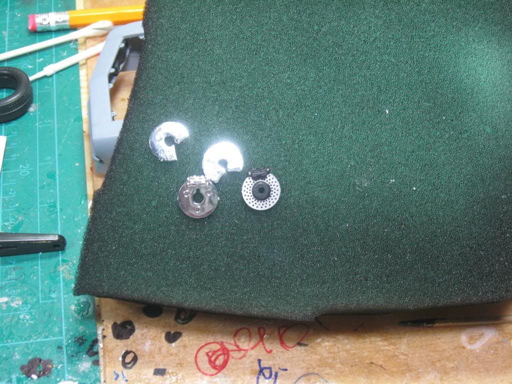

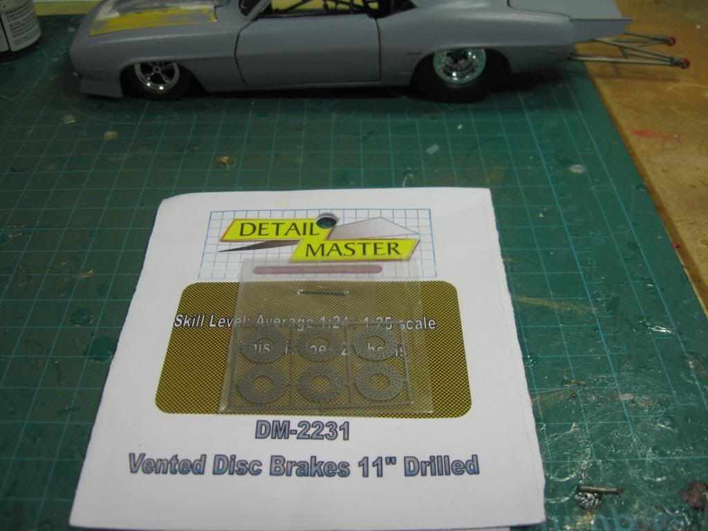

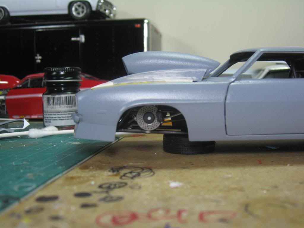

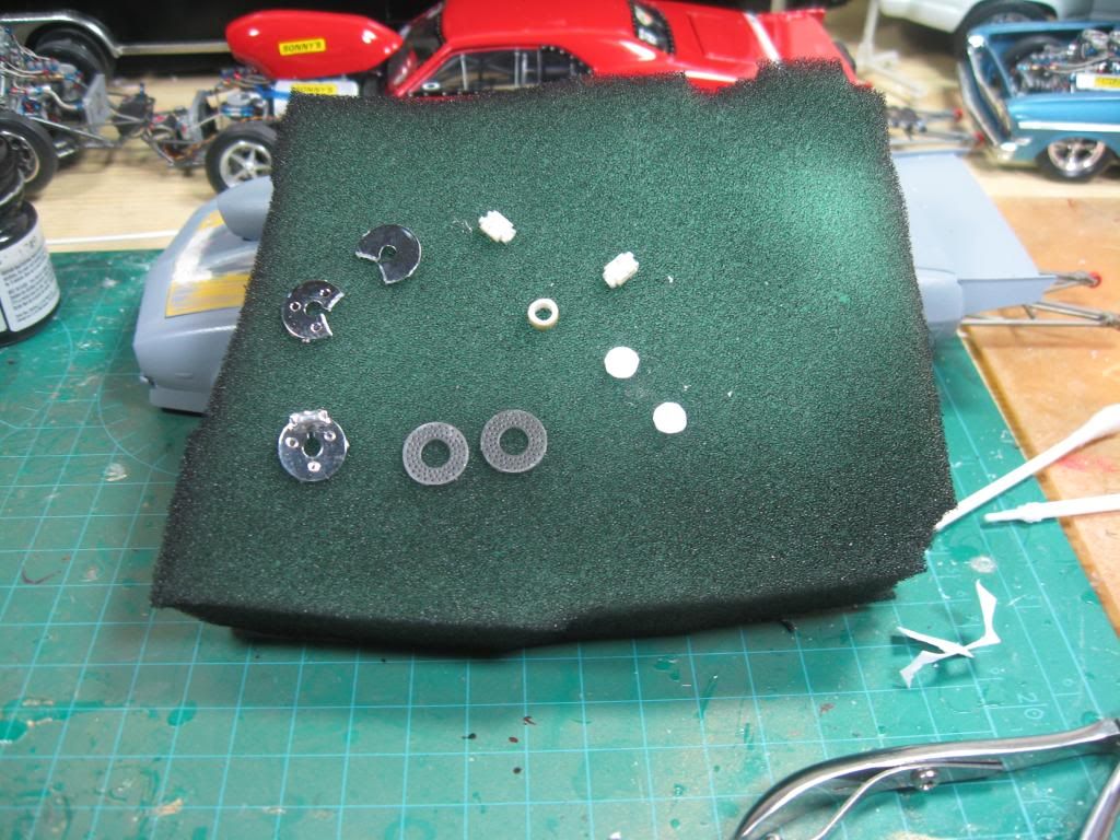

Well I got the front brakes/rotors done, I used Detail Masters drilled rotors and cut the calipers off the rotors in the pro stock cutlass kit, then I used my dremel tool w/the cutting wheel on it and carefully cut a groove down the middle so the rotor fits inside, I used a piece of round tube to make my hubs, I added a piece of stytrene to the face and drilled a hole through the center to fit on the spindle,,black paint and bolt heads from pro tech. I'll get my braided hoses on tomorrow, thanks for looking and comments welcome...

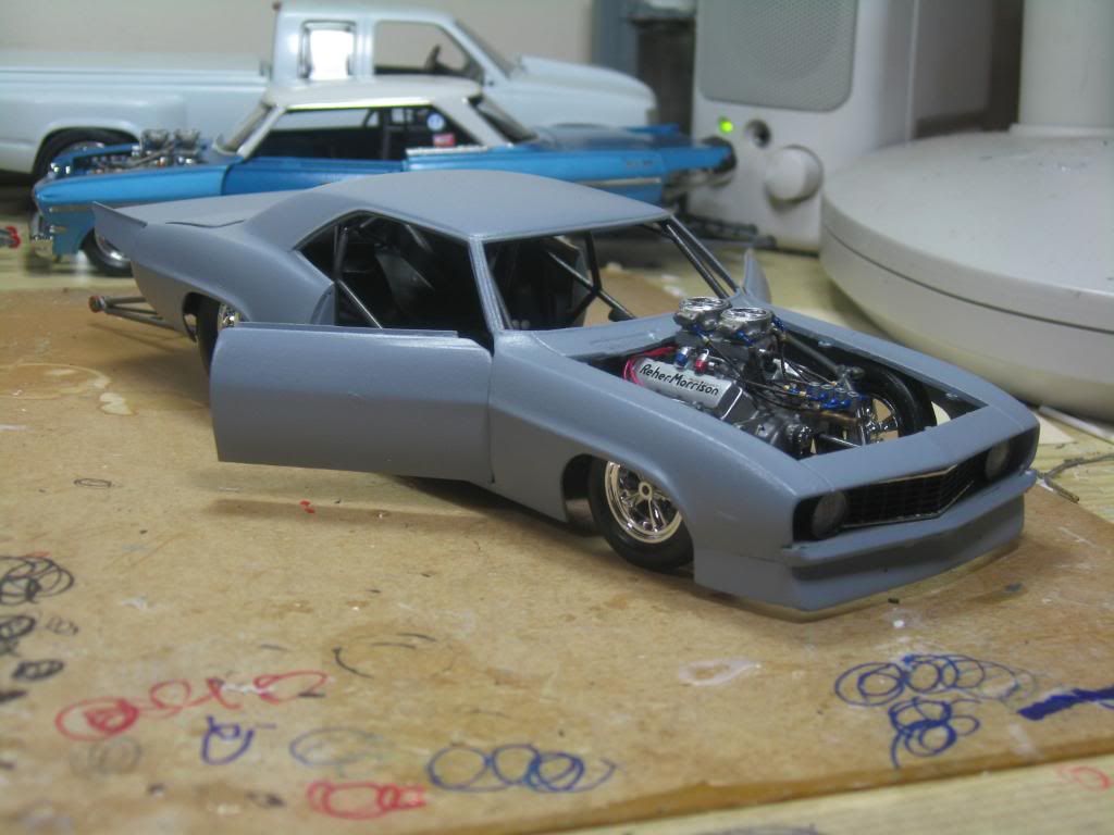

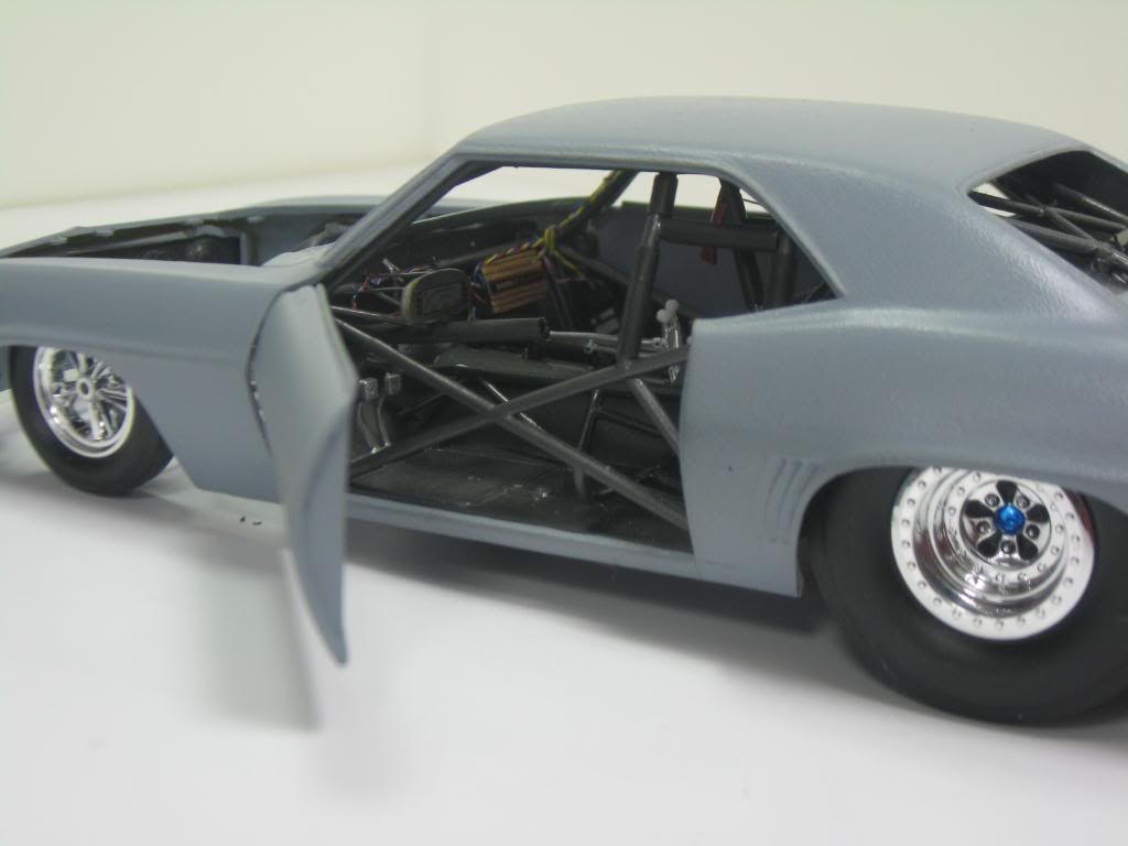

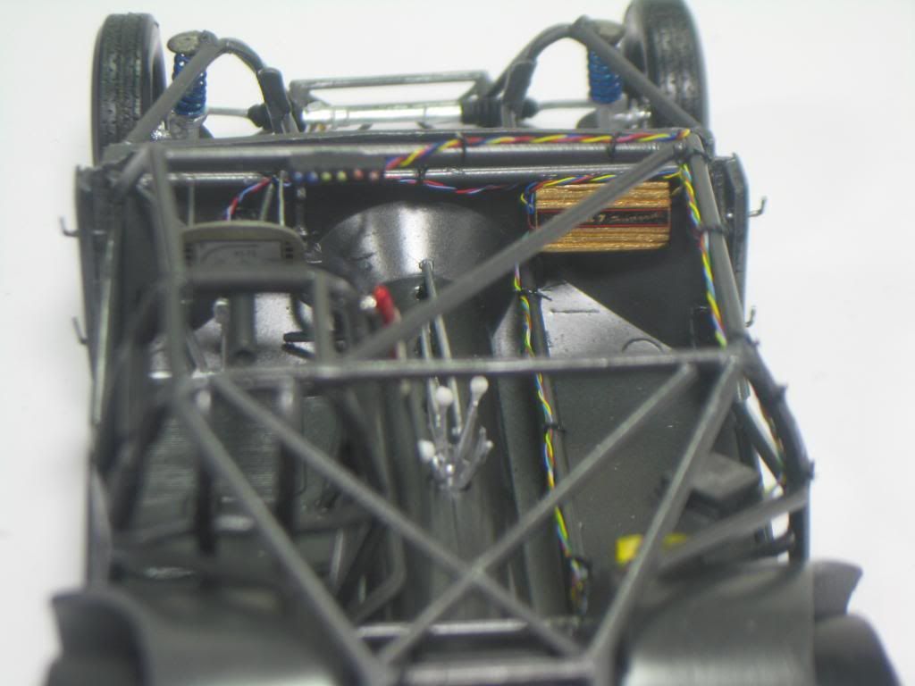

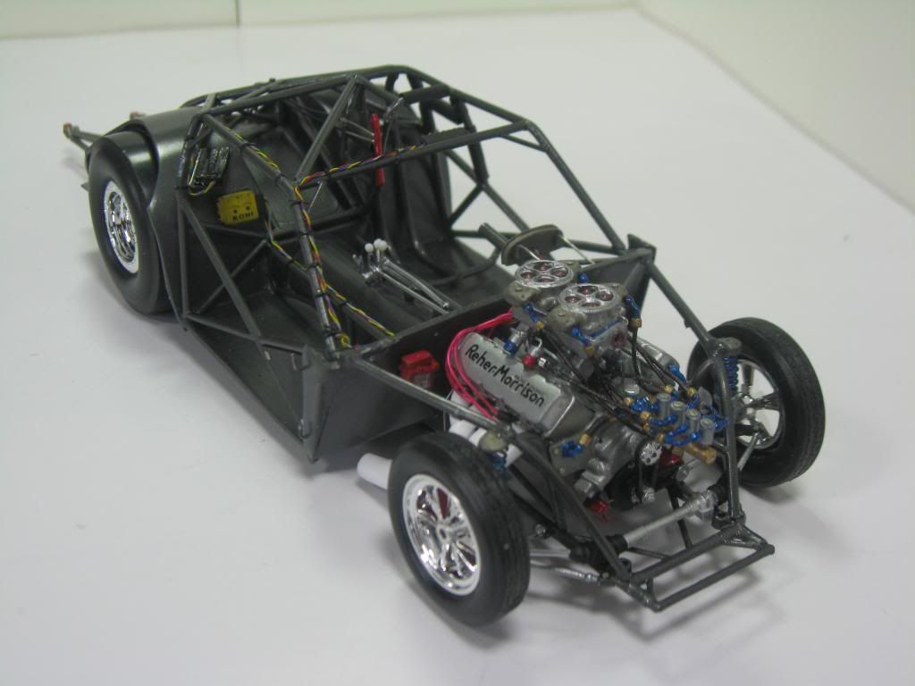

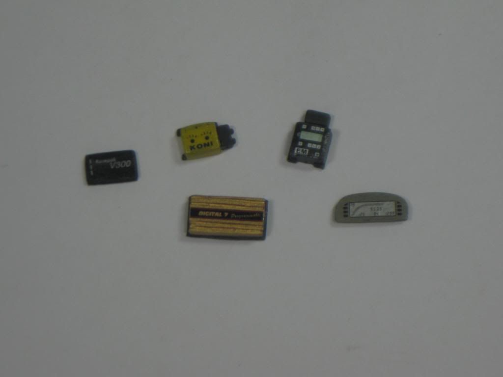

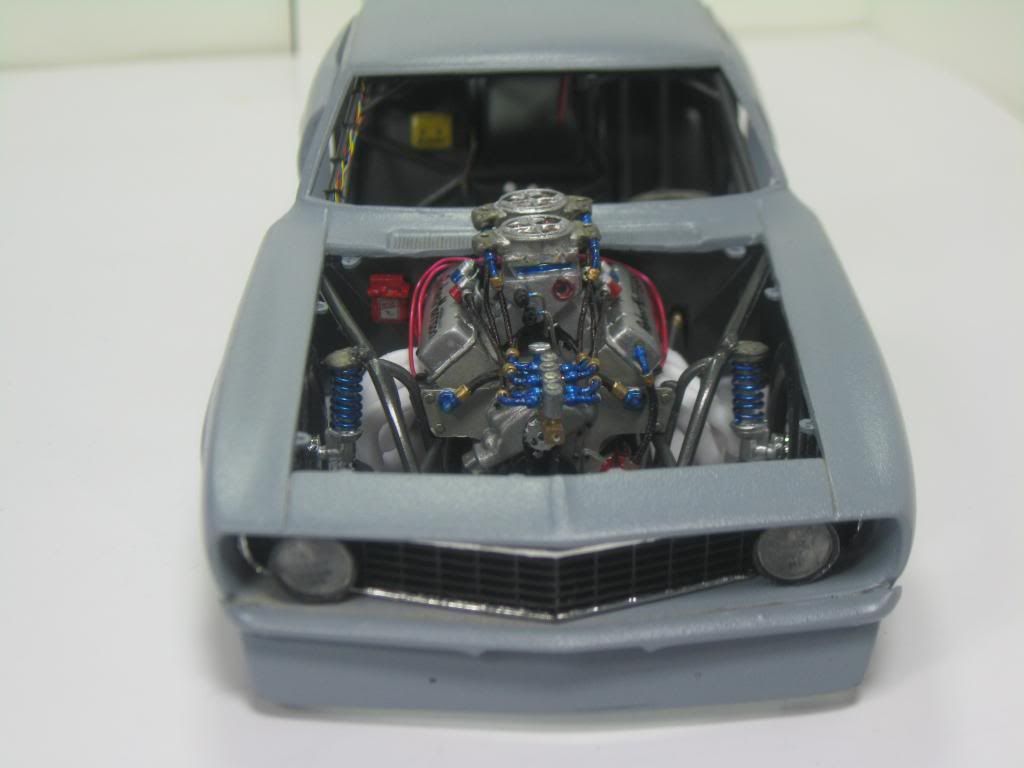

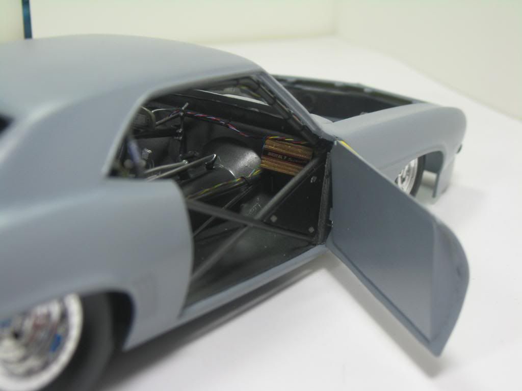

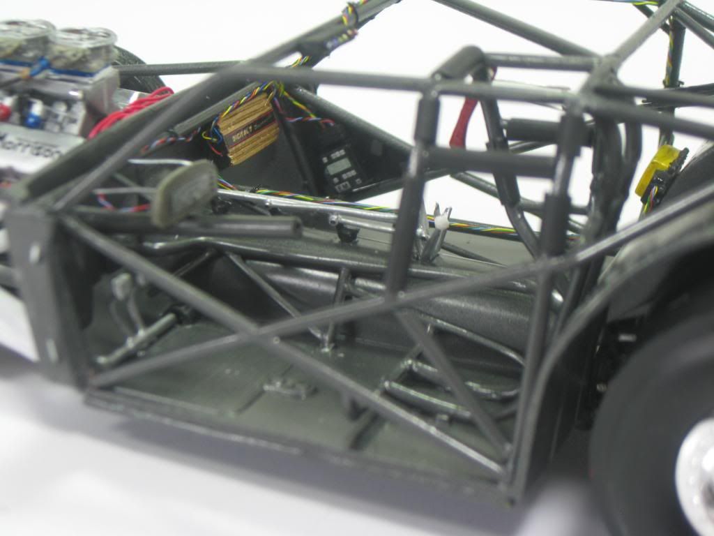

Thanks for the kind words fellas, Dave, much thanks, RG, one of these days I'm gonna have to take a stab at one of those turbos, trying to round up some good reference pics, so many projects, ideas and not enough time. I did get some work done on this one I got the electronics made up and installed, I really like the new decal sheets from Slixx, there's some of everything on the sheets, here's a few pics thanks for looking and comments welcome.....

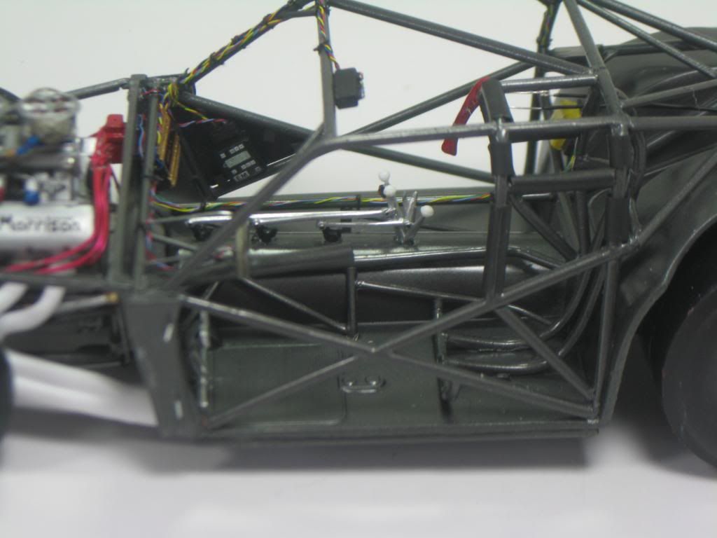

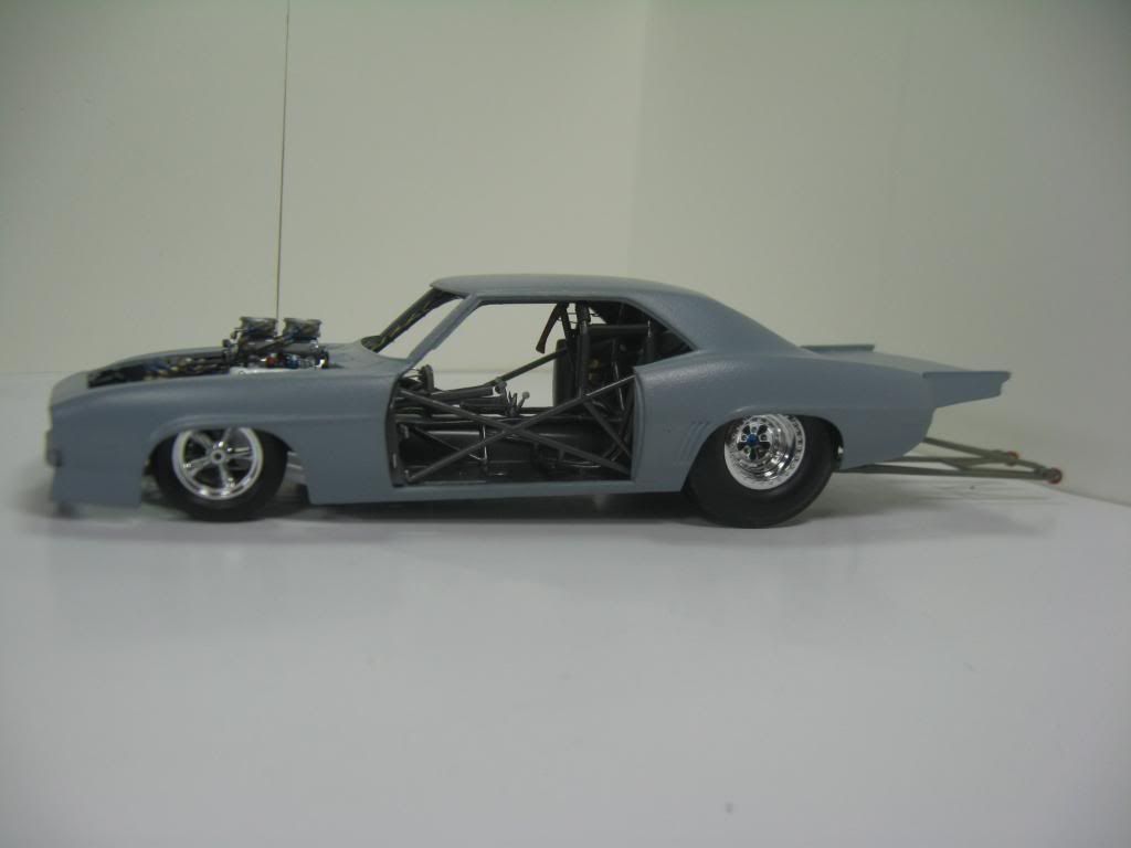

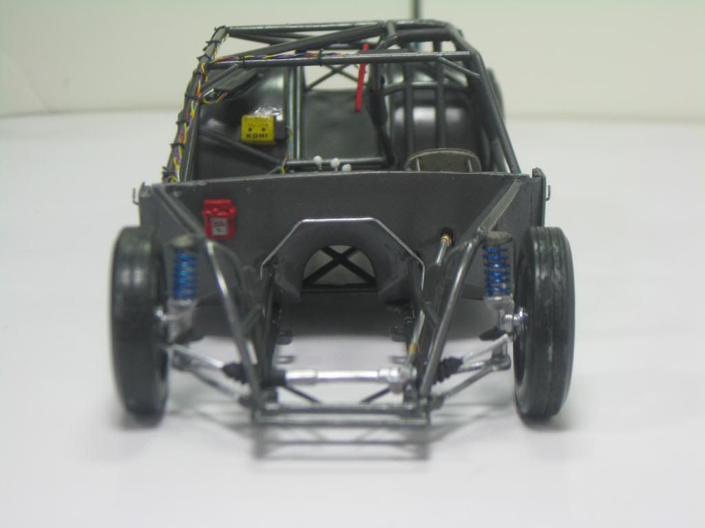

I also got the ignition coil mounted, got my brake lines ran, and got the chute handle and cables done, heres some more pics..
