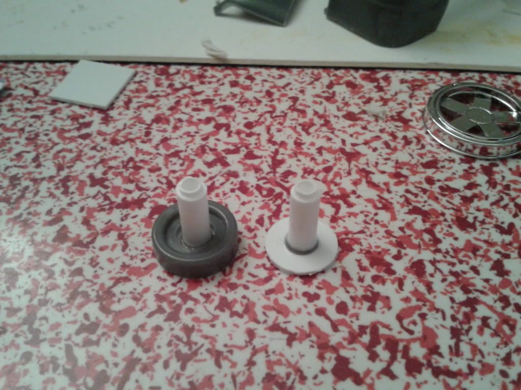

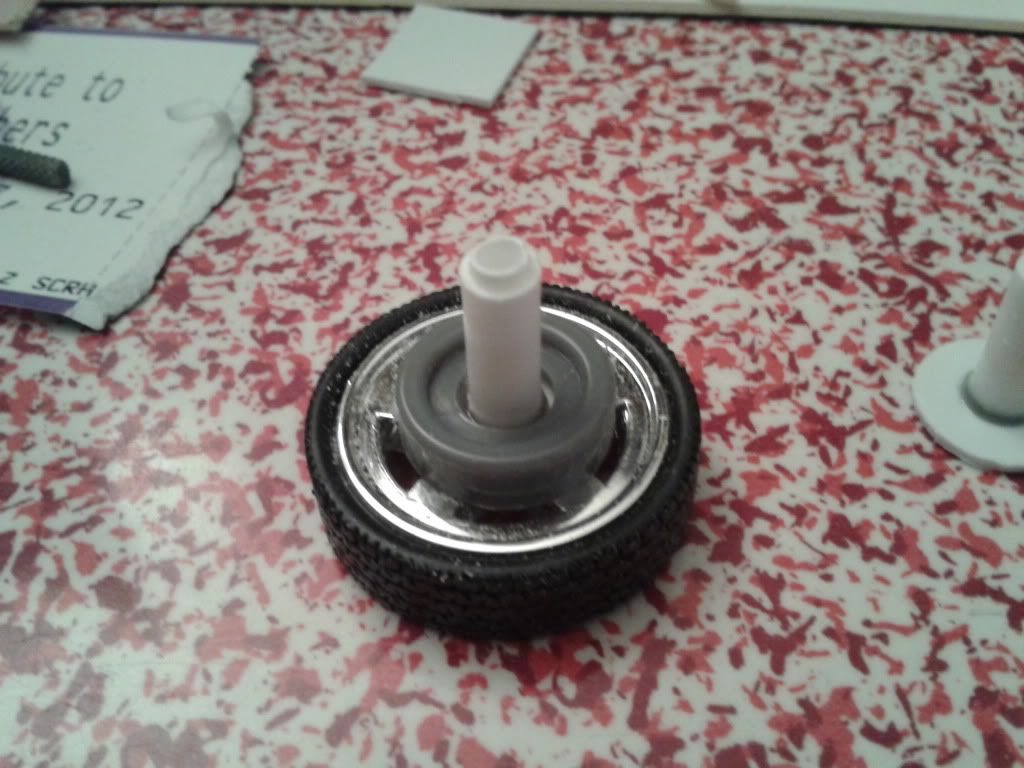

Here are some work on the wheels I made an adapter to connect the wheels to the spindles. Since I want useing stock rims I had to figure out something. The way this will work I can cut the spindels down and slid on this adapter and glue it to the rims.
Posted ImagePosted ImagePosted ImagePosted Image

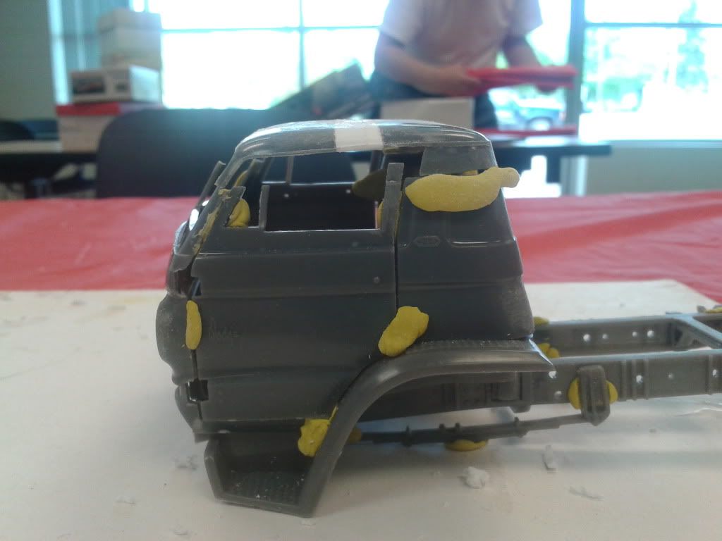

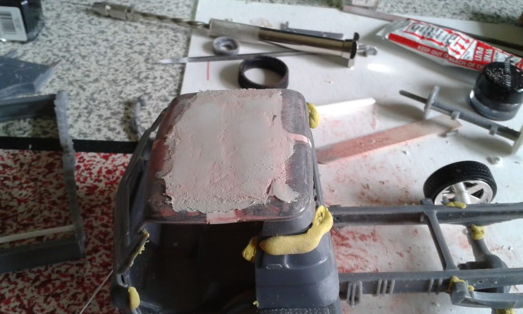

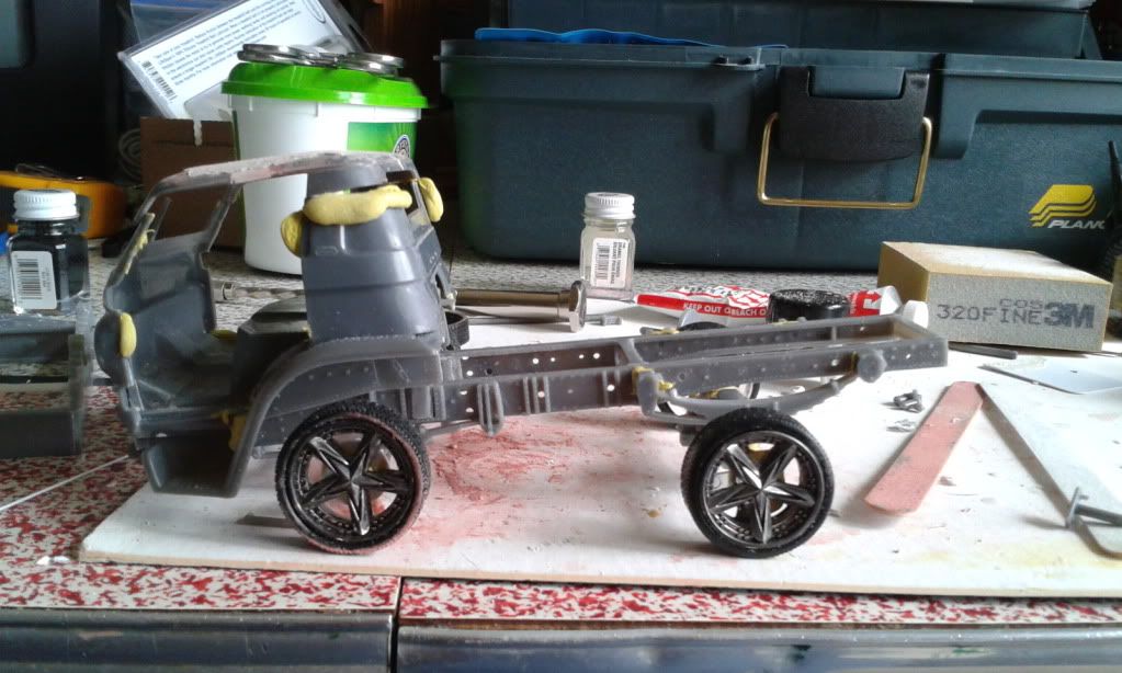

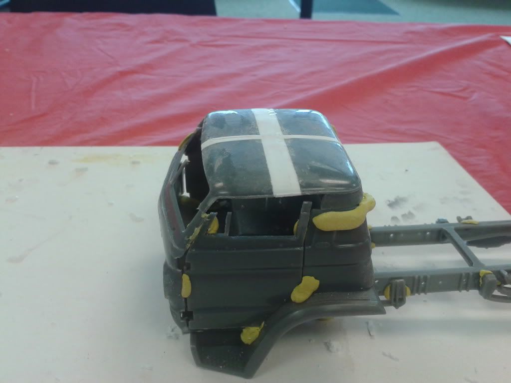

Posted 13 May 2012 - 06:27 AM
Minor update and taking suggestions on how the stance looks if I should lower the end or live it as it sits
Posted Image
Started off working on the roof again with some putty, I had a chnace to sand it down but didnt take a picture yet.
So do you think I should lower the end or leave it up in the air.
Posted Image

Posted 13 May 2012 - 03:02 PM
I'd lower both front and rear. That's just my opinion.

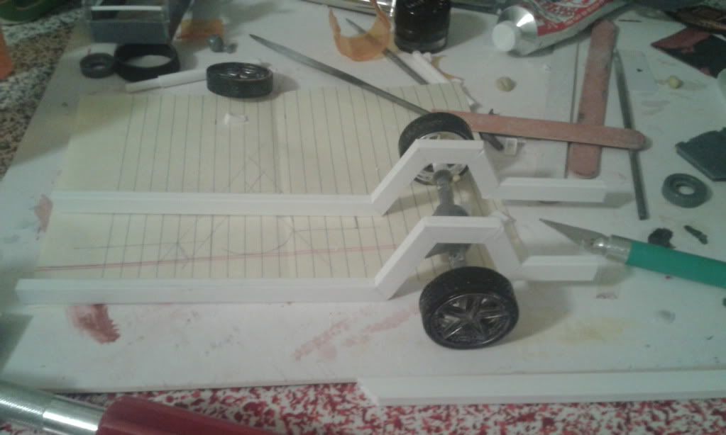

Posted 22 June 2012 - 06:58 AM

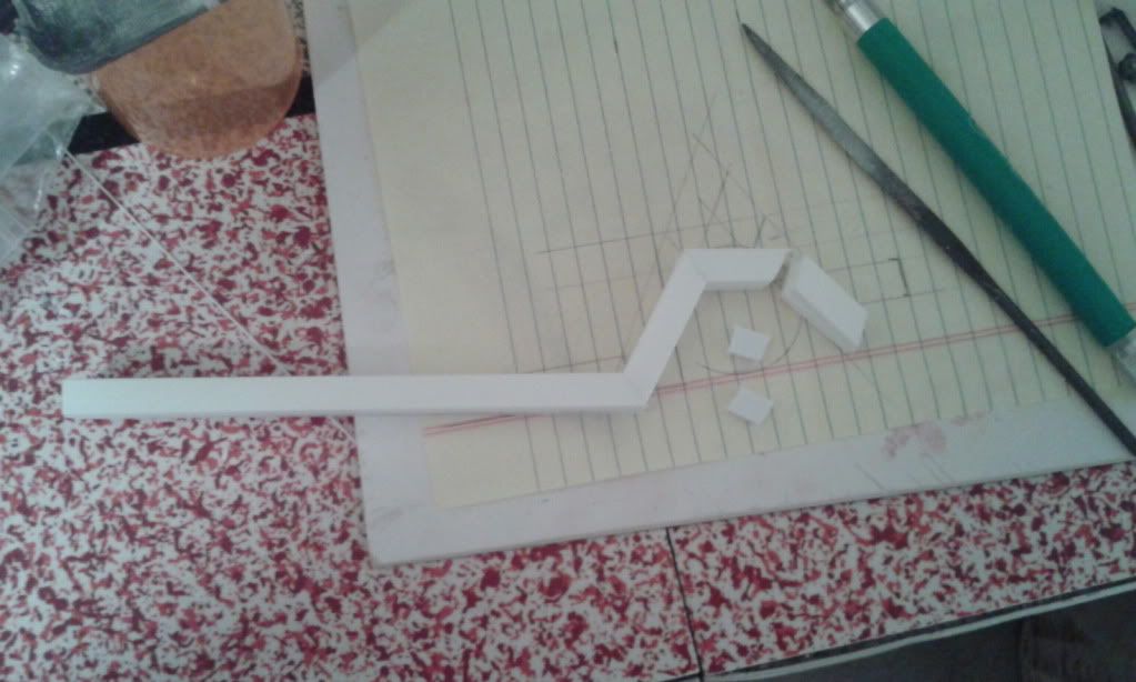

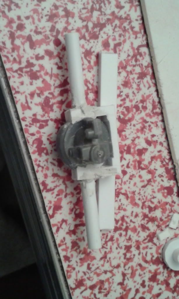

Okay major update on this one I have been working on the Frame and trying out a new process. Tell me what you guys think what should I change does it look good.
Posted Image
I have tried to create a new frame that will allow it to drop down lower and add in some Airbags for the suspension.
Posted Image

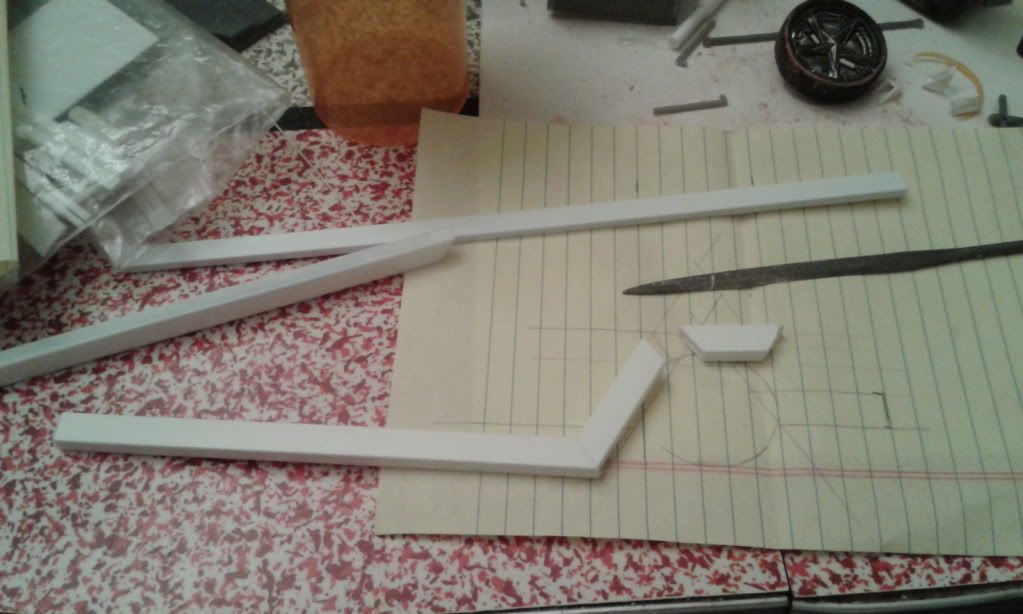

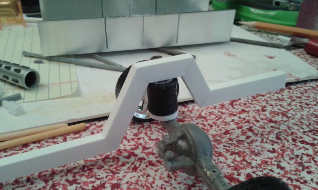

I purchased some hollow channel and begain to create the frame. At each point I put in a spline piece to give it more glueing surface.
Posted Image
Posted Image
Mock up of the frame over the wheels.
Posted Image
I started working on my airbags to see how they will look. If anybody has a spare rear end that would work here let me know I might replace the one that I have I buggered it a bit.
Posted Image

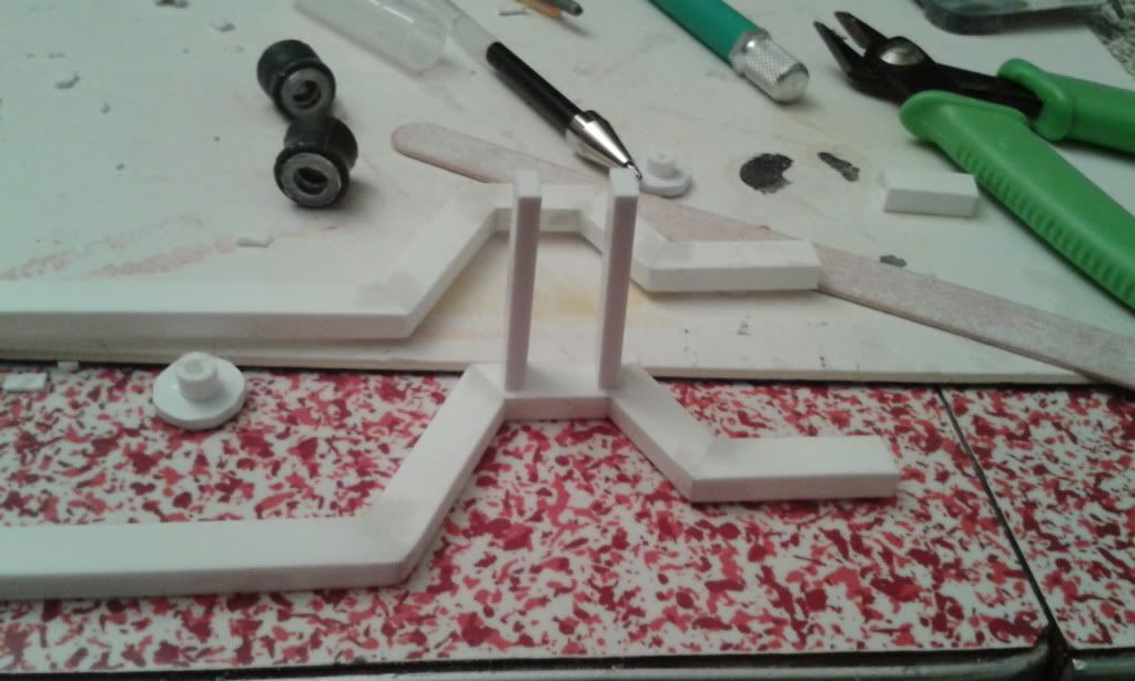

Here I was trying to rig up a spot where the upper link connections will go. it wasnt untill I had finished that I realized I had done it upside down.
Posted Image

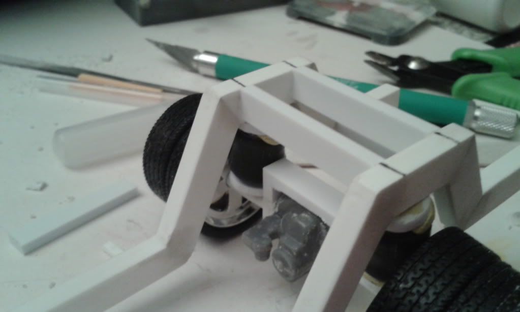

Starting to put the frame together.
Posted Image
Closer picture of the backend

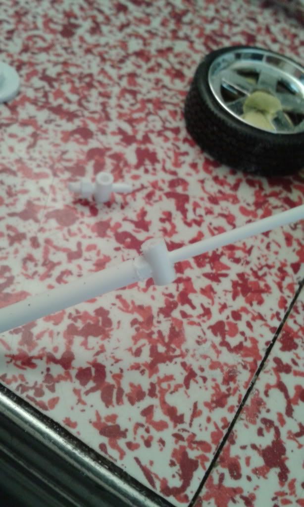

I have started making my four link suspension for my Dodge L700.
Posted Image
The top stub will chopped off.

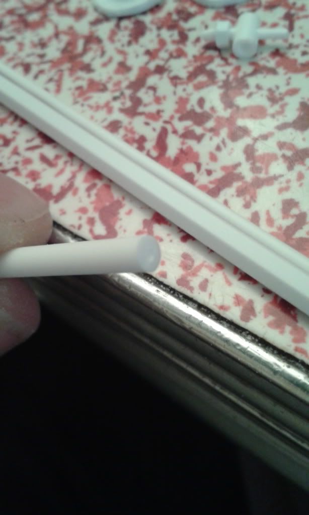

Posted 05 July 2012 - 12:04 PM

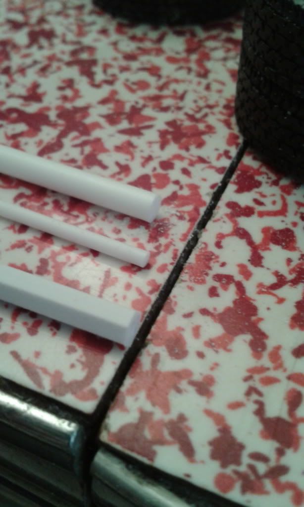

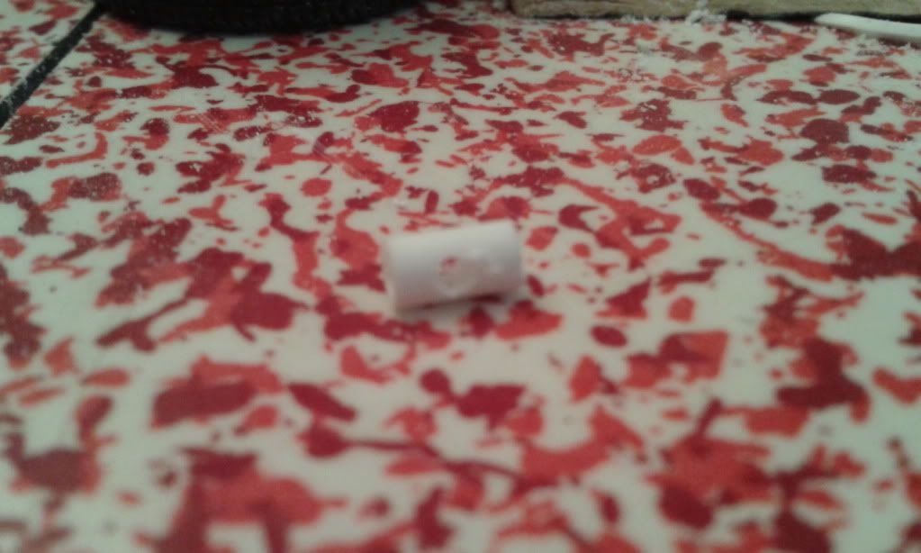

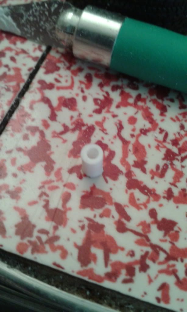

I started out with three different size rods. I would use Hex rod that is about the same size as the larger rod.
Posted Image

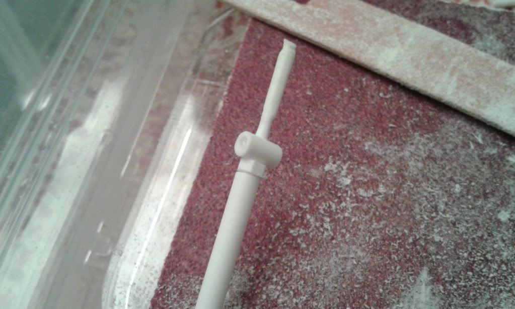

Then I drilled out the center of the larger round rod. The trick to use, I pointed my Exacto knife in the center and made a divit to fit in the drill bit.
Posted Image
I then drilled it out and cut off a section
Posted Image
Next I did the same thing with the exacto knife and then drilled a hole in the side all the way through.
Posted Image

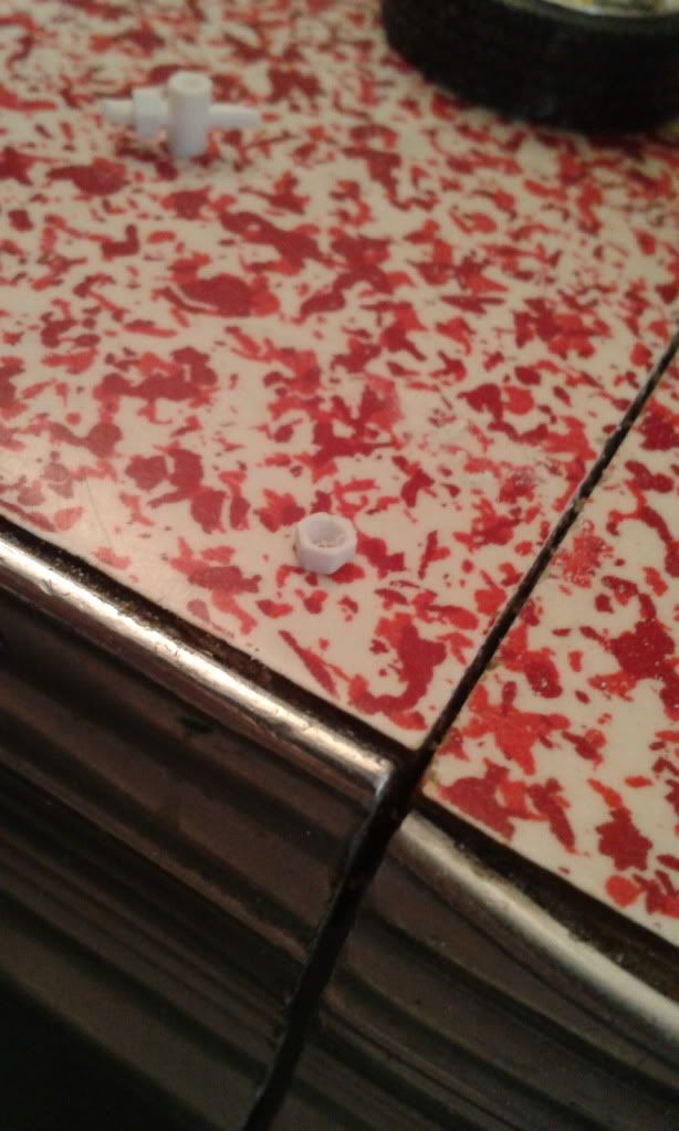

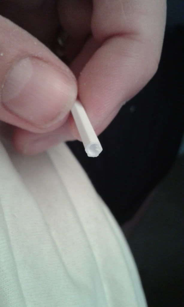

Now you drill out the hex rod and then cut of a nut sized piece.
Posted Image
Here is your nut
Posted Image
Here is the assembled piece.Posted Image
