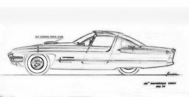

Welcome to the 1955 T-Bird design study build.
I am going to take you through the entire process of scratch building a car from the plans stage to the final display. This will be done is small increments that can be done in less than an hour or two. Each stage will cover completely the materials used, the tools required, and the process to get to the next step. Anyone with a few models under his belt and some small scratch building experience will be able to complete this project.
I encourage those following along to post pictures of their progress, to ask questions, and to offer up alternative methods. I would like to have an exchange of ideas, and ways of doing things. What I am offering up is by no means the only way to do this, but rather the way I am doing things at this time. During the build if you see better ways or different ways of doing something I encourage you to post this.
Feel free to modify the plans to create other variations of this car, Can it become a pickup, convertible or something that is rusted out and falling apart. Maybe it could be used as a platform for something entirely different from what is presented. I am hoping to accomplish at least to things here. First to show others that scratch building is not as hard as it looks, and second to have fun with it and exchange ideas.
The drawing is of a concept for the Thunderbird done in 1955. I have a few photos of a quick design study taken from this drawing. It is by no means a finished model but rather an assembly to find out the problems that we will run into and to try to make the process easier. It is rough and is not intended to be the quality I hope to have when we get done.
The first installment will be in a few days and cover creating plans from renderings or other drawings that you may have to create layout patterns to make your model. I will have a set of plans in PDF format that you can download that will print out in scale.

Getting a drawing to a scale drawing is not as hard as it may appear at first glance. It is a matter of getting the drawing to scale and then to a line drawing to work from. You can do this with any side drawing and front or rear views. You will need two programs to do this. Word and some photo program. I use Photoscape, it is easy to use and FREE. The link to get this is as follows.
http://www.photoscape.org/ps/main/index.php
You will need to get the wheelbase and tread specs for your car. In this case it is 102” wheel base. (1955 Thunderbird). Then divide this by .25 for 1/25th scale or .24 for 1/24th scale. This comes out to a hair over 4”
Now go to photoscape(or your program) and open this in the edit option and find the filter option in the main column to line drawing and choose edge. And save as JPEG. Reverse the drawing and save again as reverse.
Now open word and set the sheet to horizontal. Insert you’re drawing and set the margins to 0” along to top is a scale that you can use to size the drawing. You can adjust the drawing until you get a tad over 4” center to center of the wheel covers. It will be close enough. Save this drawing as a JPEG and PDF.
The drawings are shown here for reference.
