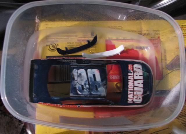

Posted 16 November 2011 - 01:45 AM
Posted Image
Posted Image

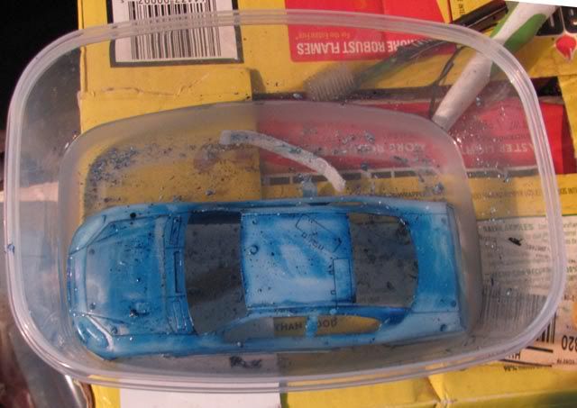

Tried superclean with not very good results

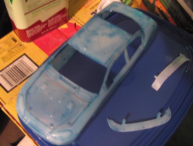

#3 MarkJ
MarkJ
  • 652 posts
  • Location:Texas
  • Full Name:Mark
Posted 16 November 2011 - 01:51 AM
Posted Image
Posted Image
Posted Image
Tried 95% denatured alchohol and got much better results. Ready for sanding and putty and styrene modifications to add a front and rear spoiler and change the nose a little. I also have to change the quarter glasses.
Edited by MarkJ, 16 November 2011 - 05:58 AM.

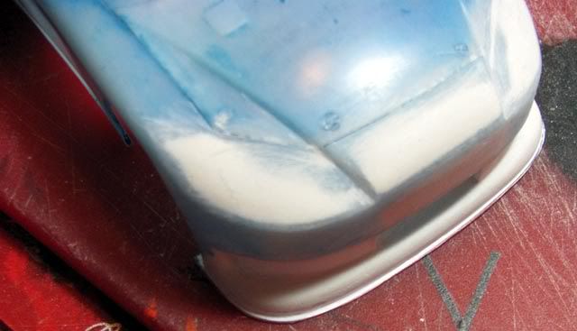

Posted 24 November 2011 - 11:39 AM

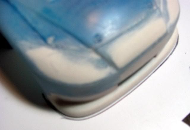

Posted Image

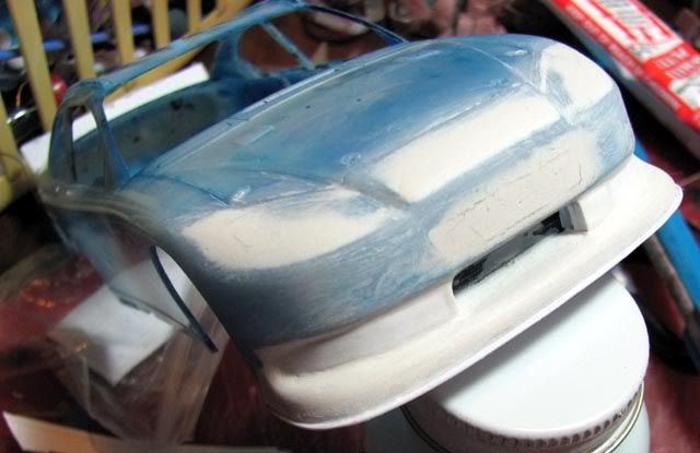

Added the Squadron white putty where needed for now.
Posted Image
Added the lower strip, leaving just the edge of the old splitter showing.
Posted Image
Will have to wait till Thanksgiving to proceed.

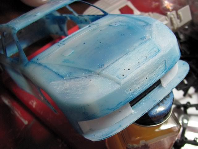

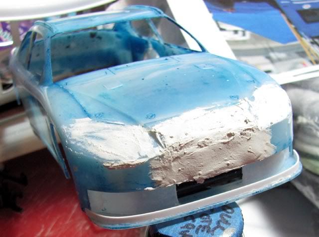

Did some more sanding but still not quite right.
Posted Image
Added some more putty . Hopefully just one more sanding and I can move on to finish the rear spoiler.
Posted Image

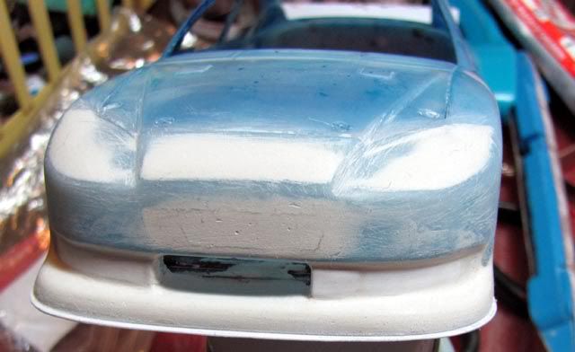

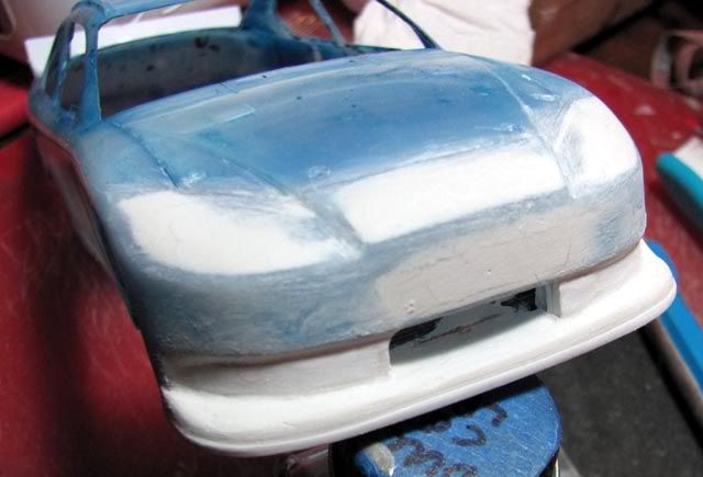

Posted 03 December 2011 - 01:46 AM
Posted Image
Posted Image
Posted Image

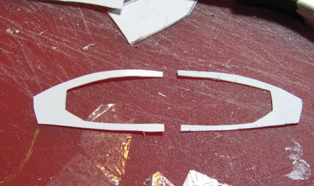

I needed to make the splitter lip to add to the bottom of the nose. I just used the nose as a template.

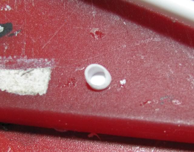

#12 MarkJ
MarkJ
  • 652 posts
  • Location:Texas
  • Full Name:Mark
Posted 03 December 2011 - 01:48 AM
Posted Image
Posted Image
The nose is ready for some two color priming to get rid of scratches, dips and pin holes.
Posted Image

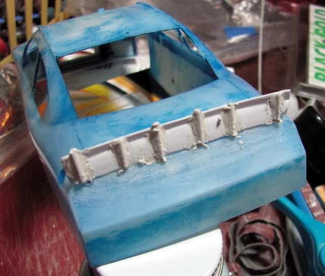

Posted Image
Posted Image

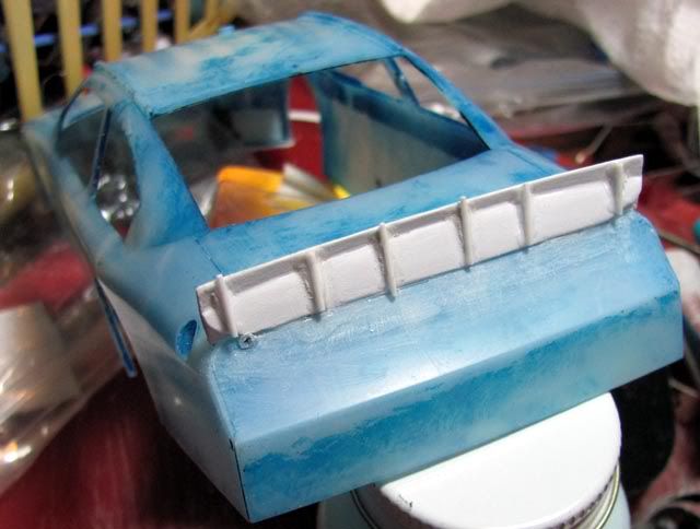

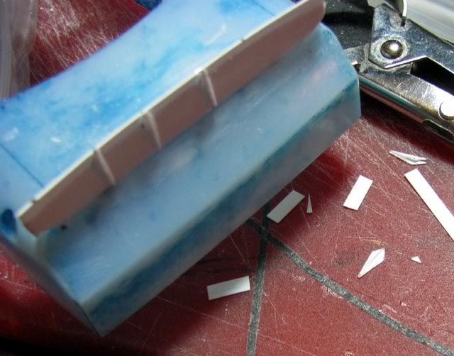

I made some diamond shaped pieces of styrene to splt but not break for the spoiler braces. After installing I added some putty to make them more uniform. It looks like the braces are not symetrical side to side and the reason being is that the real cars braces are not symetrical side to side.

Looking good. Interesting subject, new Nascars are something really rarely seen in this scale. Bodywork looks good too. I'll be watching, but where are you going to get decals for it?

Posted Image
You can see the gap on the right side between braces is greater than on the left side.

Niko, I will use some of the contengencie decals that come in the kit but the rest I will have to create on my computer and print out on testors paper. I did a test decal to see how it would look and it turned out pretty good.

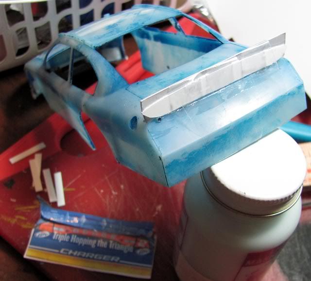

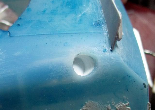

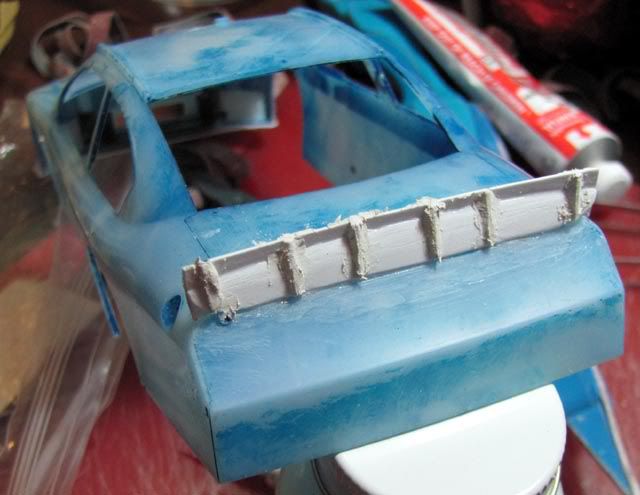

Here are some more rear spoiler wips
Posted Image
Posted Image
Need to do some more sanding.

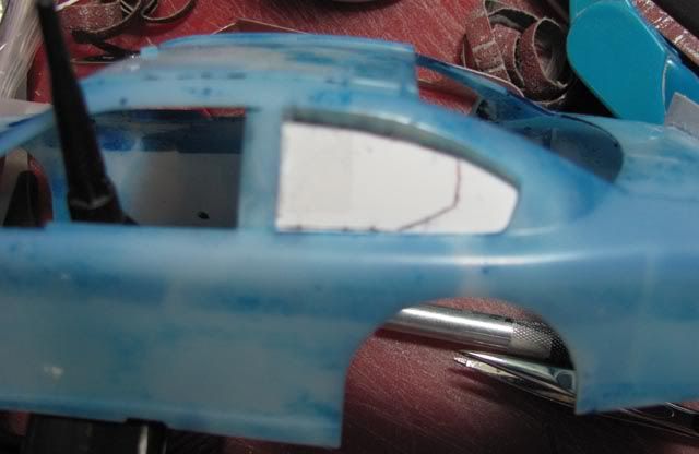

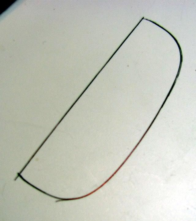

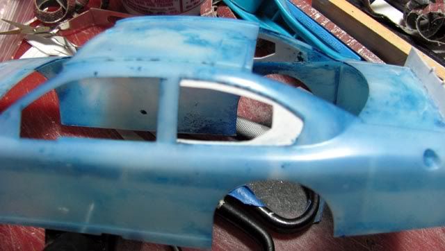

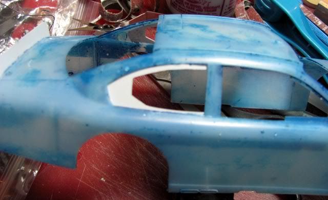

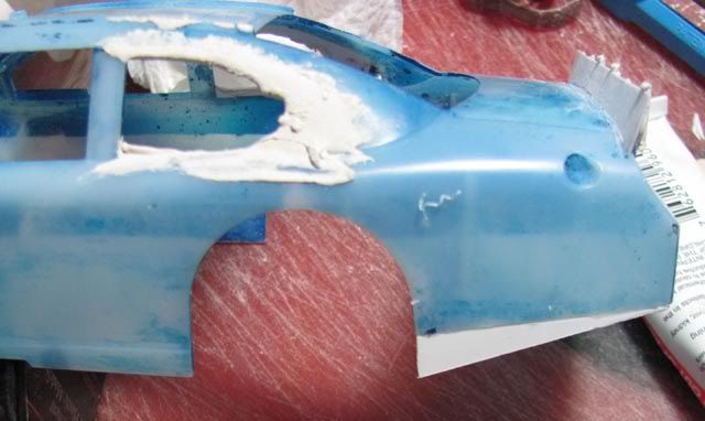

Started working on the quarter glasses.
Posted Image
Posted Image
Posted Image
Posted Image

Added putty to the quarter glasses and installed the quarter panel extensions.
