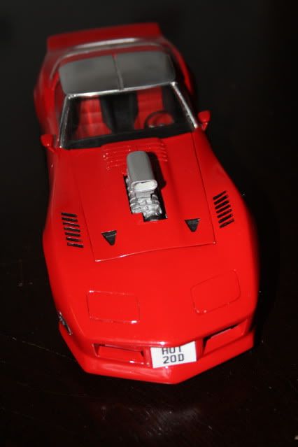

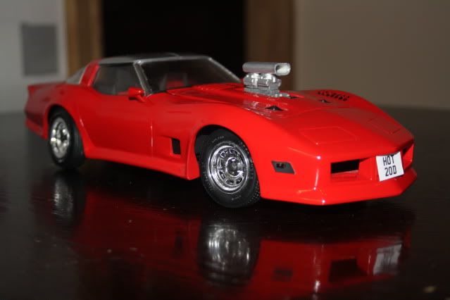

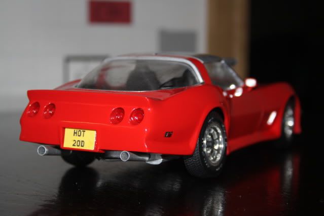

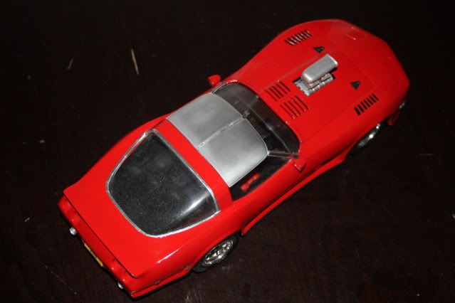

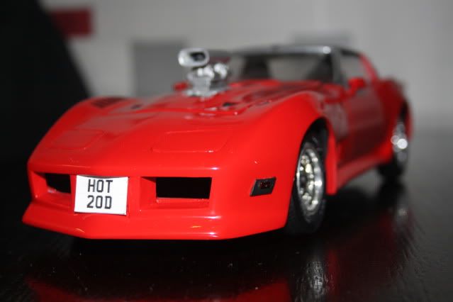

Its been a while since i updated this as ive been really busy before christmas. Over the Christmas break i decided to get on with the corvette project and aimed to get it finished in early January as i knew my free time would be taken up alot with once the FIA Race season started again.
After endless hours of filling, sanding, guide coat,primer etc etc i got a reasonable looking bodyshell ready for paint. After 5 coats of Ferrari 308 red it was then given 3 coats of clear.
The interior was flocked once it had been painted satin black and seats were painted red/black to match the real thing.
The roof was painted with enamel chrome paint but its not very good as you only have to catch it with your finger and its starts to dull. Chrome film was applied around the window pillars and rear window trim.
I didnt like the kit exhausts so i cut the tailpipe off and replaced them with 4mm ally tube.
In the end i made a master that looked close to an holley carb and made a cast from that, the scoop was taken from a cast of that from kuhl & olsen dragster kit.
I would have liked to plumb the motor but i didnt have any images of the real thing to copy and i just ran out of time as my mate was picking up 13th jan when i was down in my area of the country.

Nice work, paint looks great.

Posted 23 January 2012 - 12:56 PM
I really like the RED Paint! 3 coats of clear should be a nice base to really rub that out and have an awesome polished shine, if it hasn't been done.
I gotta ask, what technique did you use to get the vents into the front fenders? Nice touch.

Thanks for the comments, I gave it a light flat in areas where the odd dust spot had settled then polished up with a 3 stage polish kit from Meguiars that i use on my road car to give it a nice shine.
The vents in the front wings where done by cutting an hole the size i wanted for the overall vent and then i drew out a templete on paper of the required design and cut small peices of plastic strip to the right size/angle and glued them in place. Once set it was given a quick skim of filler to hide the joins.
The rear vents in the bonnet where drawn on in marker pen then i drilled an hole at each end before cutting them out with a scaple. The front vents again where cut out to shape and plastic glued to the underside to give image of deep vent.

very nicely executed , what scale is this? :huh:

Thanks, Its a 1/16th MPC kit
