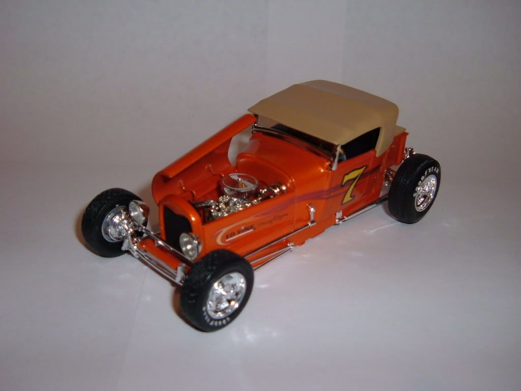

#28 E St. Kruiser50
E St. Kruiser50
  • 1,781 posts
  • Location:Oregon
  • Full Name:David Susan
Posted 28 November 2008 - 05:59 AM
yea i can wait to do it, but i think ima go with that other guy(peter?) idea, i have those little things.lol
quick question though, how did you get the doors to stay up?
Great questions :D
I hinge quite a few opening features on my projects, and have found that nearly each build presents it's own unique challanges, so I just keep designing and building until I get it right - HARDLY EVER THE FIRST TIME :lol: , so just be patient and don't give up. It's way too fun when you get it right.
Positioning the hood or trunk lid, for me is about the kind of tension I put on the bends of the brass, and not making it too tight. Practice is what it's all about, at least for me :lol:
Good Luck - Dave
Here's a couple I did. A couple of regular hinge's, and one with a double acting hinge, and the hoods are poseable in different positions.
Posted Image
Posted Image
Posted Image
