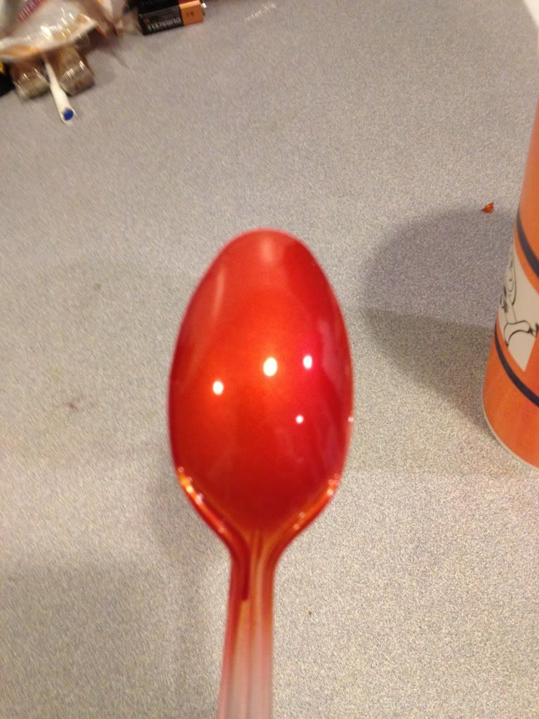

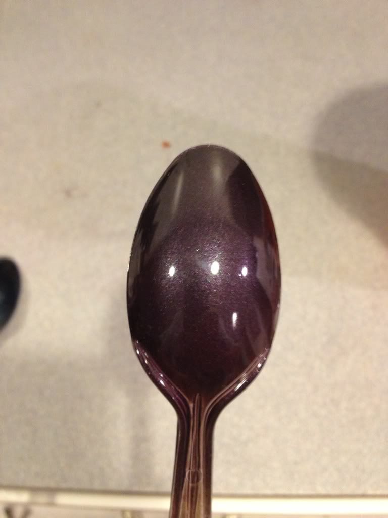

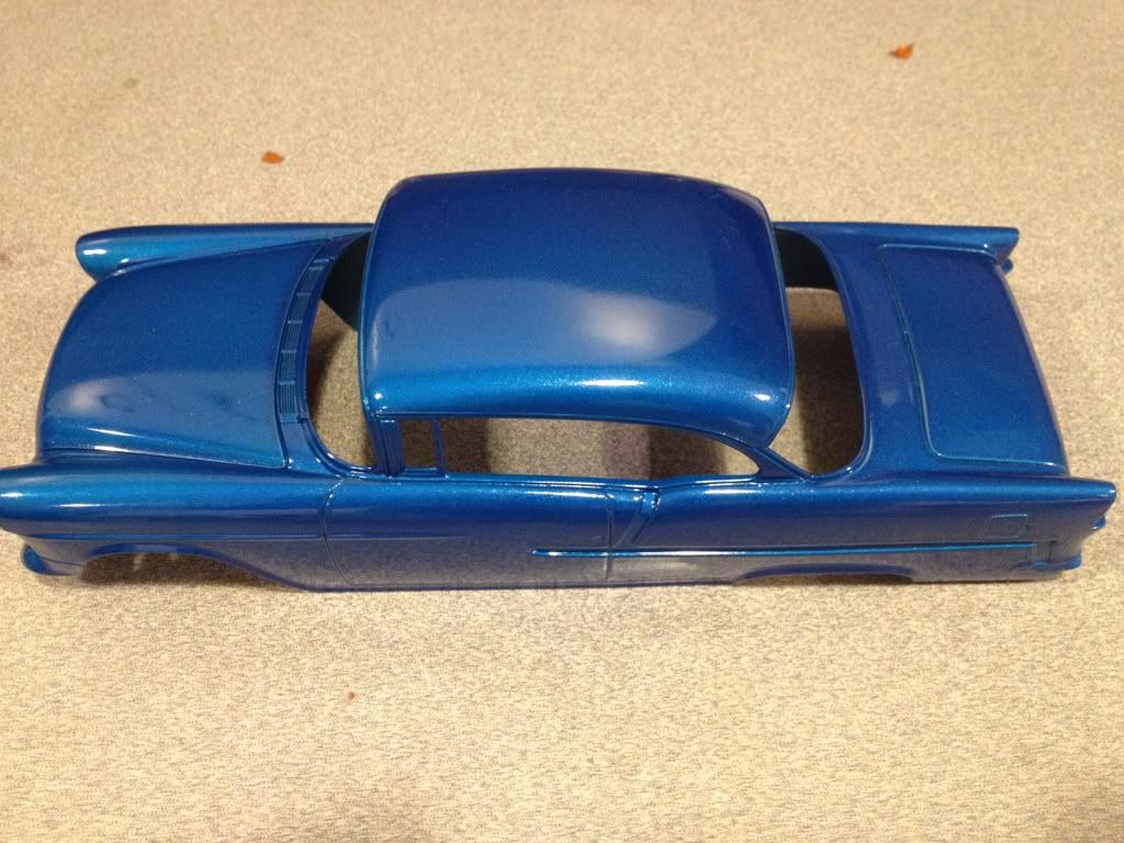

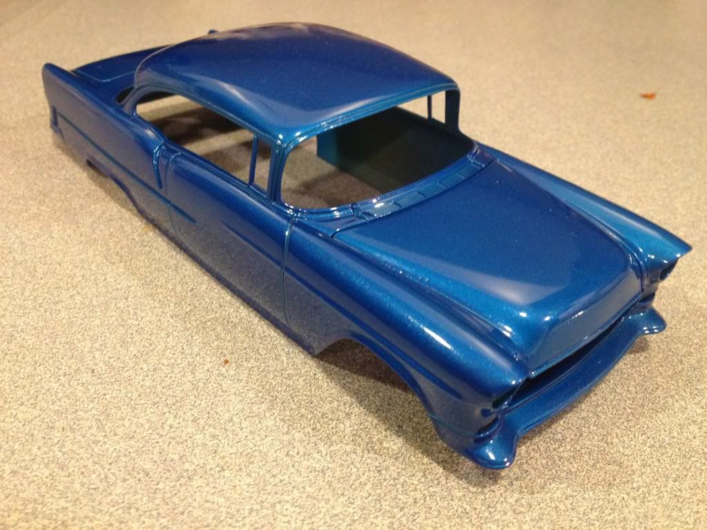

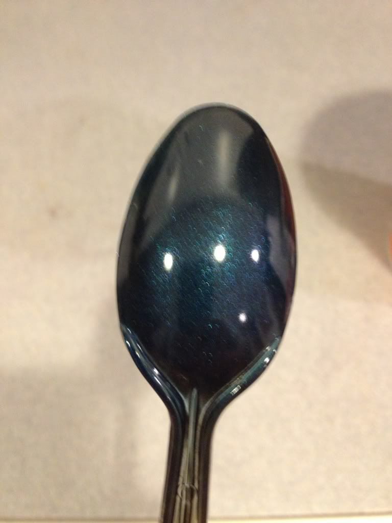

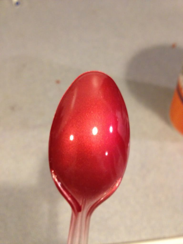

Ok here's a little trick I came across on accident. I was mixing some paints and was curious to see if I could make transparent candy colors with enamels. I took 1 jar of color, 1 jar of clear, and 1 jar of laquer thinner and so fr pretty happy with the results
Posted Image
Posted Image
Posted Image
Posted Image
Posted Image
Posted Image
The 55 is pearl blue over silver and I also did the purple and blue over black, the red is over silver and another one over gold.
