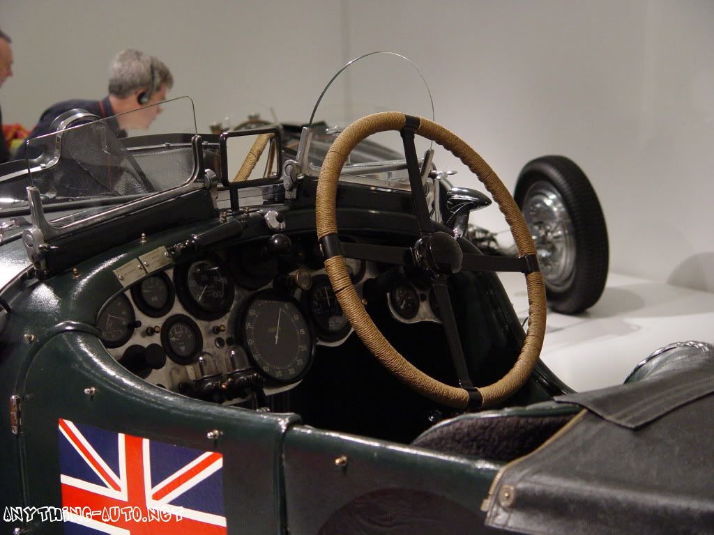

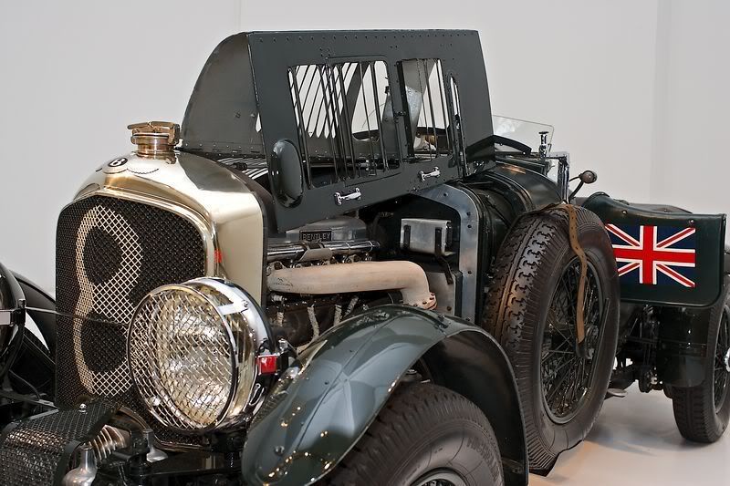

A bit more:
This is one of the 4 other of the Lauren car's sister cars built for the Birkin team. A few minor differences. I recommend adding the wheel weight cylinders (I made them from the kit's sprue bits).
Posted Image
This is the Lauren car's cockpit. You'll notice at the top center of the dash a knob that is shaped like an awl and has a coil spring around the shaft under the knob. This is for priming the gas. The steering wheel is wrapped in cord, like most of the Birkin Bentleys. And the aft-facing side of the seat back is carpet/fabric, not leather. You will also notice that Lauren's restoration has a semi-gloss finish to the painted fabric part of the body shell - it's not as flat as might be expected, or as I painted my kit. Also, Lauren has added a removable gray carpet on top of the aluminum floorboard. There are two horizontally mounted black cylinders just above the dash on the fabric cowling; these are map lights. In this shot, you will also see that the mesh stone guard in front of the windscreens is much finer than any of the other mesh. I recommend using a replacement coffee filter.
Posted Image
Posted Image
Regarding the kit, you've probably seen that the gauge faces are totally black. This is because the dials are on the other side of the decal, which is to be applied on the back side of the clear gauge lens part of the kit. You may want to make your own gauge lenses to get rid of the sink marks in the kit plastic.
The other side of the engine.
Posted Image
Another Blower Bentley. Note the cross-bracing between the firewall and the cowling. This car is painted closer to British Racing Green, whereas the Lauren car appears to be the sort of dark olive that was used on the Jaguar SS 100.
Posted Image
At this point, I would turn over any further questions to Harry, who knows even more detail than I do.

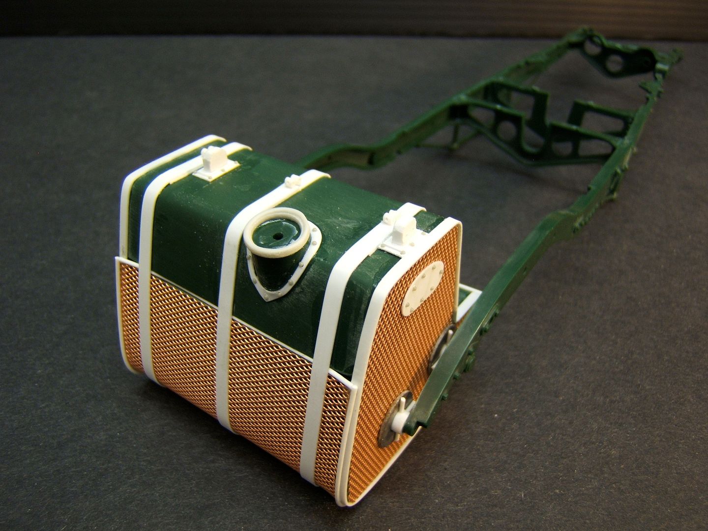

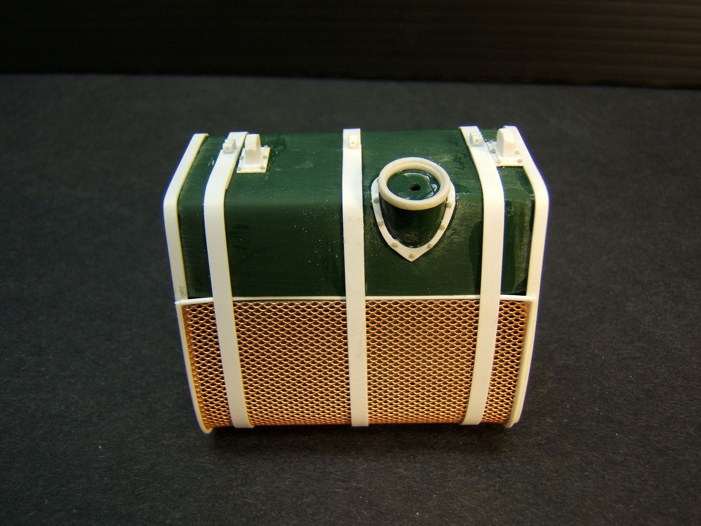

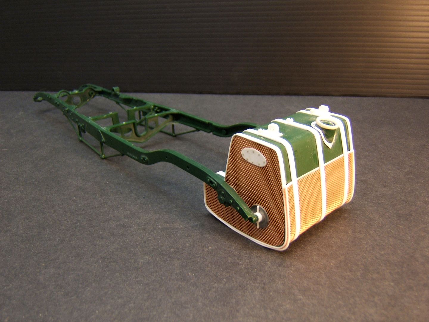

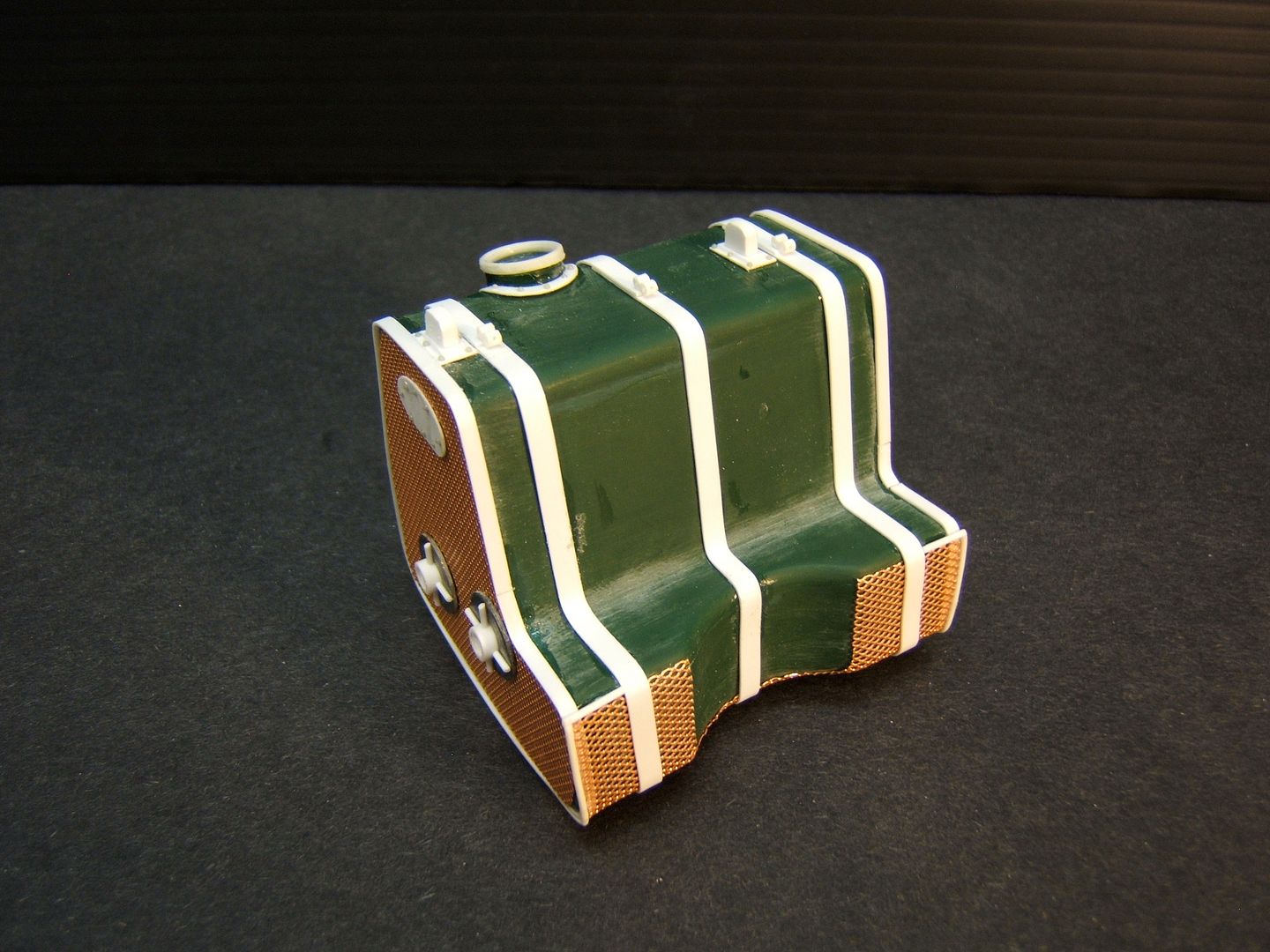

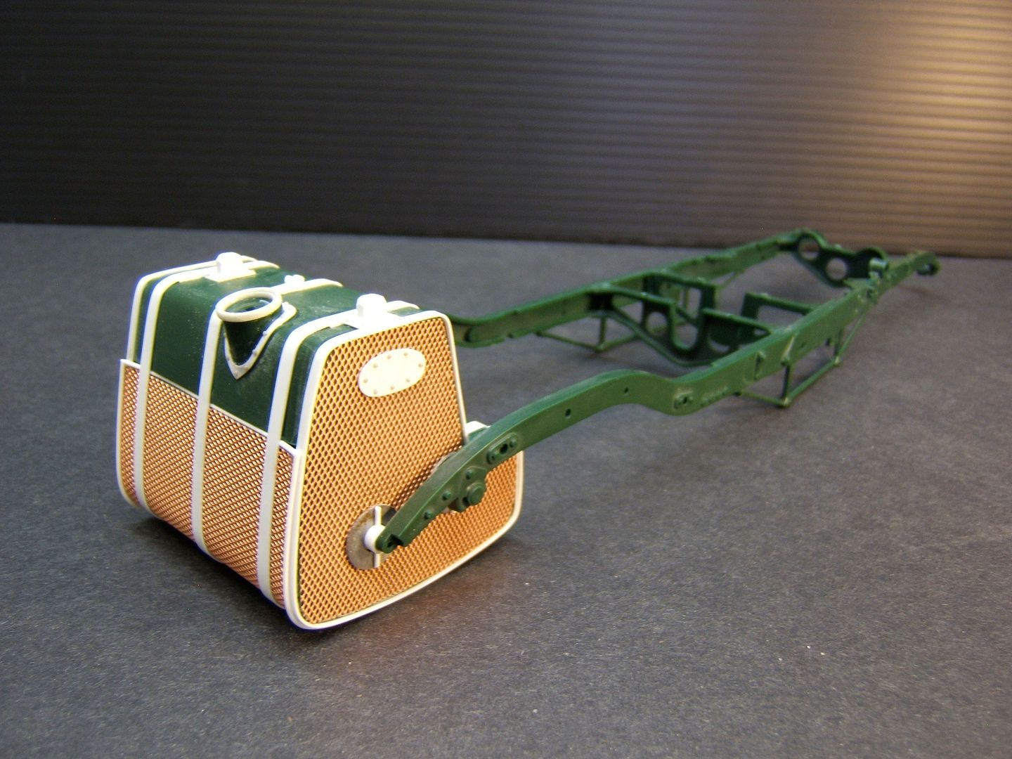

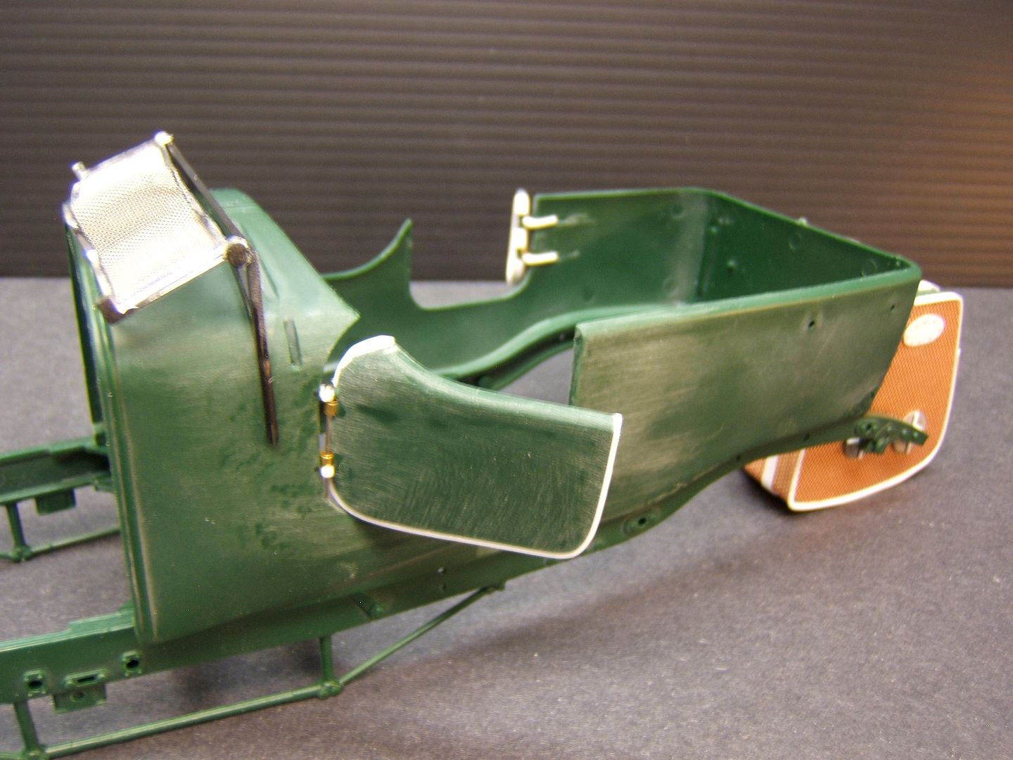

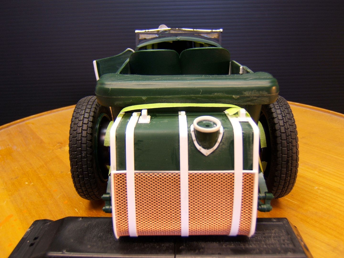

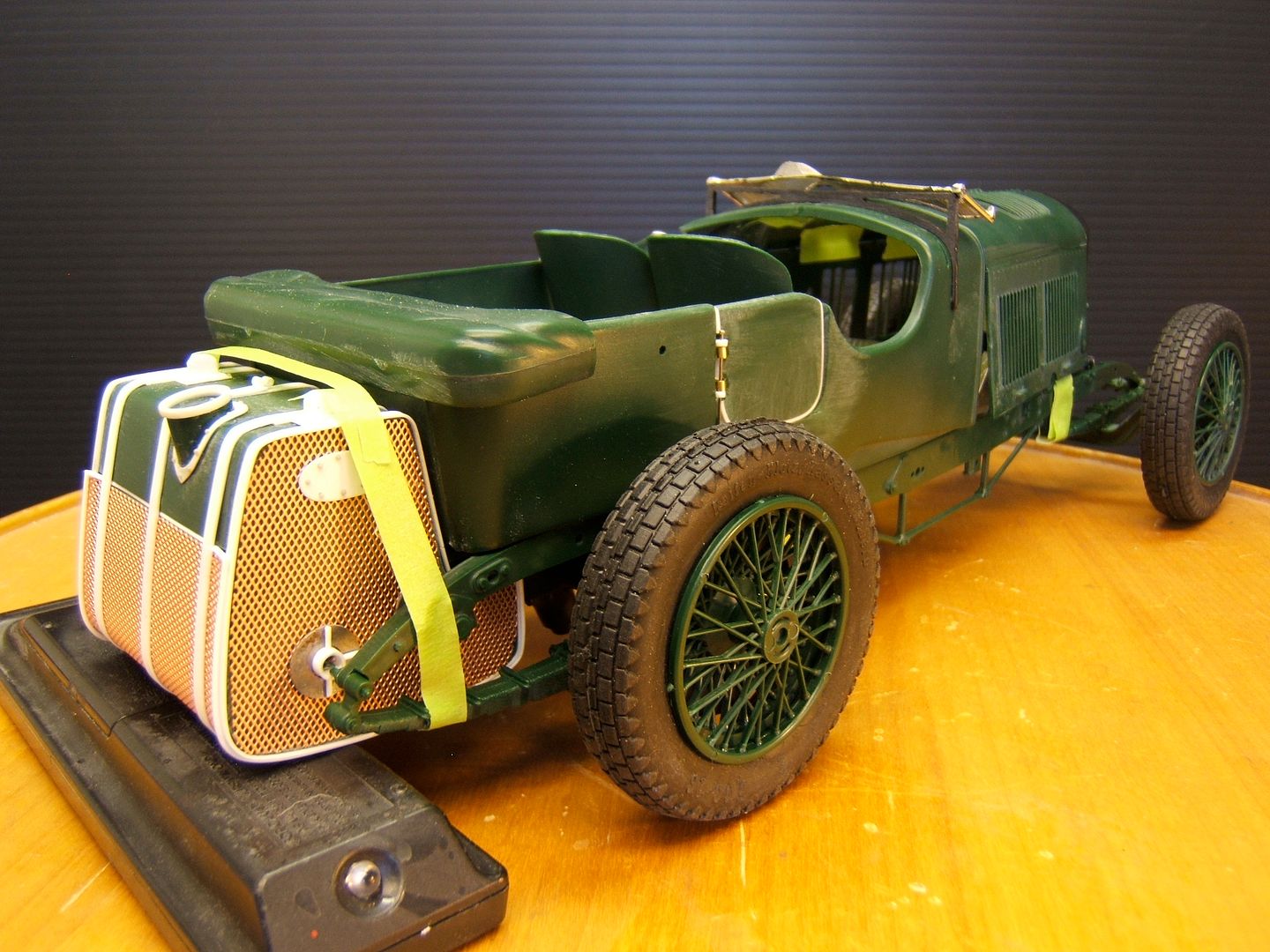

Hello.......I got the gas tank finished in the rough.......I got some mesh fitted for the window screen......the frame is glued together.......I will hinge the door`s tomorrow.......thank you all for the pictures and the kind comment`s........and for looking.

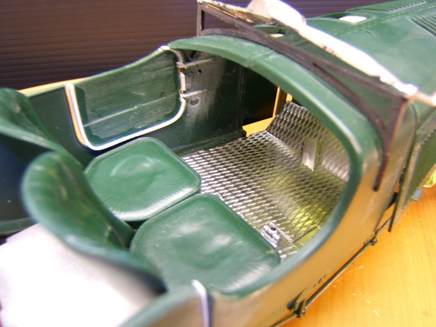

few more progress photo`s......thank`s

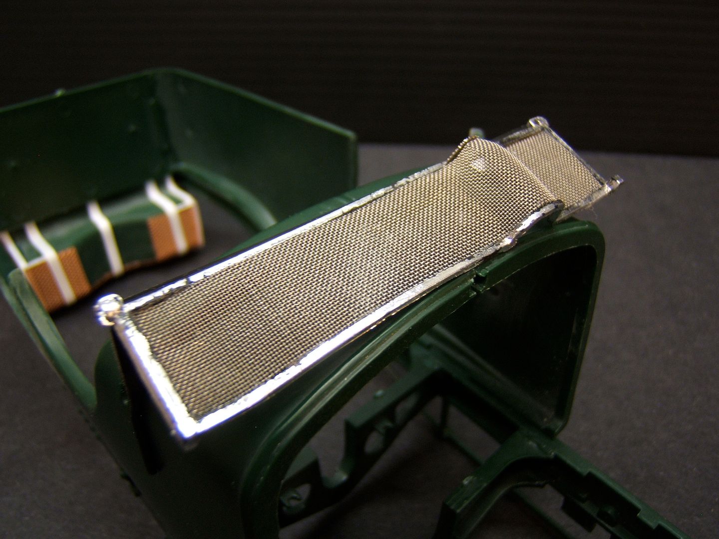

That's looking great, John! Awesome detailing on te fuel tank. My only nit-picking comment is that I would seriously consider some different mesh for the windscreen guard, as Skip suggests - you're supposed to be able to see through it when it's up... it's not armour!

Although probably not stock, consider boxing the inner frame rails like a race car. This model gets very flimsy while gaining weight. And those fender attachments will require ingenuity.

Yes, someone with John's skill could replace the very fragile and flimsy fender struts and headlight brackets with stronger material. The cleaning lady snapped off three of my Bentley's fenders when lifting it to dust the bookshelf.

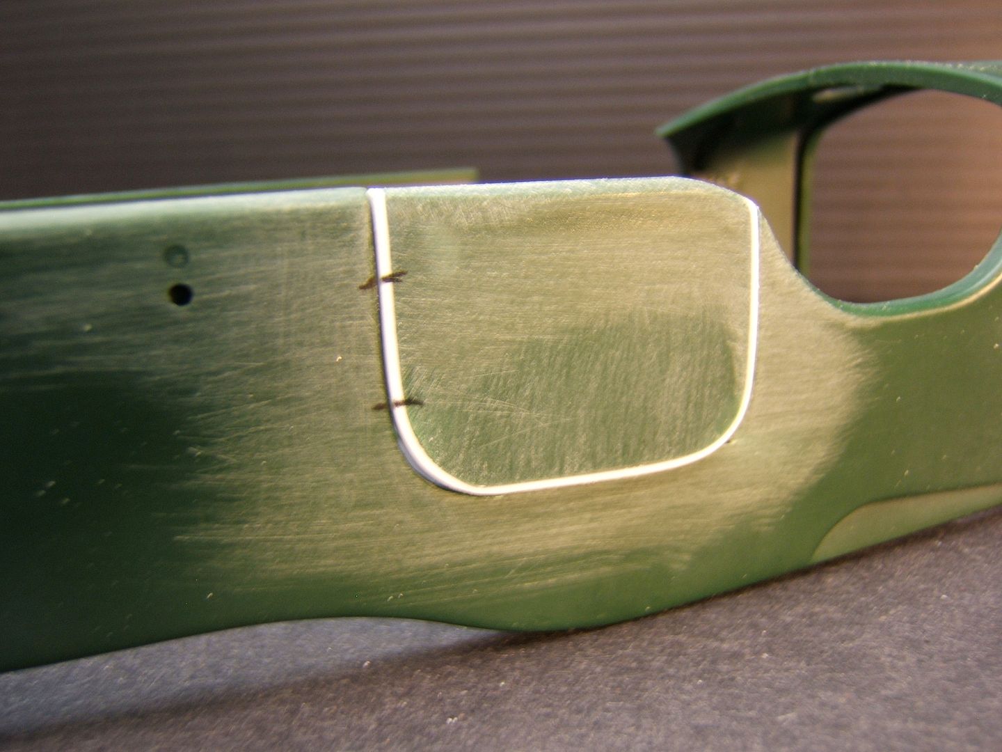

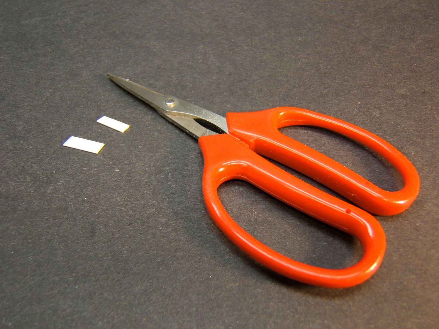

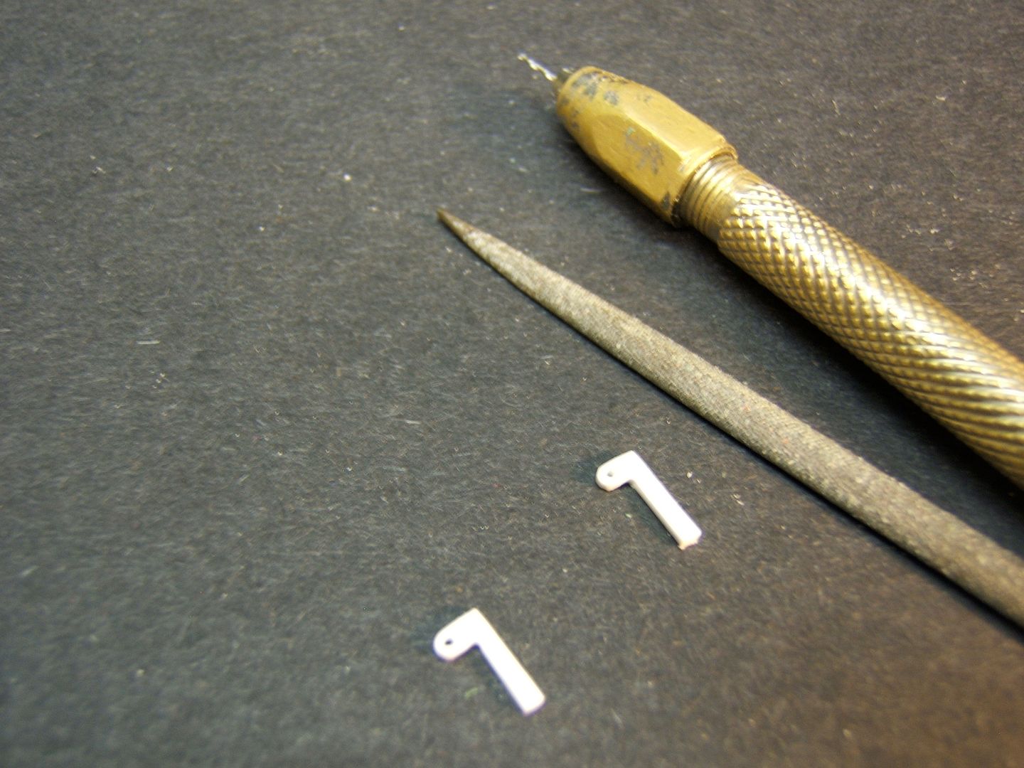

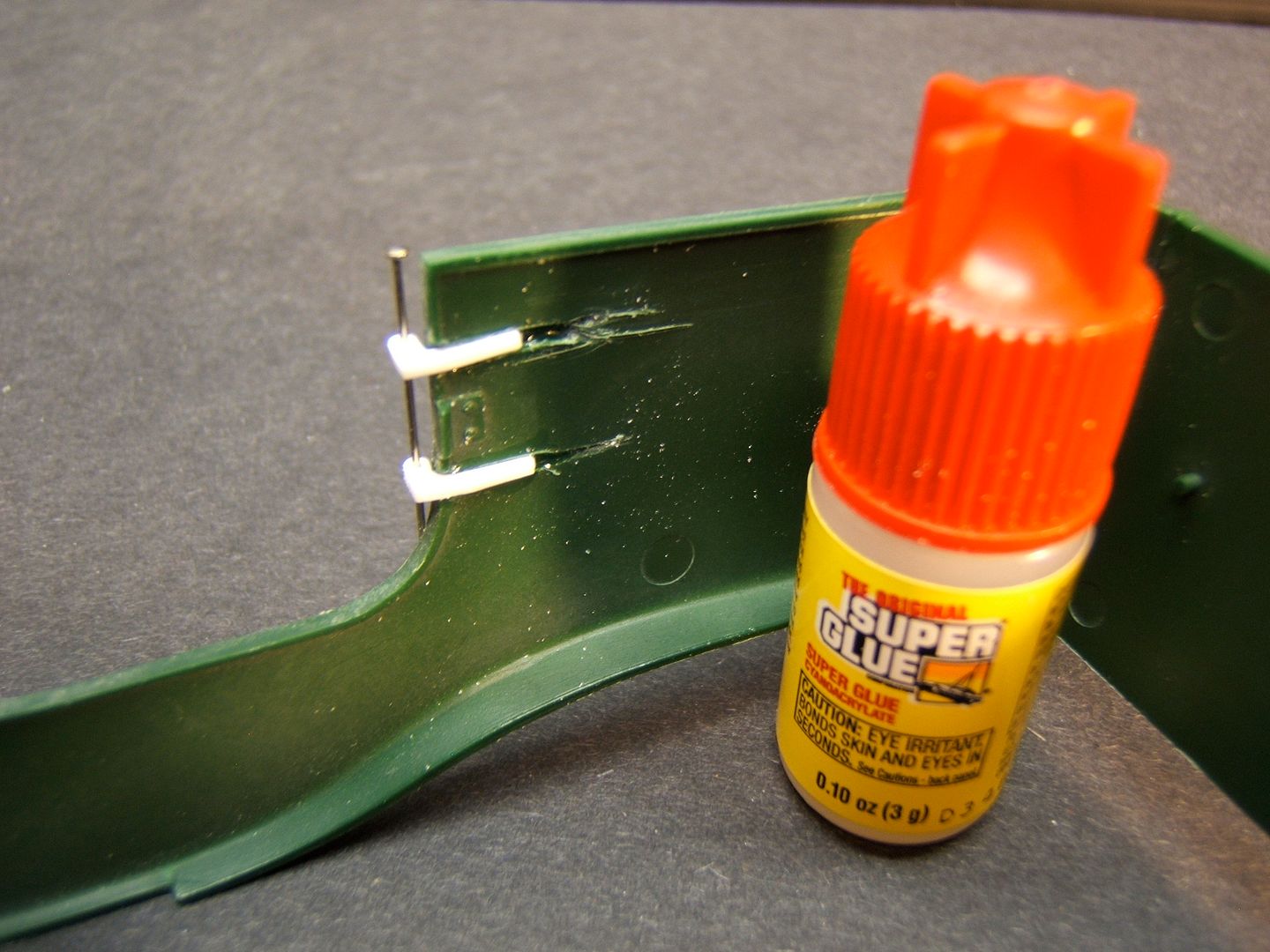

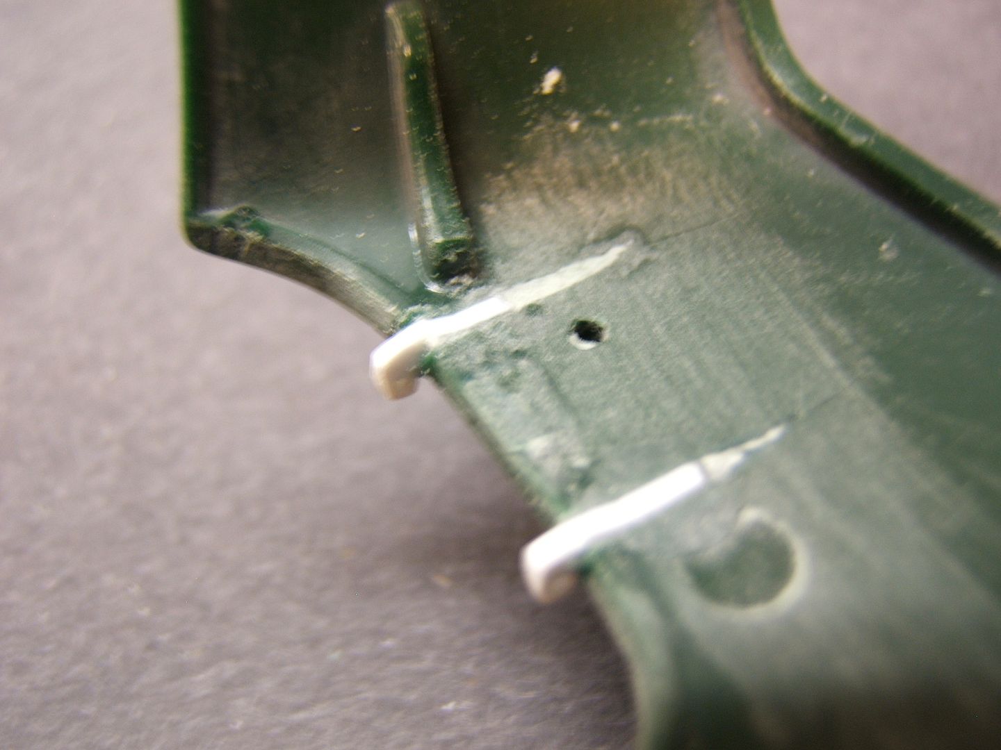

Posted 01 December 2011 - 12:07 PM

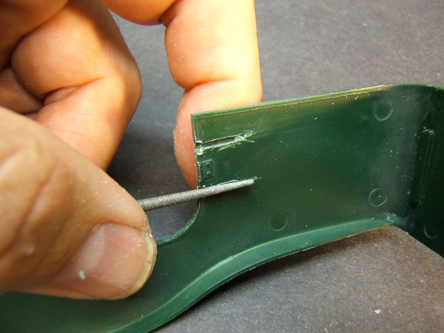

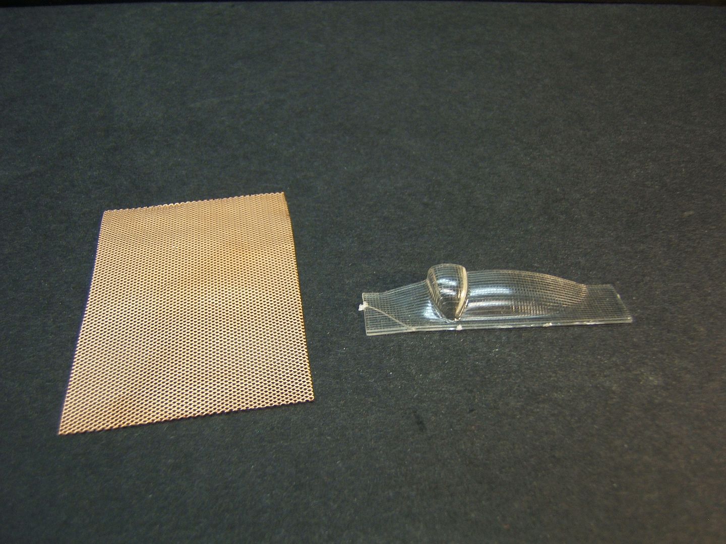

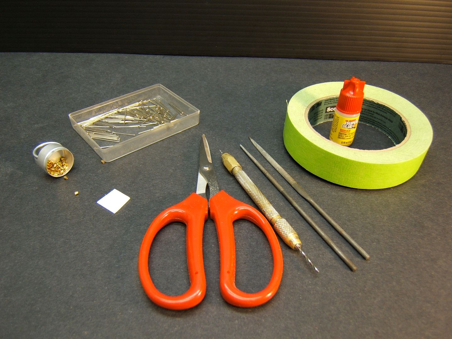

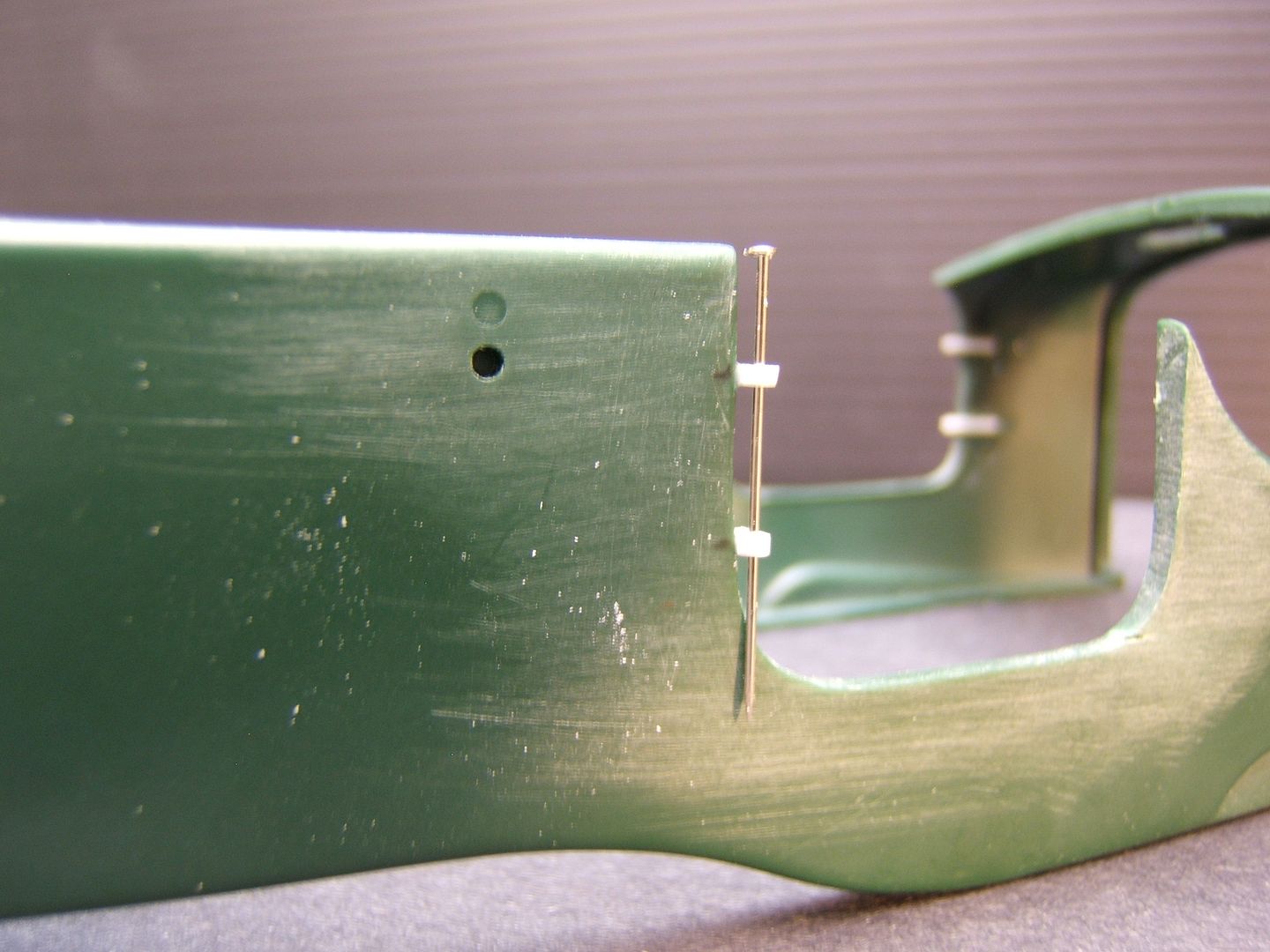

Hello.......after Matt had mentioned that the mesh on my windshield looked like armour.......I too, thought it didn`t look right......so I changed it and used some of Greg Wann`s screen that he gave me.......hope it look`s better?.......thank`s Matt and Greg........I hinged the door`s...... they are in the rough I need to fiil in the gap`s and make door panel`s ,handles and lock`s.......a few people had asked how I hinged my door`s on my 'Star Of India" Roll`s.......well I am no expert but,I posted pictures to show how I do it......thank`s for looking.

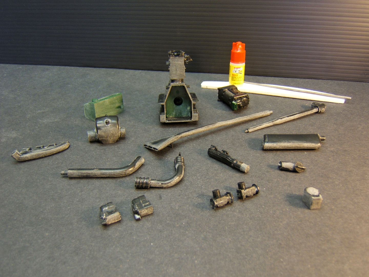

Posted 01 December 2011 - 12:09 PM
