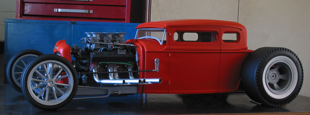

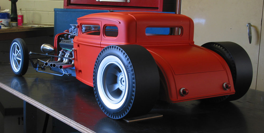

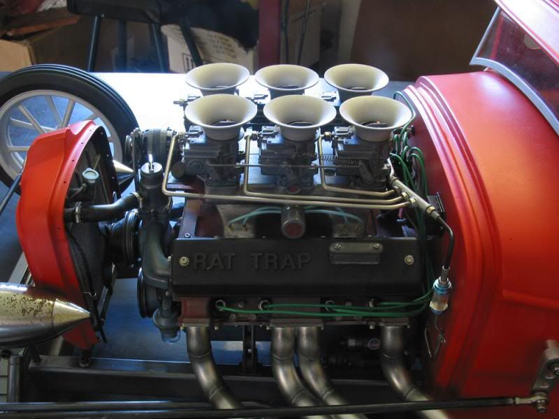

I guess I might as well make my first post a big one (1/4 scale). Here are some photos of my almost finished model. I still have a few parts and weathering to do.
Most techniques have been used in this one: styrene sheet (body), 3D printing (wheels and rear tire walls), and steel and alloy for the frame and suspension.

First off welcome to the forum...
Now that is cool, chopped and channeled 32. Just amazing work and even in 1/4 scale... Great work!

Your Hot Rod looks... Amazing! That detailing on the engine is incredible, and overall look is very sharp too. Wheel and tire choice is just perfect. Nice build all in all, thanks for sharing it.

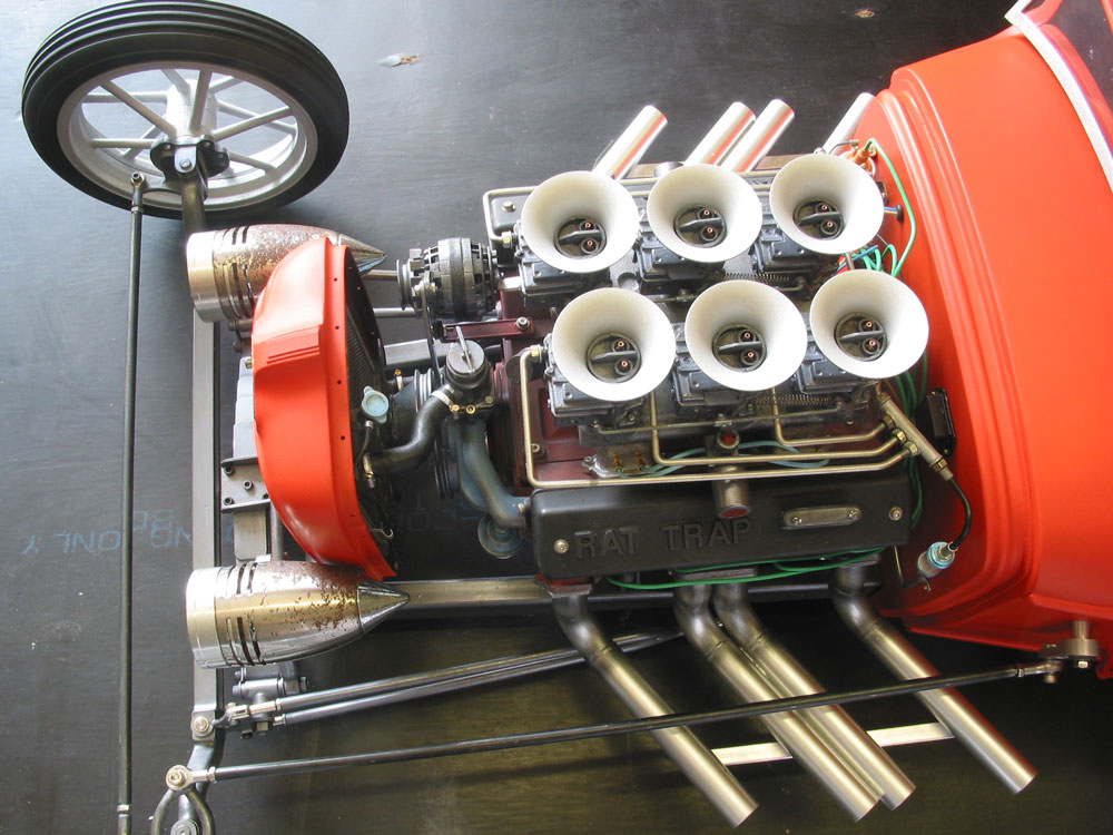

Wow is all I can say. That's a fantastic build, David. I love the clear glass fuel filter and the weld detail on each header pipe.

Thanks for replies, here are some more photos of build. I have about a week's work on another job before I can finish the model.
Some parts are just placed at the moment.

I love the stance, the look. its got the perfect ride height and chop. The detail blows me away on this. Very nice job on this one. I look forward to seeing some more of your builds.

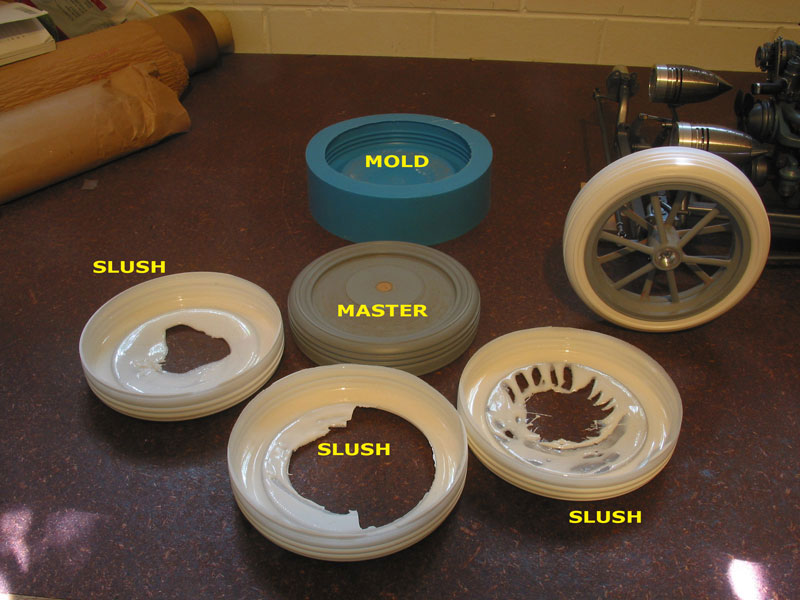

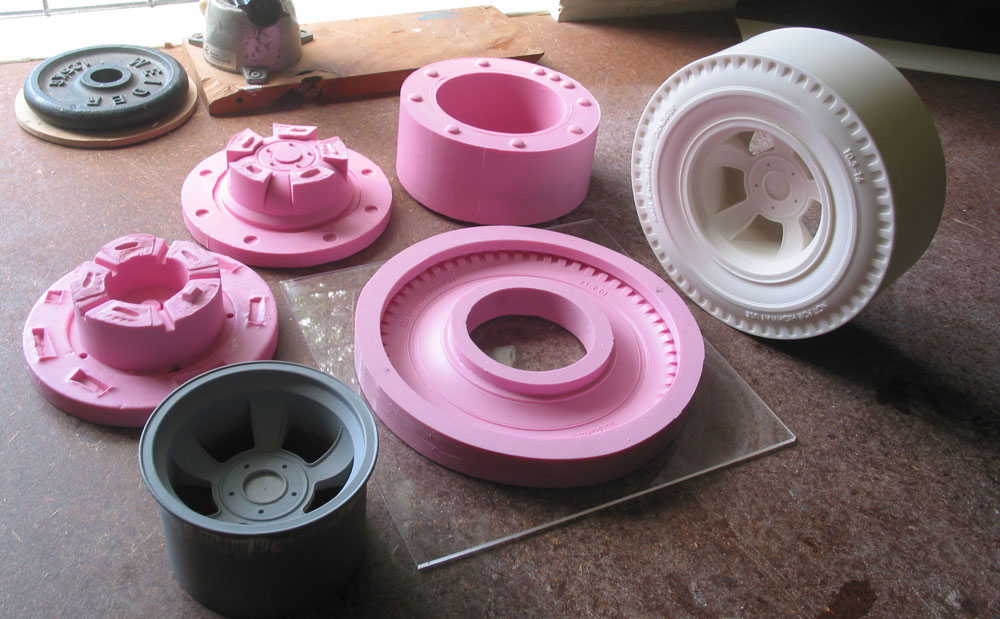

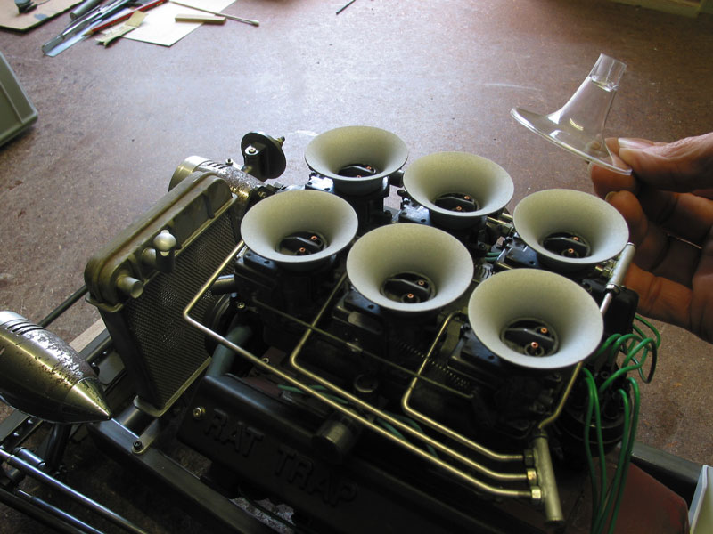

@ Mr.1/16th, Almost all of the 1/4 scale parts had to be scratch built.
The engine block is from the Visible V8 kit with a few additions like head bolts and details in the casting.
I doctored a carburetor , molded, and cast 6 off. Venturis are made from plastic wine glass stems. The wheels and tires
are a combination of turned masters, 3D modeling and printing, and mold-cast techniques.
Here are a few construction photos.
