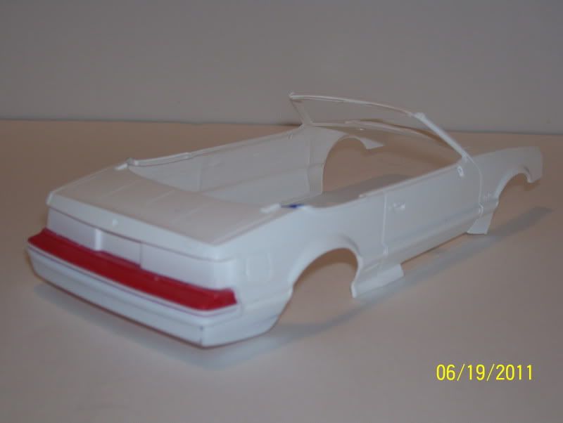

Well, to start this I decided I needed a body. The only body available was a convertible Mustang GT minus the engine bay, or under hood area.
1 of these bodies had a rear bumper,the other one did not. Since I would be replacing the rear bumper anyway I chose to go with the body that had no rear bumper.
To prepare I cut off all the useable pieces from the 79 Pace car, such as the hatch, and sail panels. (Might need those later!)
I used the top of the rear bumper from the 83 GLX carcass and grafted that to the GT body.
Posted Image
After I had the top of the bumper in place, I trimmed the GT side panel from the rear of the convertible.
I then made the lower portion of the body and rear bumper from styrene strip.
To complete the look, I sanded down the older molding from the 83 bumper and then I made the Gt bumper molding from styrene strips, as well.

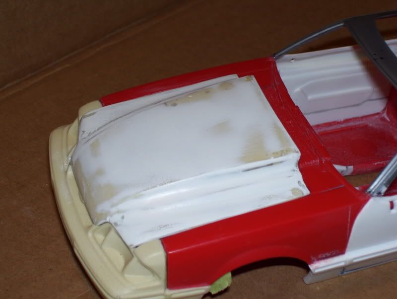

The body needs an engine compartment, unfortunately all of the one's I had were the wrong year. how to fix that? Move the battery to the trunk!
Posted Image
By carefully trimming out the battery and overflow tanks I can "up-date" the engine compartment to ambiguity (sp?) LOL
This is actually a fairly common modification to these year Mustangs, so I don't feel this is at all out of line.
And in any event, I can always get a resin battery for under the hood if needed.

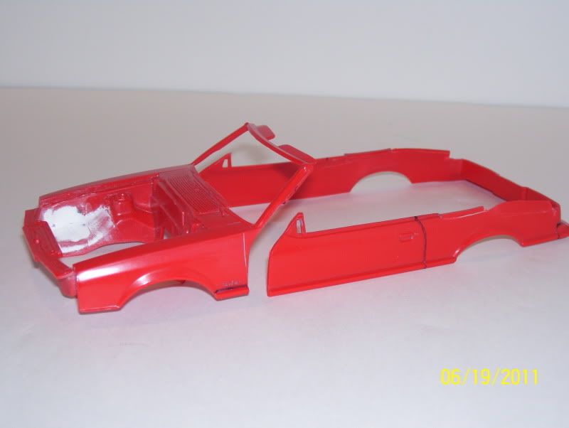

Next we attach the new engine compartment...
Posted Image
While I didn't NEED to use the whole front clip, I thought I would be better off using the whole front clip, for ease of attachment without loosing detail.
I was wrong. The 83 GLX body had a BAD warp, which was why it was all cut up, and I knew about it, but I thought it was from the door back. WRONG!
Oh well life goes on.

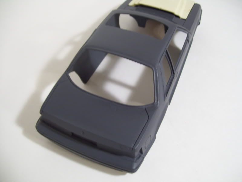

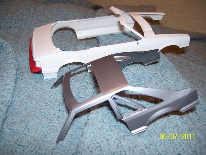

Well anyway so I had previously prepared the Pace car roof by scribing off the hatch, and carefully removing the sail panels,
in case I wished to use them later.
Posted Image

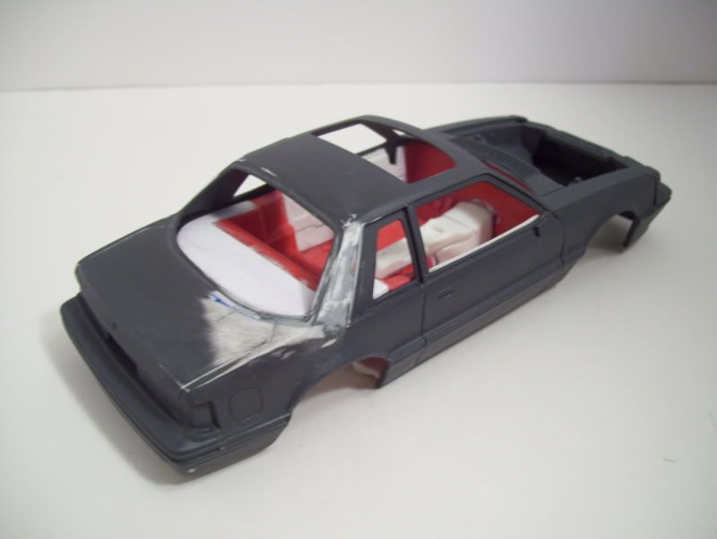

Now I filled in the holes left by the sailpanels, with card stock (an old gift card!) .
Then I made some cursory measurements...
Posted Image
Posted Image
It was at this point, that I also replaced the lower door panels and attached the new roof...
Posted Image

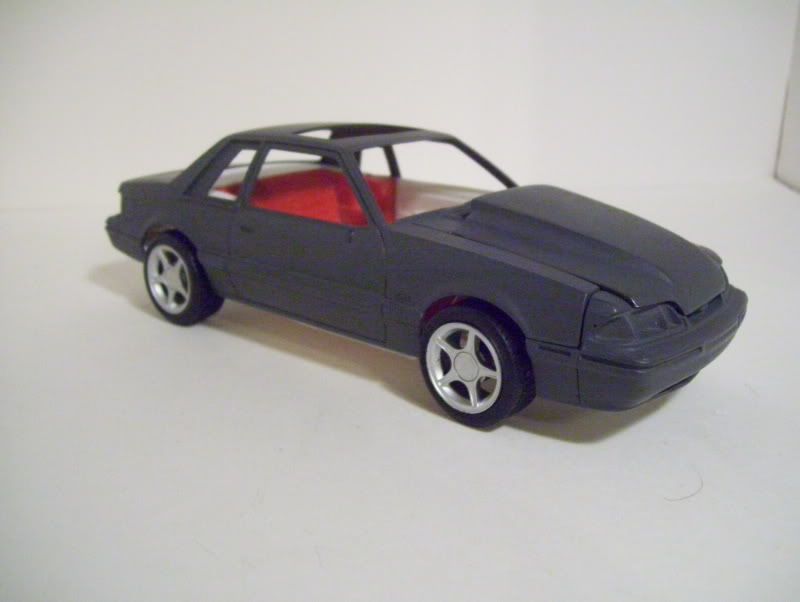

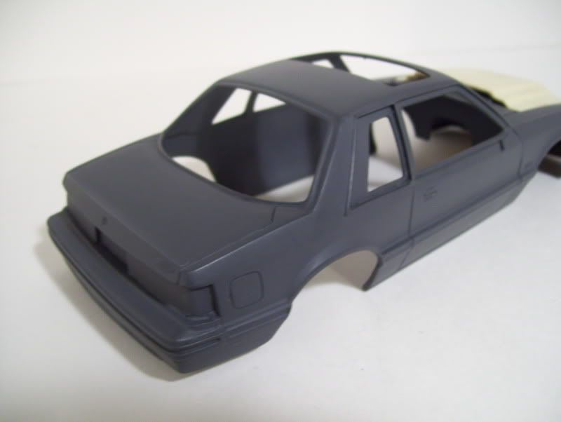

Once the roof was on, I decided it needed a hood. So I took three goobered resin hoods, cut them up and made this one...
Posted Image

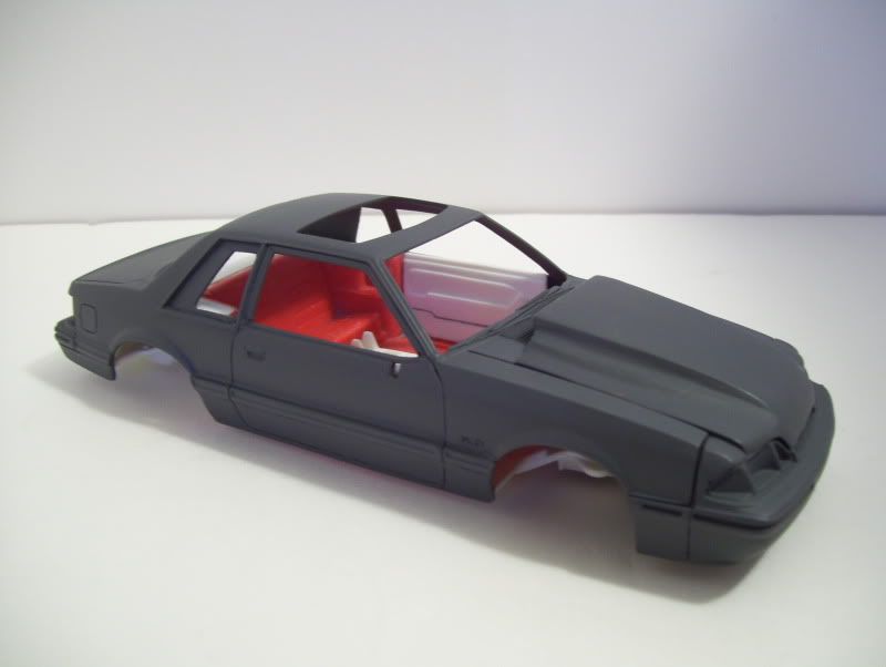

With the hood and body made I needed an interior tub for it.
Since I had used the older front clip, the newer interior tubs would not work, due to different mounting locations.
So I had to make a new interior tub that used the old mounting points...
Posted Image

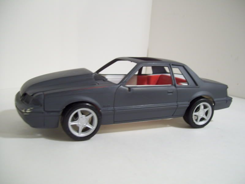

Now we can primer it and see what's left...
Posted Image
Oops forgot to make taillghts...
Posted Image

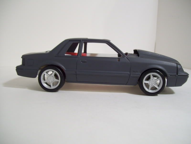

And this is approximately were it sits today.
Thoughts on colors, wheels, etc?
