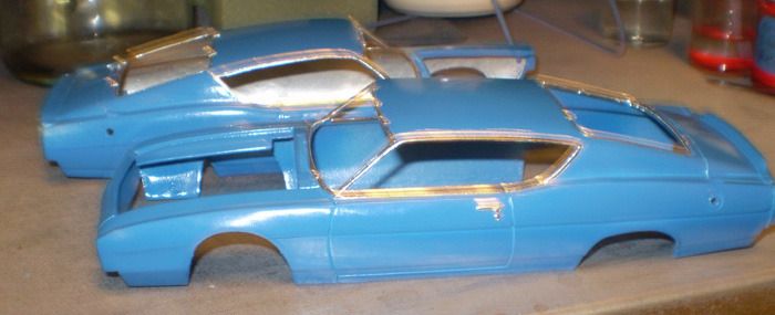

Okay, both bodies have now had the BMF done to 'em! Yay! That part's over! I can honestly say that putting BMF on a car is not one of my favorite things to do. Well, here's a shot of the two cars - forgive the weird picture - it has some sorta weird "ghosting" thing going on:
Posted Image

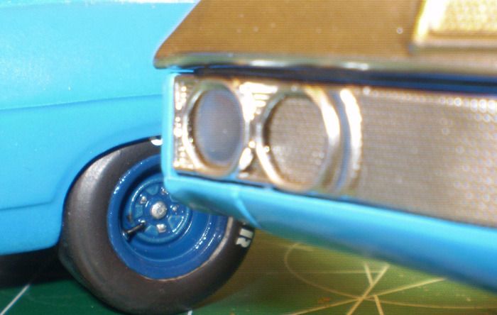

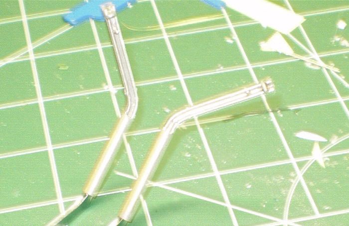

I was also finishing up some work on the chassis for both and got ready to put in the exhaust pipes. I was expecting garbage from the AMT kit (and it pretty much was), but the Talladega kit surprised me - those exhaust pipes are only 2/3 pipes all the way down to the end - you then get just a round cap on the end. Well, that was not going to do. So I took the stock pipes and cut them just after they bend to head out. I then took some copper pipe and pushed that into the ends of the stock pipes. When it was all done, I painted it in Testor's Steel color. Here's how they looked while drying - note that you can still see that the part of the pipes really is only about 2/3 around:
Posted Image
When they were all dry, I was able to put them on. Boy! What a difference that makes! This is so much better than the stock pipes!

Pipes look great! I don't remember the Talladega having that much chrome around the windows, but maybe it's the picture like you said.

yeah - it's the picture - it seems to have doubled all the silver in the picture and made a ghost image - look at the door handle or the rear window to see what I mean - it's not really that thick

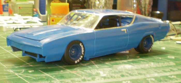

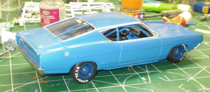

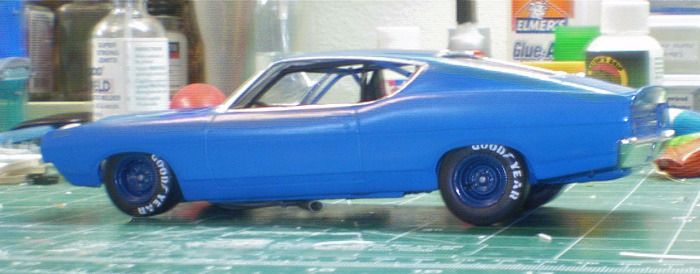

Well, I finally finished touching up everything on the chassis for both cars, so it was time to mount the bodies. Can I get a Woo hoo? He he he

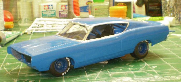

Anyway, first up is the Torino. When I first set the body on, the front end sat up way too high. When I made the adjustment for where the wheels mount, I thought I had it right, but I ended up making the front end a tad too low. Well, this has been a learning experience for me, so I will just chalk this one up to a learning experience. Here's the Torino:
Posted Image
Posted Image
Then I started on the Talladega. I brought the back end down a touch so it wasn't quite so high. Overall, I think this one "sits" a little better since I made my adjustment. Here's the Talladega:
Posted Image
Posted Image

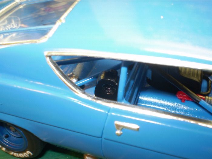

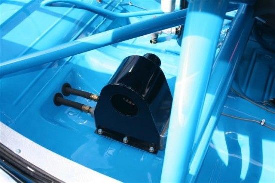

Finally, I wanted to show how that rear end cooler ended up working out for me. It took some working and a few shots, but I actually did get a decent picture of the part in the car. Remember this was not only my first time casting anything in resin, but this was also the first part that I actually made the master for. As a reminder, here's a shot of the actual rear end cooler I was trying to replicate, followed by a picture of the finished product in the car:
Posted Image
Posted Image

I am very impressed with how you corrected the front end on the Talladega, you got it perfect. This make me want to get started on the one I've been putting off.
The Torino might look better if the rear was a tad lower, the Talladega looks great as is. And the chrome looks MUCH better in these pictures, lol!

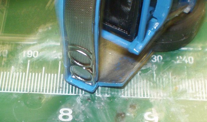

As I was putting the grills and bumpers on, I noticed that the grill for the Talladega was inset much like the Torino's grill. Here's a picture of what I mean:
Posted Image
Well, the whole purpose of the Talladega's nose job was to make it more aerodynamic and flush. Having an inset grill just won't do. I had to get that grill more flush with the rest of the front of the car. So I cut a few strips of sheet styrene and used that as a shim to move the grill up. It's much better now and just about even:
Posted Image

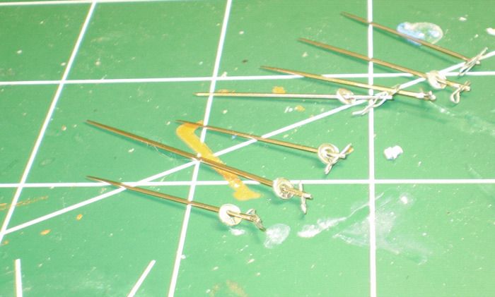

These cars will have hood pins on them, and not the molded on hood pins that came on the cars - nope!! As you can see, I've been working on making them with sequins, needles, and wire. For how I do the working hood pins, please refer to my previous build of the '64 Petty Belvedere - I'm not going to go into it here.

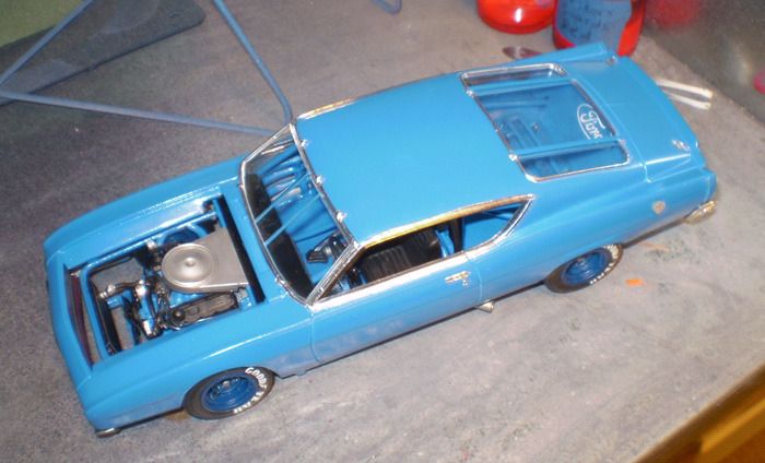

Well, I repainted the roof of the Talladega. Of course, this is going to put off finishing this up as I want to allow time for the enamel to dry and gas out. He he - you can see the hunk of skin covering the distributor - yep, I painted it to match the distributor cap and wires. Note: I still need to add the piece that fits over the radiator up to the front end. Here's the fixed roof:

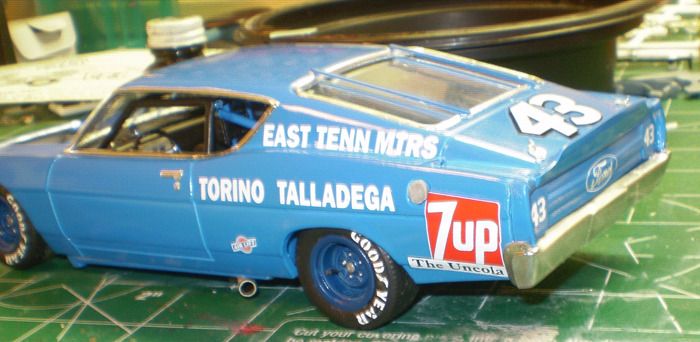

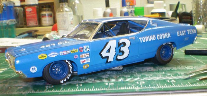

I did get the decals on half of the Torino - I realize that the sponsor decals on the front are not correct for any race. Consider this just an interpretation of what it could have been like and not an exact representation. I hate doing something 100% accurate because no matter how hard you try, there is always something that was missed, done wrong, or completely forgotten. This should be fun and not stress-inducing.
Posted Image

Looks good, nice interpretation and execution
