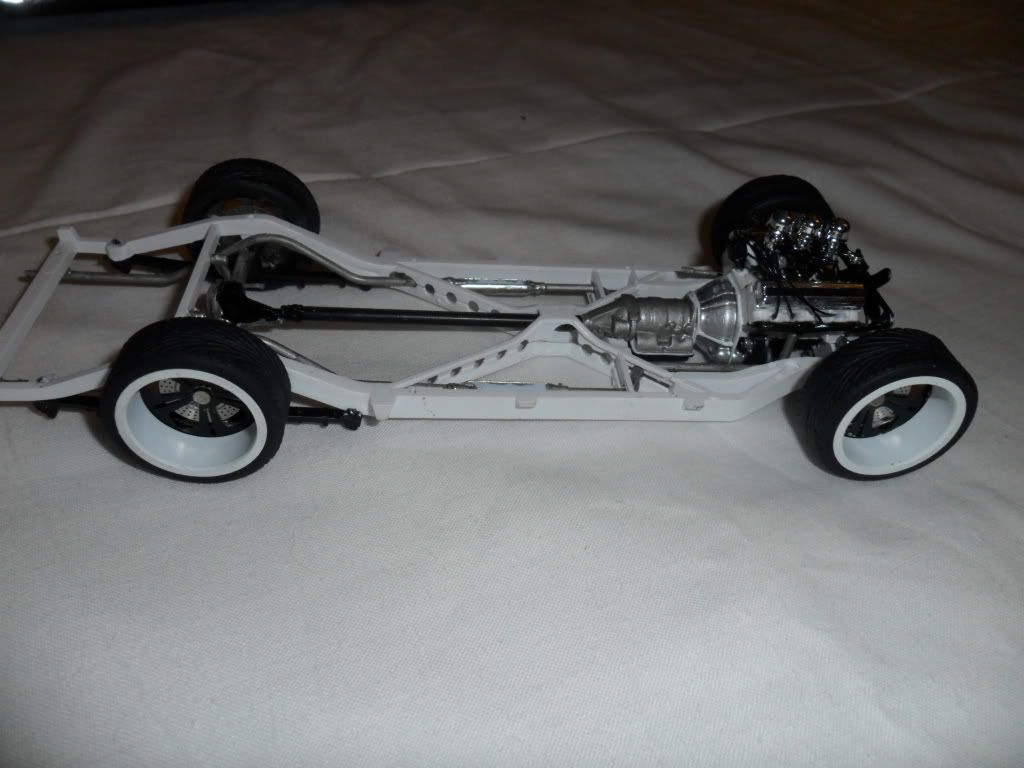

i have a buddy that dose some killer air brush work so i ask him what paint is he using . he told he he using wicked colors water base paint . so i order some and trying it out . i love it now so far im working on a 49 merc so this is what i did with this paint every thing in this pics is using the new paint i plan to paint the body in this paint and using there pearl

i love it but it fisheyes too much no matter how much i clean, whats the trick to it
What are you using to clean with?
I use a 50/50 mix of distiled water and isopropyl alcohol. Works great and I've neve had a problem.

also check for moisture in the line.
it's really good paint

this is what in using bulldog adhesion promoter. then primer and then sand. spray a mist coat of the water base paint. weight five mins the spray one more mist coat .then spry a light coat and it good .but im all so spray bout a foot a why. it spraying water so take your time
Why the promoter?

Why the promoter?
i found use the promoter help a lot when i spray auto primer to stick a lot better to the plastic parts . that what body shop use when they paint plastic parts .
