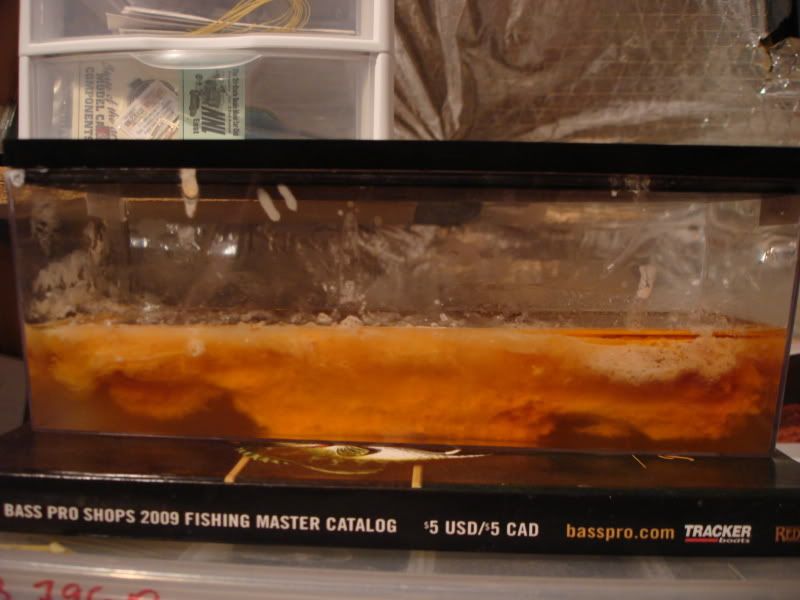

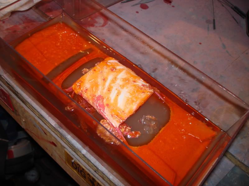

I use the dissolver also, works great and the best part of it..... you still see the shape of the car when your'e done as a keepsake!!!! :unsure: :unsure:
Posted Image
Posted Image
Posted Image
By the way, that is two bottles of the stuff in there, the smaller the container, the least bottles you need to purchase even though this stuff is pretty cheap at any Wal-Mart.
