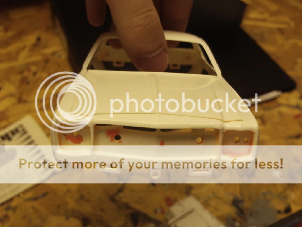

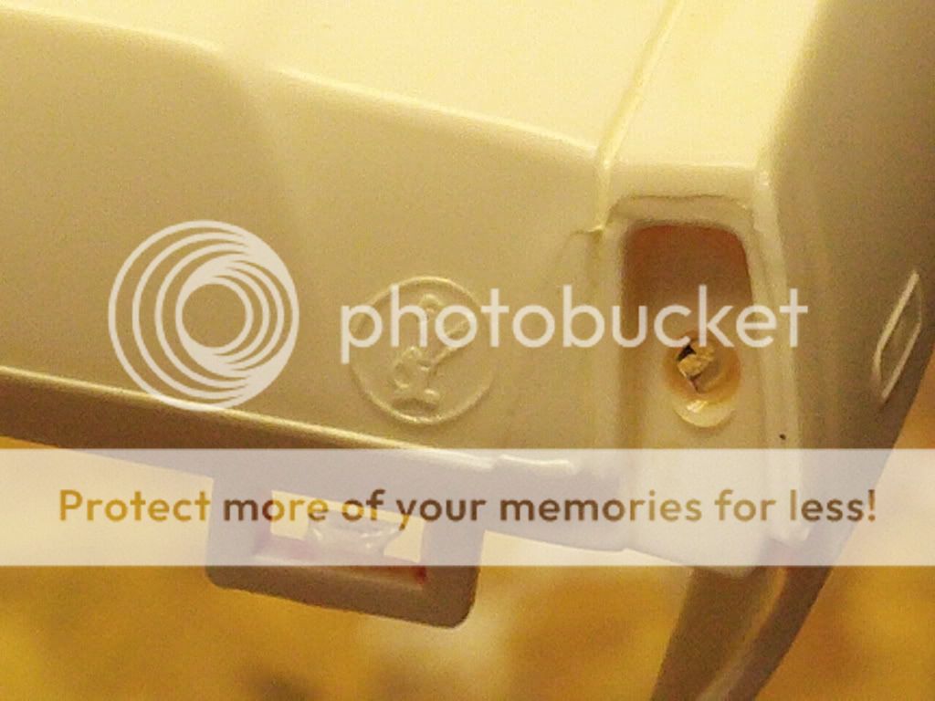

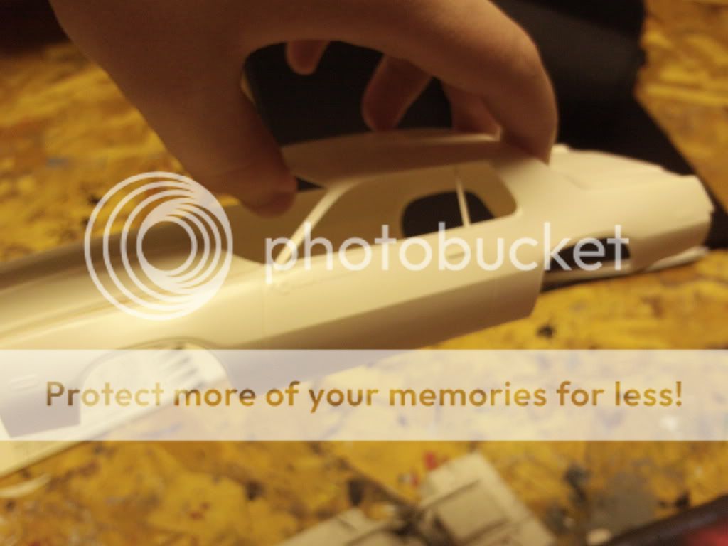

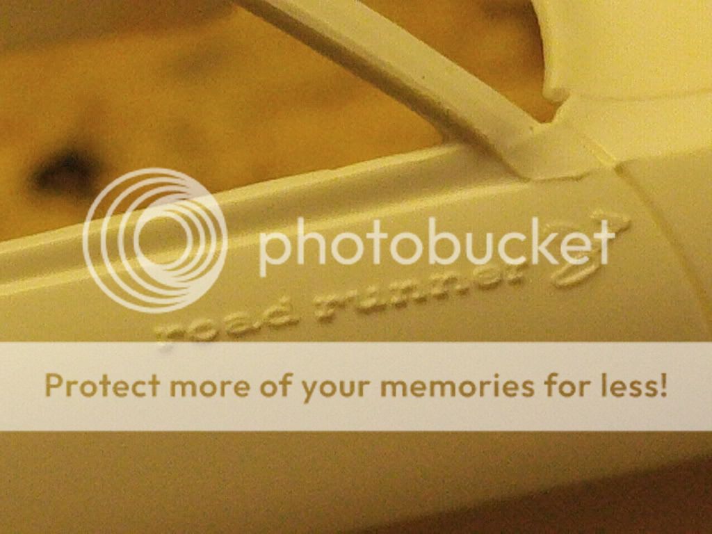

Really awesome stuff!!! I find it works much faster and is safer than DOT-3. Had a '70 camaro kit that was missing the body, but then I realized I had one from a junk build many years ago.
So I found the oldie camaro body that was painted with Colorplace Kelly Green n the bare body that crazed badly, then cleared with Krylon Krystal Krappy Klear and made things worse. So I let it sit in the purple bath for a day or so, and the body was gray plastic again with no damage to it whatsoever from the paint!
I've soaked bodys in the Purple pond that were painted with Testors, Tamiya, Rustoluem, Valspar, Dutchboy, Sears Primer, and Colorplace paints and they came off very quickly with no ill effects at all (even takes off bottle painted material no prob).
This is a very good alternitive to Easy off oven cleaner, which I don't like using as a paint stripper because it's smells AWFULL!! and dosen't work as well as DOT-3 and PP.
