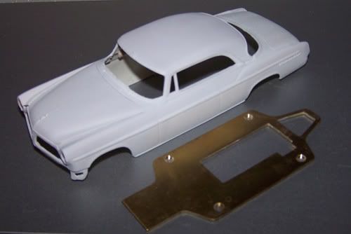

Hi guys. These are a few projects that have been on the go for quite a while.
This is the old 1/32 Revell 1955 Chrysler New Yorker kit. The plan is to build a brass chassis circa 1964 and power it with a Revell RP66 motor:
Posted Image
It was massaged a bit so I can turn it into Tim Flock's Kiekhaefer Chrysler 300:
Posted Image

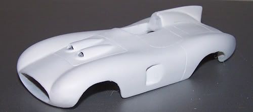

These old kits make for interesting slot car conversions. This is the Mercury Montclair which will be converted from a 4 door to a 2 door NASCAR or a Carrera Pan Americana racer:
Posted Image
Posted Image

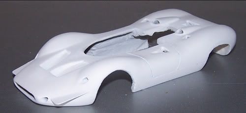

A 1/32 hand carved balsa version of Len Terry's Shelby Can Am...aka King Cobra Can Am...
Posted Image
...with lotsa curves which I like but the rear wheel wells will have to be reinforced with nylon dampened with lacquer thinner on the inside because the balsa in really thin and overhangs the tires slightly. Shoulda picked a car with radiused wheel wells!

Endbell (If I can call you by your first name!), when you convert one of the old Revell 1/32 scale bodies how do you make windows for them? The kit recommended method of cutting from flat celluloid doesn't seem to work real well for the deep compound curves on things like the Chrysler.
#8 endbelldrive
endbelldrive
    MCM Member
  • PipPip
  • 9 posts
  • Location:is everything
Posted 04 June 2007 - 07:10 AM
Hi Manuel, I think I might vacuum form the window glass. I picked up a used Mattel Vacuform Machine online at you know where for 30 bucks last year. Making a mold for the windows? I'll burn...errr cross that bridge when I get there. :oops:
