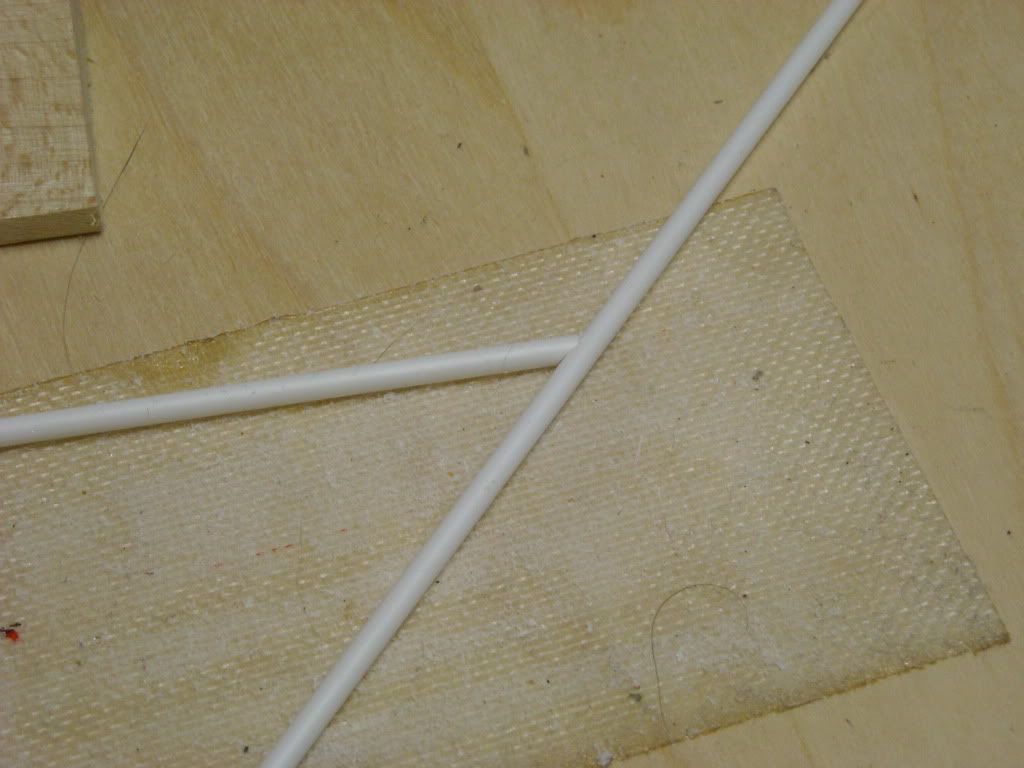

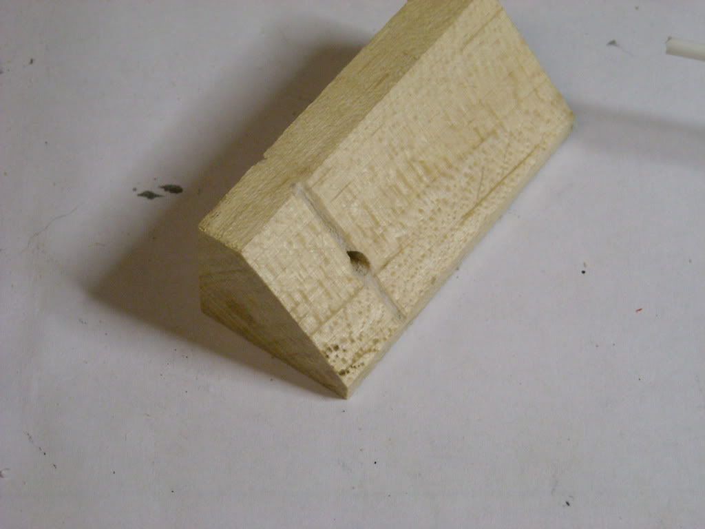

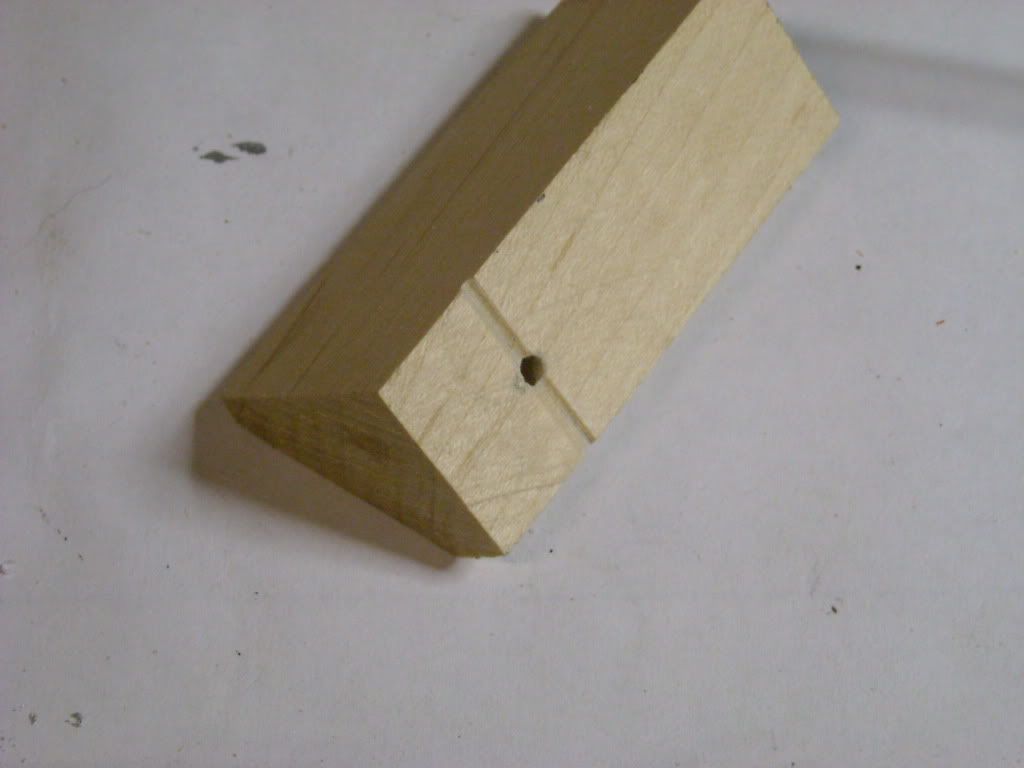

Here is my understanding of the jig Mike K. suggested.
Posted Image
Posted Image
My first attempts at 90 degrees were not much easier than freehand. But 45 degrees worked really well. The joint shown is unglued.
Posted Image
I think with some refinement this thing might work pretty well, although it's still pretty slow. I'm already pondering something involving a Dremel. Thanks for the heads up about the flash, guys, I would have carefully removed that! ;)

Posted 08 February 2012 - 03:02 PM
That's fantastic and you even did a 45 degree angle. If you wanted to expand on this you could drill holes at 90 and 45 degrees for various size tubing,as long as you could get a near perfect intersect of the two holes,you would only have to insert the drill in one and the tubing or rod in the other, and run the bit thru.When the tubing or rod is pulled from the block you would have two fishmouthed ends. :)
