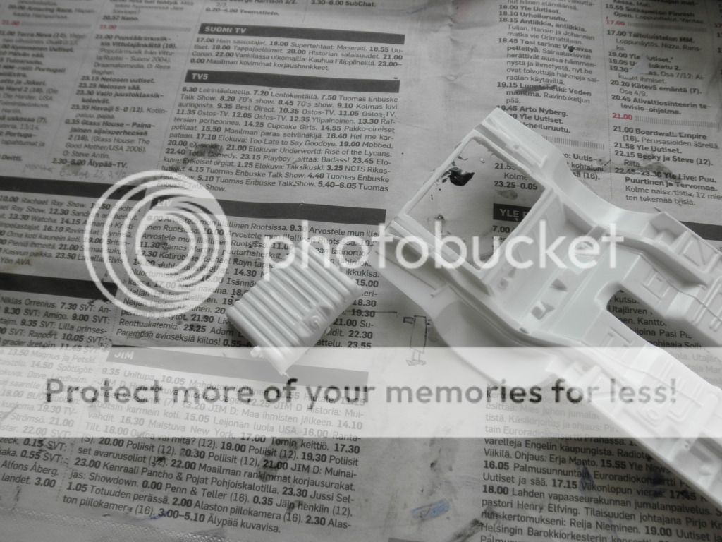

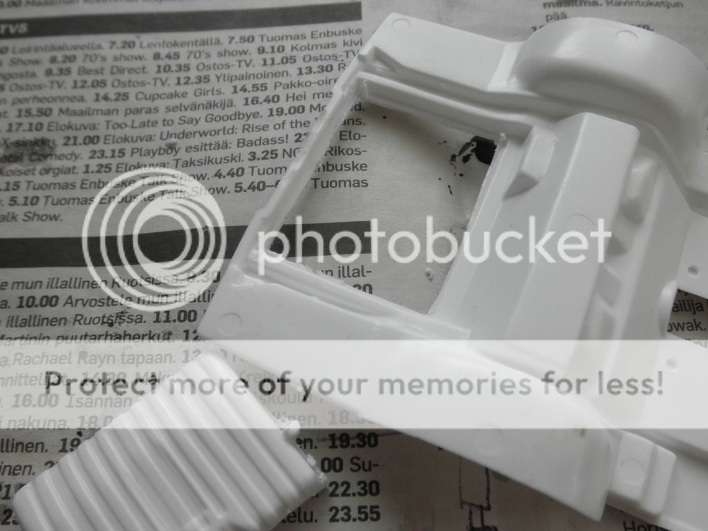

Since the Nova build is slowly getting there (having problems with the hood), I'm going to move my inspiration on this one. Today I removed the gas tank from the chassis, I will install Jazz tank later, when I have filled that hole. Gas Tank left off easily with a motor tool.

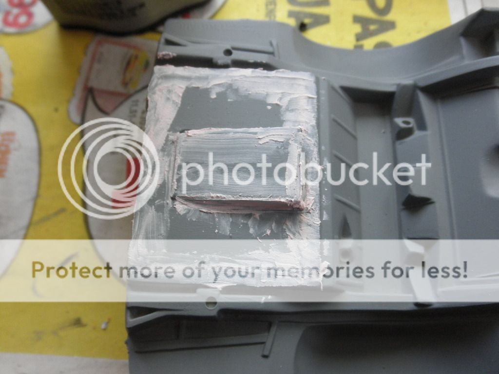

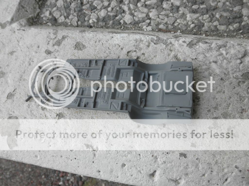

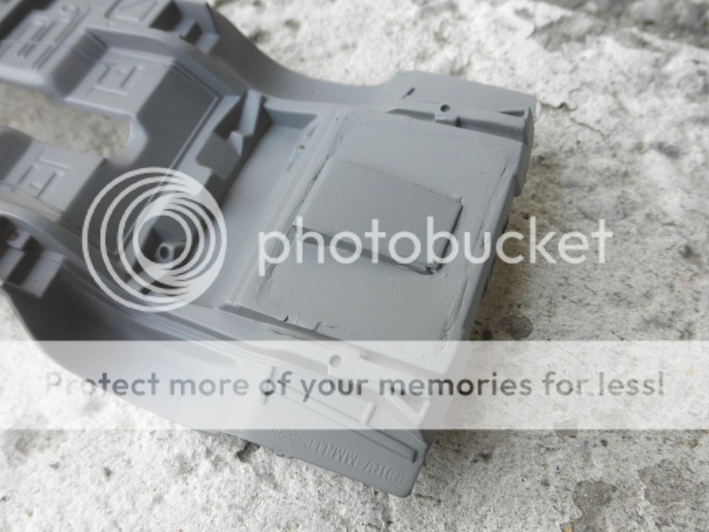

I'm finally back on this one too, and I was working on the chassis. I filled that hole on the chassis, and had to make smaller hole on that piece of plastic too, because of the Gas Tank. Gas Tank (or the part if it what can be seen from underside of the car) is built from styrene and after I glued everything together, I added some MMD's Green Putty. After some sanding, the chassis looks like this. It needs lots of more work still, and that Gas Tank needs some details too, but it's slowly getting there.
Posted Image
Posted Image

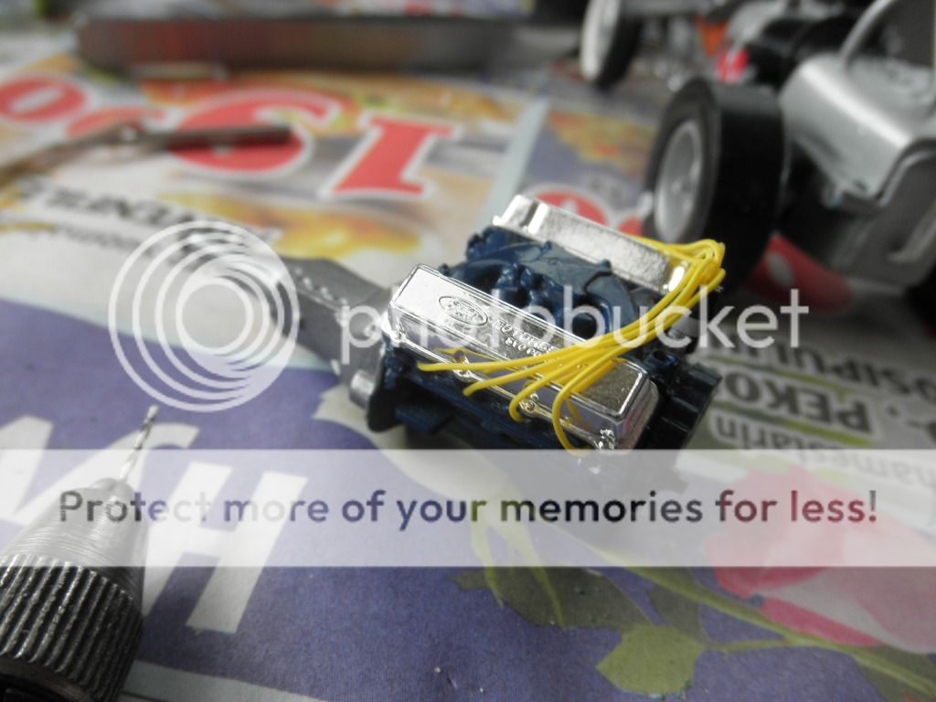

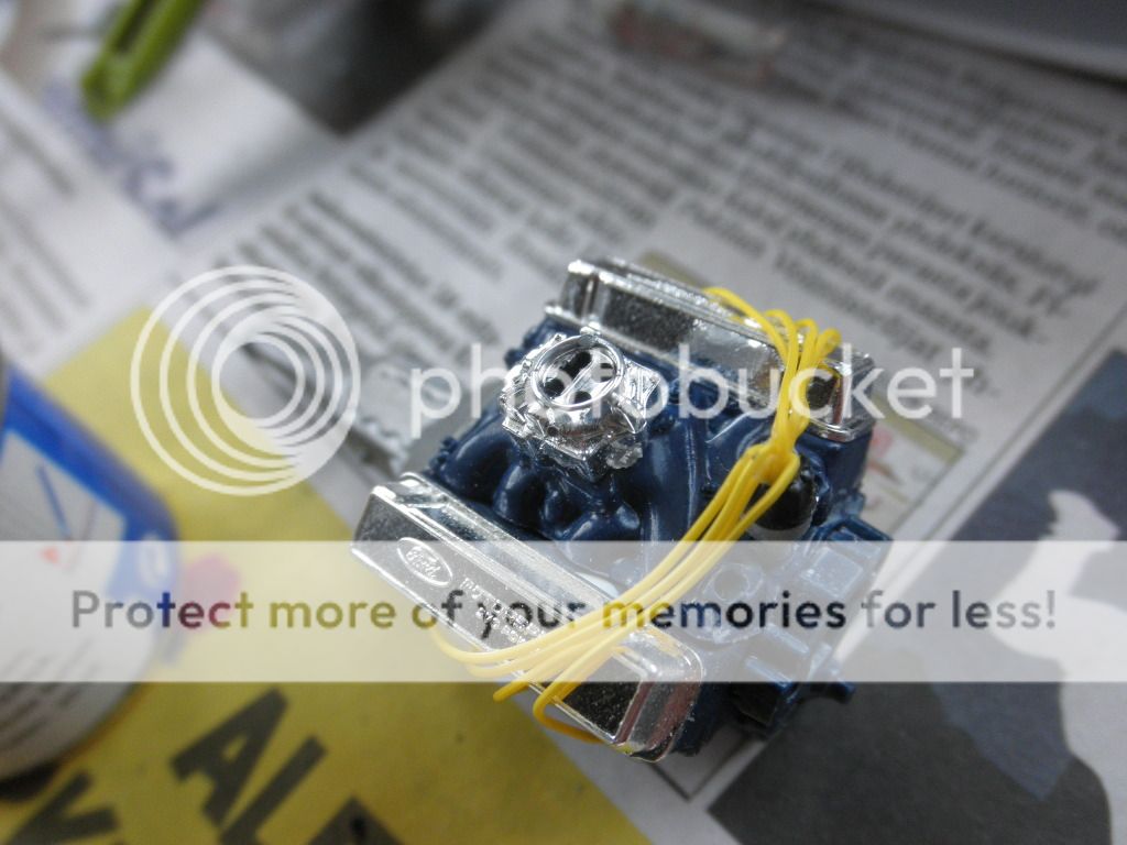

And I started adding spark plug wires too...

Niko, turn the sump around, think about where the fuel will go under hard acceleration ... it is going to go to the most rearward part of the fuel tank :)
Keep up the good work

Thanks Guys! That Fuel Tank presents Jazz Fuel Cell, and 1:1 part looks like that. So I don't see a reason to re-do it ;) .

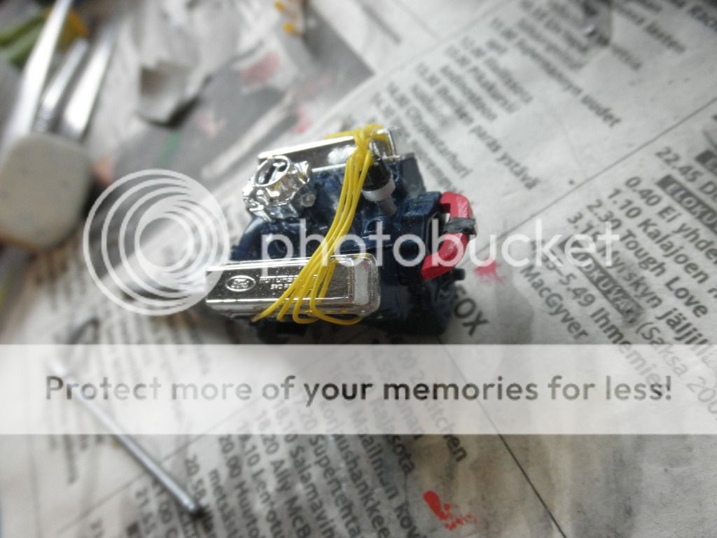

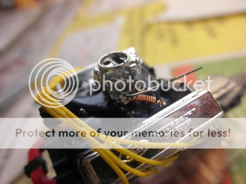

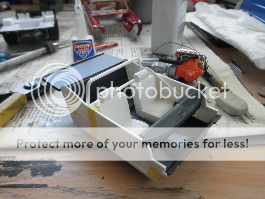

Ignition wires are attached now, and they turned out OK. Next I have to work on the carburetor and water pump area, to make some more progress on the engine. The chassis looks like it could be primered after a bit of sanding...

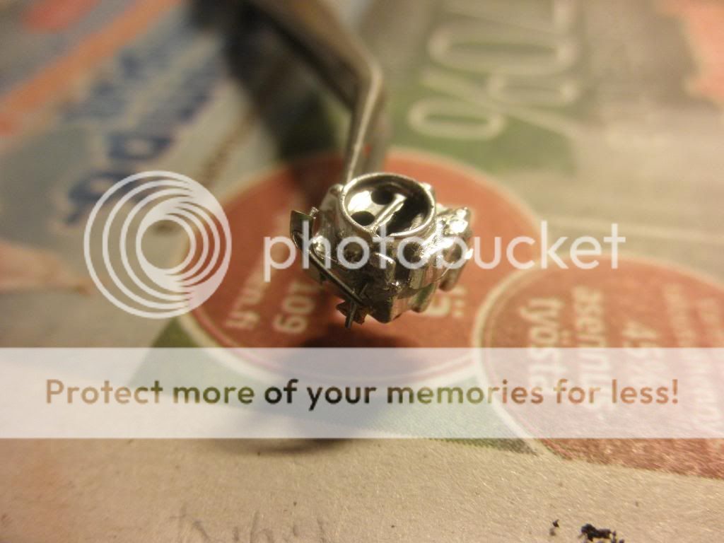

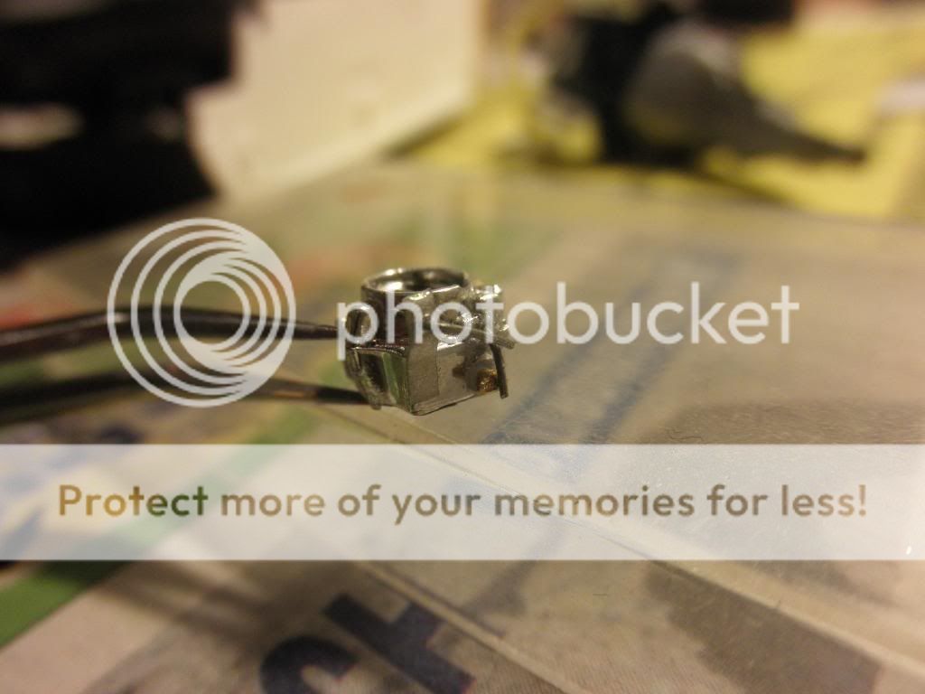

Not a big update, but little more work has been done again. I primered the chassis to see, how much putty it still needs. It's bit rough, and needs more work before I can paint it. Also glued the carburetor on the engine, it's Rochester since these Ford Big Blocks had Rochesters originally. It's from '57 Black Widow, may not be 100% correct, but much better than Holley.
Posted Image
Posted Image
Posted Image

Some Fords had the Rochester Quadra-Jet, so no, the 57 carb is era incorrect as the Q-jet came on the scene in 1965. Snag one from the Rev. 72 Olds kits and bring the fuel line into the right side of the inlet. Buick, Pont, Olds Q-jets came straight in at the front.

Alan: Thanks for the information. I spent some time with book "How To Rebuild and Modify Rochester Quadrajets", and it looks like that '57 Carburetor (is it 4Jet?) is close enough to Quadrajet. The difference is not so dramatical in this scale. I have to fill that hole on the front of that carburetor, and make a new one to the right side, where the fuel line will be connected. So '72 Olds kit has Rochester carb too... It's a shame that I can't find them from Finland and new kit costs alot. So I will be using that one, with little modifications I try to make it more accurate.

Niko, was unaware of your limited availability of kits and parts ... so in your case I guess you have to use what you can and be creative.
Alan :)
Check in the "under glass" forum, there are several photo of 72 Olds engine shots that show the Q-jet in that kit.

Yeah, the carburetor from that Oldsmobile kit looks great. I have to find one. :)

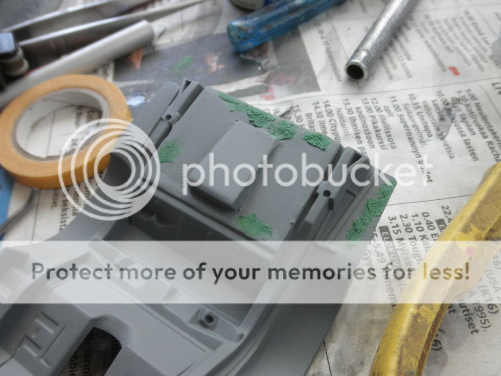

Little update. I've been working with '69 Camaro for Gumball Rally CBP, and I've had some other things to do as well, but now I managed to do some more work for the chassis. Tomorrow my plan is to sand it smooth and look if it needs still some bondo...
