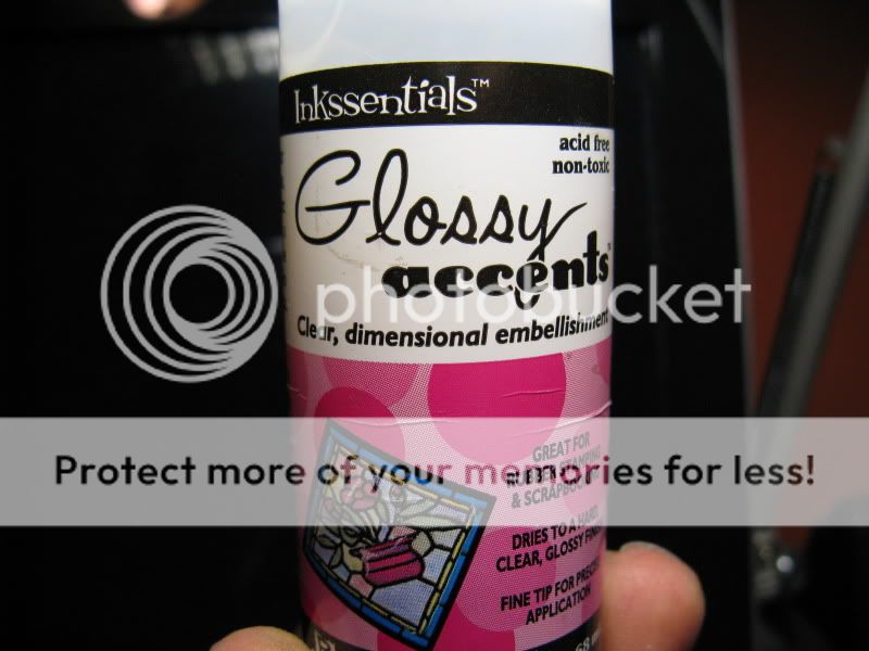

Joseph you should try this stuff it's great my wife is big into card making/scrapbooking and gave me this to try and it's great , you just pour it into your headlight pan and let it dry (couple of hours ) you can get it at micheals

I will have to pick it up and try it. Thanks for the tip

if your going to try it , it will go on cloudy but will dry clear in a few hours, put a bit more than you would want in the pan cause it does shrink a bit, i just did a 66 nova and used it and it turned out real good

Is Mod Podge Dimensional Magic the same thing as the Inkssentials Glossy Accents? I saw the MP stuff at Michaels and I was thinking about using it along with aluminum foil molds to cast headlight lenses.
