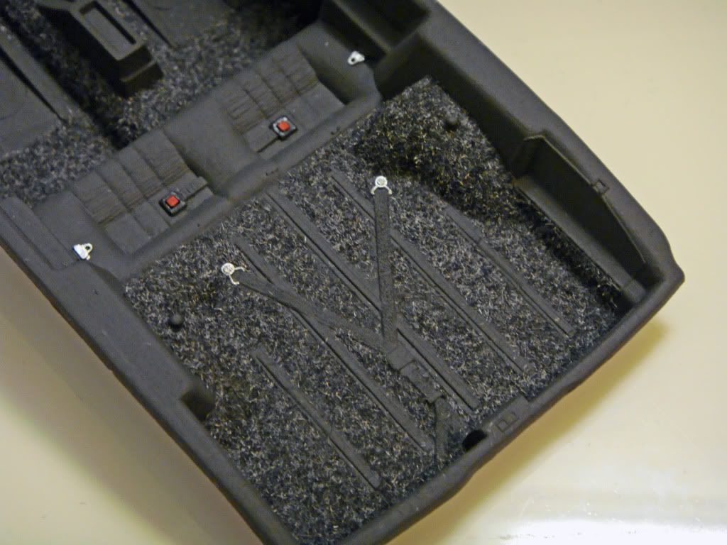

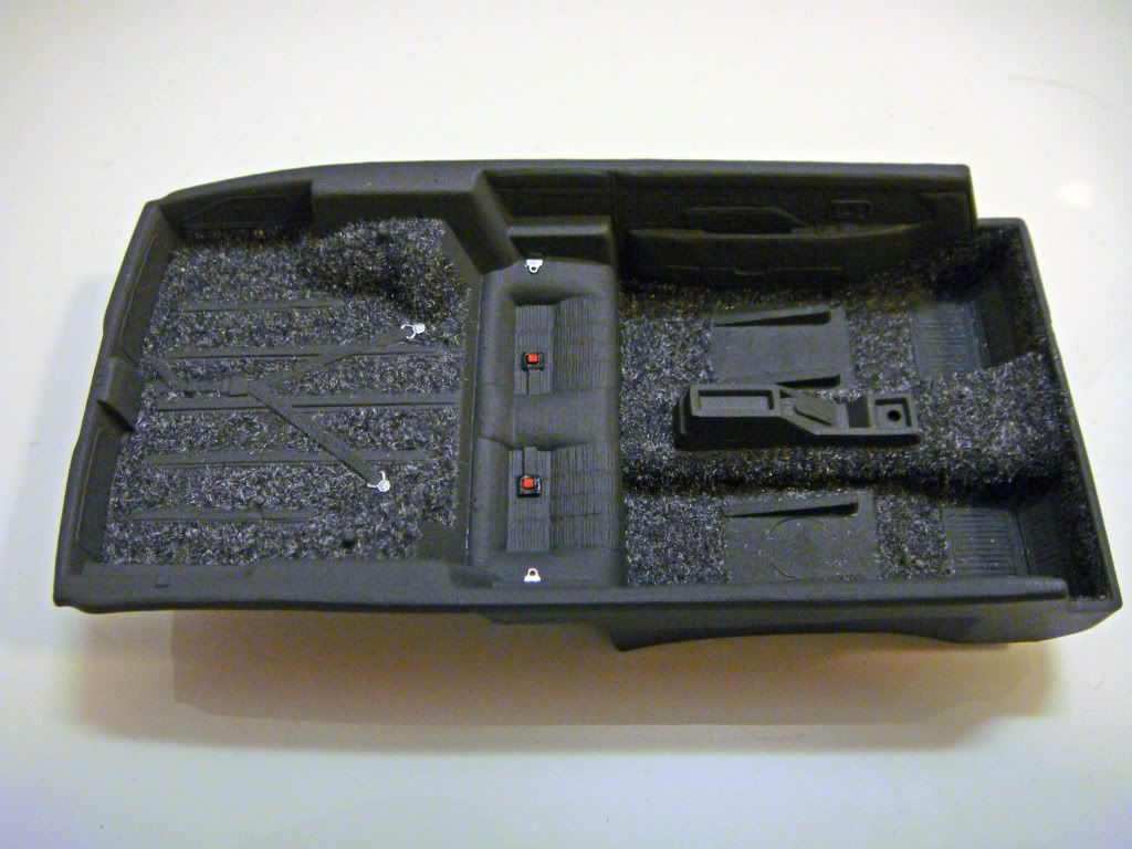

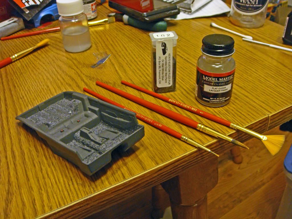

Bump for this topic...I just tried this on my 80's Supra with the exception of Testors Lacquer Clear Flat Enamel and it worked splendidly! It probably took me a good hour or more to get it done (details in the luggage area with a small brush) but it was well worth it. Thanks for the awesome tutorial!

Great job Brodie! How did you leave those lines in the luggage area? And you used model master flat clear. Lacquer?

Thanks! I used the small brush to get the clear lacquer right up to the edges of the straps and vinyl ribs and sifted the flocking on before it dried...just did a little bit at a time. There is no need to rush on stuff like this...if you do, you'll regret it. I'm glad it took as long as it did.
