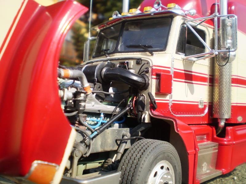

The cab and sleeper are glued to the frame. The hood can still be removed. The air filter just sits on the engine. I will glue it later.

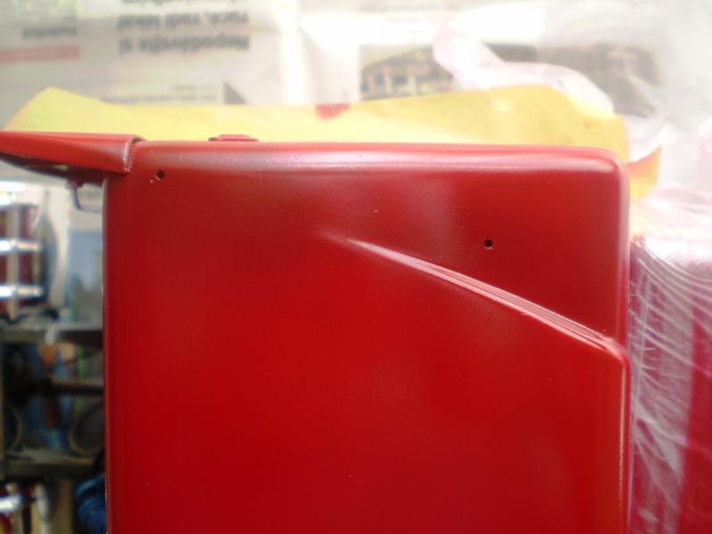

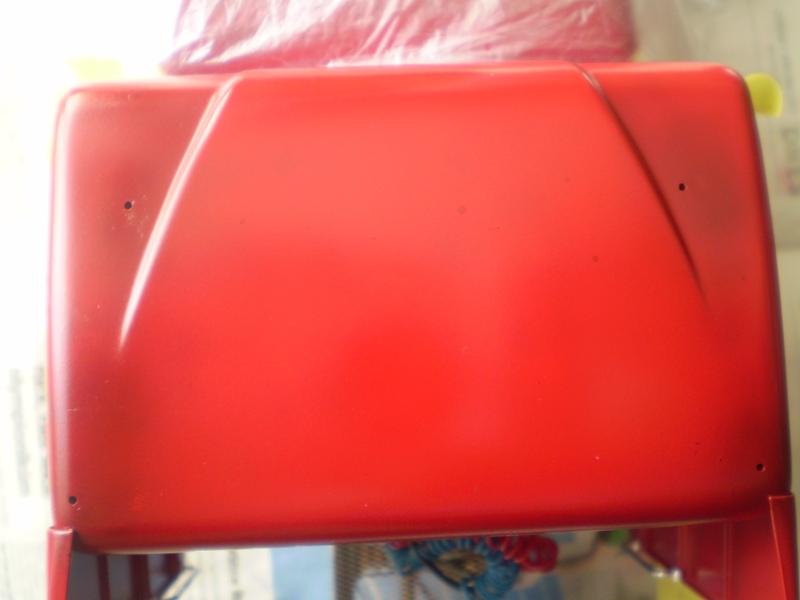

Now it fits a lot better. But what do I do with the extra holes? I am not sure if I can fill in the extra holes and repaint the spots without a trace. Someone advised me to install another horns in there. I don´t know. I´ve never seen it this way. Before I make the decision, there is a progress on another parts. I finished the coil cables for the trailer connection.

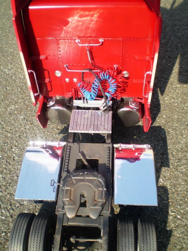

I installed them onto the truck. The spring is a lead wire 0,4 mm winded around another wire. The loop holding the coil cables is an adhesive tape. I joined two layers with the sticky sides facing each other. The black hose is an electric line. The glad hands are scratch built.
Posted Image

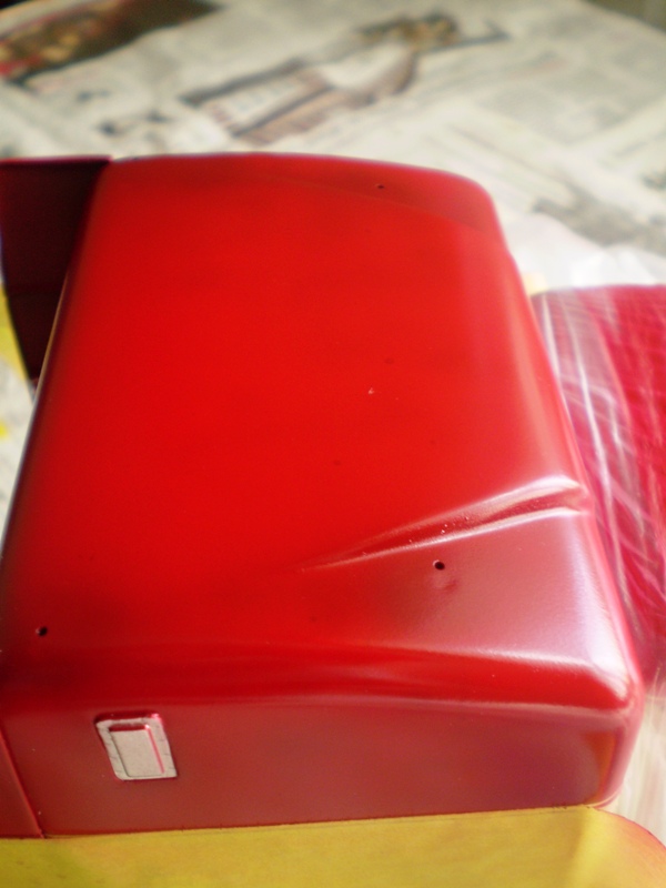

Posted 28 April 2012 - 10:28 AM

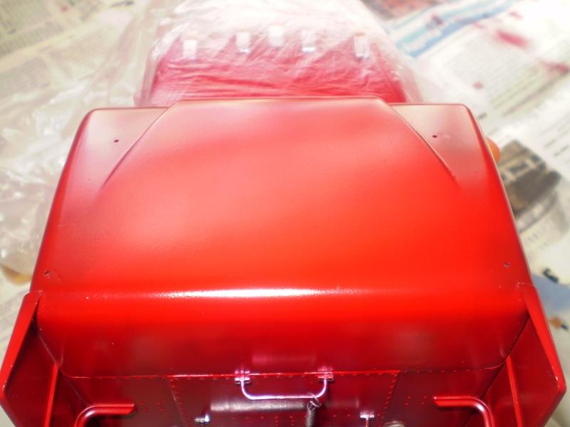

Thank you Leo. I was thinking about something like this myself. The question was... do I have the guts? Well, here is what have done. I superglued the styrene rods in the holes and cut the flush with the roof, just like you suggested. Then I tried to smooth sand the spots but the superglue was not willing to cooperate too much. So I used a bit rougher sand paper and I never got rid off the marks. My fault, I shouldn´t have worry too much about the size of the sanded spots.
I used a darkened shade of the original colour for the first few layers. I needed that dark shade for better coverage of the white ends of the rods and the light spots from the sand paper work. I sparayed a few thin layers and smooth polished them with the GT31 finishing cloth of GSI. Then I lightened the shade again to prevent too much dark spots from building up. Again, I polished each layer with the GT31 cloth. Finally I added one layer of paint over the whole roof. This will be wax-polished after the paint cures. Here is a few pics.
Posted Image
Posted Image
Posted Image
Posted Image
Posted Image
Posted Image

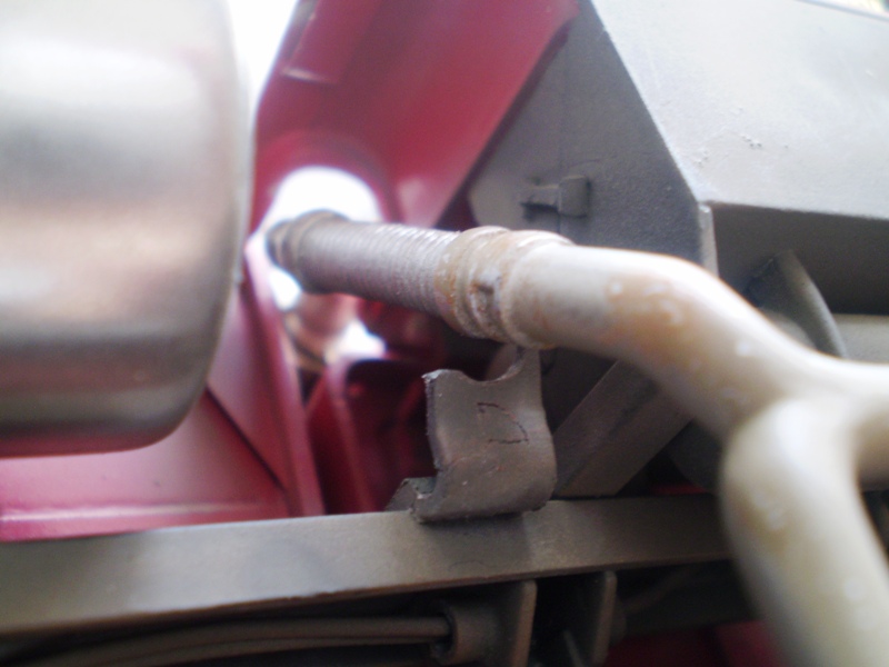

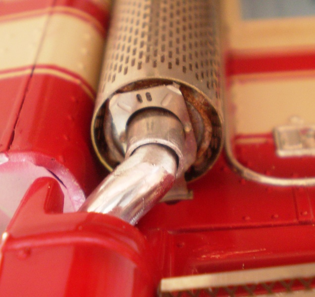

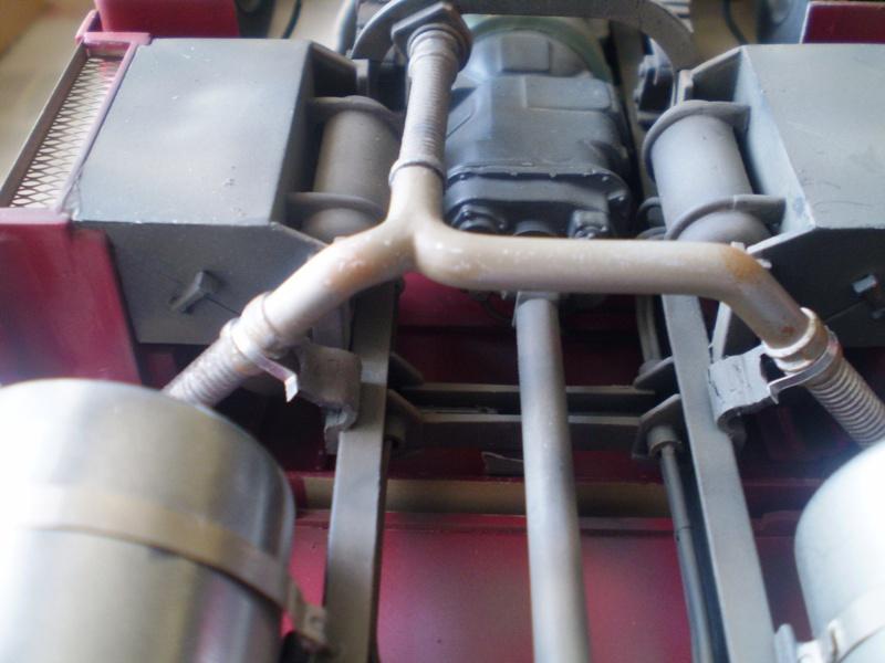

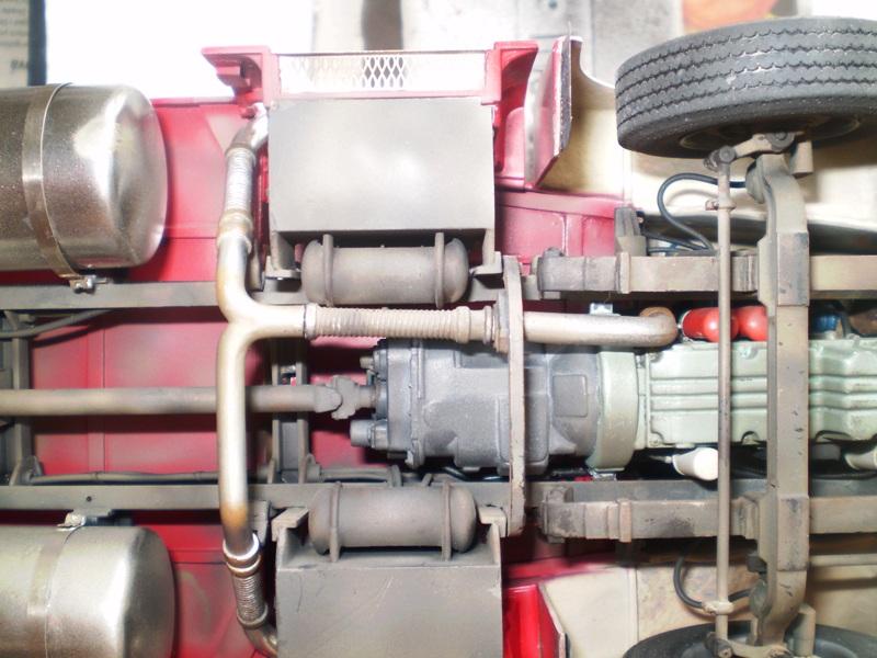

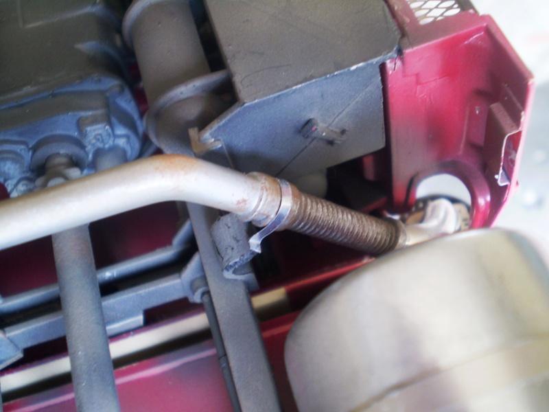

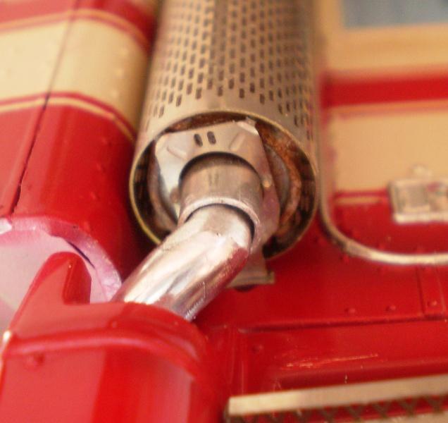

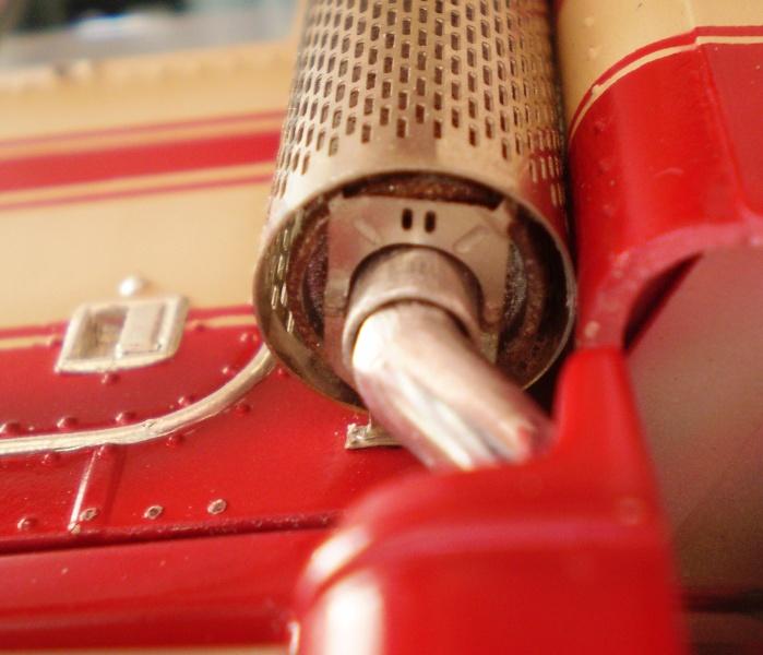

Thank you very much. The truck is getting to be complete. One of the last things I had to deal with was the exhaust piping under the frame. Even though I read the warning by Tim Ahlborn that brackets on the frame may play ugly tricks, I had to find out myself. And I got into a trouble. Again...
Posted Image
The pipes were much too far from the brackets. So, I added a pair of tin stripes to make it look better.
Posted Image
Posted Image
Here´s one of the bottom side slightly weathered.
Posted Image
I used some photo etched parts. Here is the lower mount of the stack.
Posted Image
Posted Image
I guess these were the last pictures before the model is complete.

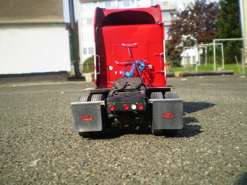

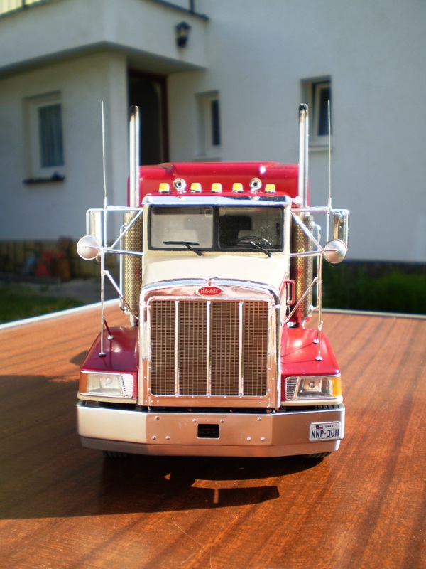

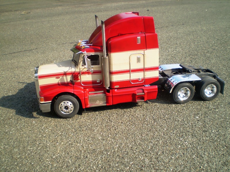

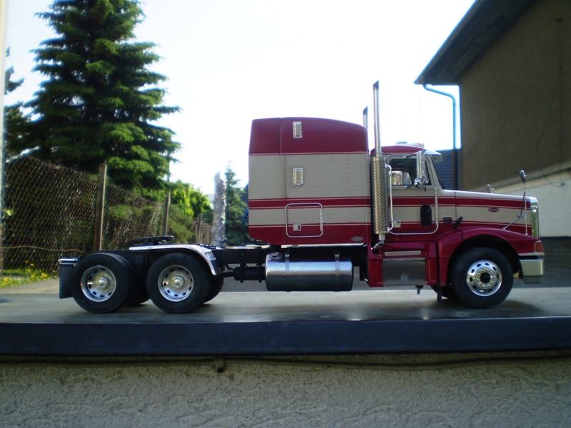

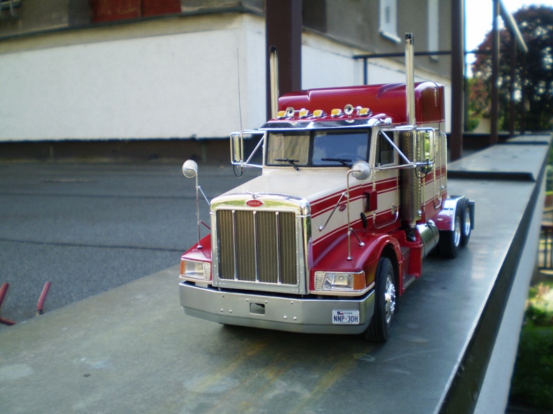

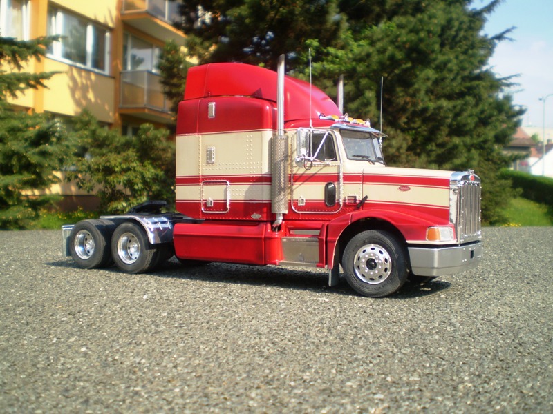

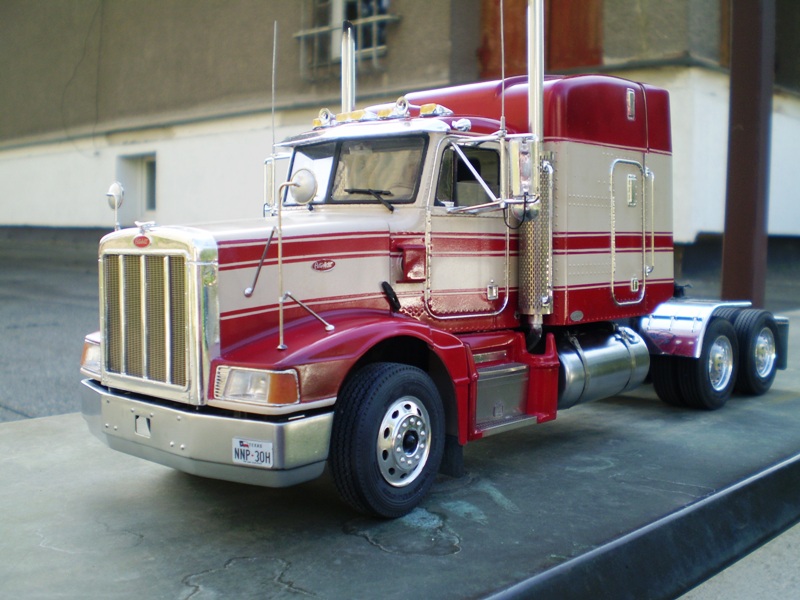

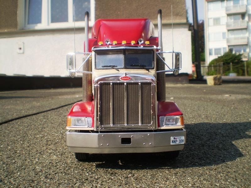

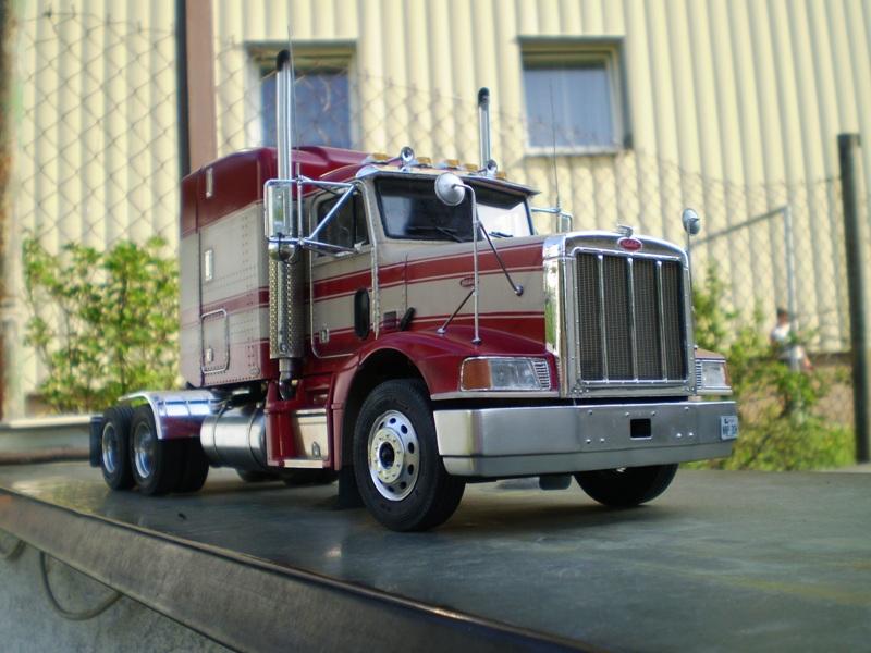

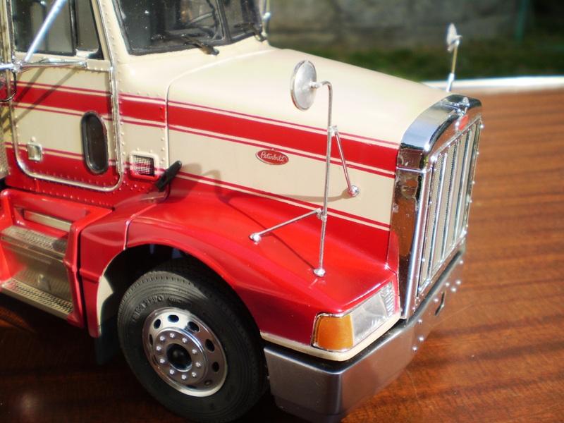

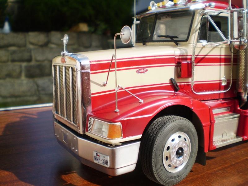

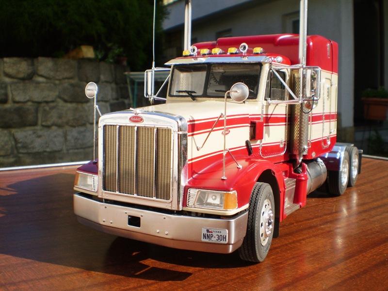

Aero Kit Pete is finished. Just one last part is missing... the grab handle behind the sleeper door. I haven´t noticed that it is not there yet when I took the pictures. I will take more pictures later with the handle added. For now enjoy these:
Posted Image
Posted Image
Posted Image
Posted Image
Posted Image

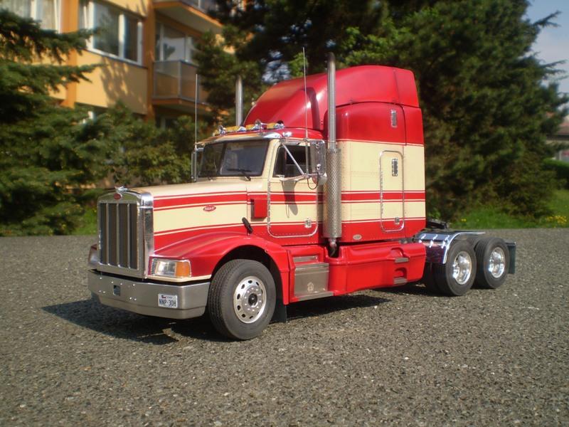

Posted 06 May 2012 - 11:23 AM
Posted Image
Posted Image
Posted Image

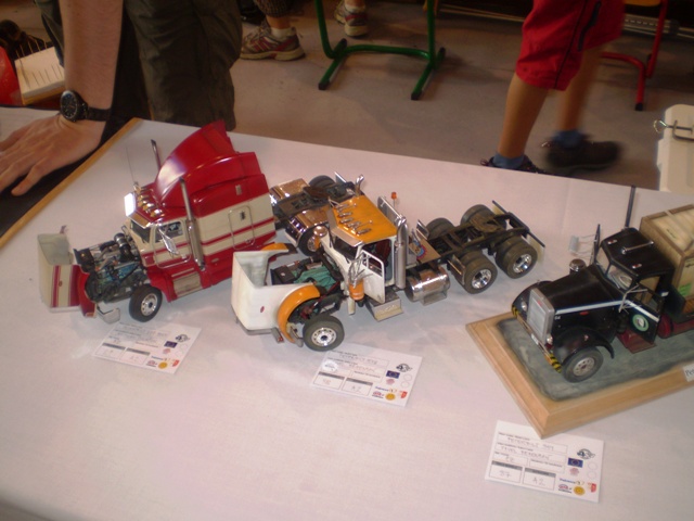

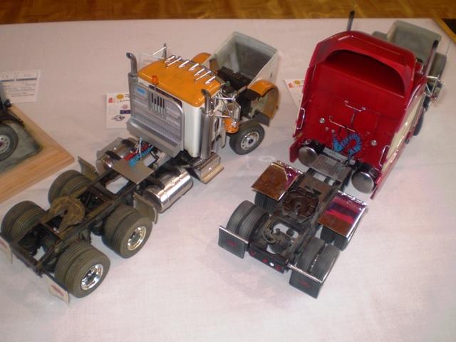

I took the model to the Beskyd Kit Show (Czech Rep.)last weekend. The 378 standing next to it is not mine.
Posted Image
Posted Image
