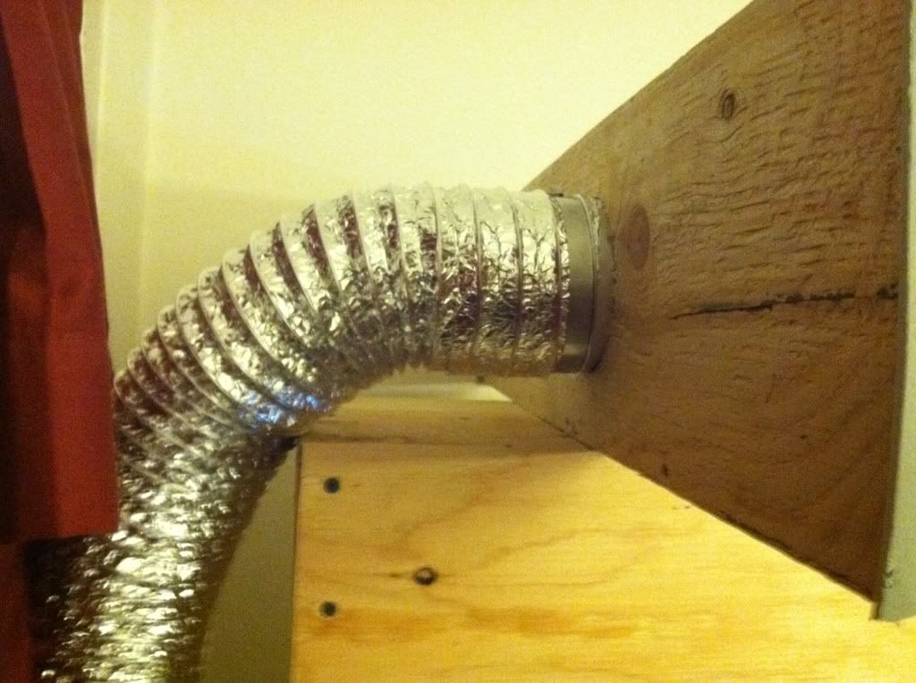

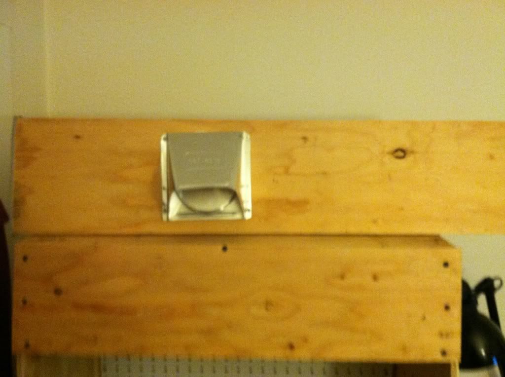

Posted 02 March 2012 - 03:26 PM
If your near a window you make something to vent it really easy and cheap. I used a piece of 1/4" plywood cut to fit the window with a 1/8" gap on each side then used some stick on weather striping to put on each end to seal it. Bought a cheap ($6) aluminum dryer vent that has a flap inside it and cut out the hole and put a thin bead of caulk under it and screwed it to the plywood. Just stick it in the window and shut it. works great.
Posted Image
Posted Image
