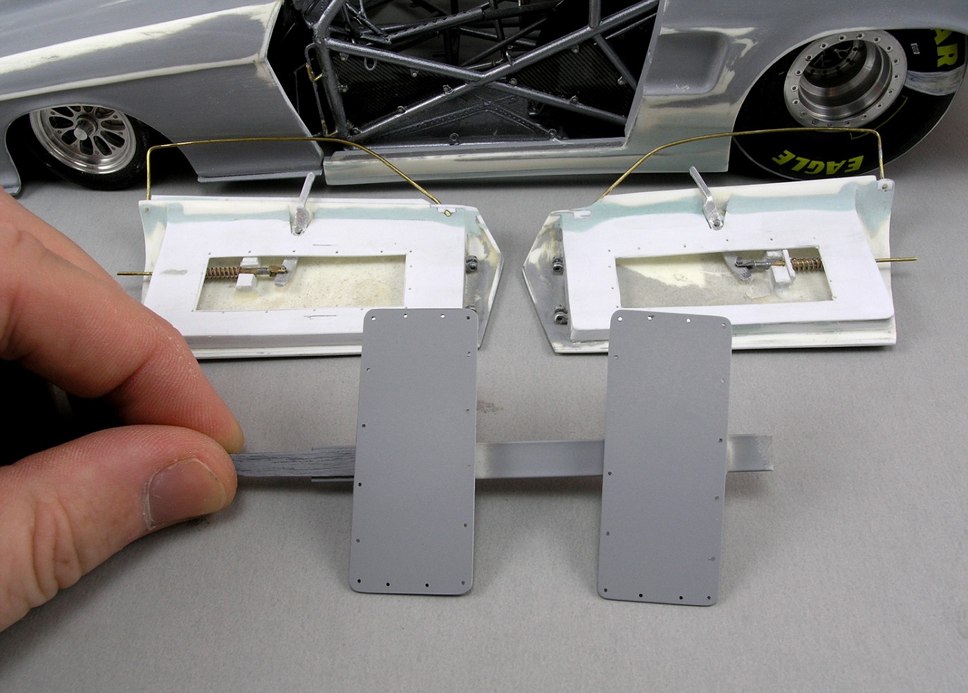

I've spend the last week or so working on the wheel tubs and filler panel. I wanted to match the way R2B2 does theirs as much as possible. I tried using the Shapeways 3D printed tubs I had, but they weren't big enough, so I went the brass route.
I started bending up one and fitting it in place, then I made the filler panel pieces, then I added the second remaining tub. It all fits in there pretty well, and seals off the body pretty decent. I still  need add some more plastic pieces to show the junctions of where the pieces connect, but I'll get there eventually.
Once I did the tubs, I found out my rear tree didn't fit anymore. So I made a new one from brass rod. It all works together now, even though it will barely be seen once all together.

As you can see, I also got all of the rear suspension installed for good. I still need to add the sway bar and links, and hook up the brake lines. The puke tank and hoses are installed, and I added the filler panels at the back of the cage too.
And a few with it all mocked up.
Now I can get the tubs painted black and start decaling them thanks to my man DaveT! I've also been working on the inner door skins.
CK

John, the brake lines are from Detail Master fitting line. And I usually use black thread to tie off the lines and hold them to the chassis. Pull it tight, a small dot of super glue, and trim the excess thread. Works great.
Got some work done over the weekend. I need to make more progress on the engine, so I went out and machined a new oil pan. I made it a bit too deep, but it should work. Once it was glued on I added some .040 Pro Tech nuts to hold it down.
I also machined a smaller piece to simulate the "boss" where the oil line  will go.
The distributor is from Micro Nitro and is installed and ready for plug wires. I used Slixx 1/16 MSD decals on it. I also started figuring out the idler pulley bracket.
Front brakes are finally installed and ready for  brake lines.
