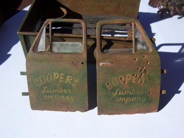

I have found that clear fruit containers, like the ones that strawberries and grapes come in, have great "glass". It is super thin (to scale) so it is easily cut and bent, and most panels on the packages are flat.
Sorry, the only photo of it I have but you can see how thin it is.
Posted Image
