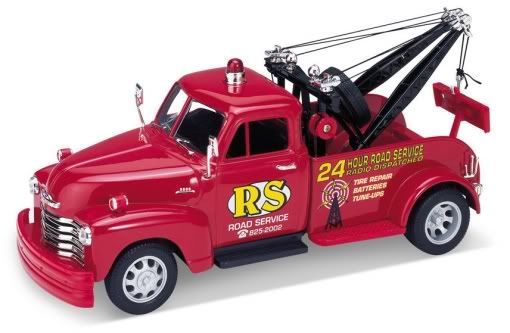

Need these wheels but I think I may have to buy this truck and scavenge them. Wonder if anybody would make a resin set of these for me if I buy the kit so I don't have the diecast with no wheels? Other people would prob buy them. Someone should also make a photoetch wrecker kit with all the accessories. I may make a Texaco Decal kit for this truck for more wreck decals. I would probably buy a few sets of the wheels. Posted Image

I would definitely be interested in that particular wheel. However, those shown are not very accurate. They look too small in diameter, and the holes are too large. I think it was a Danbury Mint piece that I saw that had an accurate version, but I can't locate it atm.

The truck shown in the first post, which is a Welly, and the Danbury are both 3800 1 tons. I can't speak for the accuracy of the Danbury as far as wheel dimensions, but the Welly does measure out to be accurate for the 18" wheel with a 7.00-18 tire that the Advanced Design dual wheel 1 tons used.
