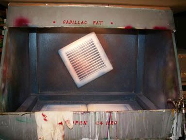

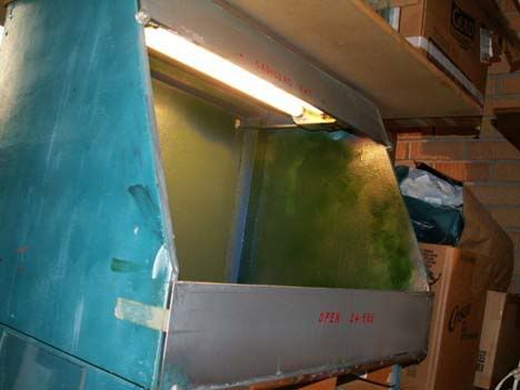

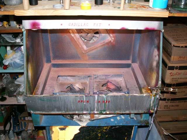

Here's the one I've been using about 13 years spraying HOK products and flushing my guns with Lacquer Thinner,
The Bathroom Exhaust fans are quick and easy to change out,
The fans cfm empty the booth in less than a second
The booth is not constructed of C4 and I do not use natural gas as my air supply for the AirBrush.
I just love alarmist remarks against building your own Paint Booth instead of "buying" something that puts bucks in another guy's pocket,
The Government even has a booklet of Basic Skills instructing people how to walk by placing one foot in front of the other
Posted Image
Posted Image
Posted Image
2 of the ducts running outside before the third fan was added,
Posted Image
Manufacturers do not want possible consumers to build anything themselves.
However, good old American know how prevails.
CadillacPat

Regarding Pat's homemade bathroom fan booth...
Aren't bathroom exhaust fans "explosion-proof," or brushless? I mean, hairspray is pretty flammable. Would't bathroom exhaust fans have to be the explosion-proof kind, per building codes? Wouldn't they be ok to use in a homemade spray booth?
Just asking...

Regarding Pat's bathroom fan booth being "unsafe"...
Aren't bathroom exhaust fans "explosion-proof," or brushless? I mean, hairspray is pretty flammable. Would't bathroom exhaust fans have to be the explosion-proof kind, per building codes? Wouldn't * they be ok to use in a homemade spray booth?
Just asking...
I know one way to find out........but I would rather spend the money on something that someone engineered properly.
The same could probably be said about kitchen range hoods too Harry, afterall they are designed to extract fumes and are subjected to grease, but how many times do you hear about kitchen fires that start in the ductwork? I have seen and heard of many!
If I can afford $25 model kits and $8 cans of Tamiya spray paint, then I can afford $200 for a properly built and engineered spray booth, even if it means fewer kits and spray paints.
I could use my weedwacker to mow my lawn, but isn't my lawnmower designed to do that? ;) Just Sayin!
Just asking...
I've not seen any notice on a bathroom fan package indicating that they are explosion-proof, Harry. However, due to the humid environment they generally work in, their motors tend to be induction, or brushless motors. In any event, bathroom exhaust fans don't have much CFM capacity, and if one is trying to vent out of doors completely, chances are the inner surfaces of a dryer or other sort of vent will slow the air going through down dramatically.
Just a thought.
Art
Range hoods do have explosion-proof motors. When one hears of a stack fire in one, it's generally from a source other than the mofor--which is why when you go into a McDonald's--if you look closely at the french fryer station, see the exhaust uptakes, they have those rather sophisticated baffles on their bottom end--should a fryer flare up on fire, the baffles help to keep the flame out of the exhaust stack.
Art
