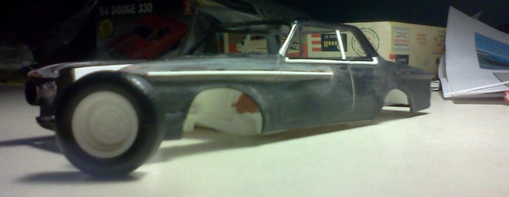

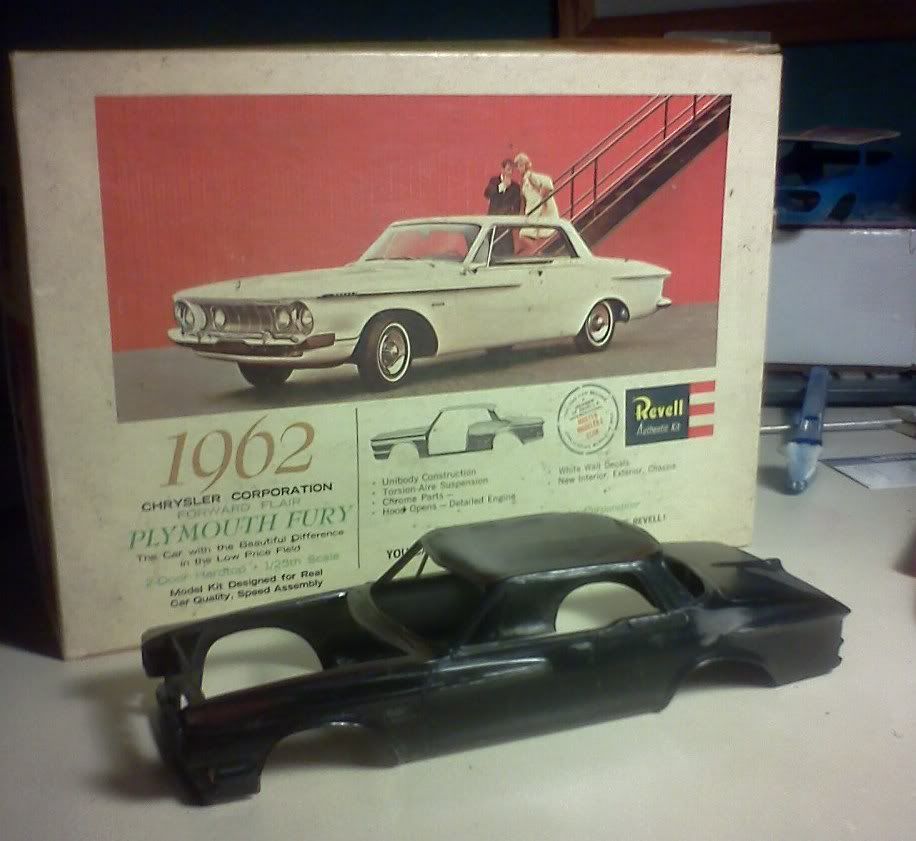

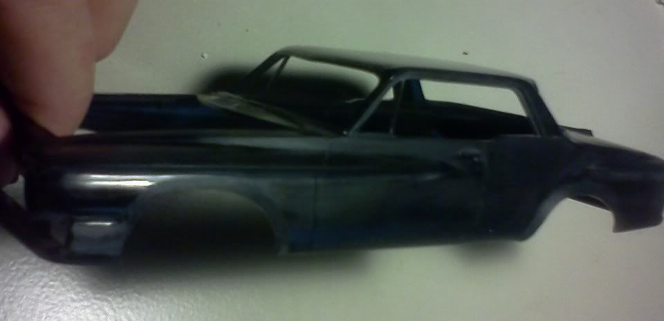

Not much of an update, working on taking the Fury trim off to replicate the Savoy trim. Will need to make a Sedan out of the hardtop as well. Working on donor chassis from Lindberg 64 Dodge as well. Had to shorten the chassis about 1/8" or so for wheelbase to align and had to cutthe rear of the chassis by 1/4" roughly to fit into body. May need to narrow abit as well, will see once glue has dried.
Body work has been started.
Posted Image

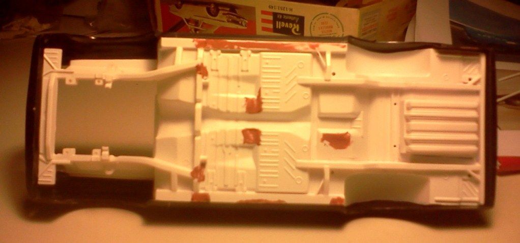

Here you can see where I cut the chassis right behind the front sub-frame to shorten wheelbase. Cut out the stock gas tank and shortened rear frame rails. Need to fill in were tank was and either modify the stock tank or fab a new one similar to the Johan 64 Petty tank.

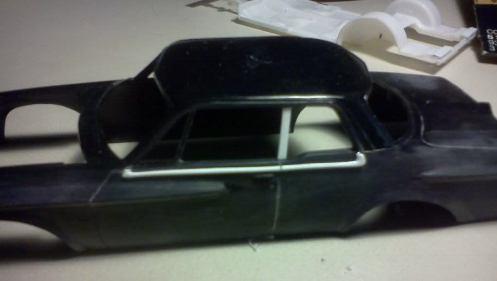

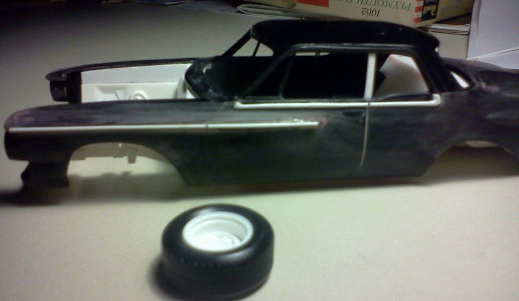

Started making the Savoy trim on the drivers side and added the sedan post. Everything is just tacked in place for now. Need to finish clean-up on trim yet and make another for the passenger side.
Posted Image

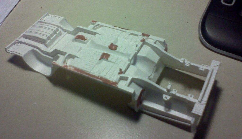

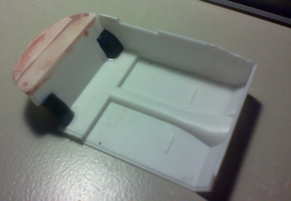

Posted 19 May 2012 - 07:45 AM
I have a small update on this project. I have the 426 ci engine with single carb manifold and manual trans from a Lindberg 64 Mopar that I will use, no pictures yet haven't done any painting or detailing yet on engine. I have purchased a set of the resin 1960-1964 Firestones from Plastic Performance Products (PPP) and thought I could use the steel wheels from the Lindberg kit but they are to small of diameter so, back to the internet to purchase PPP wheels. I have also purchased one of there rollcages as well to adapt to this project.
I have primed the chassis and found some areas that needed alittle more attention with some putty. Overall I think it will work great. Need to finish up and start checking on ride height.
Posted Image

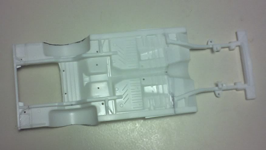

I have also started to see if I could modify the interior pieces from the same Lindberg 64 Dodge 330 kit that the chassis came from to fit the 62 Savoy body. Have modified the package tray and added some wheelhouses to the rear seat area. I will attempt to make door panels with stock upholstery pattern on them using the reverse side of the Dodge pieces.
Posted Image

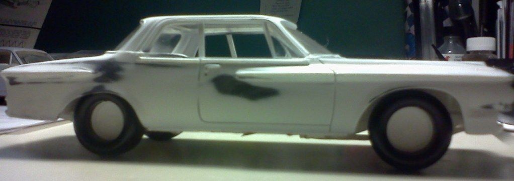

Posted 10 August 2012 - 08:51 AM

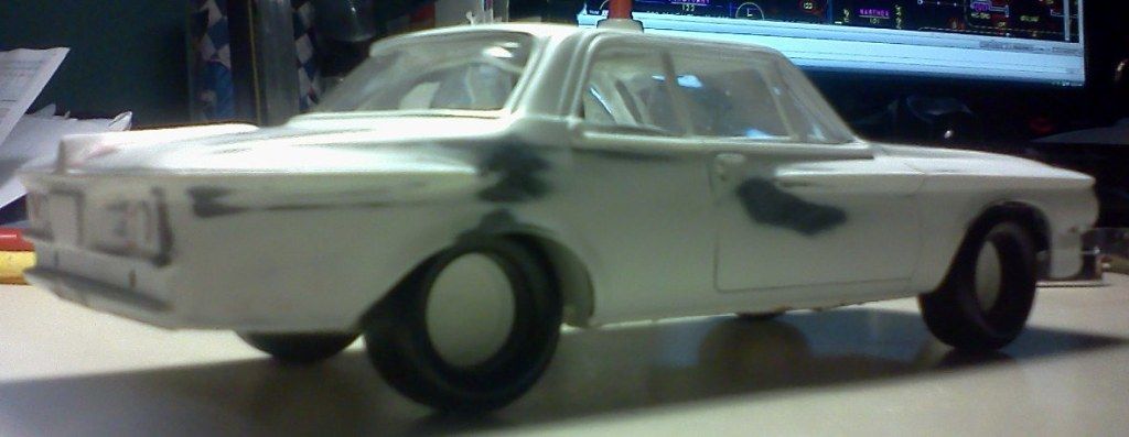

Been awhile since I updated this project. Been slow going on it with work and a new son being born at the end of July and some other projects.
Finally got the body in primer and noticed a few areas that needed blocking. Mocked up the suspension to see about ride height.
Posted Image
Posted Image
