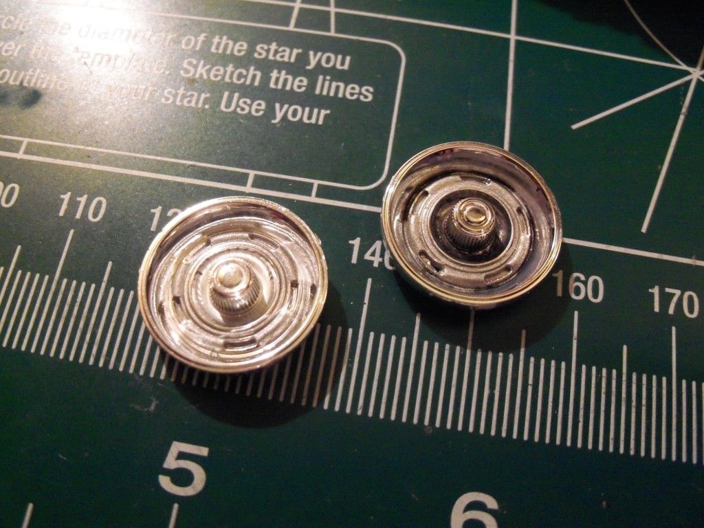

Ever notice how kit chrome looks a little too...toyish? I've got news for you B)
All I do is take some acrylic black paint, and pretty much soak all the chrome in it. Then once it dries, I wipe the black paint off.
Here's the difference:
Posted Image
(One on the left is stock chrome, one on the right is after the black wash)
It really tones down the chrome and makes it look more realistic. But, unfortunately, I haven't figured out how to get rid of the sprue attachment points :( :P

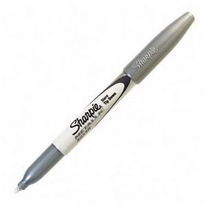

A lot of people including me use a silver Sharpie to touch up the sanded down sprue points.

The Sharpie is better than nothing, but the color is more aluminum than chrome. I wonder if we treated it like Alclad, and preceded it with a black Sharpie, if that would make a diff? Hmmm? I will have to try that.

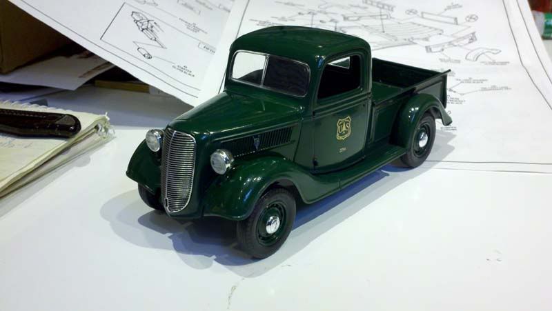

If you put down a coat of Future then thinner based paints should be ok. I use artists oils and Mona Lisa thinner to black out grills, he oils give a good solid black and have a long working time. Without the coat of Future I have had the chrome just wipe off like Jon said. I specifically use the Mona Lisa brand thinner because it is supposed to be very mild as thinners go so less likely to react with underlying paints, chrome etc.

Nice job, Aaron. Great subject! I've always loved those old Ford pickups.
