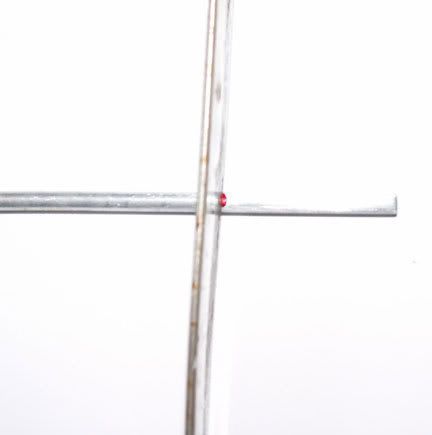

Now, lay your 1/8" tubing alongside the exposed length of the bit and mark the tubing the same length as that portion of the bit protruding from the Chuck.

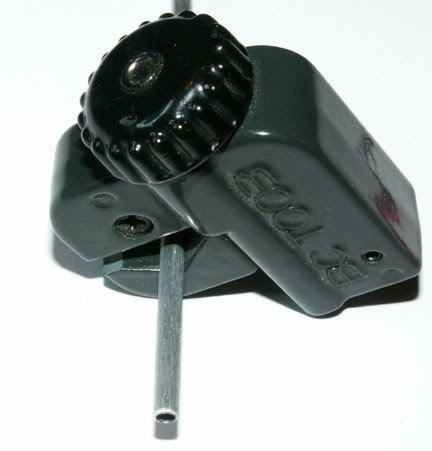

Use either a small Tubing Cutter or a Razor Saw to make your cut.
