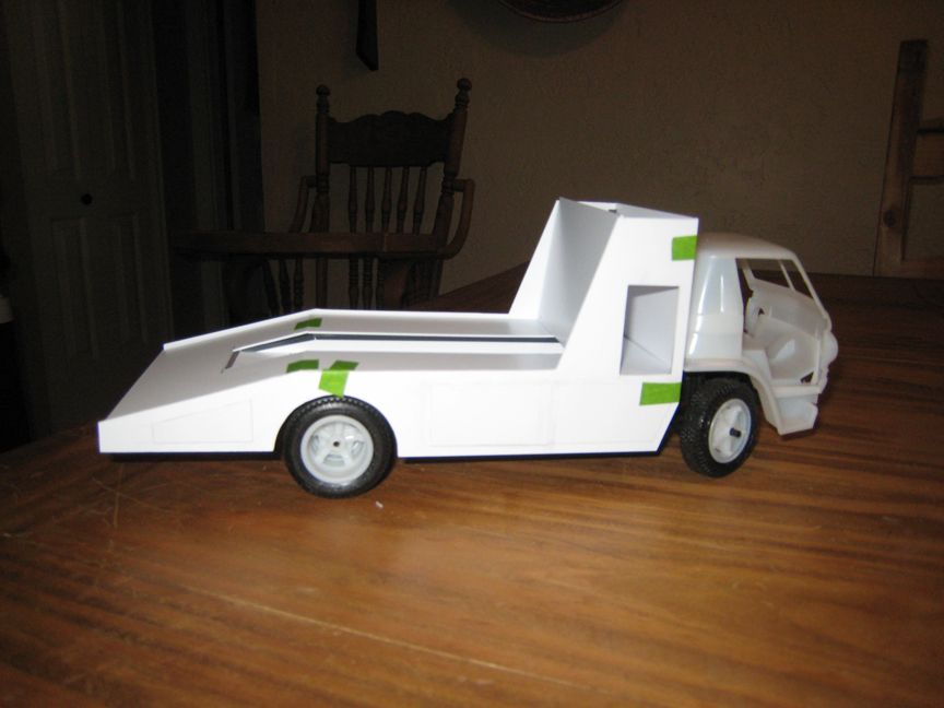

Gents - the SLM group is doing a dio, in case you haven't heard and been living under a rock, so I volunteered to build a drag car hauler. Now the premise for this duo is it takes place in early July 1967 somewhere in the midwest. Phil sent me the Dodge semi which had to be lengthened and I'm in the process of building the ramp bed which will have a few opening storage doors and some weathering.
I spent a good portion of this afternoon continuing the bed but ran out of time to take some pix so here's some earlier progress pix to give you the idea.
I'm not sure of paint colors or scheme yet as this is being built to haul another member's build so at the moment, I don't know the finish.
Posted Image

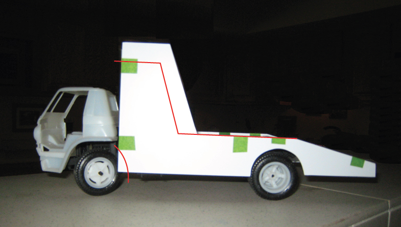

The vertical portion was built oversized so I could figure out just what height I wanted it when it was in the mock-up stage. I've made the adjustments as indicated in red. Updated pix to follow...
Posted Image
Stay tuned and any input/suggestions are welcomed as I know little of these big rigs. Thanks for following along.

Check your body ramp angle. It looks a little steep car frame might hit the bed. Your coming up with something very creative.

Thanks for your input Vince. Since its 1967, not many of the vehicles were low riding so I think we'll be OK. At least I'm hoping so.

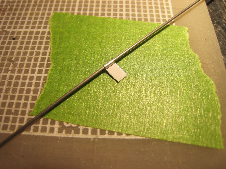

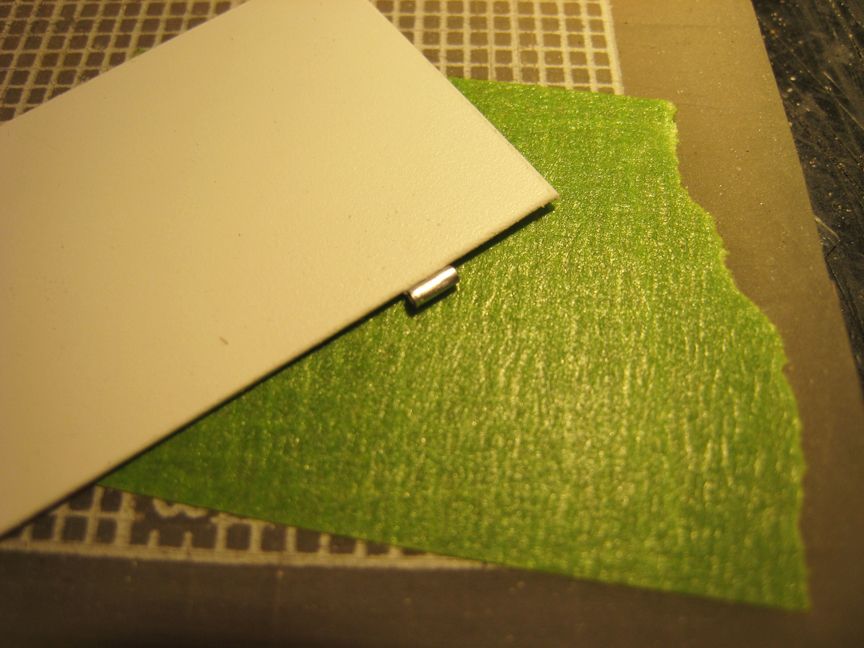

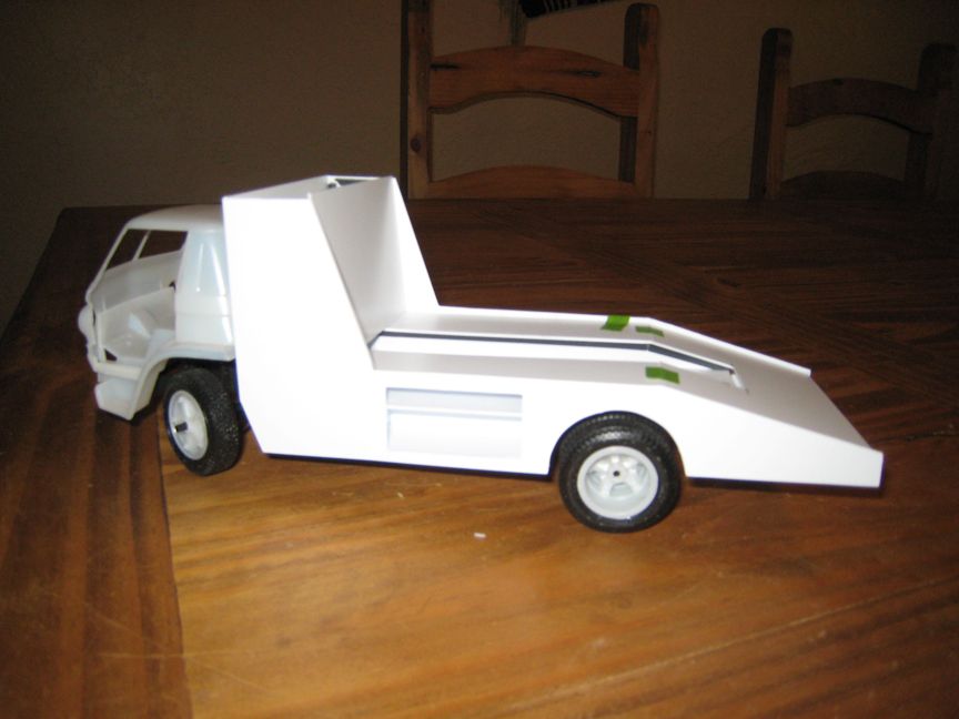

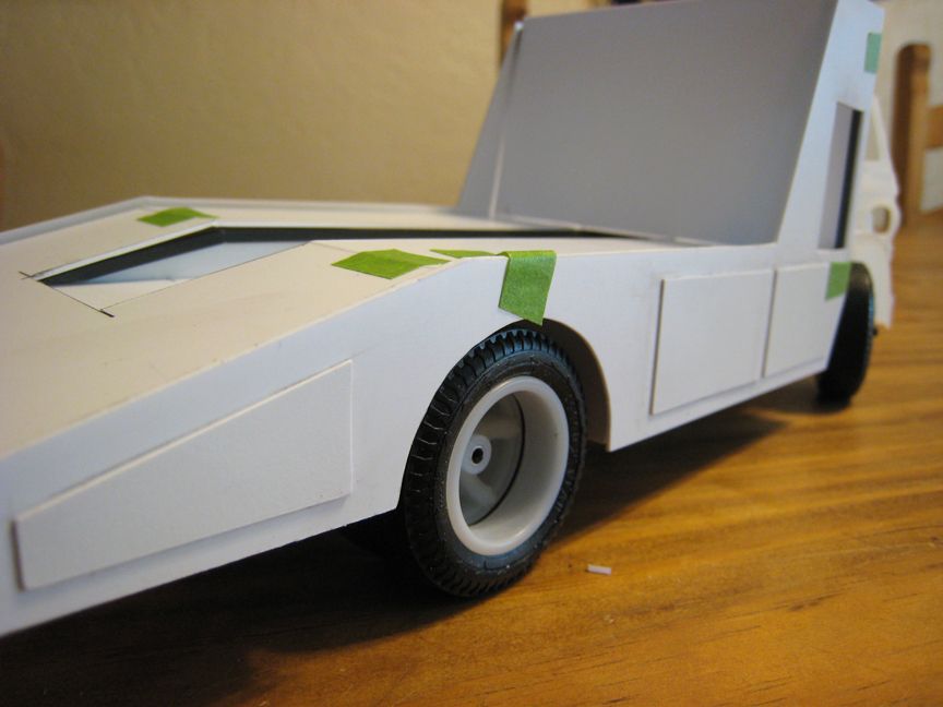

As promised, here's a few progress pics. As you can see, one access door on each side of the hauler will be opening up for display purposes. The right side has the non-functioning doors glued in place and am still working on the driver's side. For the hinges, I'm using printing plate rolled around 0.25" steel piano wire which will be bent and attached to the body of the hauler. The actual doors are 0.15" syrene glued to an inner portion which is 0.26" and small enough to fit inside the door opening. Hope that makes sense. More on the hinges and doors later once I actually get one mounted.
