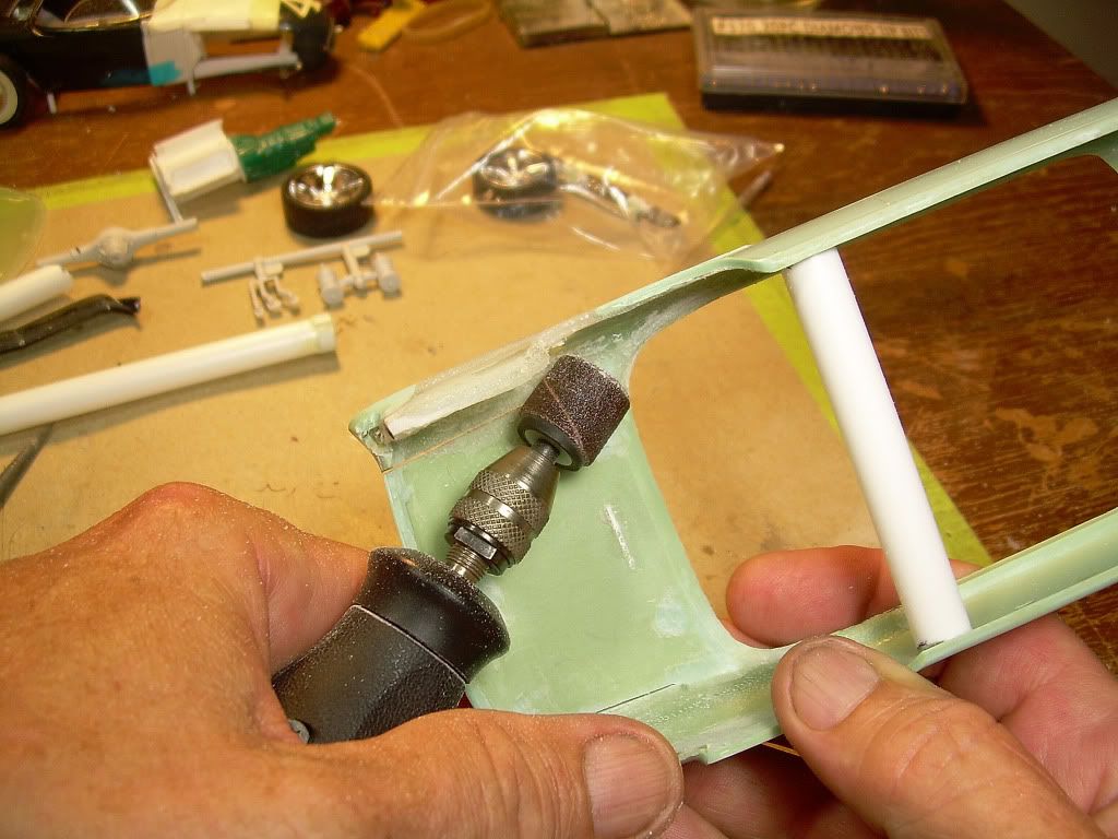

Wanted to open the deck before I got into the restyle of the tail too far. This old body is as thick as resin, and extremely brittle. I thinned the deck cut-lines on the inside with a dremel to ease the process. The tube between the rockers is a temporary reinforcement to keep the body from cracking again through the front and rear cowl sections.
Posted Image

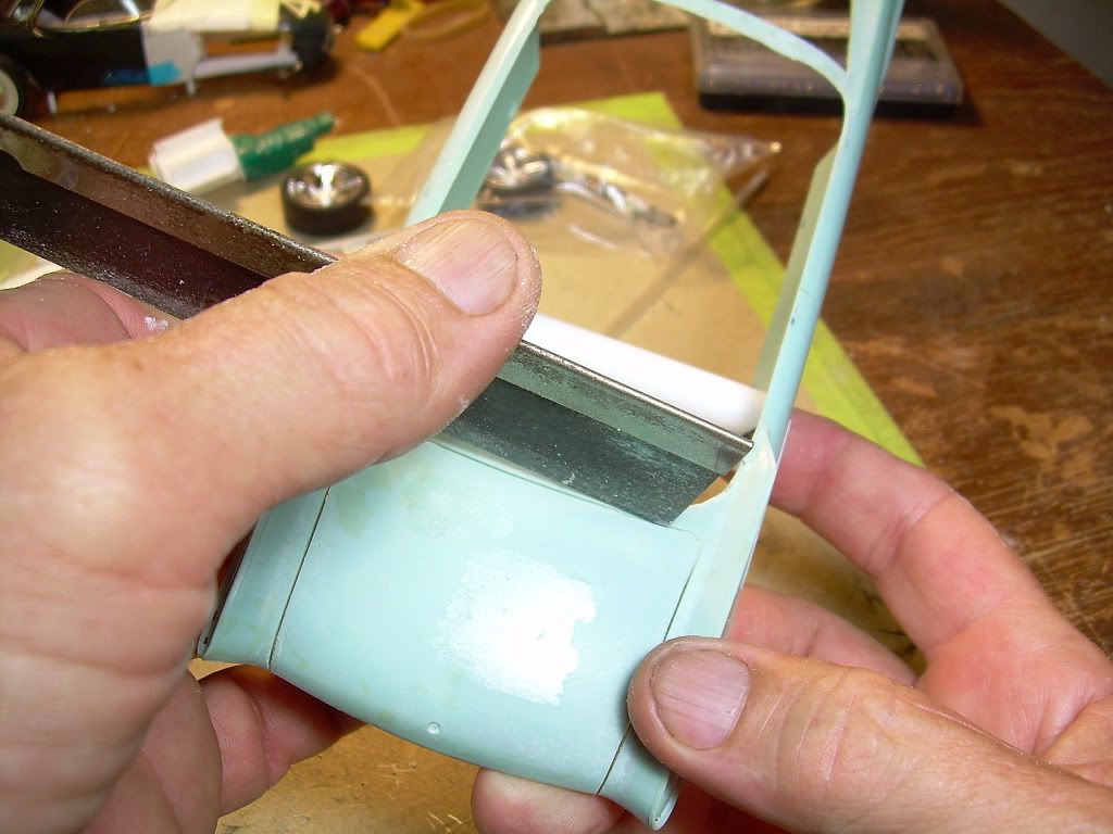

The decklid sides were straight cuts with the razor saw, and the front cut-line only required scribing repeatedly to deepen it to almost the depth I'd thinned it to inside. Then it snapped out, fairly cleanly.
Posted Image

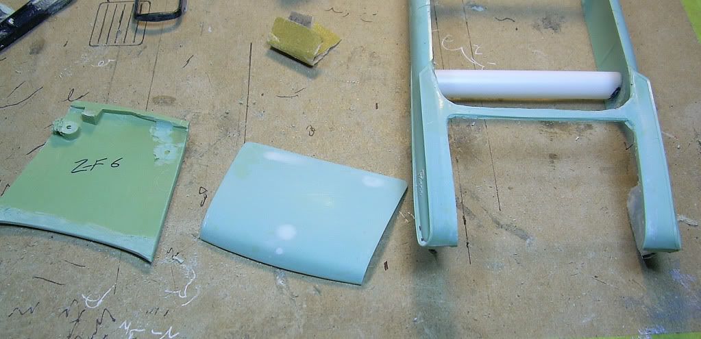

Open hood and deck, body still intact thanks to the tubular reinforcement. Starting to repair the sinks in the panels, to get them in primer and see how well they fit back in the openings.
Posted Image

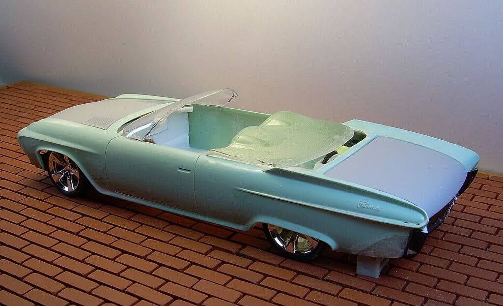

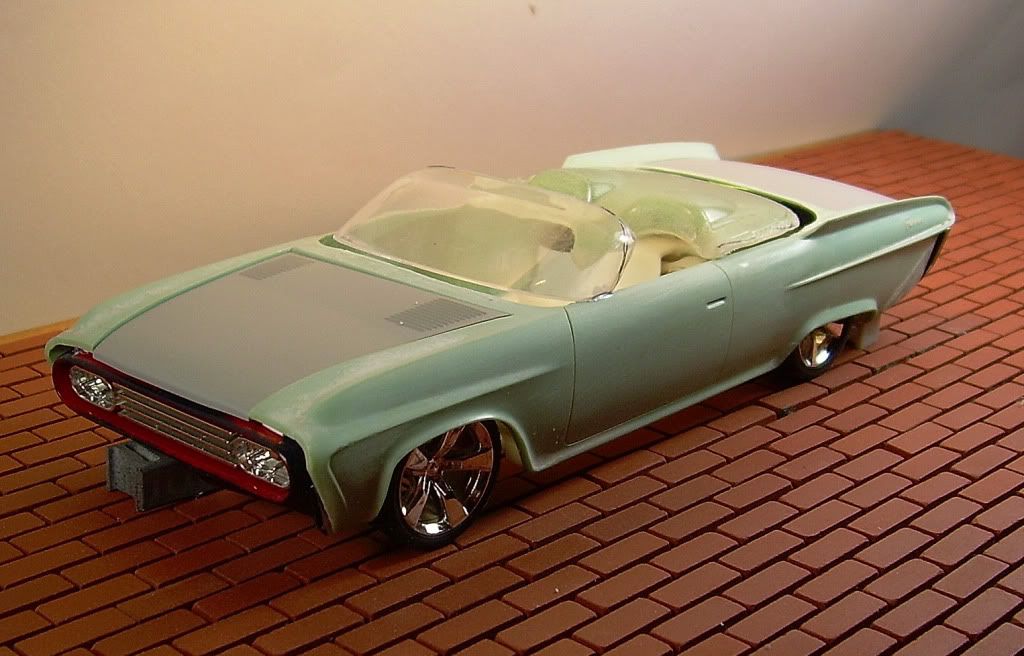

Fiddling with the nose and tail. Thinking of doing a floating surround for the grille. The rear panel I'd started to use has moved to the front, and a similar panel, again sort of Pontiac looking, has grown on the rear so both ends will have some design unity. Also moving the windshield back a few scale inches. Mostly dechromed at this point, too.
Posted Image
Posted Image
