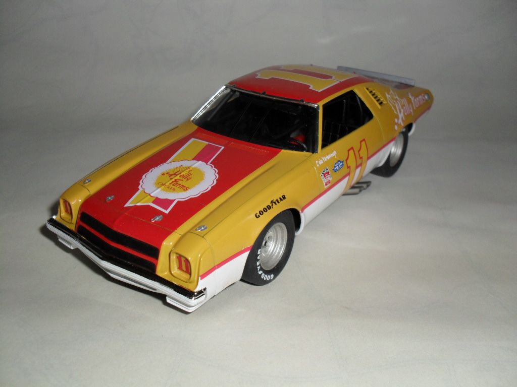

You can check out my recent WIP for a similar car, Cale's Holly Farms Laguna here:
http://www.modelcars...showtopic=54419
I used Monogram 1/24 wheels/tires to fill the wheelwells a little more.

Nice build Bruce!
Well considering DW only drove the Gatorade Laguna in '76 and '77....slicks it is! But I will use the advise about the Monogram wheels, they do look much better.
