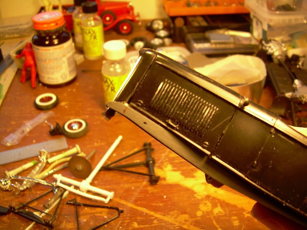

I've put this one back in the rotation, 'cause there's slow drying stuff on the other two current projects, and this one could see completion relatively quickly. This is going to be a '57 or so period hot-rod build, a car that would be seriously fast on the street, lakes or early dragstrips. It's been stalled for a while, but I've been on it again lately, and will bring the pix up to date as time permits.
Came in like this......
Much excessive glue holding everything together, firmly.....
some Dremel surgery........
...and an early mockup of where we're going....
The wedge channel job gives the car a little different profile than the standard hiboy or lowboy, and a little less drag for lakes runs.......

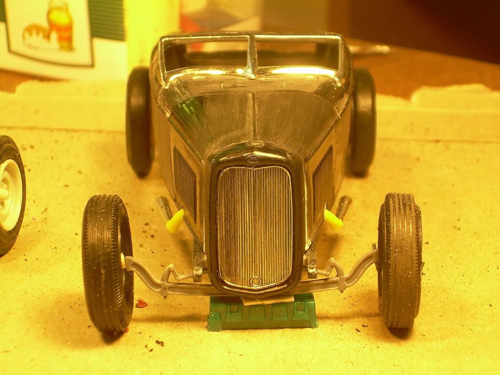

Got pics of how you got that stance?
#10 route66modeler
route66modeler
  • PipPipPipPipPip
  • 447 posts
  • Location:st.louis mo
  • Full Name:steve doing
Posted 15 June 2012 - 04:05 AM
me too. Steve
#11 Ace-Garageguy
Ace-Garageguy
  • 7,598 posts
  • Location:Down two, then left.
  • Full Name:Bill Engwer
Posted 15 June 2012 - 06:41 AM

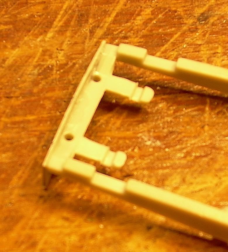

Yup. First thing was to substitute a model-A front crossmember from an original edition of the Ala Kart chassis. This was one way it was done in the day, to get an extra 1" or so of drop.
Posted Image
The kickup in the center of the crossmember allows the spring / axle to mount a little higher relative to the rails.
Posted Image

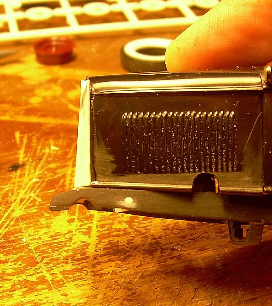

The frame rails are notched to clear the spring. The bottom of the rad shell is kicked a little forward too, to prevent the overbite look some '32s get.
Posted Image

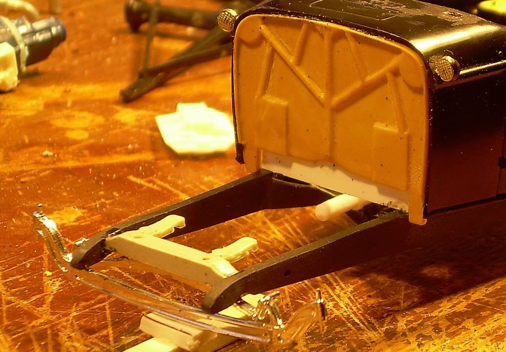

Had to fab a rear floor and new crossmember for the rear of this old AMT chassis.
Posted Image
Then the parts stash yielded up a '40 Ford rear from the Revell kit. Careful fitting and numerous measurements place the axle at the right height to get the desired stance.

I cleaned the parting lines and junk off the sides of the rails.
Posted Image
And this shot gives a better indication of how the wedge-channel works. Body is stock height at the rad, channeled in the rear.

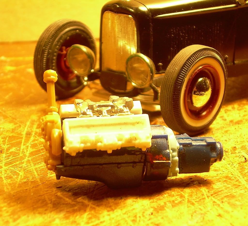

whats going powed it i would use a full house flathead
The engine will represent a 324 Oldsmobile, with 3 two-barrel carbs and a top-shift LaSalle gearbox hung on an Offenhauser aluminum adaptor. The engine is made up of vintage Revell and AMT parts, as when I started this build, there was no GOOD stock representation of the early Olds OHV V8. When the Olds 303 came out in '49, it had 135 hp, as compared to the Ford flathead's 100, and was the beginning of the end of the flathead Ford's dominance.
Posted Image
Engine in the chassis with a fabbed solid front mount. I'll probably rework the mount to the rubber-isolated style. The period-style headers are being modified from the Pontiac pieces in the old AMT '36 Ford kits.
