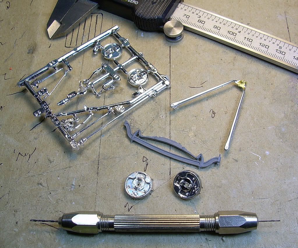

The dropped front axle I'm using is from many Revell model-A kits. It's a nice piece, and comes with working steering, but it also has model A mechanical brake backing plates, which aren't appropriate for a hot rod that represents a car with hydraulics. MOST fast hot rods got built with '39 or later juice brakes. They were almost a bolt-on, and vastly improved deceleration.
This is the chrome tree that goes with the axle, a set of juice front backing plates from the Monogram '30 Woody kit (which comes with later brakes) and the axle and wishbone from the A kit.

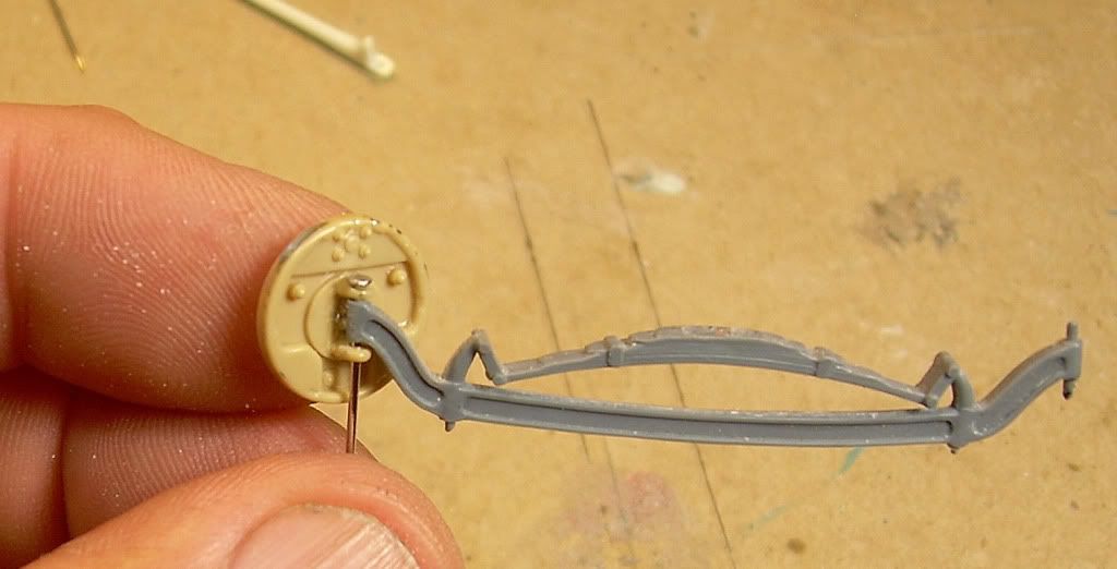

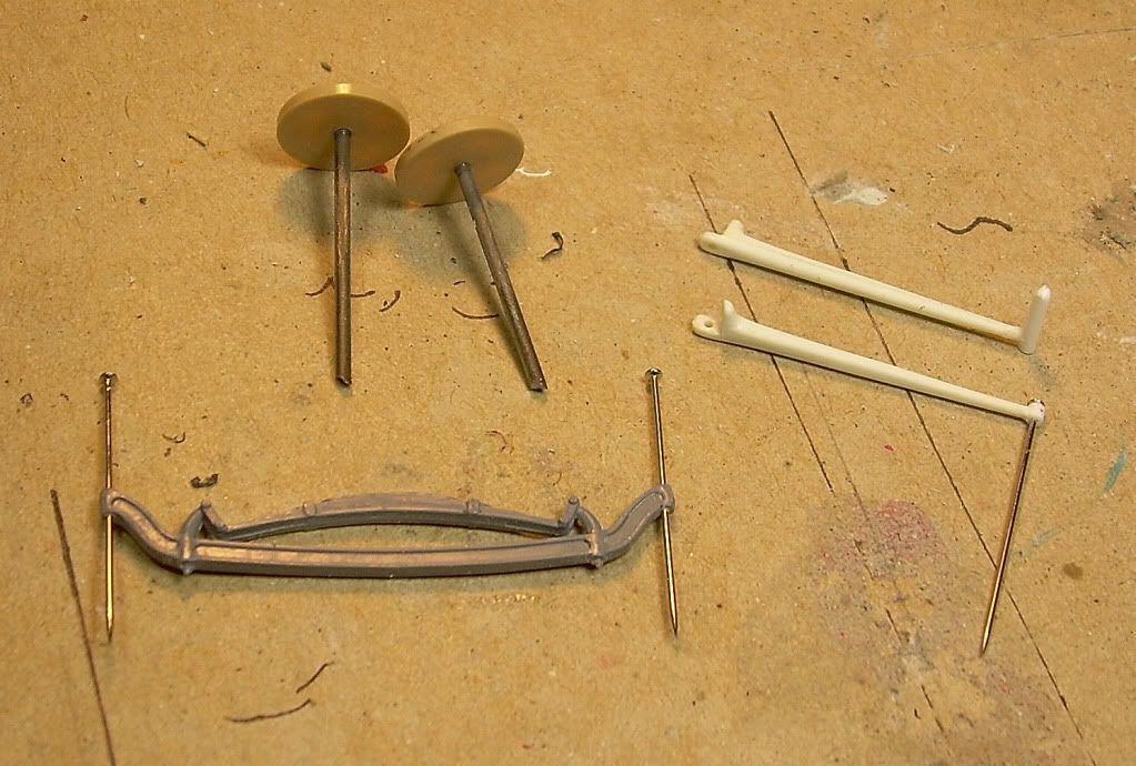

Axle and backing plate drilled to take a .030" kingpin.
Posted Image
Axle, split wishbone with the ends modified and drilled, and new stub-axles on the backing plates.
Posted Image

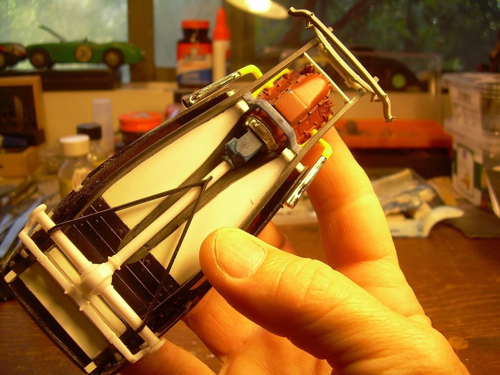

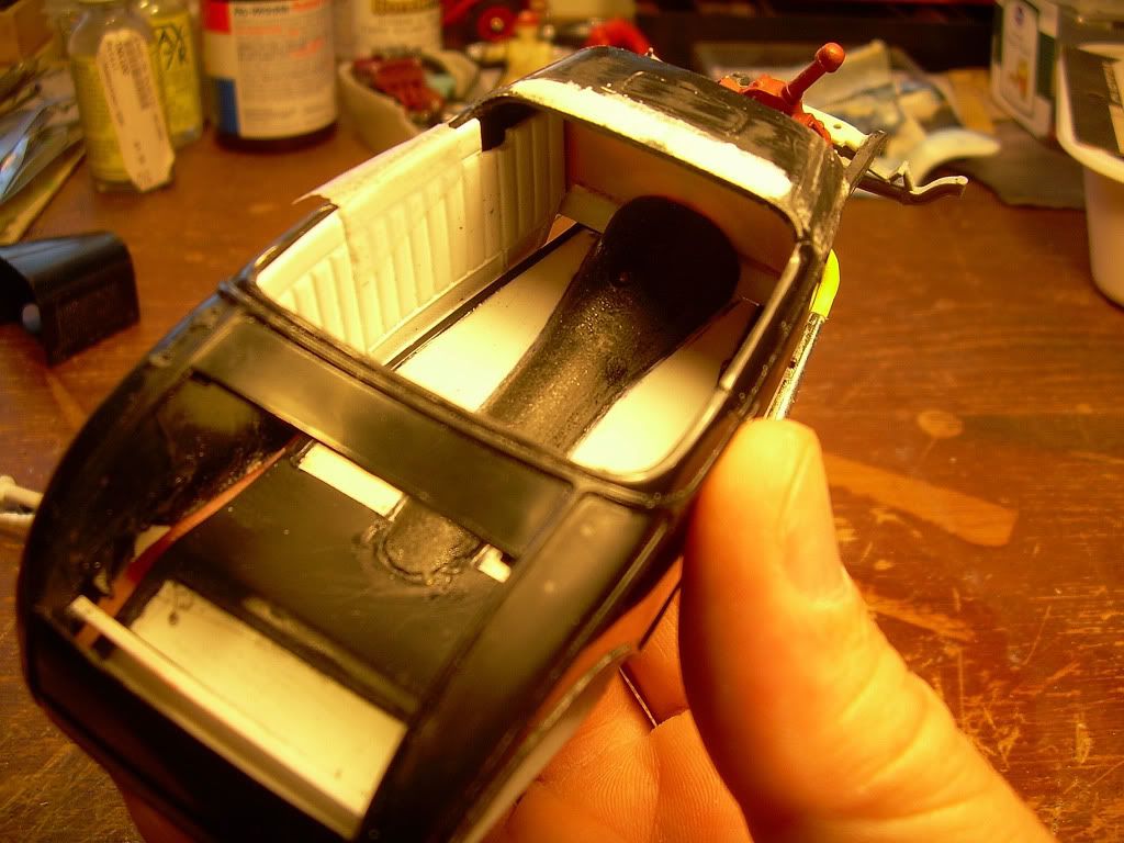

The Olds engine, the LaSalle box, and the mild lowering of the tail all conspired to necessitate a rework of the floor and tunnel. Floor is scratched from styrene sheet, and the tunnel was sourced from a parts-box interior tub. The Olds also requires a center mount at the gearbox, so all of the original K-member of the Deuce frame had to go......
Posted Image
Top view with interior panels being fitted......
Posted Image

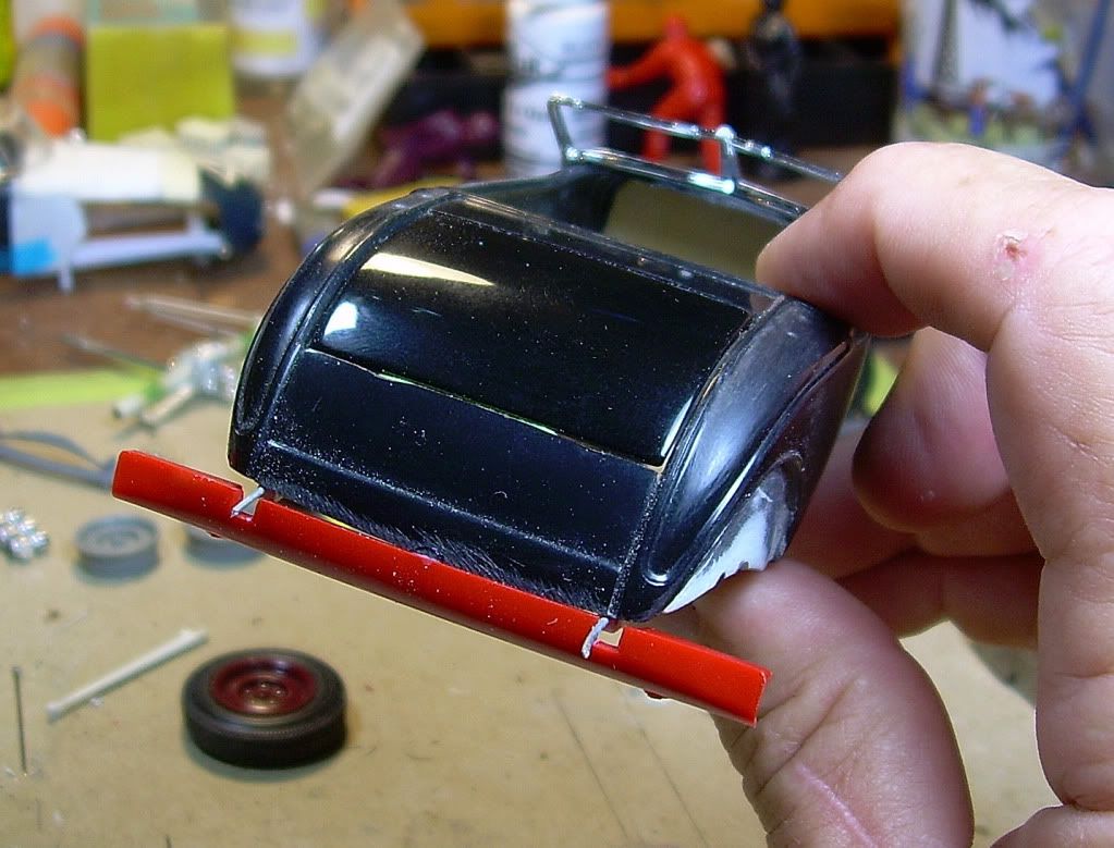

...and she's gotta have a rolled rear pan. This mystery valence from something has the right top curve to be the basis.

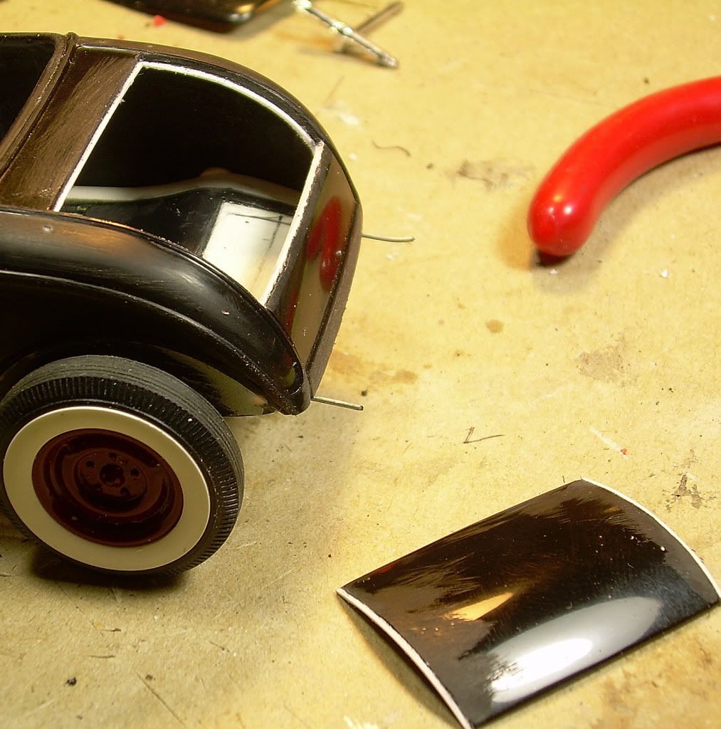

Some progress. Widening decklid and making up drip channels in rear of body.......

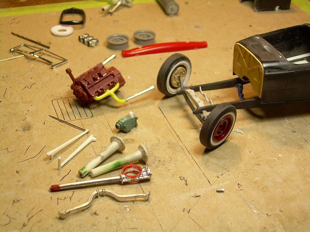

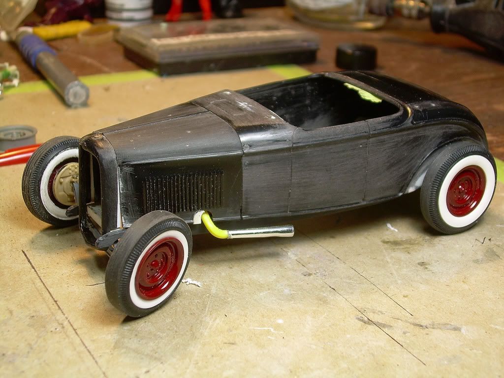

Worked out the through-the-cowl steering linkage, and the ahead-of-axle tie rod layout. This would have been necessary on a 1:1 to clear the big Olds engine, and to accommodate the dropped axle. There was a starter relocation adaptor that put the starter on the right of the Olds and allowed the '32 steering gear to be used, but I like the racecar look of this setup.
Posted Image

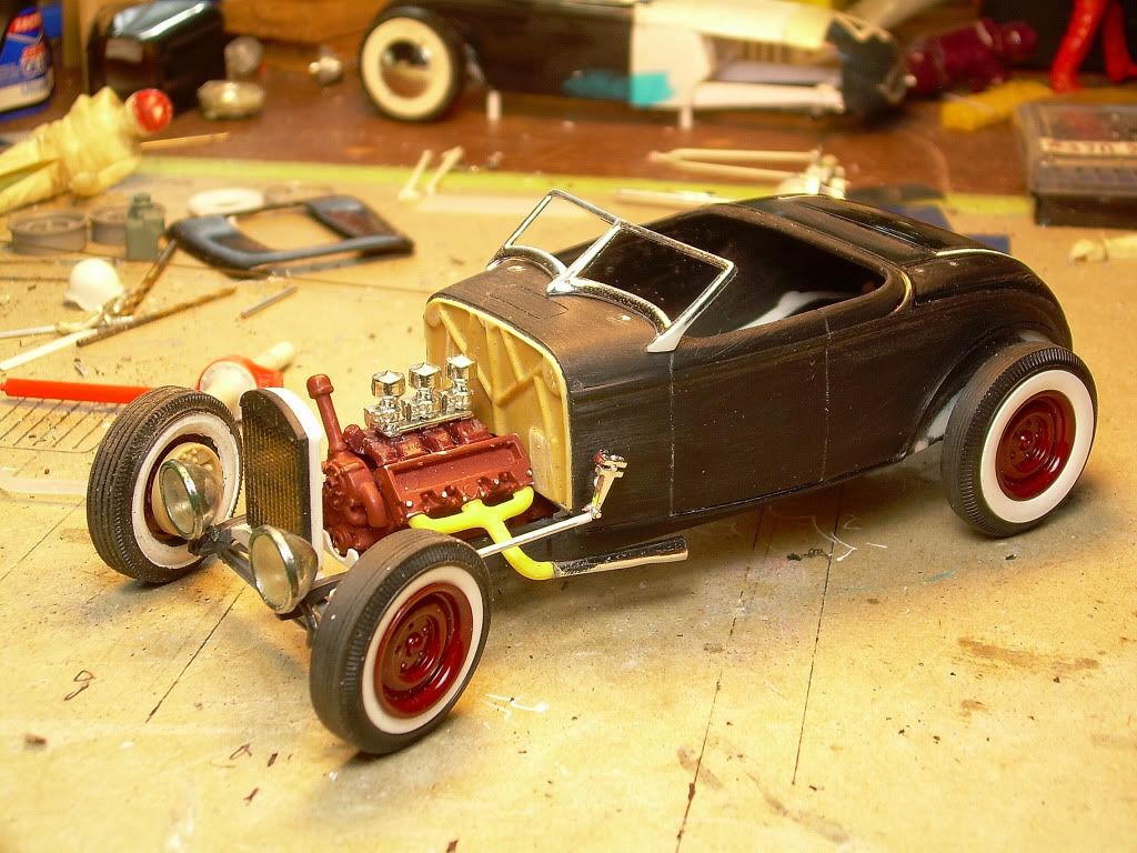

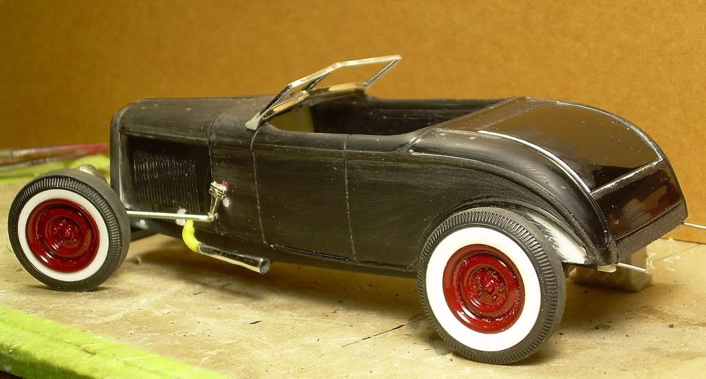

Having the steering linkage finalized also let me finalize the locations of the headlights, and it all worked out just like the mockup. Lucky. The headlight buckets will mount on 1" scale tubular brackets, and shock mounts will also be fabbed in behind them.
Posted Image
Close to being ready for primer. Still have to do the quick-change, and see where that will put the rear rolled pan to allow the QC to show.
Posted Image
