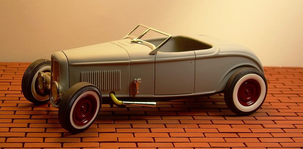

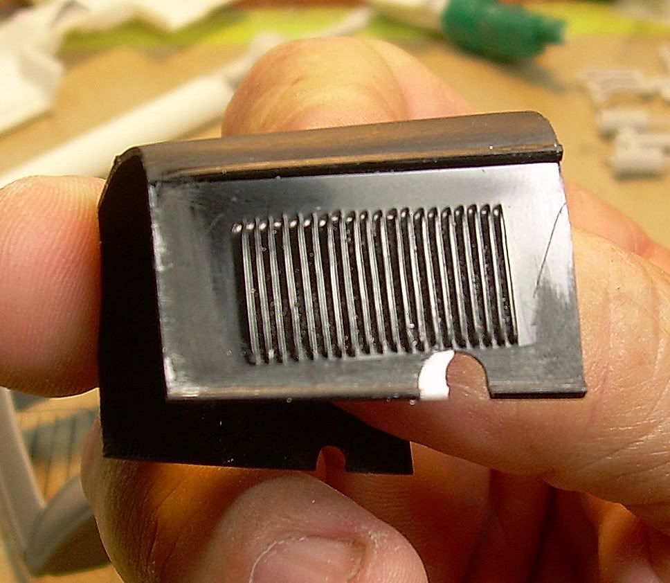

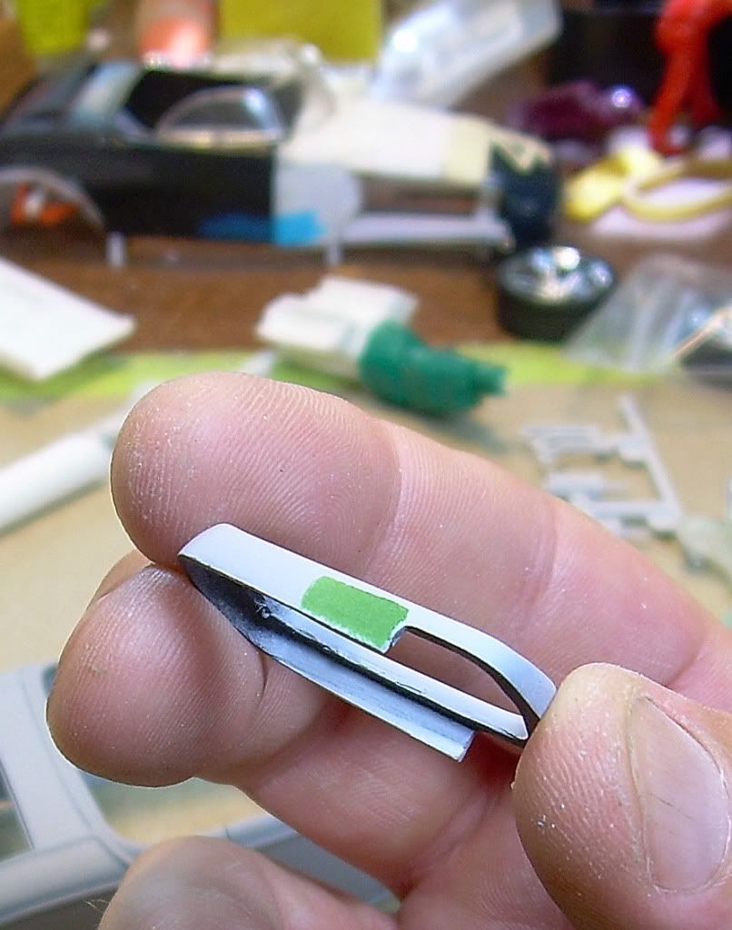

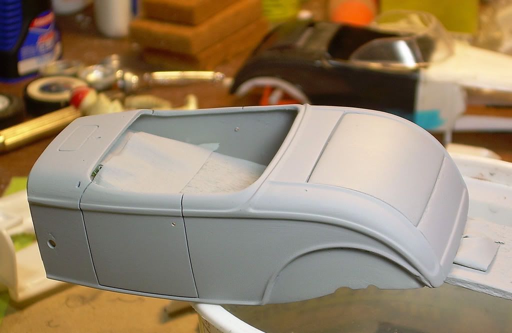

Got enough of the bodywork squared away to start with the primer......
Posted Image
Still have some issues with the resin firewall that need to be addressed....
Posted Image
Had to make the roll at the bottom of the hood side where I'd cut the exhaust opening in the wrong place. Styrene half-round rod. Will primer today.
Posted Image
Also finishing up the extensions to the grille shell, to kick the bottom forward a bit. I'd originally put the extensions on the hood sides, but the resultant angle made it impossible to easily remove the hood. Duh.
Posted Image

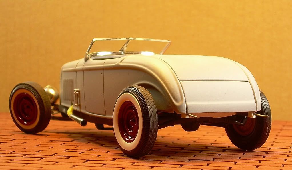

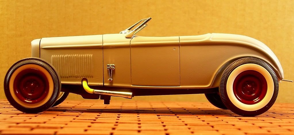

Posted 07 July 2012 - 05:00 PM
Getting there........letting the primer shrink in while I work on other parts of the build.
Posted Image
Posted Image
Posted Image

Posted 07 July 2012 - 05:37 PM
looks good. Where are the Door hinges?
#47 Ace-Garageguy
Ace-Garageguy
  • 3,377 posts
  • Location:Down two, then left.
  • Full Name:Bill Engwer
Posted 07 July 2012 - 05:46 PM
Ummm......Gone? It wasn't uncommon at all to put hidden door hinges on these things. Not real common, but doable and a well known mod back in the dim recesses of time. The car's going to be gloss black lacquer, and I just didn't want to fiddle with sanding and polishing around hinges....so, they're "hidden".

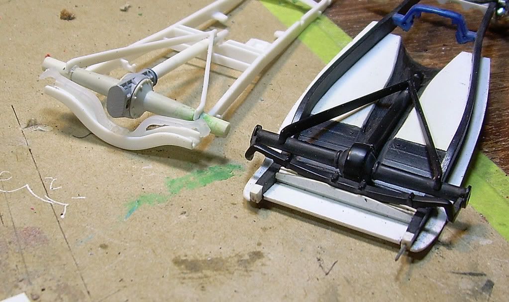

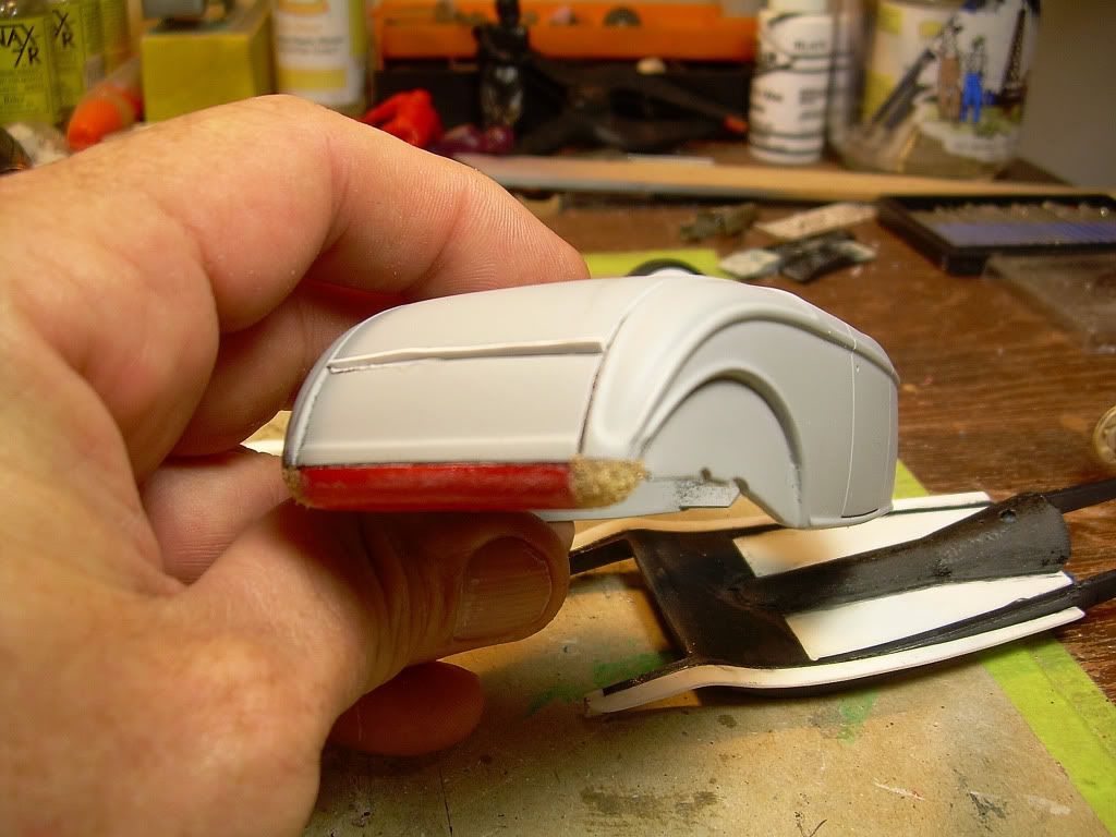

Well then....decided to go back into it and do the quick-change rear end, and a rolled-rear-pan to go with it....all very period, high-end hot rod. The rear of the AMT body shell isn't exactly accurate, so I cut it off where the real '32 shell ends, and removed some material from my basis for the pan....
Posted Image
With it stuck to the car, I'm trying another new experimental technique. Using closed-cell urethane foam blocks glued in place to shape the rounded corners.....
Posted Image
Getting there. Will probably saturate the foam with epoxy before finish-shaping and bondo. I also noticed a fit-and-square issue with the decklid, so that's getting corrected.
Posted Image
And on the the QC. This is all the stuff to do the quick-change swap....Existing '32 frame with a '40 rear end and spring on right, '28-'31 model A frame in the center, with an AMT '32 Vicky or Phaeton rear end, top; the QC and some widened axle-bells from the AMT Fiat double-dragster kit; and a model T rear spring from a vintage Revell roadster parts-pack.
Posted Image
Last shot shows the way the model A rear crossmember will clear the QC, but obviously the one I fabbed to use the '40 diff won't. Stay tuned...........
Posted Image
