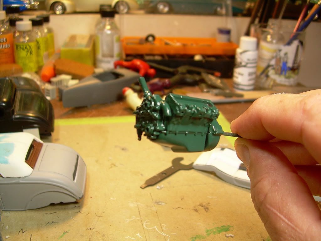

First off, please pardon the fuzzy pix. Seems I'm a camera doofus today. Had to rebuild my Dremel and dropped some little parts too. Doofus all around today.
Painted the engine about the right green for a 303 Olds after drilling the spark plug holes and the oil filler tube.

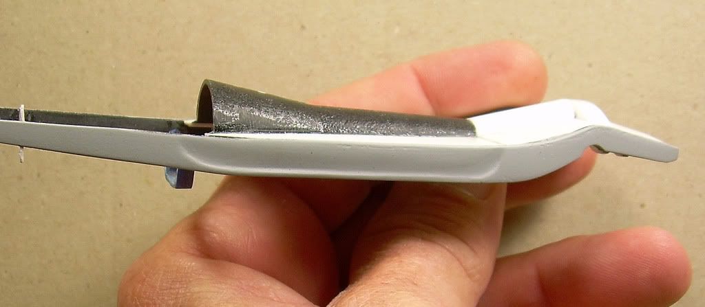

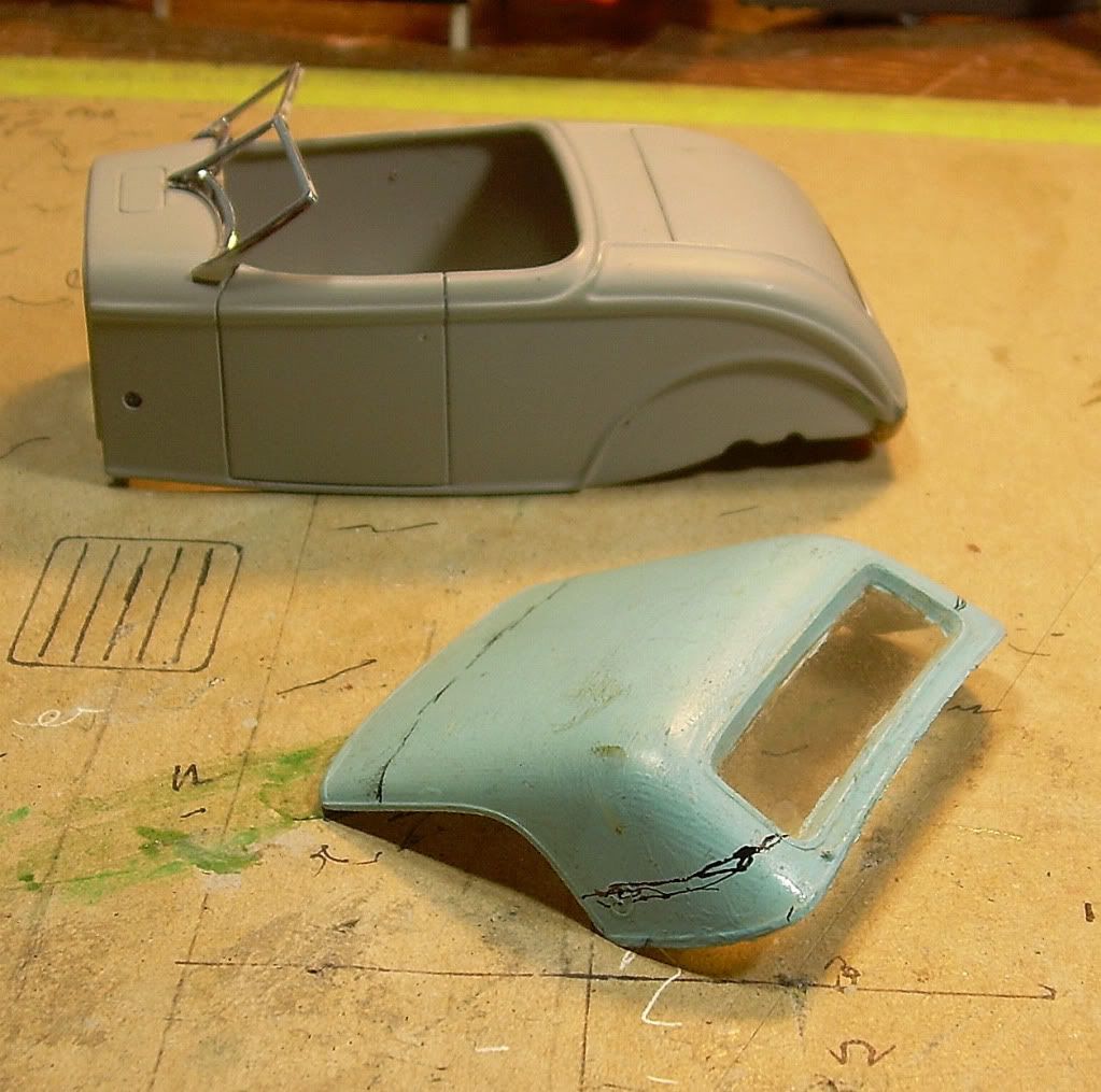

.....Started making up a Carson-style top from a '55 T-Bird unit.....
Posted Image

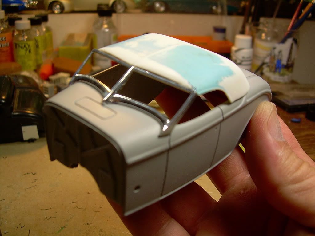

Chopped it to get the profile...
Posted Image

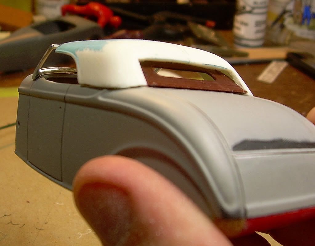

Narrowed it, shaped it to match the Vee of the DuVall, and will have to make corner extensions to match.....
Posted Image
And will set in an oval back glass from another parts-bin top....
Posted Image

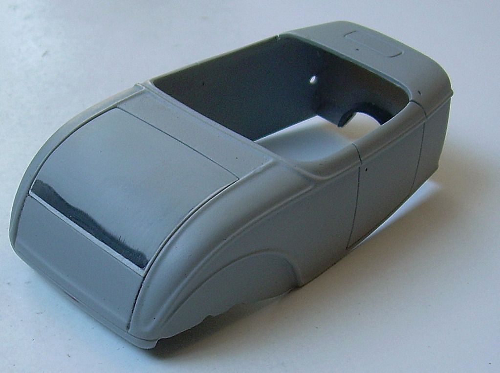

Rear rolled pan with the rigid-foam corner-fillers filled with epoxy/cotton flock slurry, as well as the corners of the Carson-style top. This stuff is WAY stronger than bondo or any other conglomeration of baking soda / superglue or whatever...I don't like to have my work break and fall off. Or shrink excessively.
I've also reinforced the inside of the pan-to-body joint with fine glass cloth, as I want to deeply scribe the joint line on the outside.
Posted Image
.....the result, just about ready for primer....
Posted Image

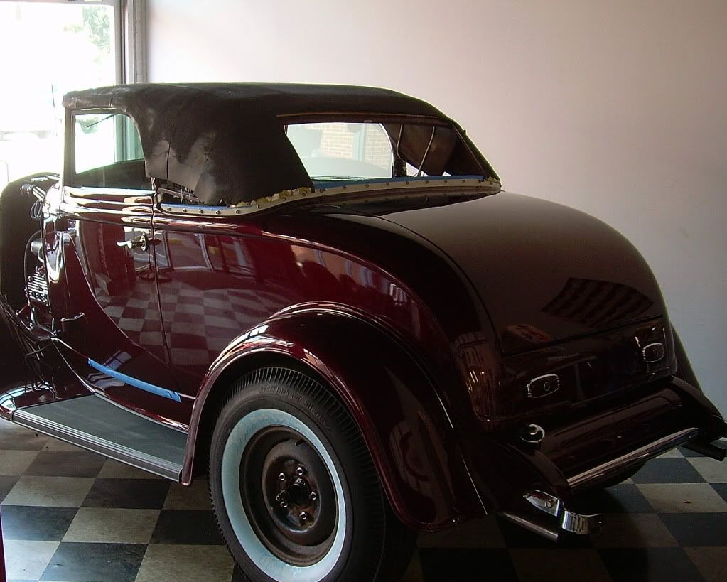

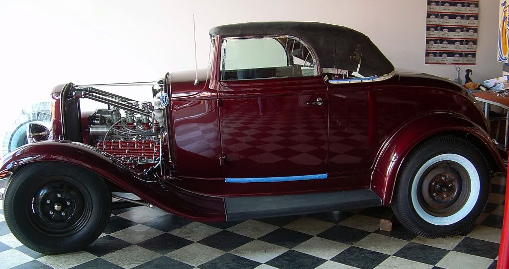

The inspiration for the Carson-style top idea came from the Bill Cox '32 cabriolet, a February 1961 Rod and Custom feature car, currently nearing completion in the shop here. It's being restored to its '61 condition, after having been through a sucession of owners and modifications. It's slated to be re-introduced at the Grand National Roadster Show in Pomona, Ca., in January.
Anyway, I liked the lines of this custom top so much that I decided to do something similar for this build. Though the 1:1 Cox car doesn't have the laid-back DuVall windshield, this is the look I'm going for, with the curved side-window opening, etc.
Posted Image
The rear 3/4 view works very nicely with the rear line of the '32 body.
Posted Image
Posted Image
