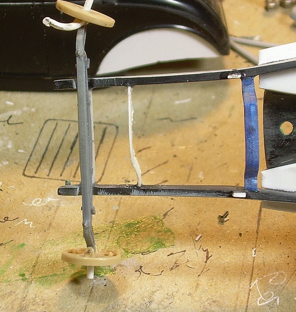

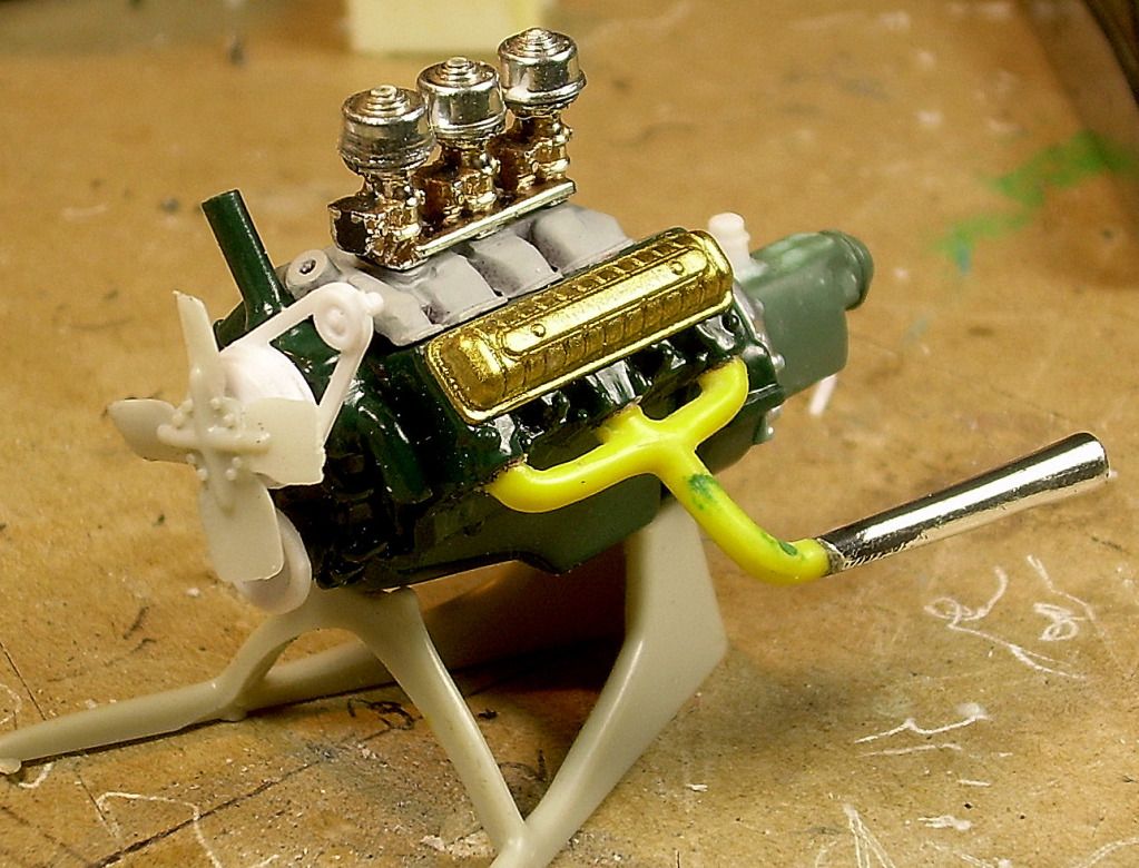

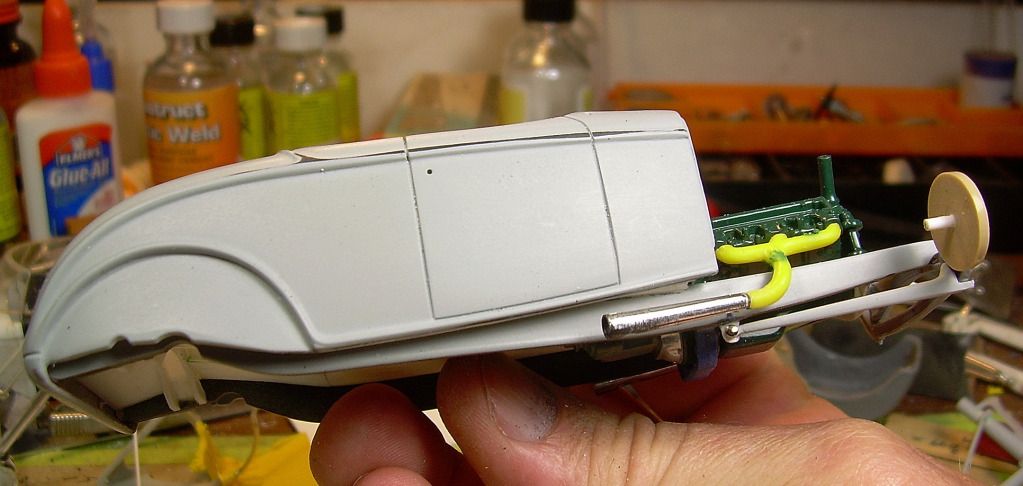

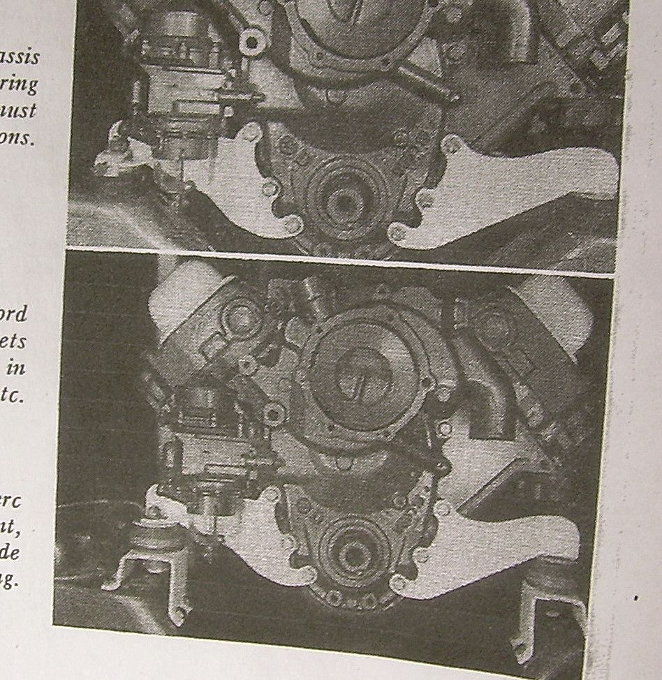

Getting close to the end, final fitting prior to paint. Got to looking at how the Olds mounts, and the fuel pump seemed to be in the way for what I had in mind. Got to looking through some HRM back issues and came on this aftermarket mount that clears the fuel pump by going behind it....
Posted Image

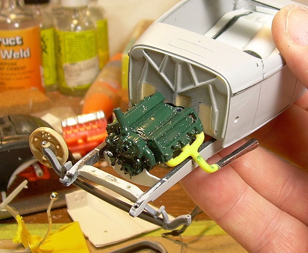

...so I made one with a similar joggle.....
Posted Image
....then had to shave a little more off of the firewall to clear the heads and the distributor.......
Posted Image
Got brackets for the wishbones on and drilled....
Posted Image

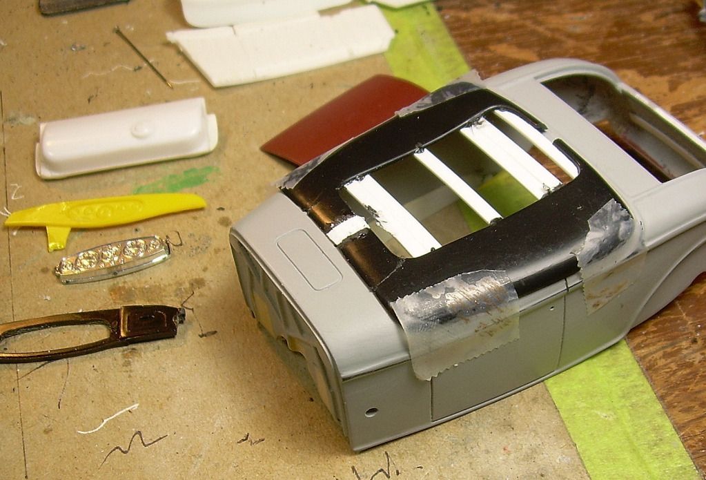

...and started widening an old tonneau from something else to fit the '32 right, and to offset the aperture for the driver to the left, as I want to display the car stripped for lakes running.....
Posted Image
Happy with the fit of everything underneath, so on to primer on the frame.....
Posted Image

I don't remember seeing that Offy adapter in my stuff. Did you scratch it? Or where'd it start from?
The trans adapter is from one of the first-gen, Olds powered Revell Stone-Woods-Cook Willys kits. In the kit it mates a B&M Hydro-stick (based on the early GM Hydra-matic) to a first-gen Olds V8. The molded-in mating-profile for the gearbox isn't right for the LaSalle, but in 1:1 could conceiveably have been redrilled to accept it.

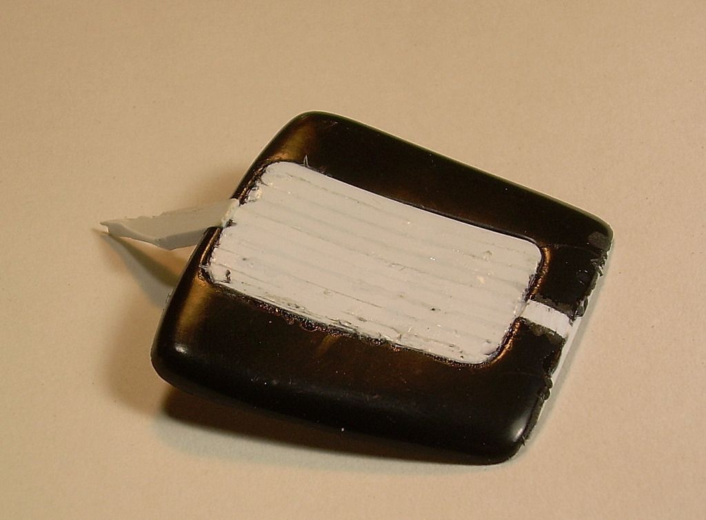

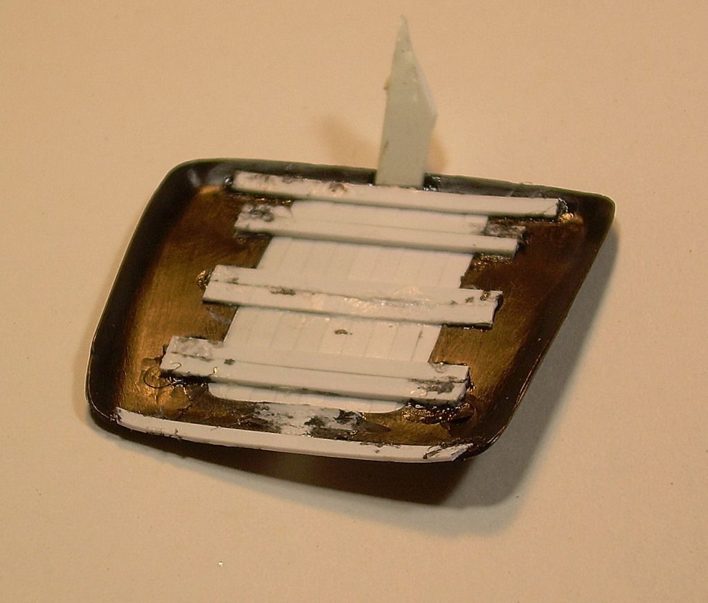

Filled in the top of the tonneau with .015" strips. Ready for filler as soon as I trim the tail. Workmanship doesn't have to be pretty, as I'm going to pull a mold of this and make the final part in fiberglass. Fit is important though.
Posted Image
Posted Image

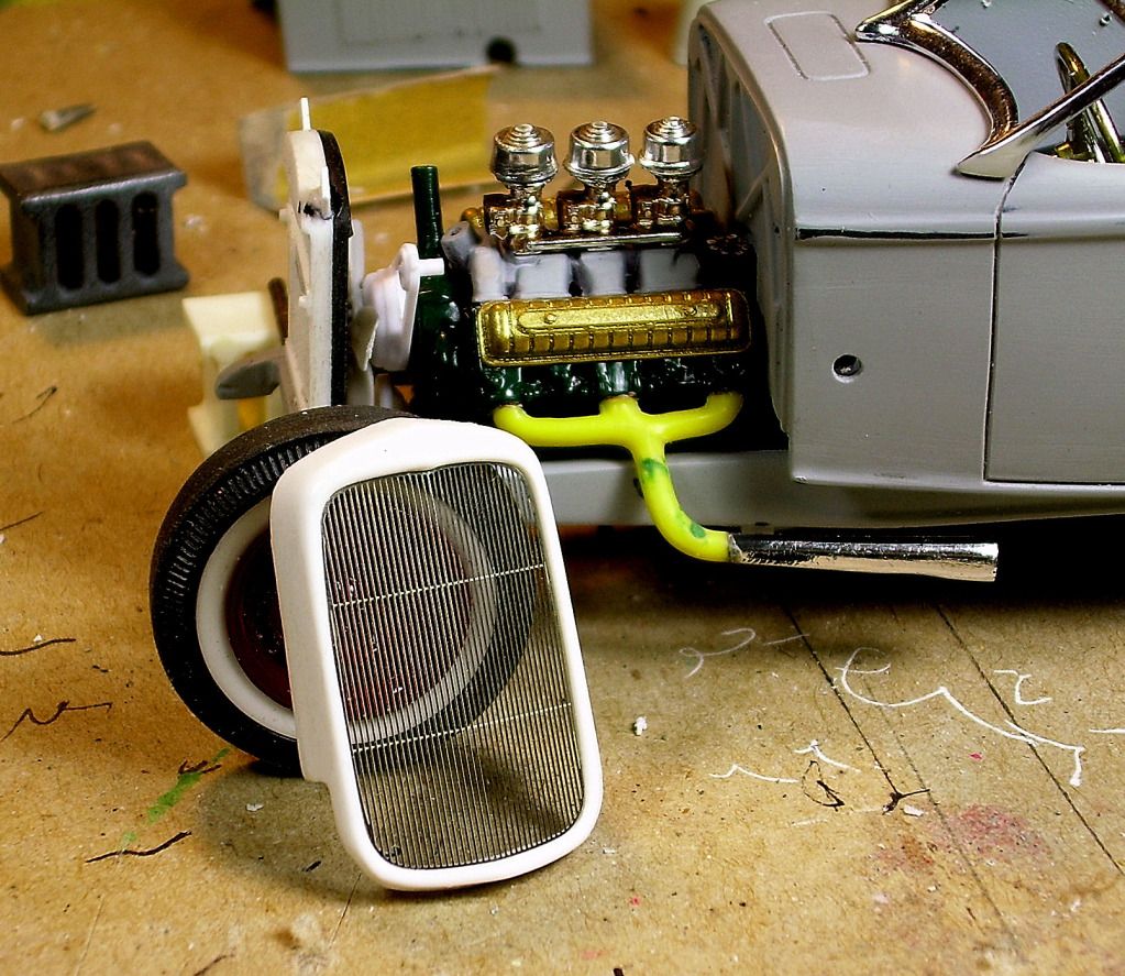

Built a custom dash panel, adapted some Mercedes instruments and fitted a center-steer box for the cowl-steering....
Posted Image

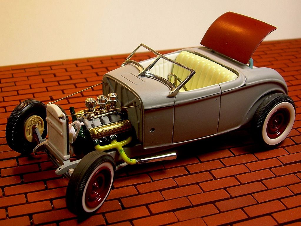

Made a lot of engine progress, including almost finishing the AMT '40 Ford / Olds manifold. Also adapted the Revell '50 Olds pulleys and will hang a generator from bracketry over the left head.
Posted Image

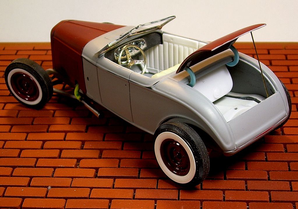

Hinged the decklid, fitted the fuel tank and most of the interior and painted the seat.
Posted Image
Sprung for a PE grille insert.....
Posted Image
...and sat back and enjoyed the view.
Posted Image
I think the work on the rear pan and the QC rear end was worth the effort.
Posted Image
