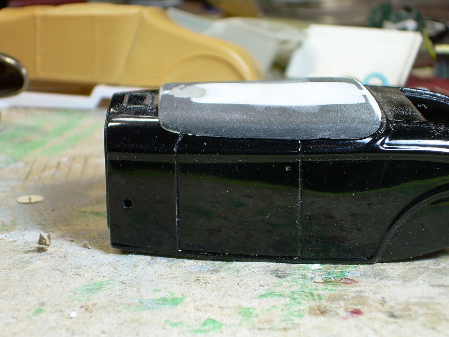

One of the things I'm trying is Ace Hardware black rattle-can lacquer. It's cheap for a lot of it, and it covers very well. I've already experimented with sanding / polishing it and it gives the finish I want for this period build...NOT clearcoated and looking like it was dipped in syrup. There's some peel in this shot, but it'll all come out in the end. I let the primer shrink in for months and then final sanded just before shooting the color. Stupidly, I neglected to clean the body with 70% isopropyl alcohol first. The other side is horribly fisheyed, and will have to be sanded back to primer. Stupid. When I saw what was happening, I let it flash and then cleaned THIS side with isopropyl before painting. No problem.

Gladly.. I had a lot of repair and remedial work to do on this one. It just takes a little time and patience.
This is the 'bad' side after I'd washed off the horribly fisheyed black paint (while it was still wet) with 70% isopropyl. The alcohol attacked the Duplicolor primer a little bit too, so the entire side of the car had to be re-sanded with 400 grit wet.
While I was at it, I re-sanded the 'good' side with 600 wet to level the orange peel in the paint.
Bad side with 3 new coats of Ace Hardware rattle can black lacquer. This will need to be sanded with 600 wet and re-shot, to make it as slick as I need.
Good side with 3 more coats of black lacquer. Orange peel this time is less noticeable, will sand and polish out.
...and just for fun, I finished up one of the wheel / tire assemblies to get a better idea of the final look...
Edited by Ace-Garageguy, 12 July 2013 - 01:43 PM.

Paint on the body is sanding and polishing nicely, and there seems to be plenty there to get the look I want without going through it. This is Ace Hardware rattlecan black lacquer.
