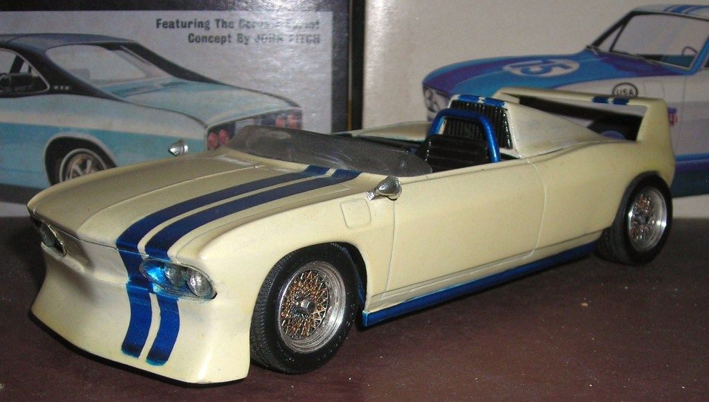

That very yelloewd "white" paint gives you an idea just how old this model is! I love the look of those wheels on this model!

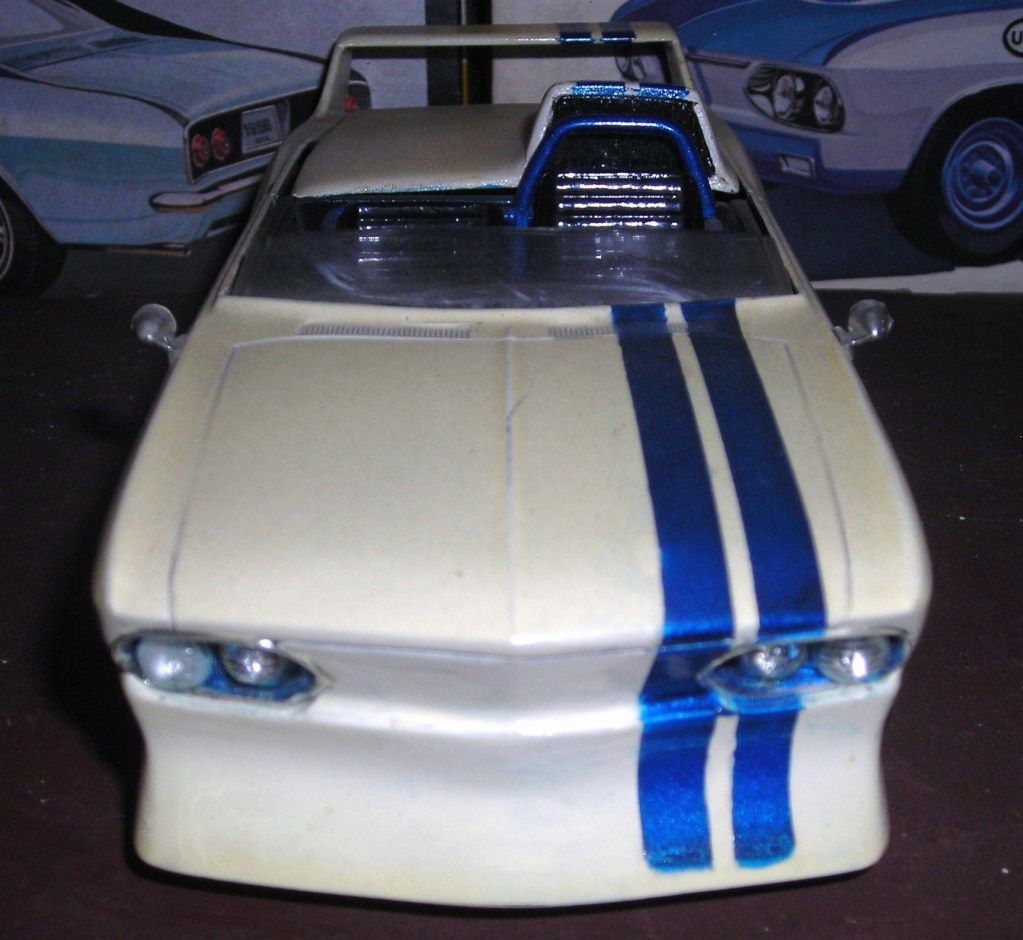

White with blue stripes were the official American racing colors, as dictated by the FIA. When sponsorship became such a huge deal right around that time, the traditional national colors went by the boards.

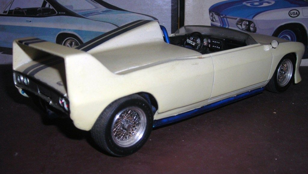

I kept as much of the Corvair's character alive in the Sports Prototype version as I could, keeping the standard taillight area intact, for instance, and running the lower body character line back through where the original rear wheelwells were.

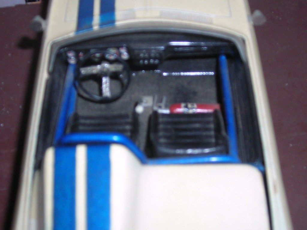

Sorry it's so dusty in there! It's hard to keep an open-bodied model clean on an open shelf! Anyhow, the fire extinguisher is entirely scratchbuilt, and I added several gauges to the instrument panel.

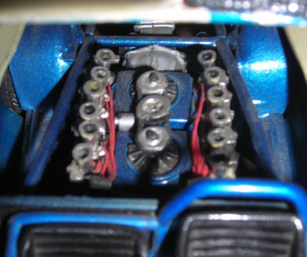

A flat-12, several years before Porsche had one!

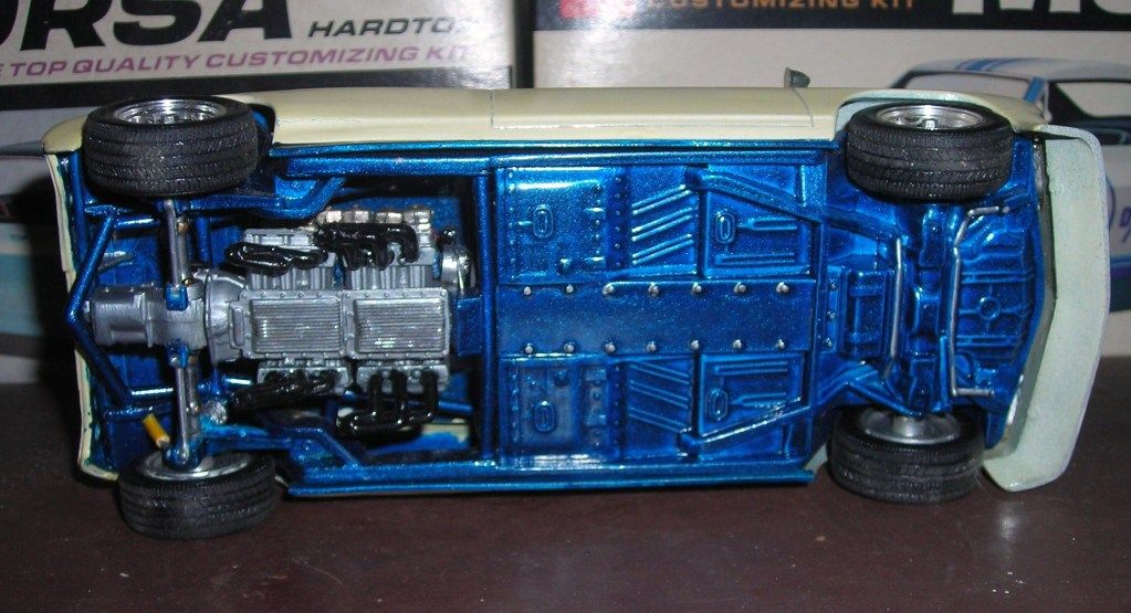

Underneath, I probably should have done more with the exhaust headers than just letting them dump the spent gases under the car!

OMG! Wild concept & even wilder execution! That thing would be wicked on the straights. l like the blue stipes. The cockpit looks cramped but very functional. The lines of these cars flow beautifully & l'm glad to see your mods added rather than detracted from the look. Beautiful racecar! l would be very proud of this one. Bart.

How do you make the front smooth after removing the chrome trim?

Nice catch, Maxx. That is one of the problem areas of this body that AMT never did get right. The front panel isn't supposed to be concave between the headlights and the central peak like they molded it. I just went slow and easy, filling it a layer at a time until it was level, and evening it out between rounds of filler with a sanding board. I had to re-scribe the trunk lid line while the putty was still soft each time or risk losing it completely. Removing the trim bar made this a lot easier! Now if someone would come out with a photoetch set for the Corvair kit (Yeah, fat chance of that ever happening!), I could smooth out the front panel on all my "Late Model" (1965-69) Corvair builds, since I wouldn't have to worry about losing the nameplate beside the driver's side headlights.

Long live the Air Suckers!!!!!,cool lil' concept,love the 12 "cans"!!!!!,now that would be a "Buzzin' Dozen"
