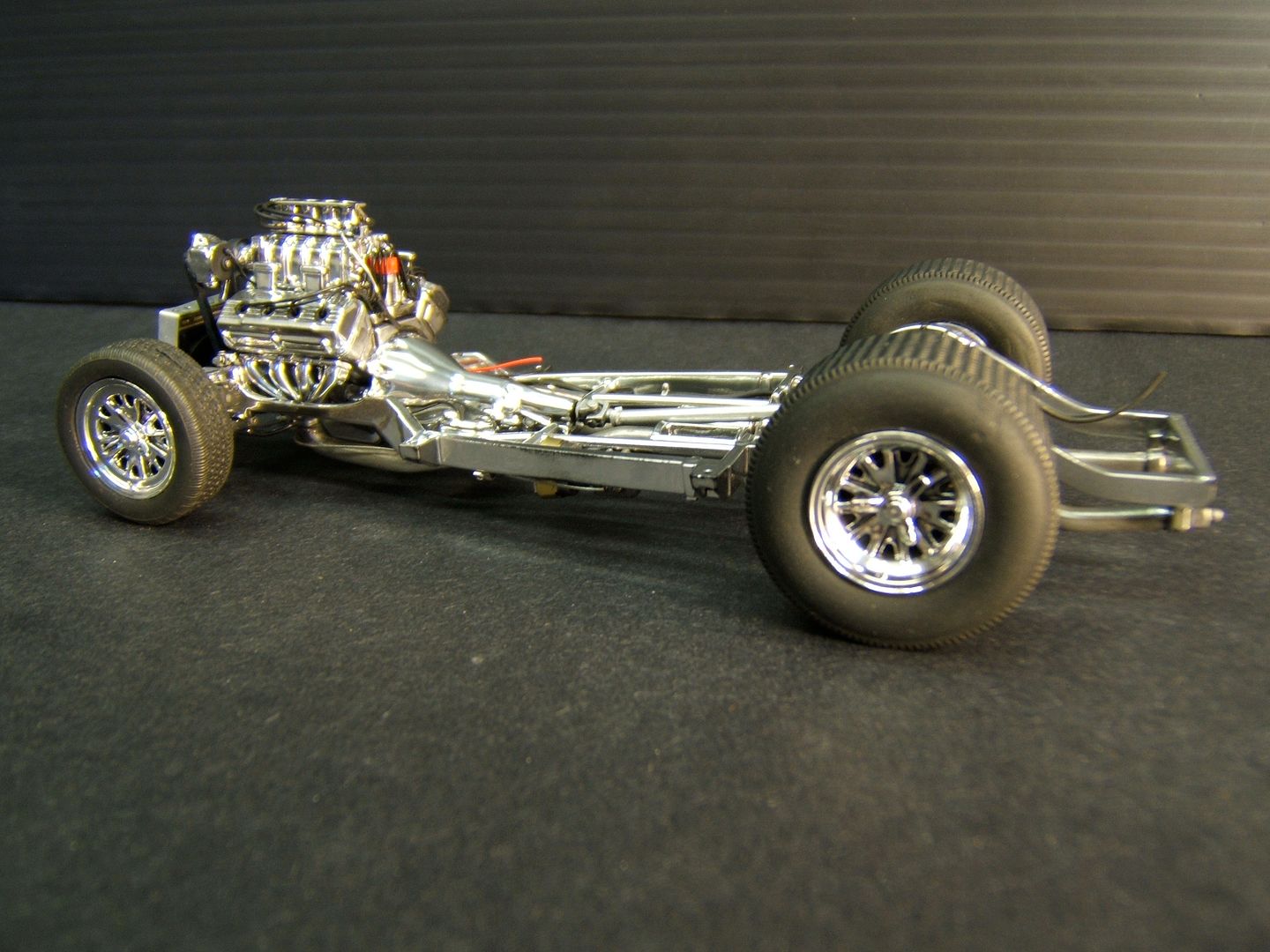

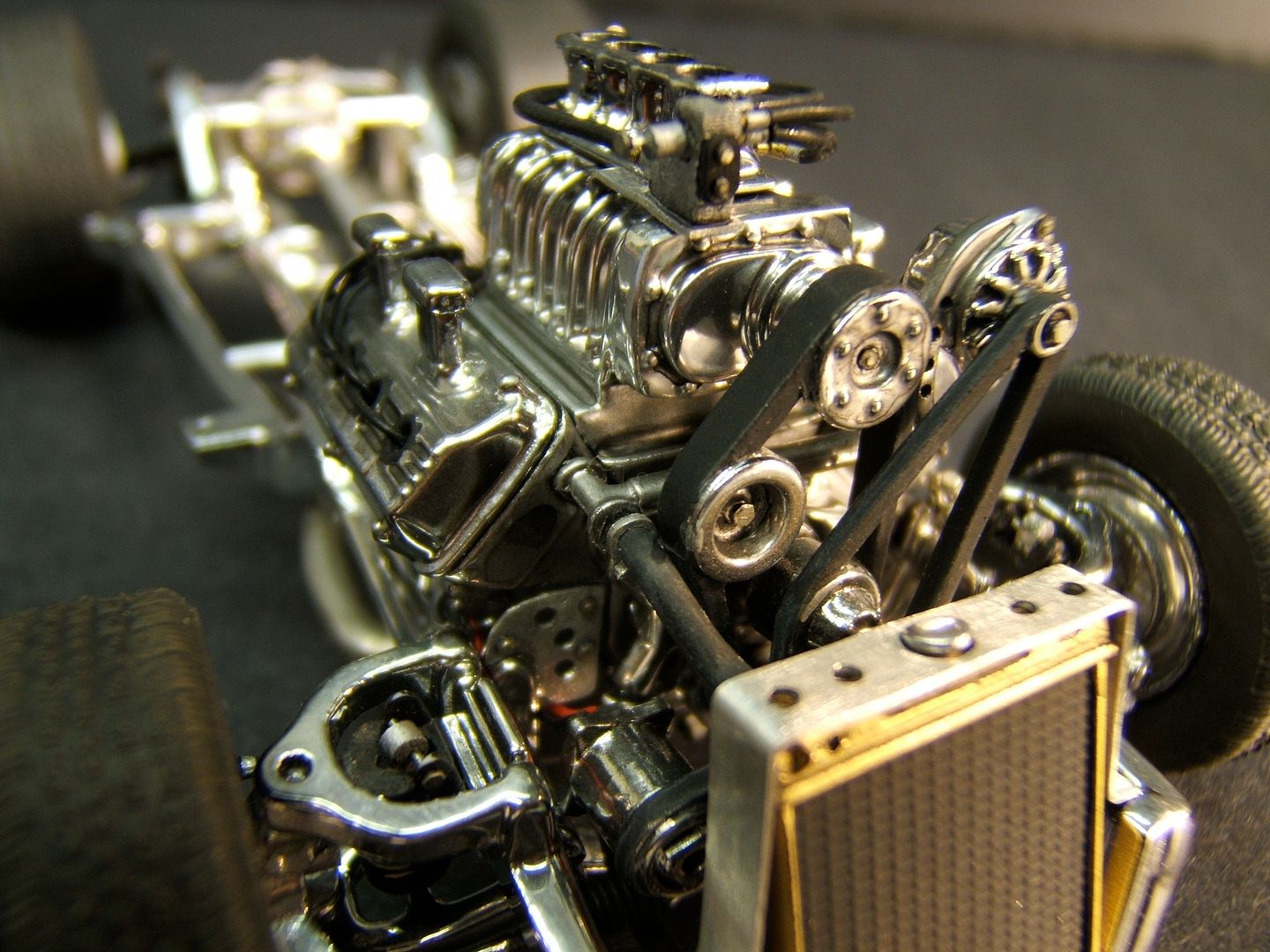

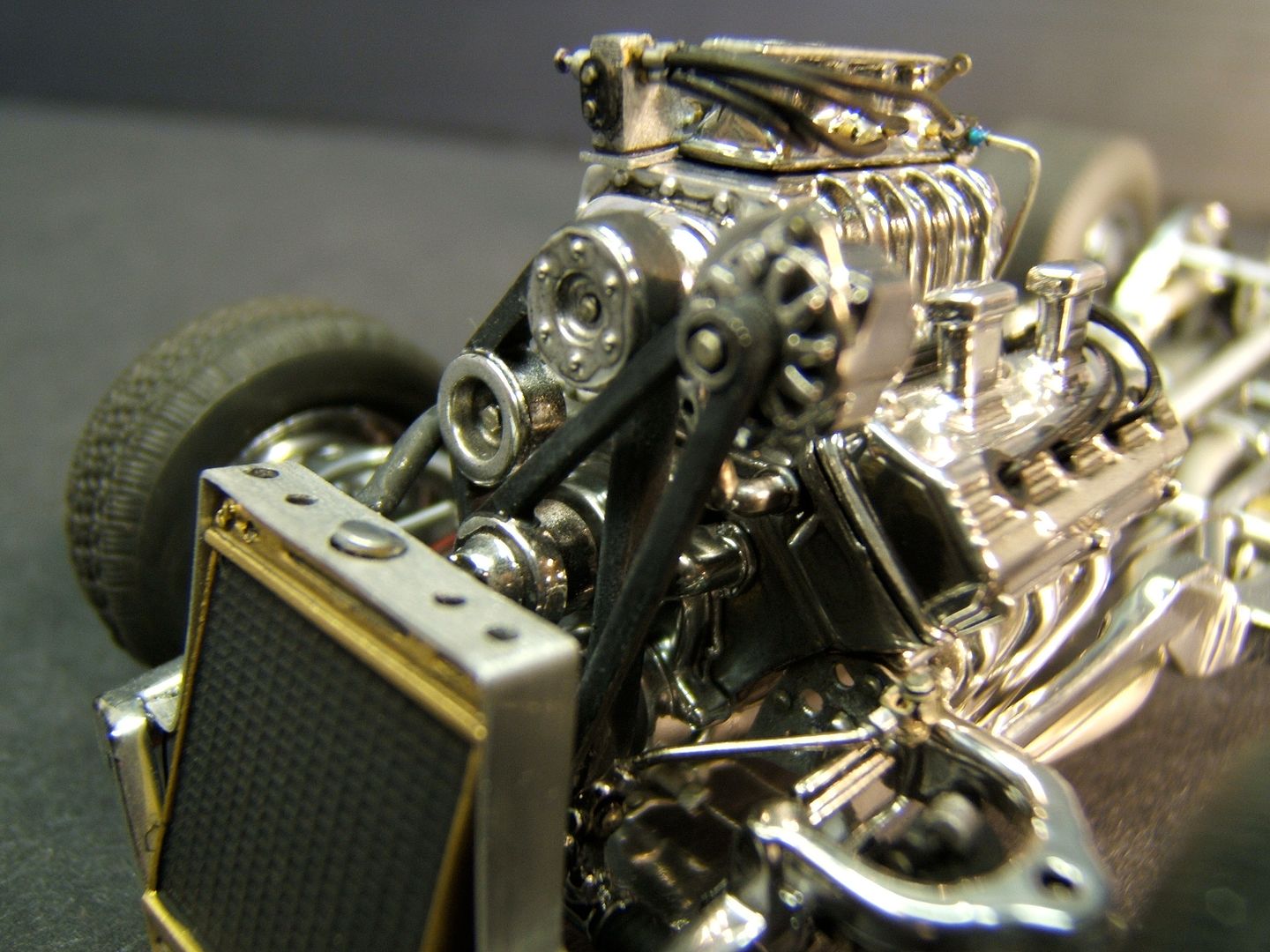

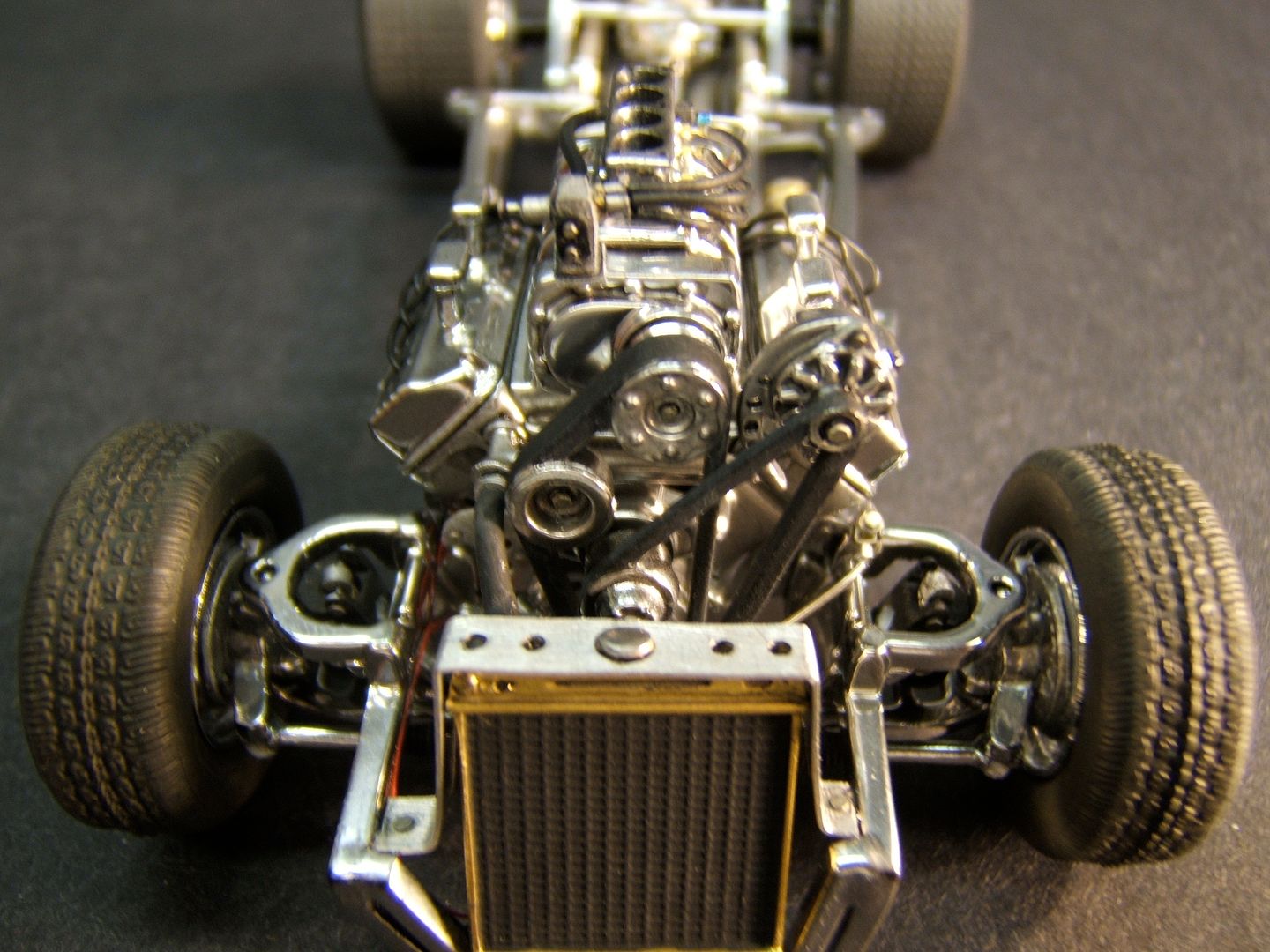

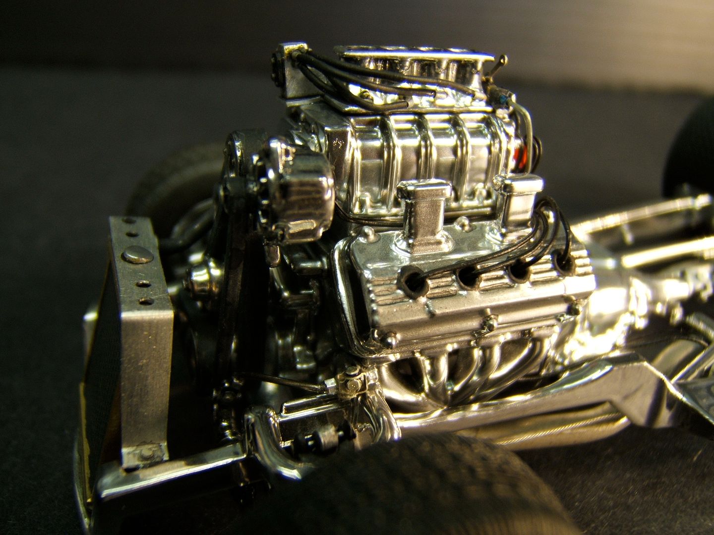

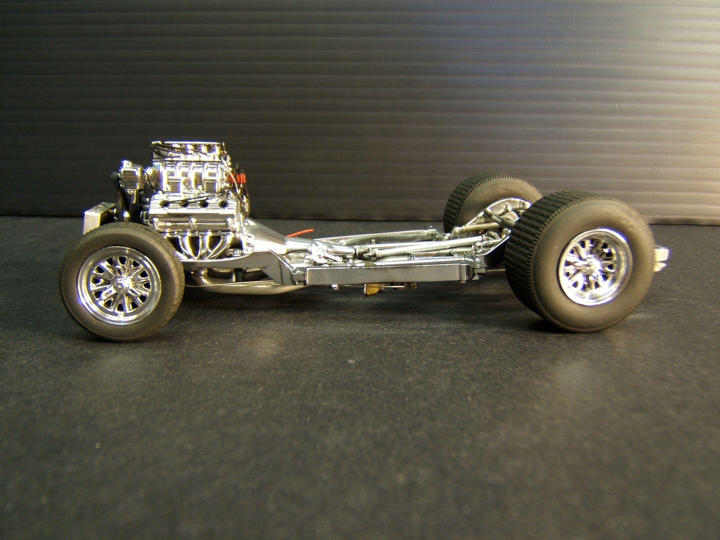

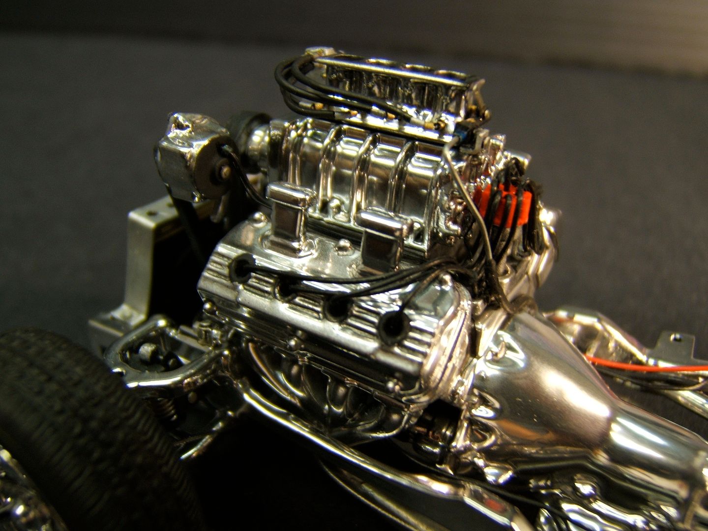

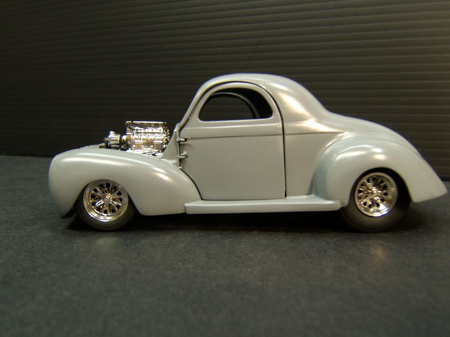

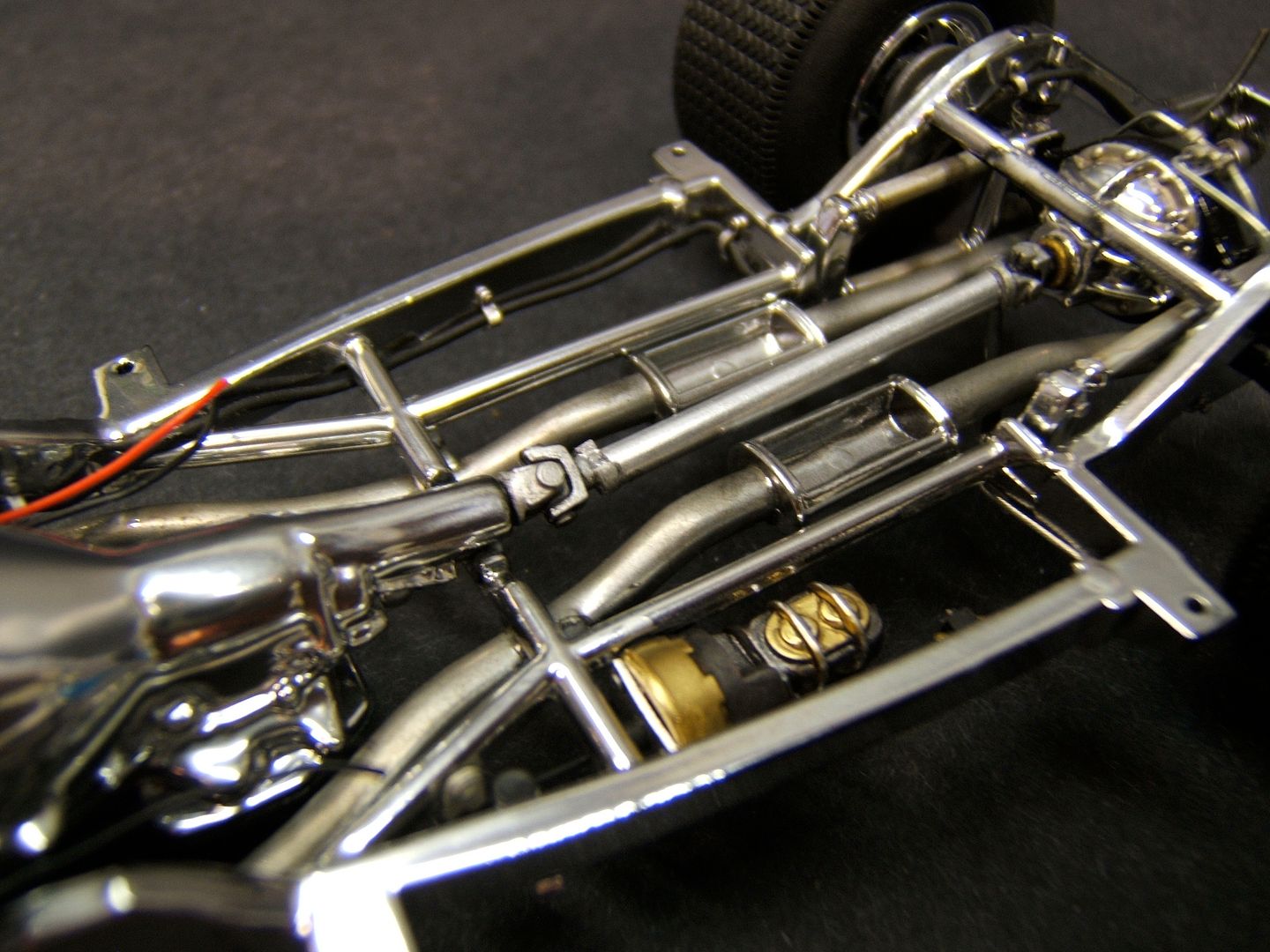

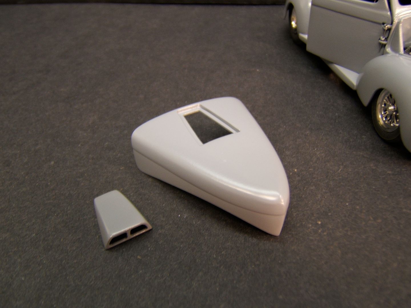

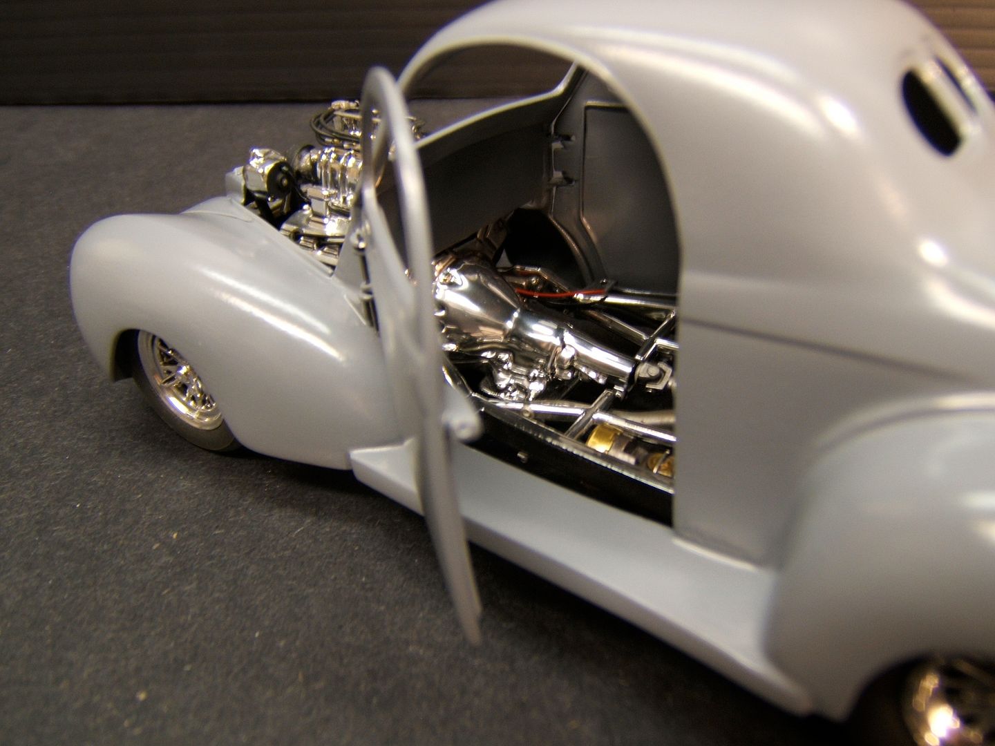

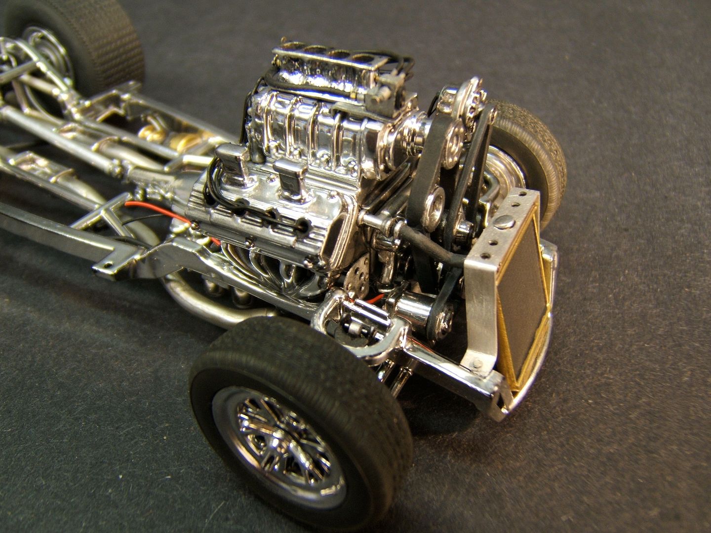

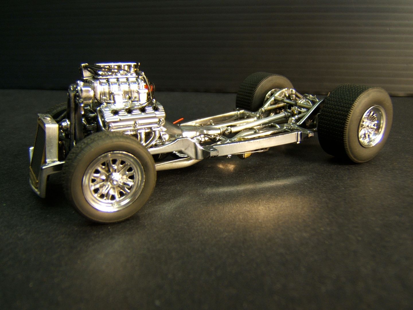

Hello......thank you all so very much for the kind comments.........the engine is installed and plumbed..... using"Pro Tech" fuel line.......I still need to attach the throttle cable........I hooked up the radiator and added a few details.......I will primer the body tonight......thanks for looking.

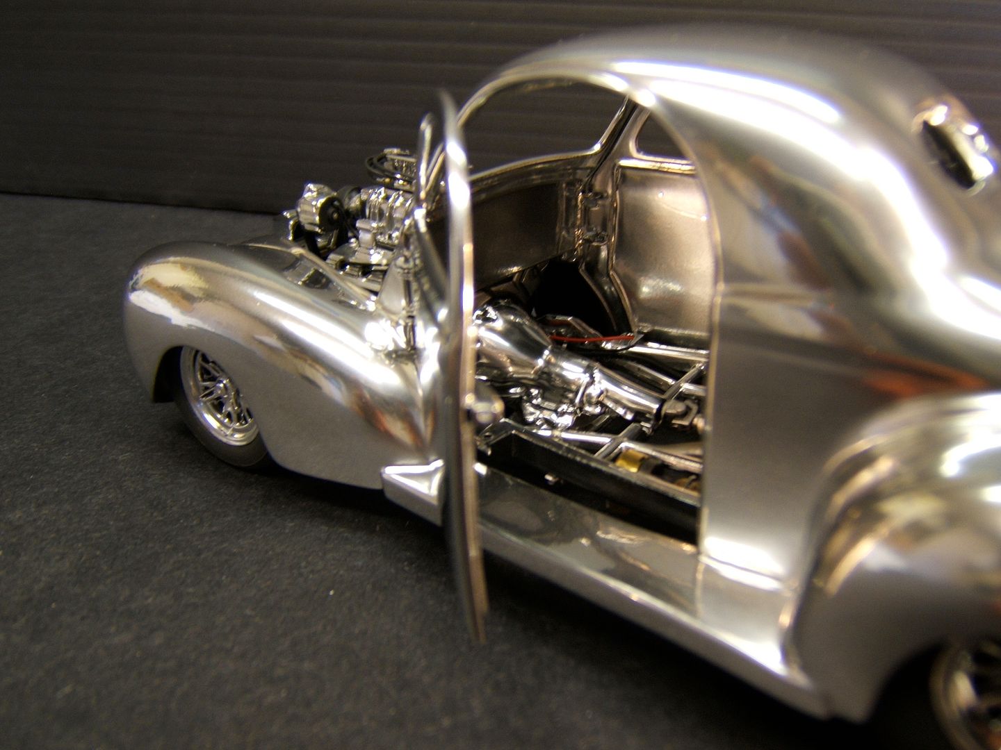

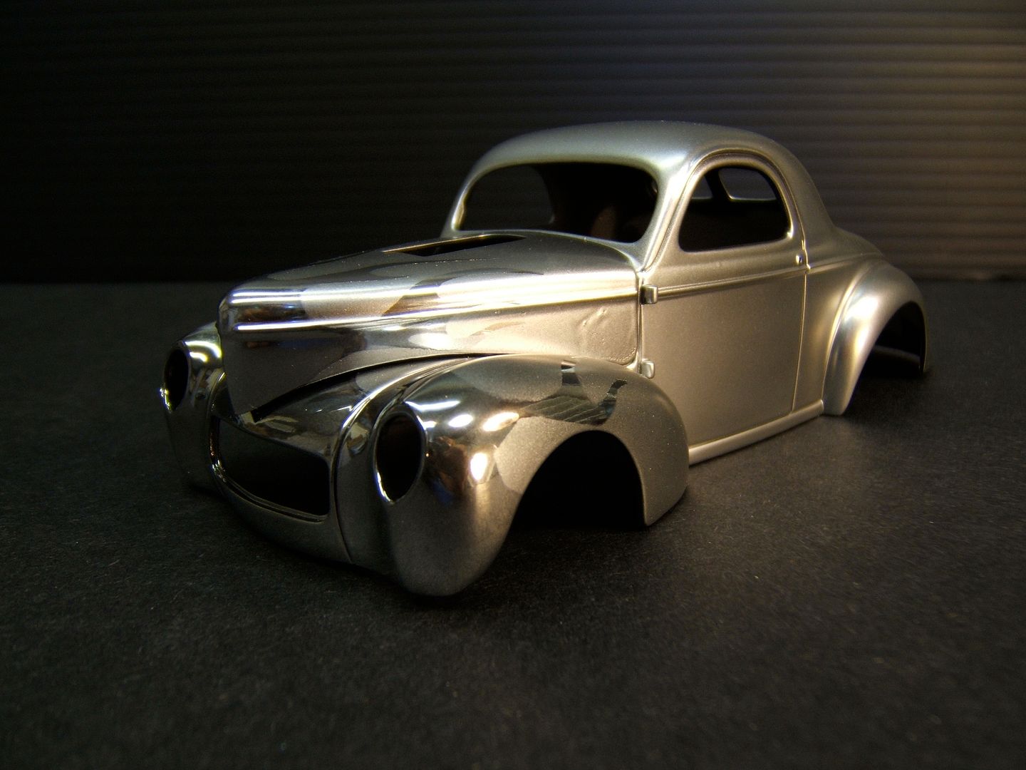

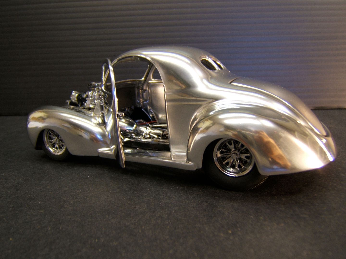

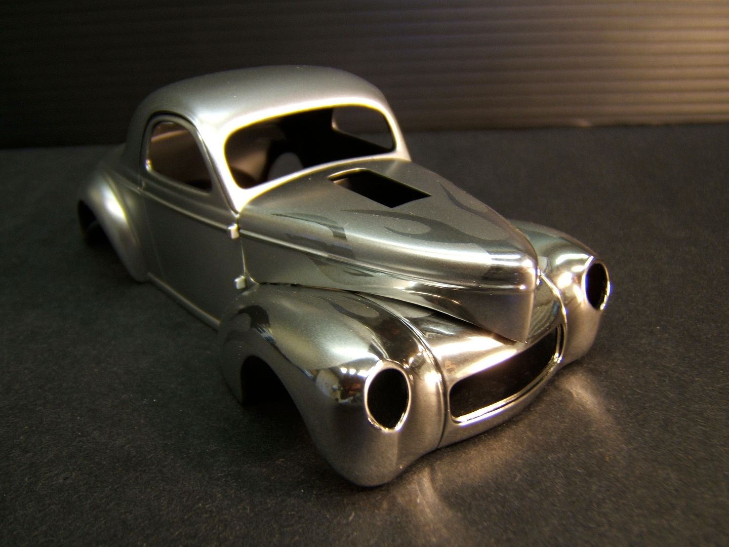

few more progres photos......thanks.

thats a whole lot of bling! B)
Absolutely. I think it could be refered to as 'jewelry' in some circles. Not only am I completely in XXXX'ing awe of your work, I still can't believe how short of time it takes you to create such a XXXX'ing masterpiece.

beautiful rolling chassis

add me to your long list of admirers, you are a model ARTISTE!
I do however have a small nit to pick.... your driveshaft is improperly "timed" and would not survive "real world" use for very long. Universal joint positioning should be mirrored otherwise there would be vibrations at higher speeds.
Mike.......thank you for the tip.......that is good to know.......believe it or not.......when I attached the drive shaftt to the axle and engine......I thought to put the joints in the same position but,i over looked it :( ......one of my weak points not paying close attention to what I am doing.........thanks.

I'm fairly sure you must have gotten distracted by something SQUIRREL!!! because you saying you weren't paying close attention to what you're doing just doesn't seem to jive with the models we've seen you produce.
PS. there have been a few other builders here that have not timed their driveshafts correctly either. ;)

looks great, though those interior bolt heads... look a little out of scale.

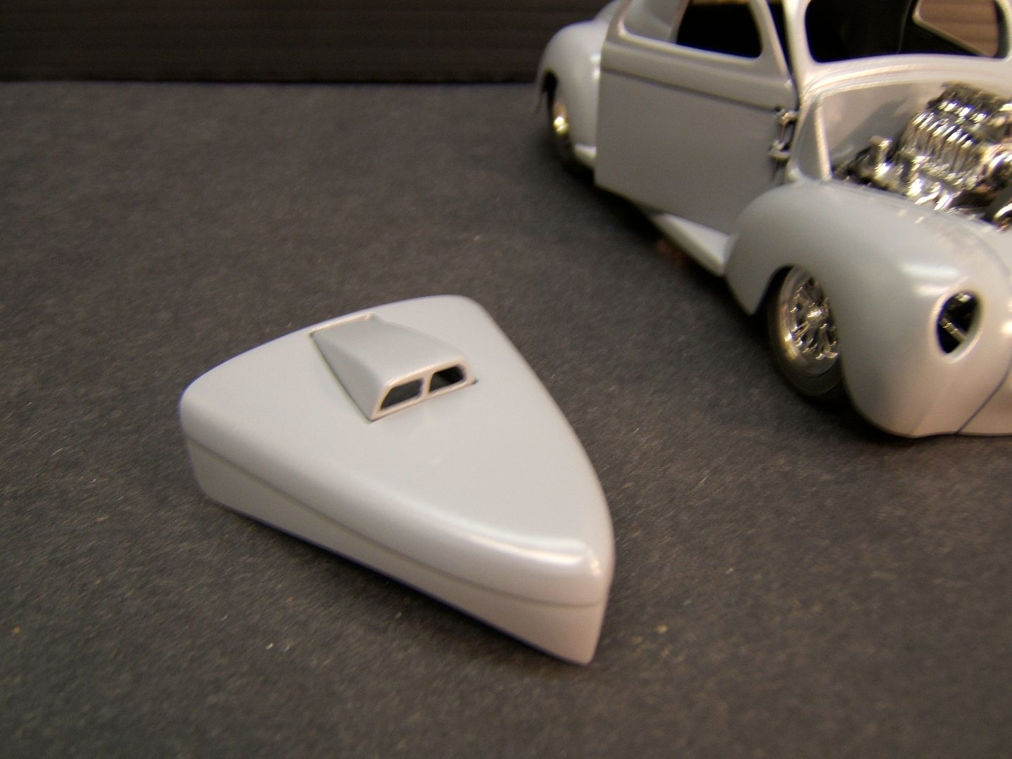

Hello......thank you all for the kind comments........I got primer and finished the body work ......I will sand down the body and get the base coat on tomorrow.......thanks for looking.
