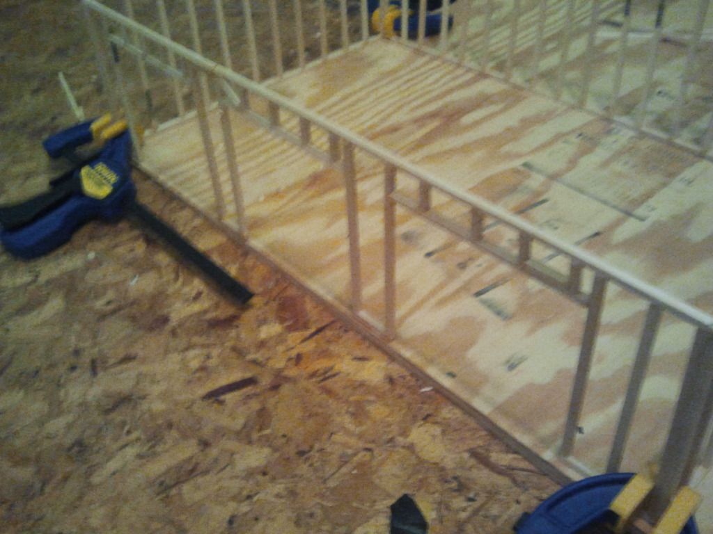

Got 3 walls of 7 togther today.
Posted Image
Posted Image
Posted Image
sorry about the clamp in the way of the picture. had to reglue one of the pieces of basswood.

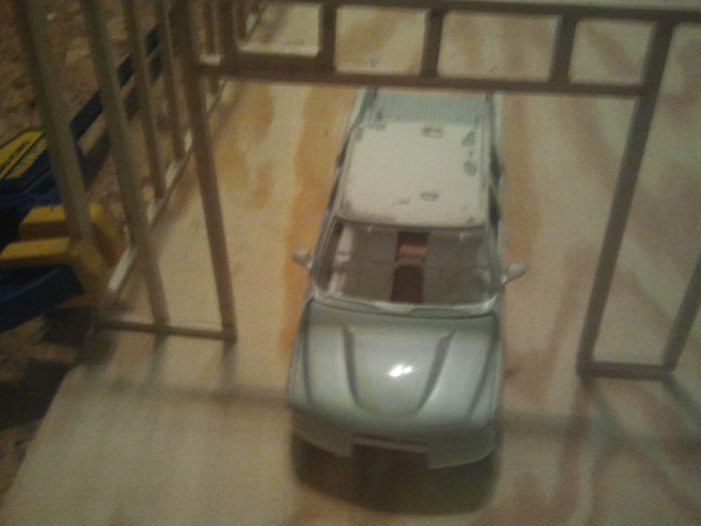

Got some more done, just not to much. The front wall is done along with the base being cut. Base is 30x30. Heres the pcs:Posted Image
Posted Image
Posted Image
Posted Image
Posted Image
Plenty of room for a car or truck even with a dually or crew cab truck.
Posted Image
Posted Image
Now the next question, what it the best way to replicate concrete on the wood surface? Now i do have an airbrush so weathering and painting it wouldnt be a problem and the wood is already sanded. So thats my question.
Thanks for looking.

Now I see the way you're constructing the walls, I understand why you have been against the use of Foamcore sheets. You are doing a good, neat job on the actual construction, keeping everything square and true with barely any excess glue. Nice work.
Now I'm curious though.... perhaps some other members can shed some light on this........ Would a commercial service garage of this size have been constructed with timber framing in reality? This is not a criticism of the way you're going, but more to satisfy my own curiosity. The design would indicate a building in the 1930's era or newer........ as opposed to an earlier 1900 to 1920 era, which may have been of wood construction, but a lot smaller.
Are you going to cover the inside and outside as a finished surface or leave the wood framing exposed inside?
Tony

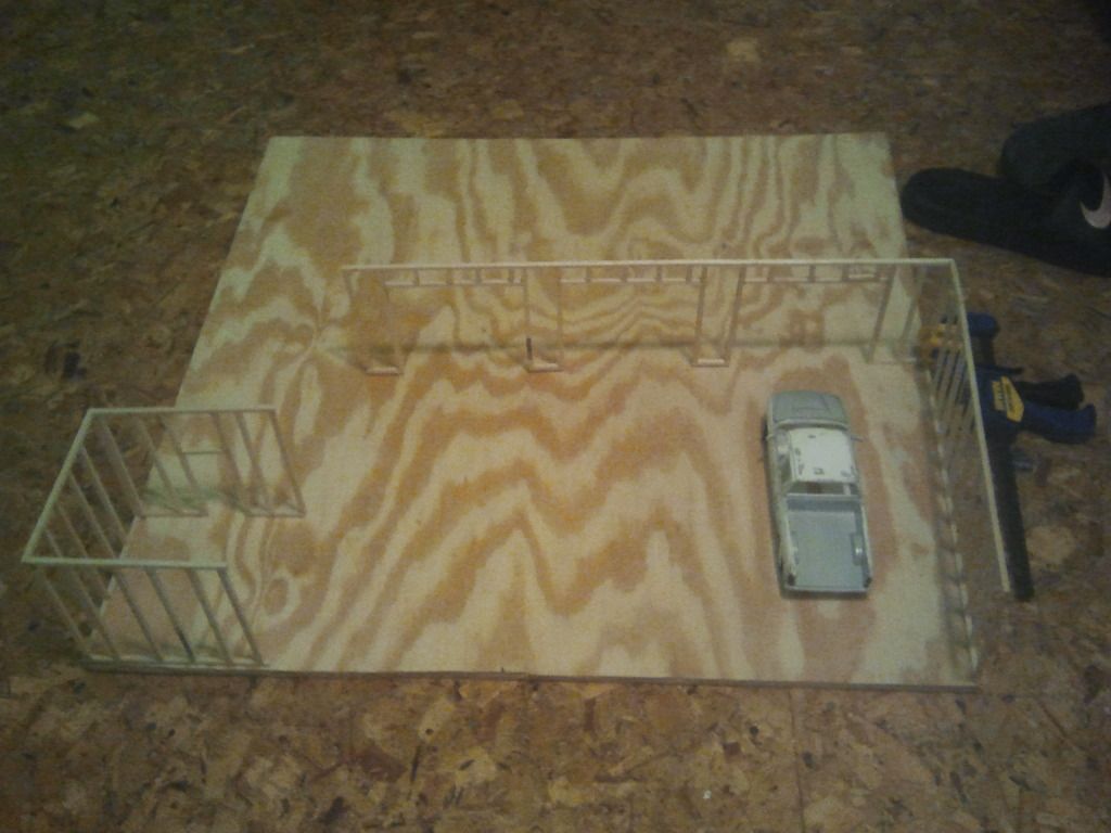

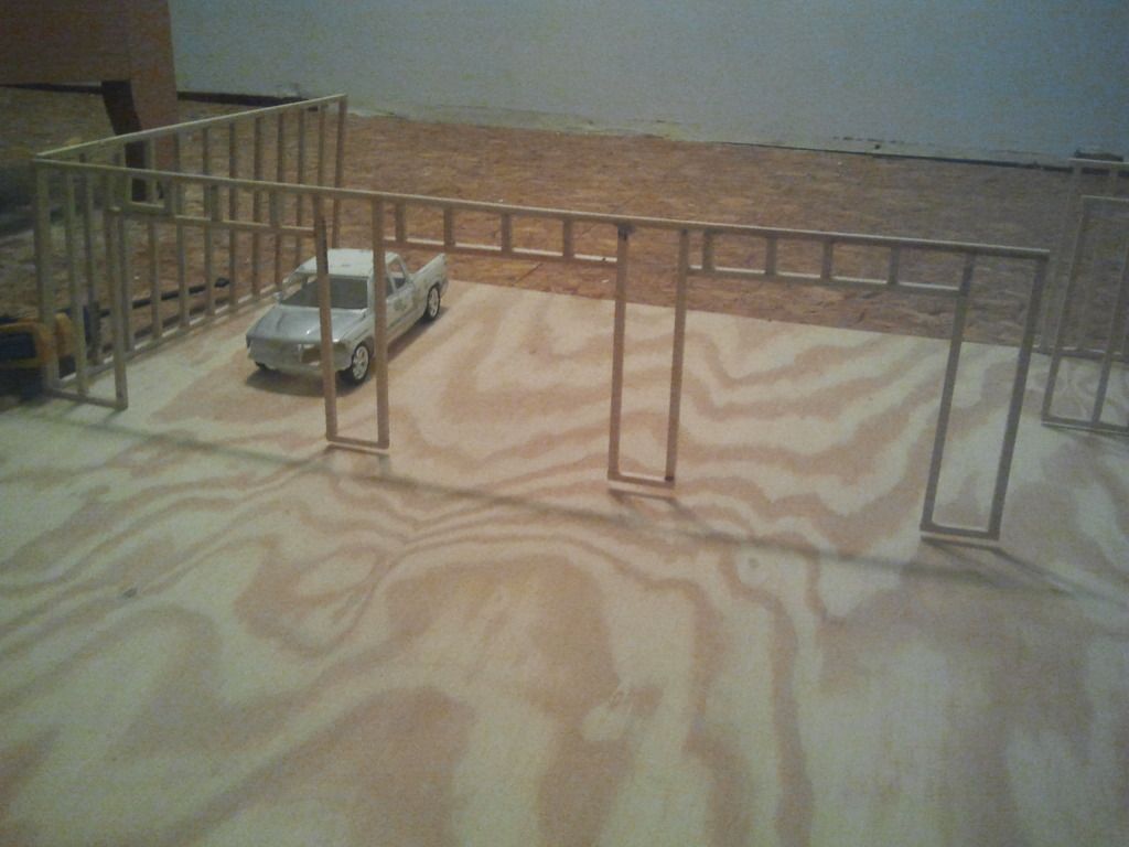

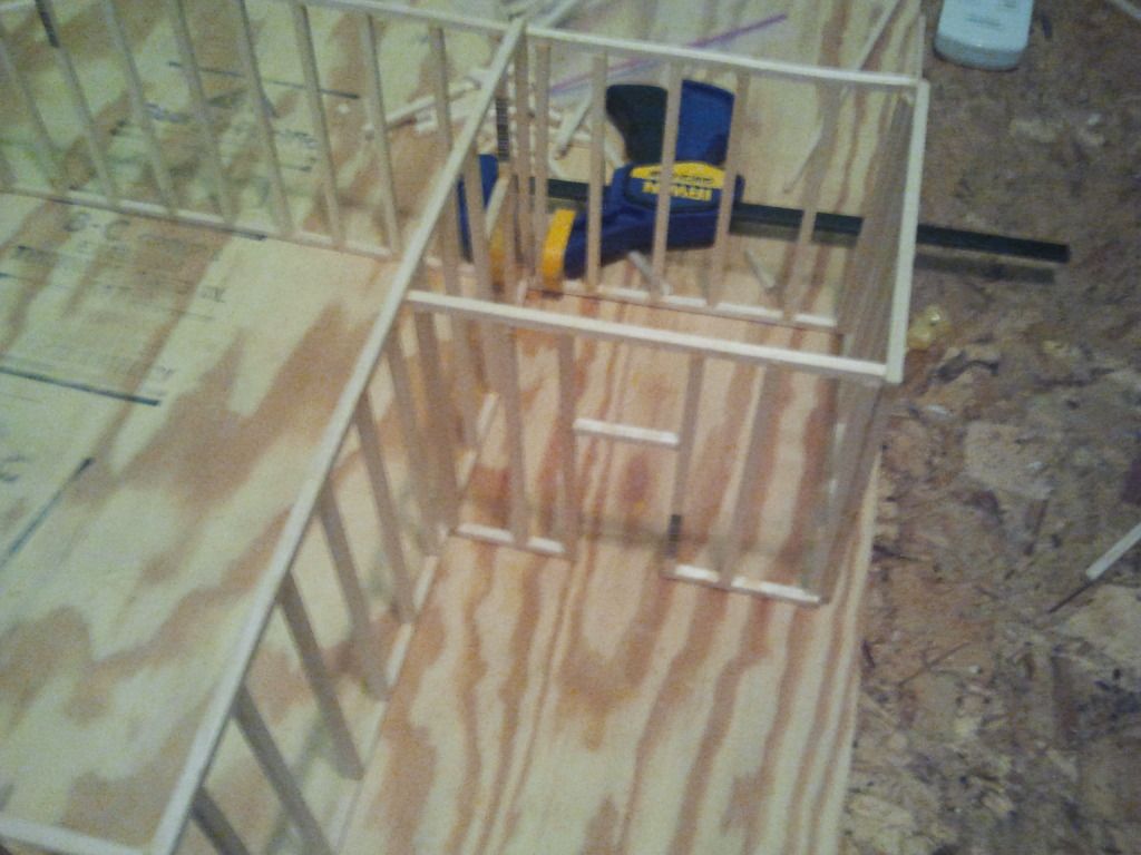

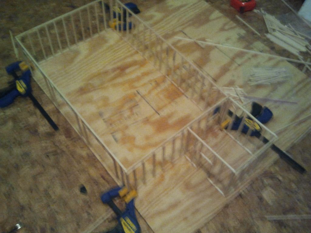

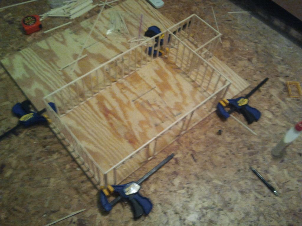

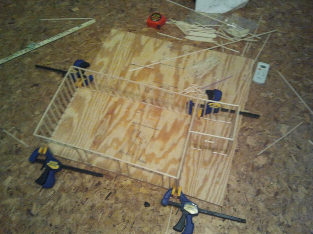

Well ive got all of the walls built. and mocked them up using clamps so there straight. Stilll need tto figure out how i want to do the concrete and asphalt. Heres the pictures:Posted Image
Posted Image
Posted Image
Posted Image
Posted Image
Posted Image
Thanks for looking!!!

Nathan,
1. Really nice job on the studding.
2. Funny- I'd be the opposite of your dad, I'd be pushing you to the workbench! You and Dad need to start a dialogue. Explain why you're doing what you're doing, and help him understand this is your interest, your passion, and your pursuit. Sports is cool, if you're into it, but you need to keep diverse interests, lest you suffer from burnout.
3. Basswood is the better choice for this work, absolutely. You might want to consider putting some sealer over the wood to make sure it doesn't warp, splinter, etc. Clear spray lacquer in a flat finish, available at any hardware store for short money, would do just fine.
4. As Tony Suggested, plain old Elmer's glue will be fine if you're doing wood-to-wood or wood-to-paper or cardboard. If you're using another material, such as plastic, I would suggest slow-set epoxy to give you some working time.
To answer Tony's question, it's entirely possible an early garage could have been wood-framed, as many of them were converted barns, stables and other older commercial buildings. It was, and still is, somewhat common, to also build brick or concrete-faced wooden-frame buildings, although less so now for buildings like this in modern times, but it would have been seen in fairly regular use, I would say into the 1940s or '50s in rural areas, anyway, perhaps an occasional suburban/city location, too.

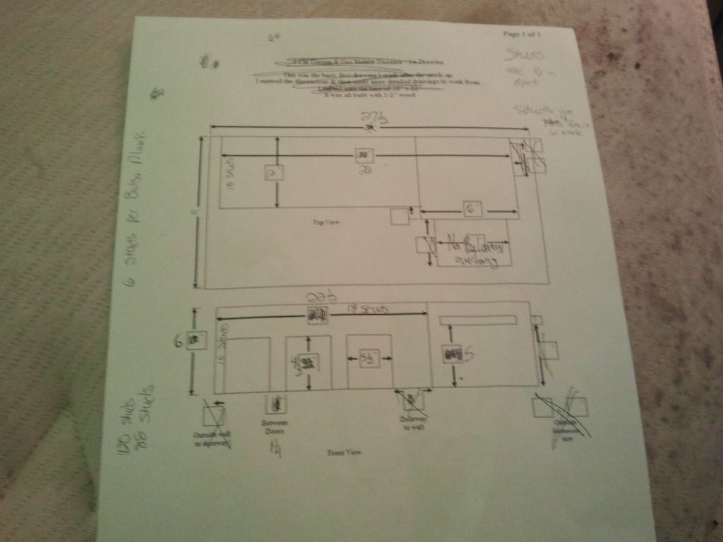

Since im organizing my photobucket, heres all of the photos again.
