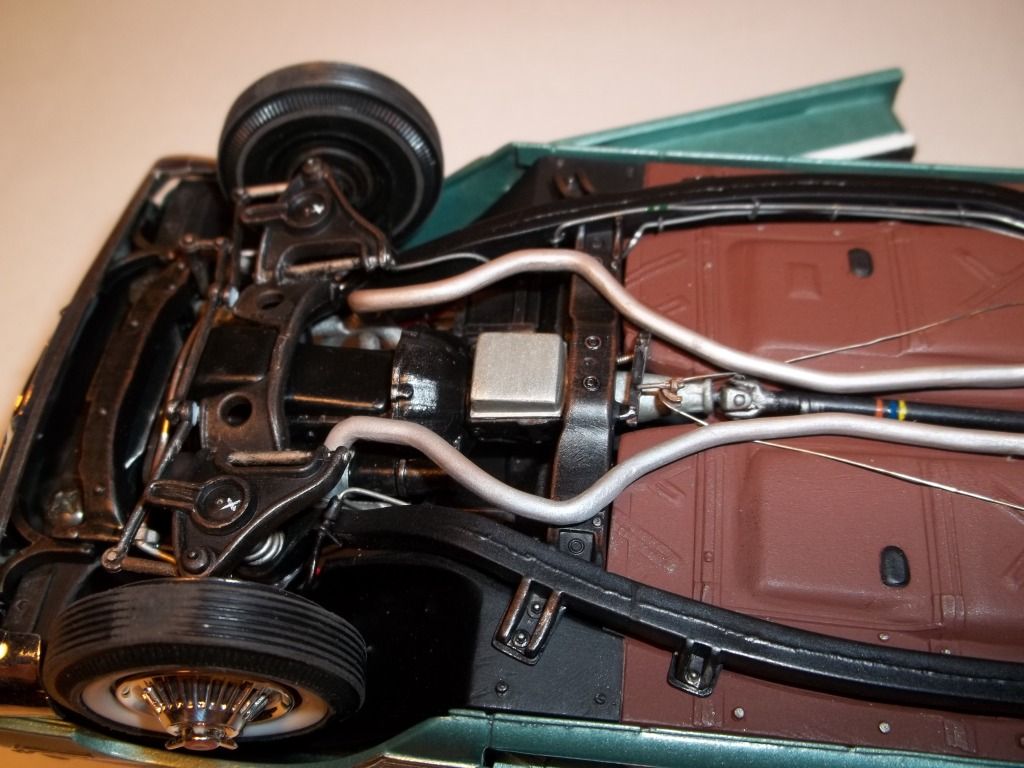

Along with the '60 Starliner youl want to rework the radiator support to remove the screw hole lugs from the old tool chassis. Although this is my stock build using the old tool separated chassis and floor pan it is close to what a kit bash can achieve. Parnelli's car is really neat, have fun and keep us posted.Posted Image

So if I use this starliner chassis is the frame seperate from the undercarrige or does it require it to be cut away. The reason I ask is if so why wouldn't it be done to the marauder chassis. I know that the exhaust and all is molded in so that would require removal. Now if you are not planning to show off the bottom is there any other reasons for the chassis swap. I know that I will need to rework the interior cause of the rear bench seat.

Darrin, build to the level you enjoy and build what you want to look at, a curbside version of this car would be very nice and would only require a stance adjustment to the original kit chassis and some side exhaust peeking out.
