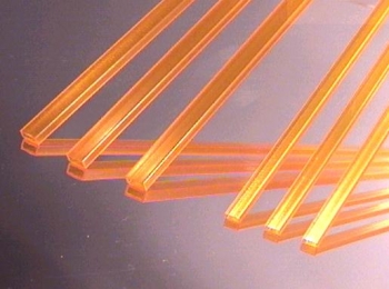

Whoa. Those are really cool. I might even have to try it. Where do you get the colored styrene?
#4 Joker
Joker
  • 1,216 posts
  • Location:Old Dominion
  • Full Name:James Scott
Posted 10 July 2012 - 03:19 PM
Thanks y'all
Hobby Lobby..it's $1.35 for two rectangular orange tubes.
About a 1/4" wide by 1/8 by 1 foot. (.118'x.236' / 3.0x6.0 mm)
Brand name Raboesch super styrene model # 541-55.

I googled that stuff and it appears to be available in the UK, not the US. I'll check with Hobby Lobby when I go there.
The store I go to has a big RC area too..they use styrene for all kinds of projects and repairs.
The rectangular styrene is in little cubby hole type shelf.
Good luck

pic..

My Hobby Lobby has ZERO RC items.
