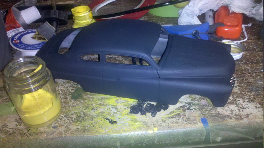

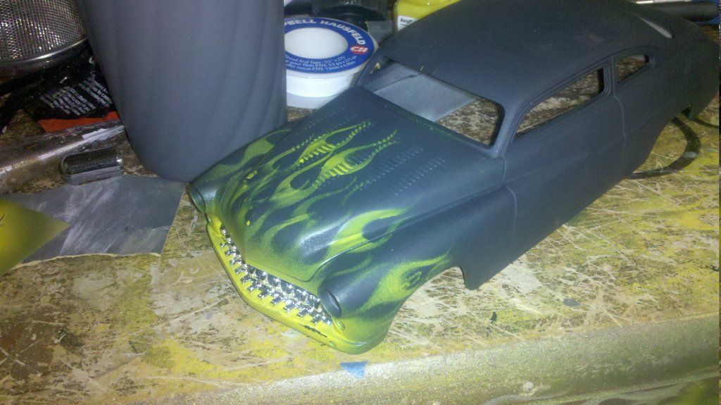

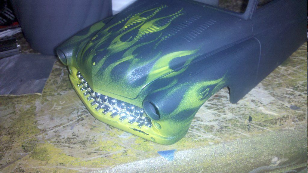

I finally got time to try out my new airbrush that I recieved from Ken Bryller a few months back. This is the first time I have ever used an airbrush. I used it on a piece of cardboard for a couple days first and than I moved on to a 49 Mercury. Its not the best but for the first time I am pretty tickled with it. Let me know what you think.Posted ImagePosted ImagePosted Image

Great first try. I am only trying to help, not be critical. You have some paint spattering(large spots). This tells me the paint is not being atomized properly out of the brush. Thin your paint a little more. Close the orifice(don't open the needle as much) and increase your pressure a bit. Ideally you can get within a 1/2" and get a fine edge without getting too much over spray, but it will take several passes. Keep playing with it and you will get a technique that will be very pleasing to you.

Thanks guys, much appreciated. I am using acrylic paint so how exactly do I thin it out and how much do I use.

  • Full Name:Pete Johnson
