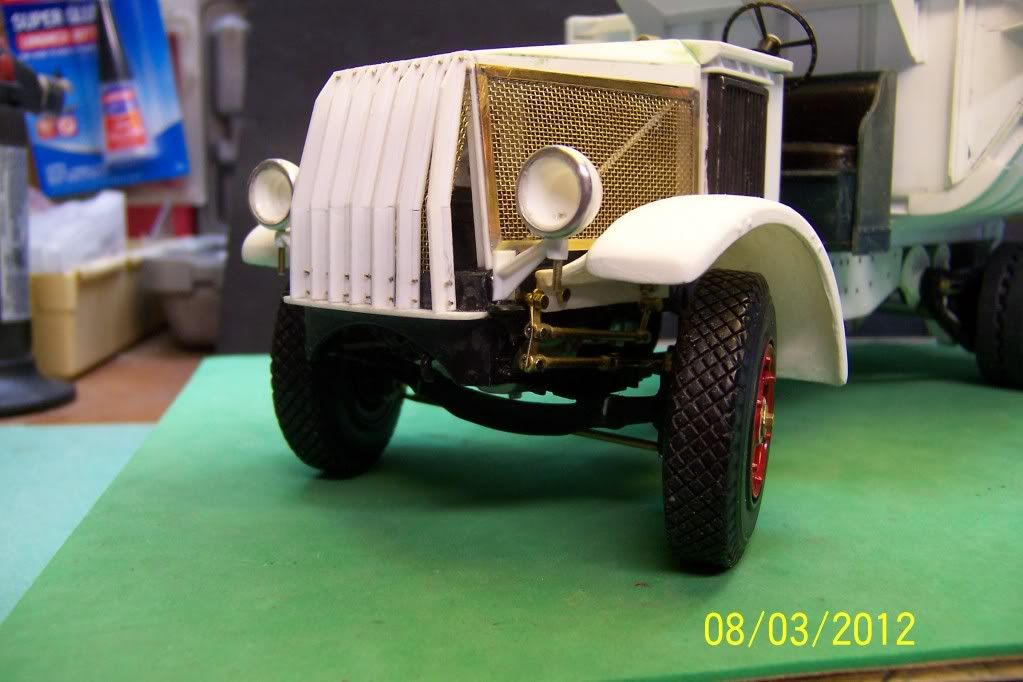

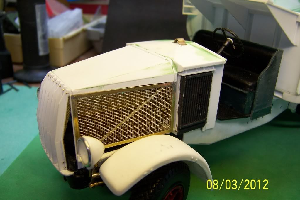

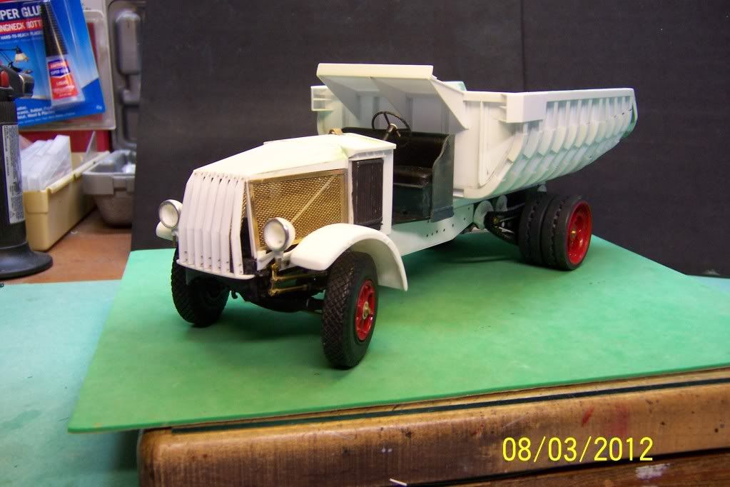

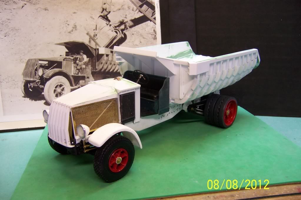

I've been to Hoover Dam as well and had the tour down iside. It's quite an experience. The two 30' diameter overflw drops on each side are really something. I's hate to ever fall in one! We got to walk inside the original diversion tunels that were dug out of the canyon walls to get the Colorado River water way from the actual dam area so that they could do the base excavation. In the meantime work continues on this build. The side screens for the hood were finally fit in place, the steering column and box are set and the drag link and steering arm are now connected. There is a small protective shield over the radiator cap also. Next is to detail the fishplate with some bolt heads. Then probably the engine will get some detailing.

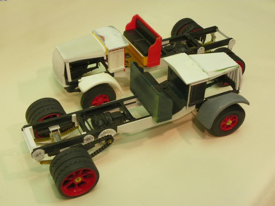

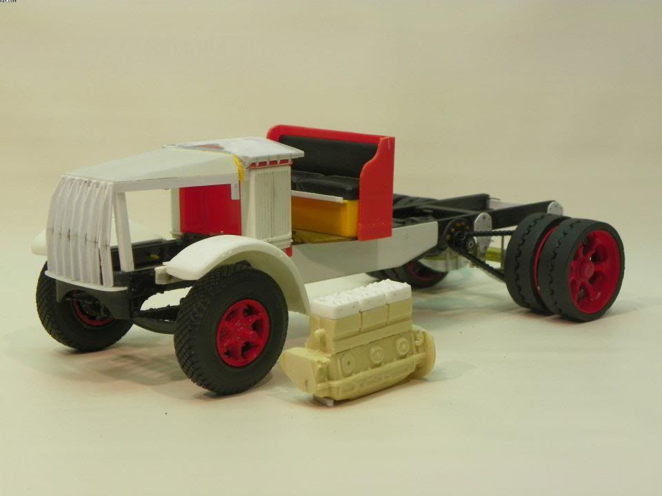

Just so that you know that there are actually two AP's being built, here is Jeff Harper's version that he will turn into the cement mixer. The second pic obviously is of the two of them together.

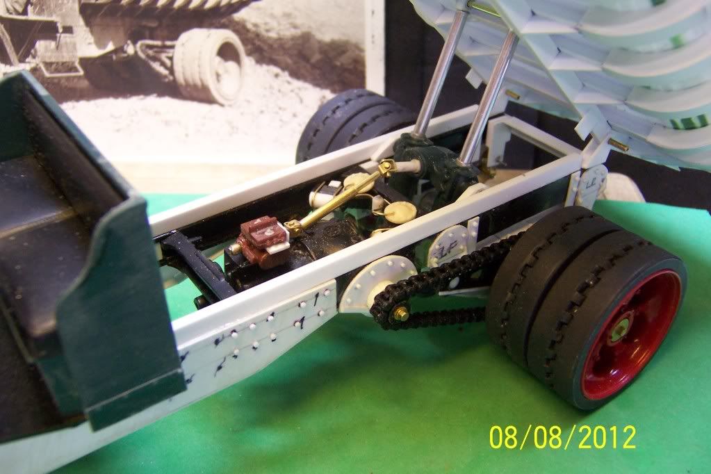

The delrin chain and sprockets are easy to come by. They are a bit large for most uses but fit right in here because the trucks were so beefy. The chain can be made any length just by adding or taking out links.

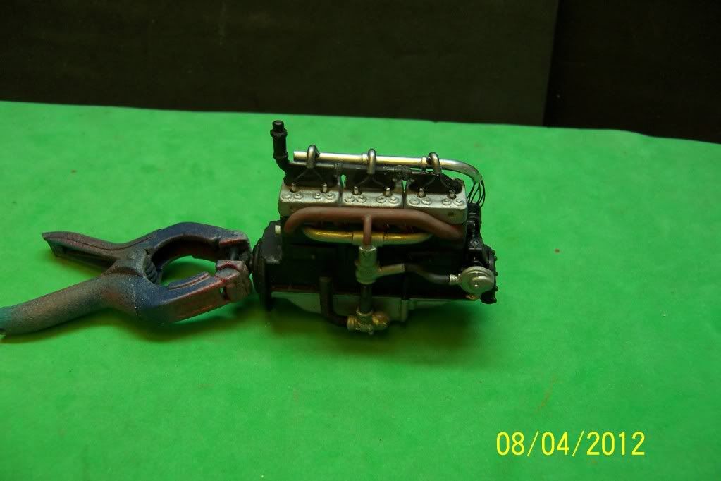

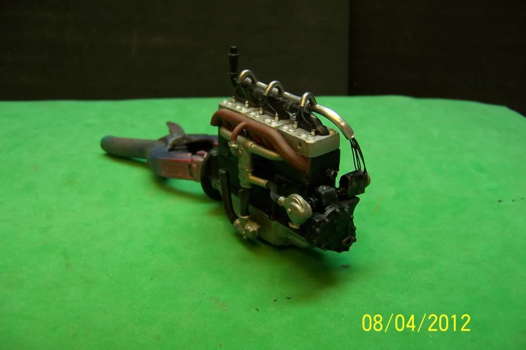

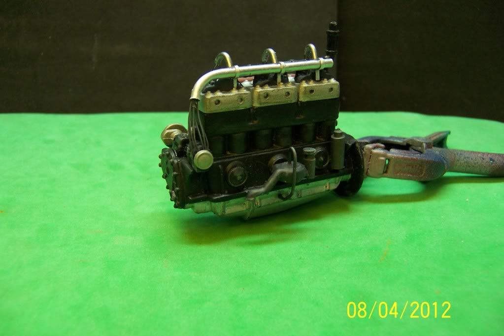

Here are a couple of shots of the AP Engine. It's made from two blocks of the Monogram AC with a bit of detailing including wire, aluminum tubing, solder wire, and parts from the parts box.

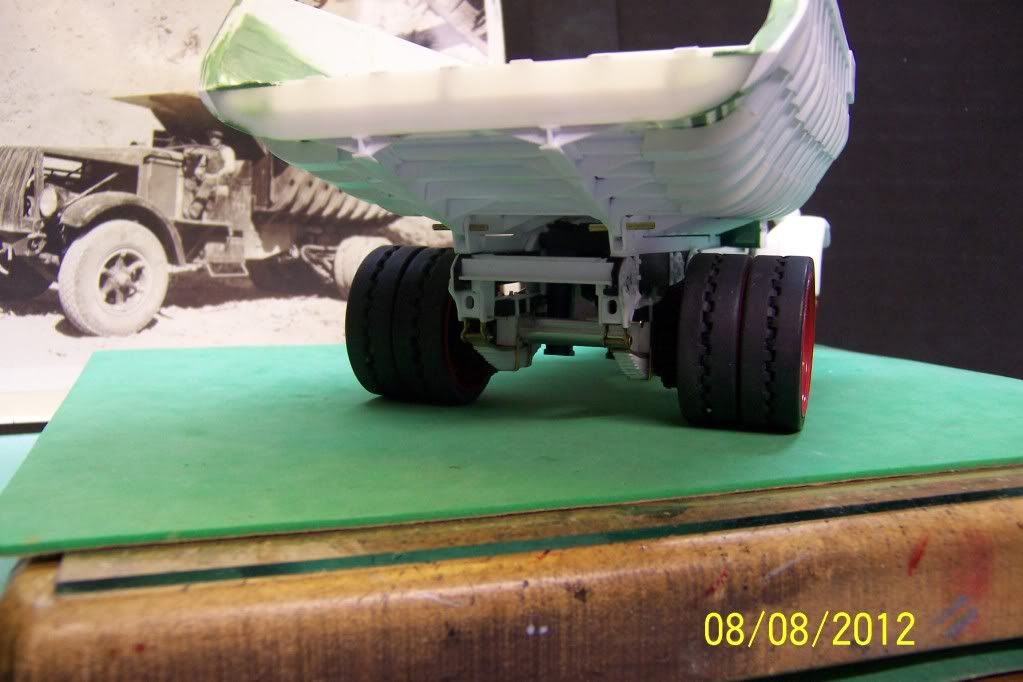

Here's a bit more progress. First pic shows an actual Boulder Dam being loaded with rock. Second pic shows the hoisting mechanism that was used on the first series of AP.s They underwent some changes during the time they were at Boulder and later on at two other dam projects. Third pic shows how beefy the undercarriage and body are.

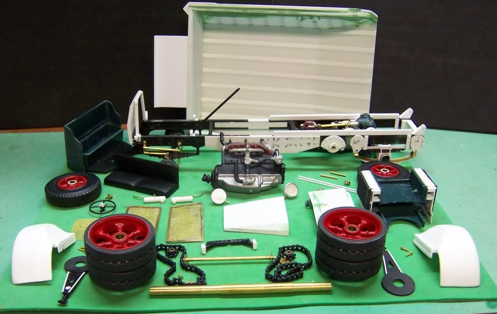

We got the information we were looking for from the Mack Museum today and it looks like we are going to have to repaint the wheels. Documentary evidence says they were dark green. Anyway, here is a breakdown of the parts so far for the AP dump truck. There are plenty of "widgets" to be added once the painting is done for what you see here. The entire frame, cab and hood are to be Mack dark green. Accents will be included but will be mostly subtle like drybrushing to bring out highlights and the use of powders. We'll also show some caked on red dirt in the tire treads.
