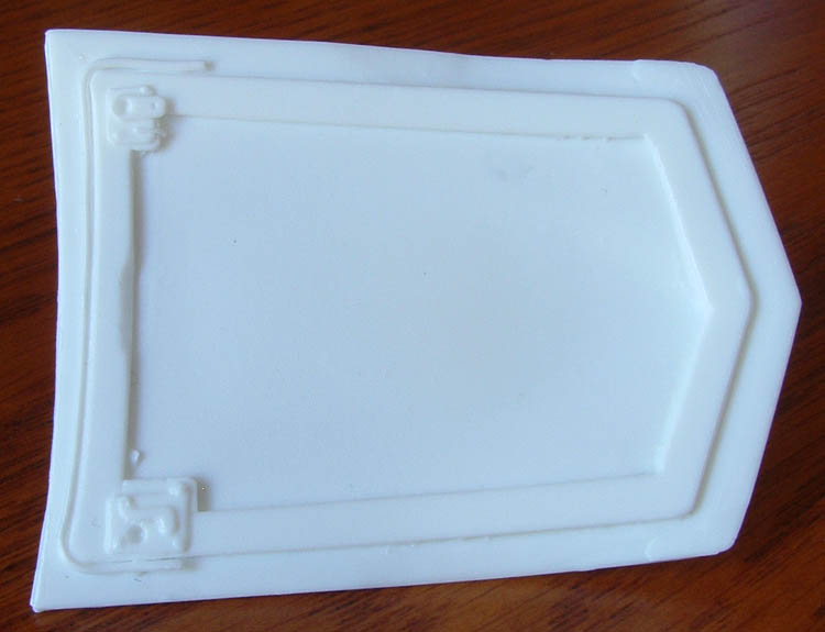

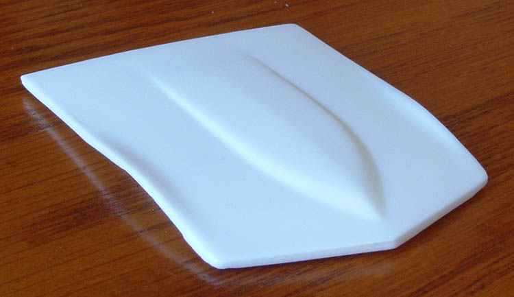

to hoods like this from Time Machine resin:
Posted ImagePosted Image

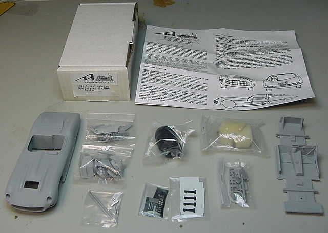

To complete kits like this from Aardvark
Posted Image
