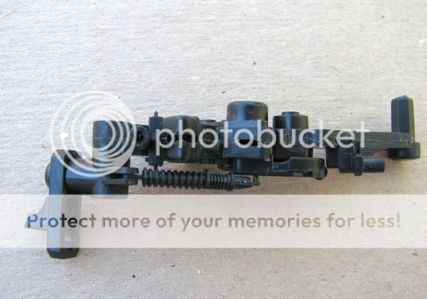

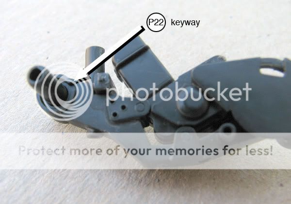

Assembly begins with the Frame halves (22, 23) and Engine part (24). The next step is the assembly of the Front Chassis parts (15, 34, 35) and some modification needs to be done for proper fit and alignment.
Posted Image
There is a gap between the two subassemblies. This gap doesn't allow the key to engage the proper position between the (Frame) and (Front Chassis). The stance of the completed vehicle will be off and the gap visually noticeable.

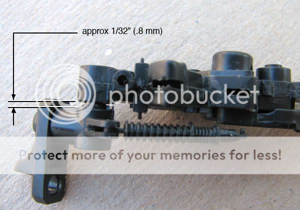

Posted Image

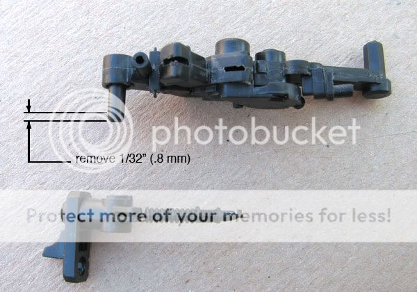

To solve this just trim and drill :
Posted Image
I cut and sanded smooth approximately 1/32" (0.8mm) material from the end of the suspension pivot peg of part (23). This peg is 1/8" diameter.
Posted Image
With a 1/8" bit, drill out the Front Chassis Connector Tube, Upper and Lower Half parts (34, 35) after gluing together and the glue has set. These parts want to split while inserting the pivot peg part (23) otherwise.
Posted Image
After I did this mod, I noticed the assembly was easier and the keyway registered properly. And no more gap

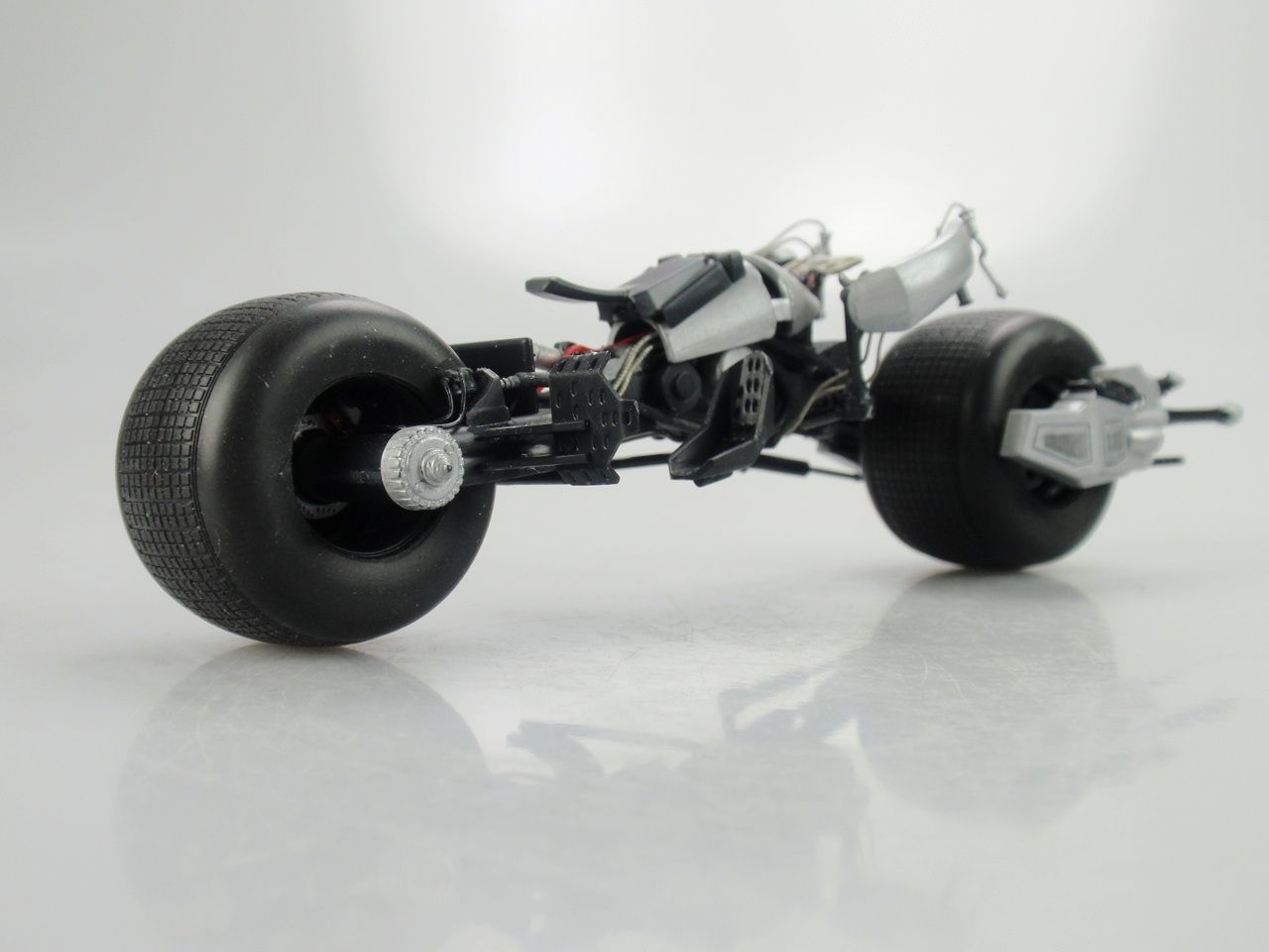

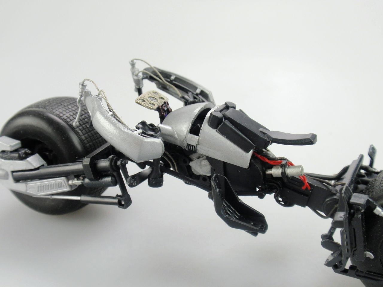

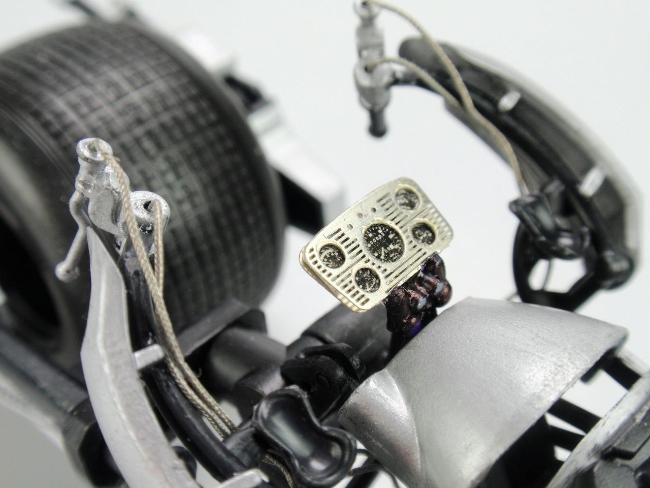

Wow, yours is off to a better start than mine...I didn't even pay attention to those areas. This is how mine ended up, not movie exact, got some wires on it and a gauge panel
Posted Image
Posted Image
Posted Image
Hope you don't mind me putting mine on your thread. Can't wait to see your build-up!!!
